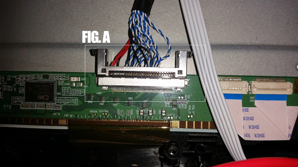

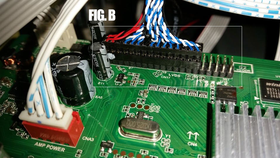

    Alright. I've discovered something odd in my opinion. I was testing the connections here from the LED driver board to where it connects at the bottom of the TV. I'll try to explain it clearly.
    When I disconnect FIG B. and test continuity of each wire, they all have continuity with ground and/or each other.
    When I disconnect FIG. A (from the bottom of the TV), there is no continuity between the wires except similar (red, black).
    FIG B. pins all test fine (no continuity except similar)
    FIG A. pins all have continuity.
    Is this normal?
