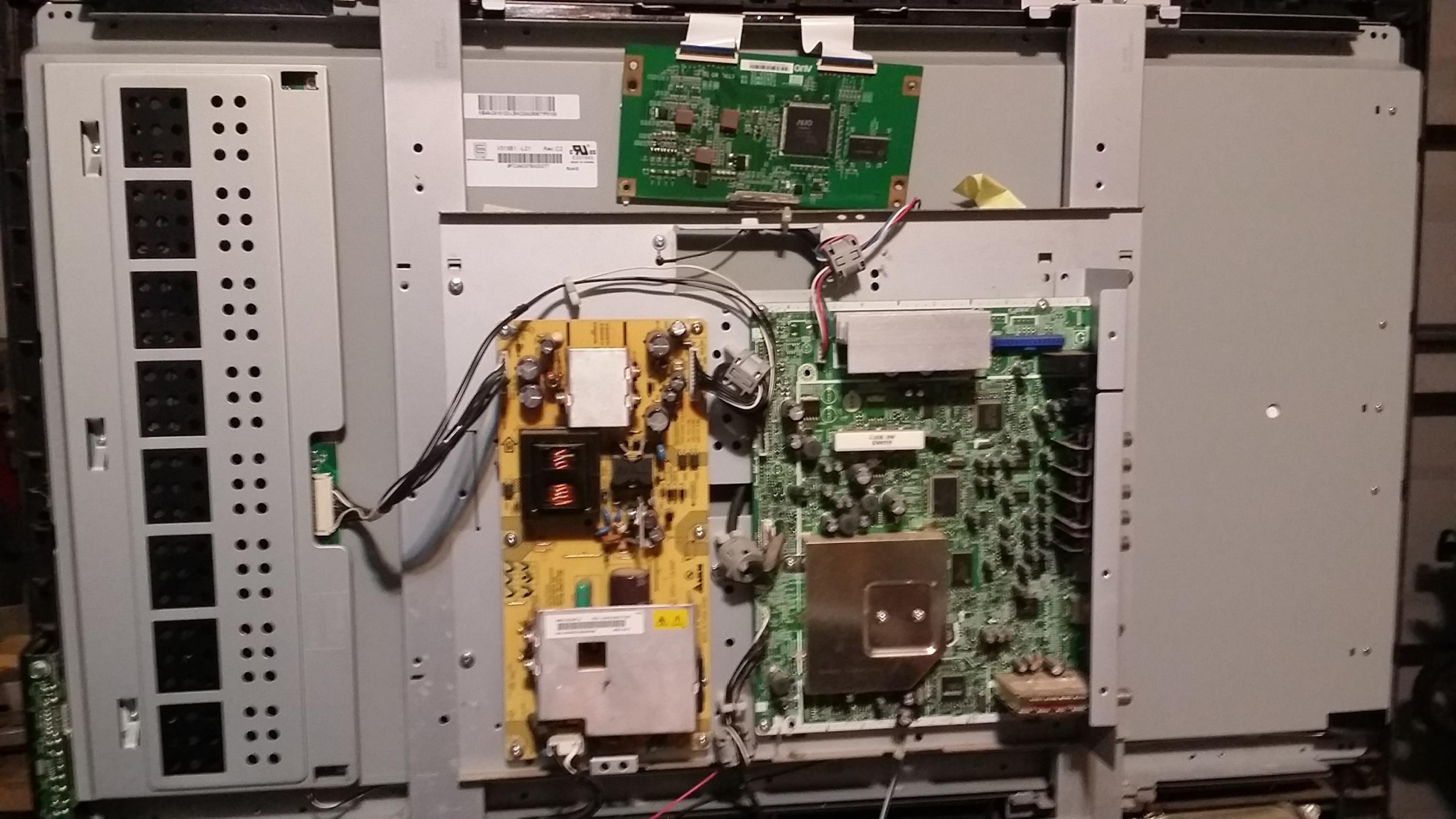

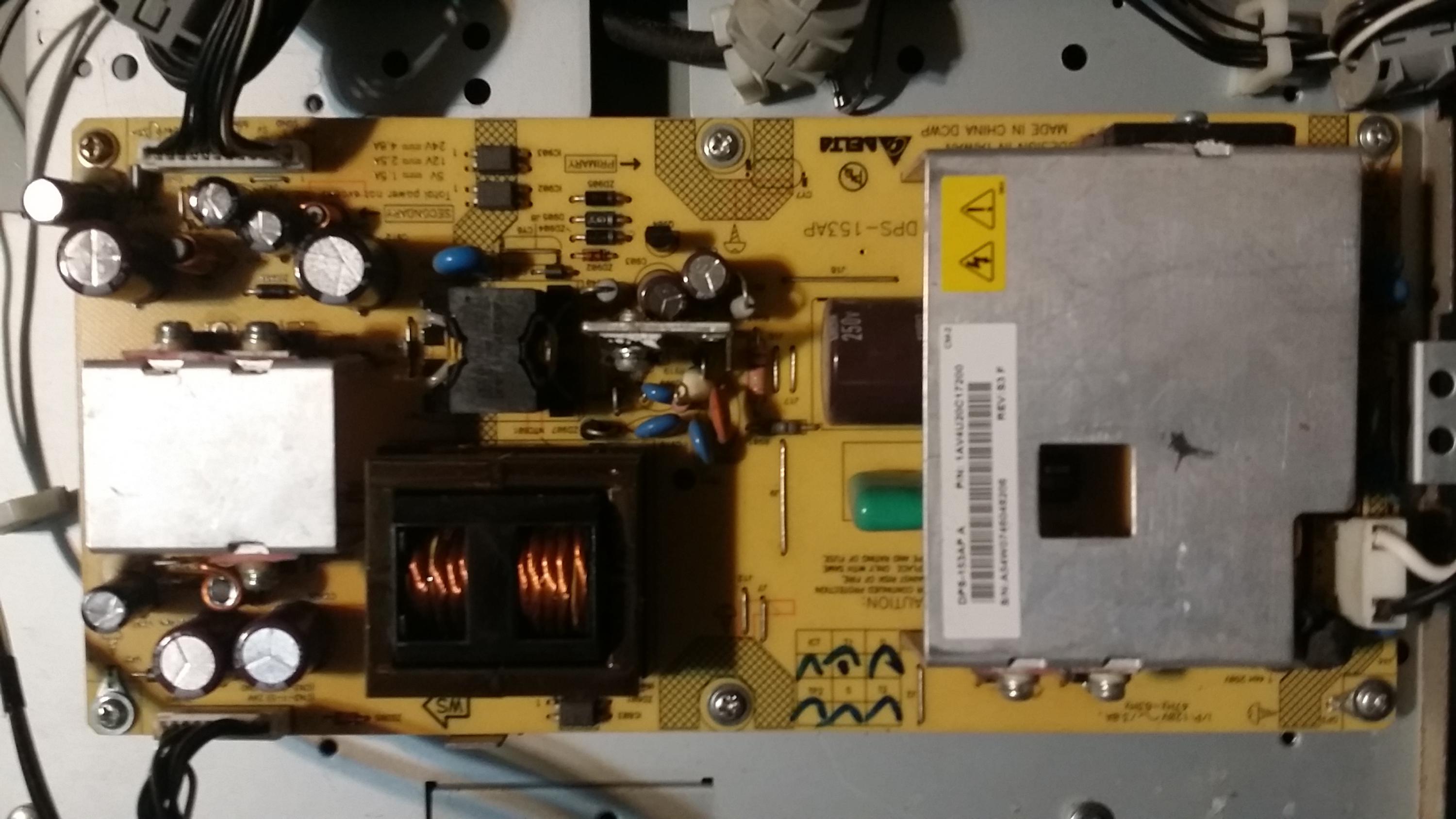

    Sanyo DP32647 Backlight flickering
    So I ended up with a RCA 32" Tv that the p.s. board was shot, and a Sanyo 32" that the screen was broken in the panel. After taking both tvs apart I notice a the inverter board takes the same plug and T-con's are nearly a direct match. So I decided what the heck Ill swap the panels out should work in theory. Anyway after swapping them out I discovered the panel back light turns on for about half a second and then just starts flickering off and on. You can hear noise coming from the inverter board that coensides with the flickering.
    Thinking it was a bad swap out I remembered the broken panel did the same thing before I replaced it, to be sure I hooked up the old panel and the same thing is happening.
    Im kind of at a loss on what to check, I know it has to be something related to power supply probably but Im not sure what, or where to start.
    I did take some voltage readings from the pins going to the mainboard and the inverter board, I get 24v to the inverter where it says I should and 24v, 5v, and 12v going the main board where it says I should. What is there to check next?
    Attached is a photo of the of the back of the tv, any insight is helpful. I am eager to learn.

    Re: Sanyo DP32647 Backlight flickering
    1st measures the voltage from the P.S. to the inverter (tall board on left of set. The voltage should be stable as labeled. Normally 24vdc. Then check for commands that tell the Backlight to turn on. It too should be a steady voltage. If all is good, remove cover and inspect inverter for burnt parts etc
      I sold a similar model to a guy after fixing it. He had that problem too. It turned out to be a problem with his line voltage! I bougt it back ang sold it to someone closer to me. Whenever his AC turned on it would start flickering as his voltage had droped to 94 VAC
        If the TV has a problem with low line voltage the primary capacitor(s) could be going bad
          Ill take some readings now and post back
          Ltank, Would it be possible that both panels have bad inverter boards?
          The cracked panel does the same flickering as the replacement which leads me to believe it has something to do with the power supply. Let me get a reading on the voltages again and I will give the exact numbers.
          Keep in mind the first time I took readings the voltages were jumping around from the back light flickering off and on. Ill try to get better readings. Ill post back in just a few.

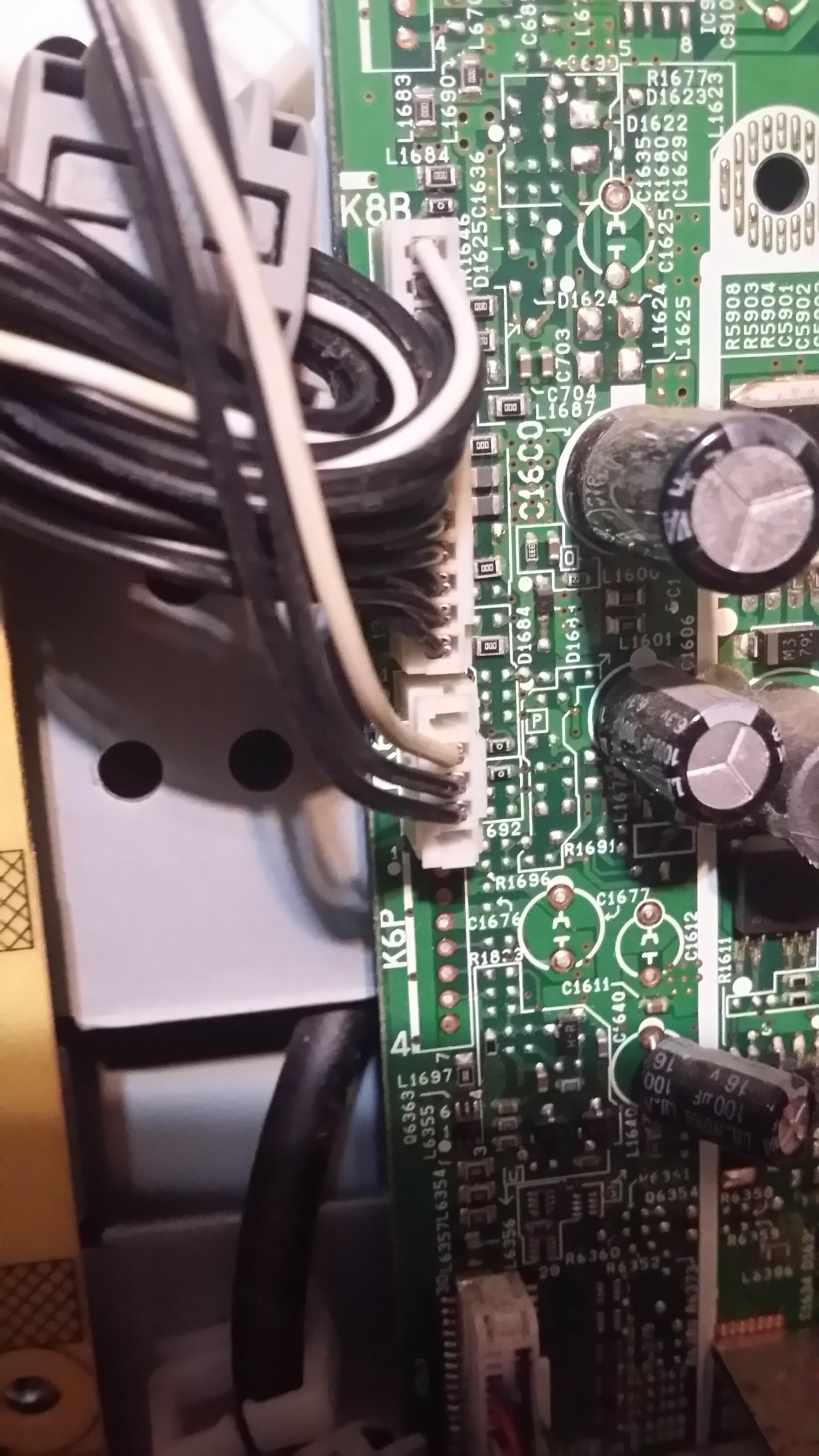

            On the top pin of the ribbon cable, the white one going to the inverter board I get a solid 24.46vdc before the screen turnes on and begins to flash. When its flashing it goes down to 22.30-22.44VDC. I also get around 22.40 VDC from a few of the lines below the first one.
            Where would the commands be to turn on the the back light? There is a separate set of wires that comes from the inverter board but instead of going to the power supply they run to the mainboard. Its 3 wires 2 black 1 white.
            I tested those separate 3 wires going to the main board.
            Here is what they read before I turn the set on
            Top(White):.032
            Middle (Black): .172
            Bottom(Black): .163
            And then when I turn it on
            Top(white): .028 vdc
            Middle(black):4.99 vdc
            Bottom(Black):3.35 vdc

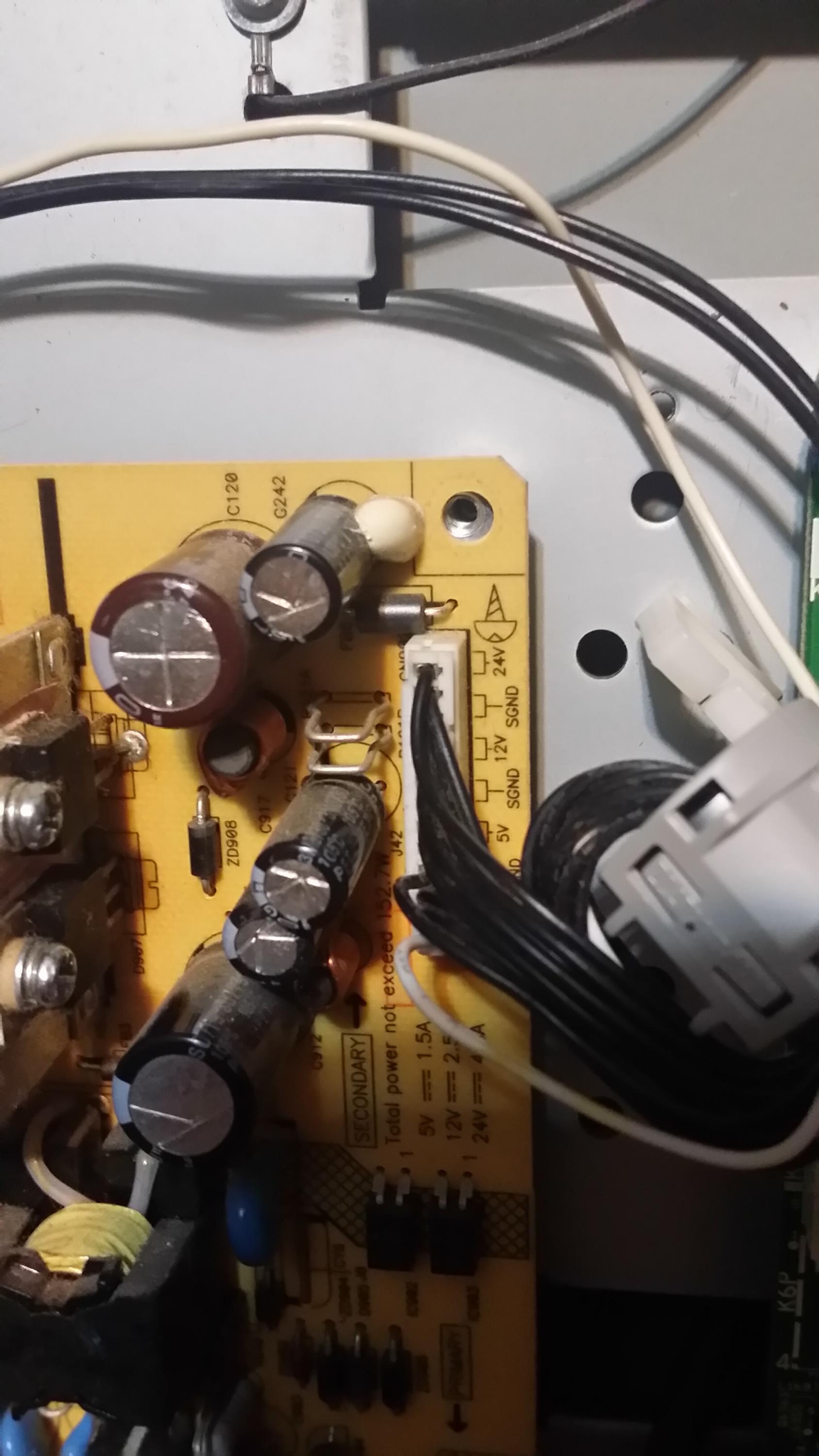

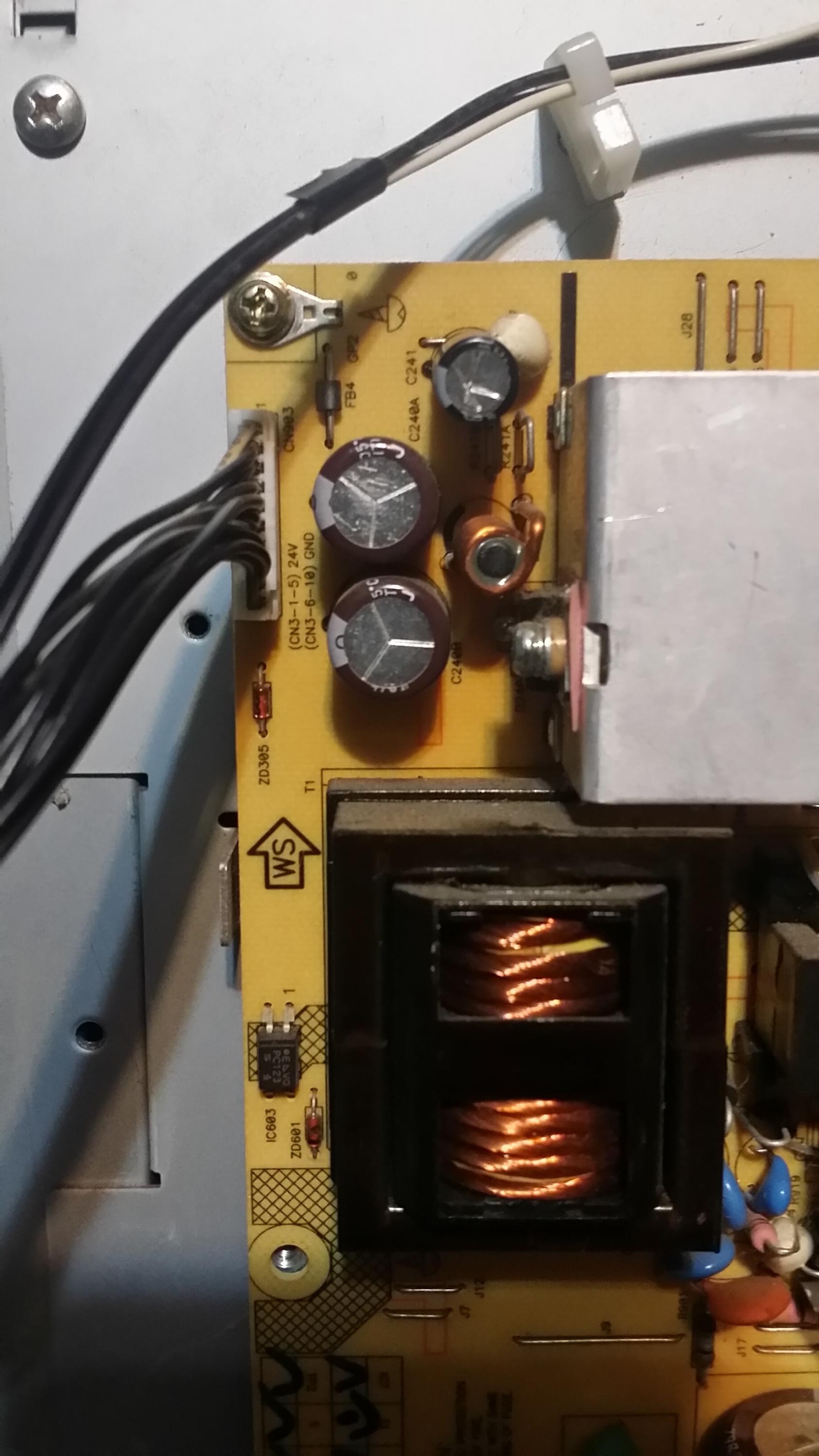

            On the cable coming from the power supply to the inverter board with the inverter board unplugged I get from top to bottom as shown in the picture starting with the white one:
            1. 24.38Vdc
            2. 24.38Vdc
            3. 24.39Vdc
            4. 24.39Vdc
            5. 24.38Vdc
            On the cable coming from the power supply the main board I get the voltage as shown on the board
            Next to 24V : 24.27Vdc
            Next to 12V : 11.94Vdc
            Next to 5V : 5.05Vdc
            Next to PSON( Im guessing this is standby?) 4.85Vdc.
            Im thinking that maybe the problem is within the 32 cables coming from the inverter to the mainboard. I think those are my turn on wire perhaps?

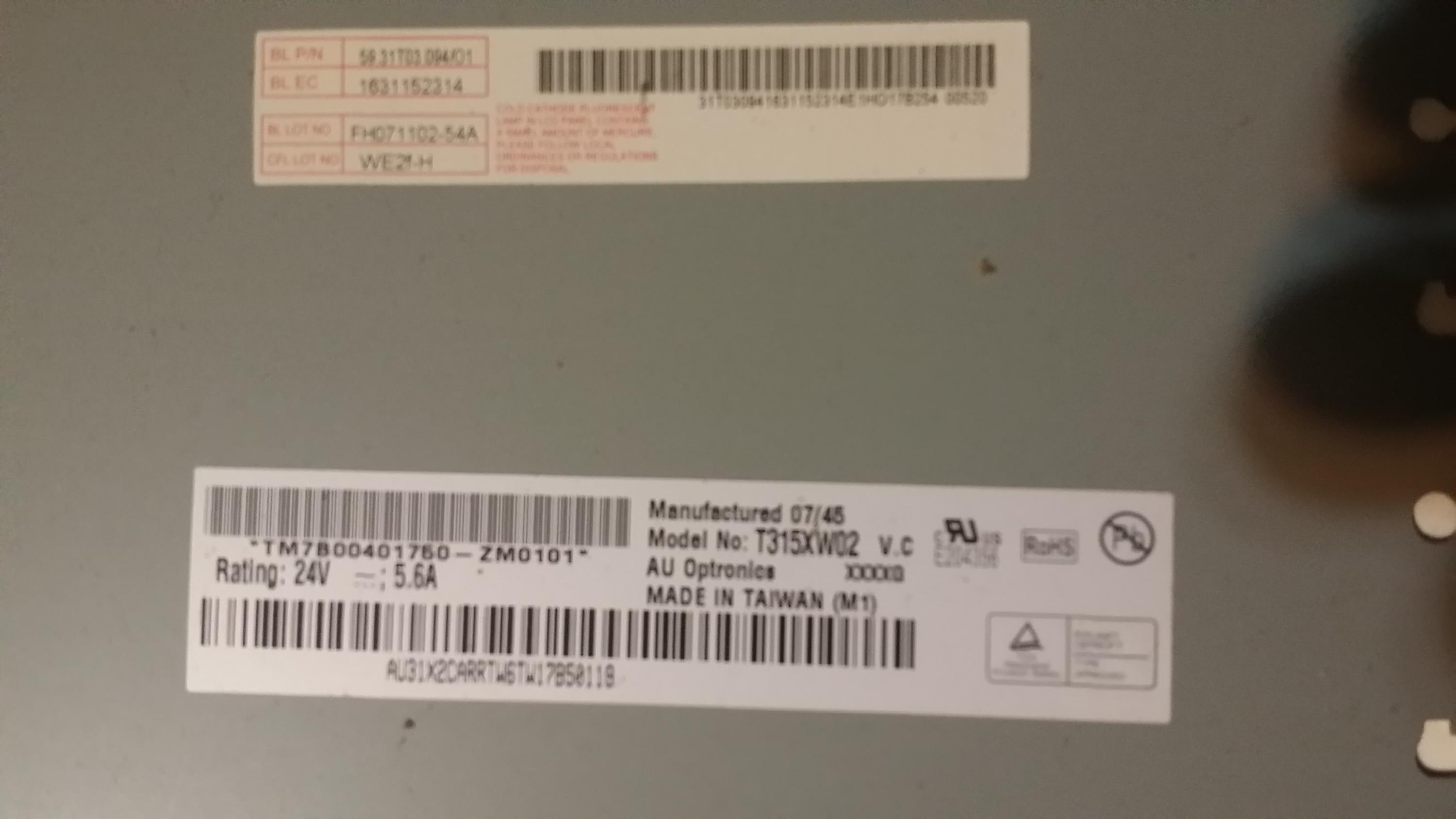

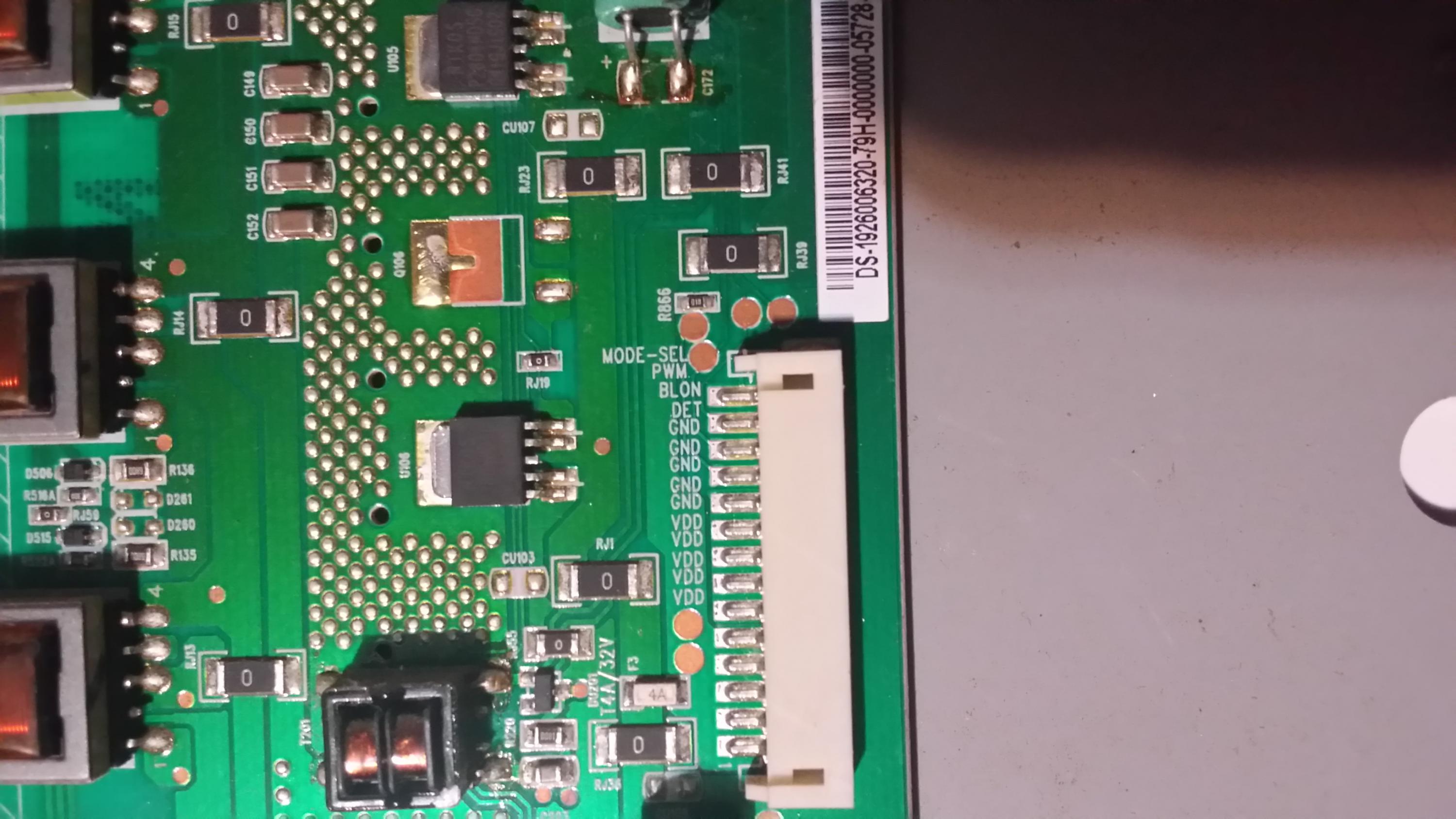

              Can we see the closed up pictures of the inverter board, especially around the connector that goes back to the power supply board. We need to locate the BL_ON and Dimming control lines.
              What is the LCD panel numbers? We can get the spec sheet that will show the pinout of the inverter board.
              I am still wondering if the pinout of the two inverter boards are exactly the same.
                Alright I got pictures closer to the inverter board where the p.s. cables come in. Had to take the shield off. Also Is a picture of the panel info. It would be weird if the pinouts for the two inverter boards were different but still present the same problem on both of them. Let me get a picture of the original inverter board.
                    https://www.badcaps.net/forum/attach...2&d=1417842664
                    ON/OFF is the BL_ON should show steady DC > 2.50V.
                    E_PWM = External PWM dimming signal.
                    I_PWM = Internal PWM?
                      Inverter boards pin out
                      Board #1 pin 11 = ERROR, board #2 pin 11 = DET
                      Board #1 pin 12 = ON/OFF, board #2 pin 12 = BL_ON
                      Board #1 pin 13 = I_PWM, board #2 pin 13 = PWM
                      Board #1 pin 14 = E_PWM, board #2 pin 14 = MODE SEL
                      So the two boards are not exactly the same, need to find the spec of both panel to understand what those pin 11, 13, and 14 are exactly for.
                        Let me check the On/Off, I believe the first three wires being the ON/OFF and the E-PWM and I-PWM are the wires coming not from the power supply but the mainboard that I tested earlier. Ill check them on the inverter board this time.
                        ON/OFF:.650 VDC
                        E-PWM:3.35 VDC
                        I-PWM:4.99 VDC
                        Granted this is with the set on and flickering so the voltage readings jumped around a little bit.
                        Should I just try putting the old inverter board from the cracked panel on this one?
                            Spec of the V315B1-L01 V2
                            "ON/OFF:.650 VDC
                            E-PWM:3.35 VDC
                            I-PWM:4.99 VDC"
                            Are you sure you are measuring at the correct pins, especially the ON/OFF pin? min DC Voltage on this pin for backlights on is 2V (5V MAX).
                            Another important one is the supply voltage for the T-CON board, this one uses 5V, most of the 32" uses 12V, so the pinout of the T-CON will have to be verified also or bad damage will result in T-CON and on the main board.
                            It always best to verify the pinout, the voltage, current requirement, etc.
                            Boards that are using the same connectors do not mean they are the same.
