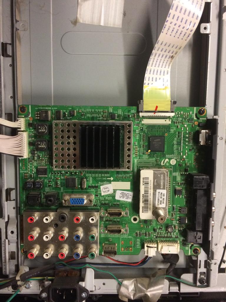

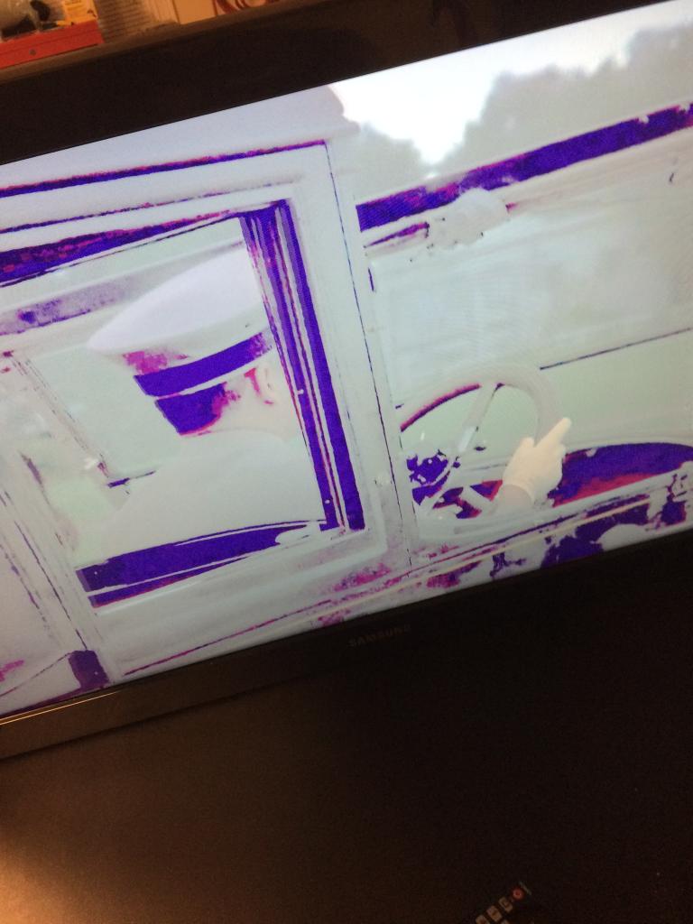

I have a samsung television that turns on and displays a picture but the picture is pink and green. I'm thinking the main board is going bad, but they are pretty expensive on ebay. Is there a component on the main board that I could replace?
samsung LN40530P1F image is pink and green
Re: samsung LN40530P1F image is pink and green

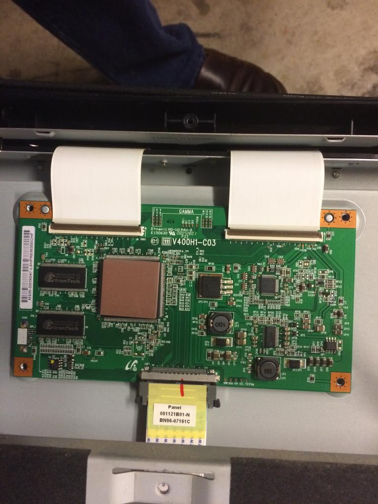

Yep, another bad AS19 (similar to AS15) GAMMA IC U7, I hope you do have tools to do SMD repair.
http://www.shopjimmy.com/cmo-35-d026047-t-con-board.htm
You can verify by checking and report the DC Voltage readings on the test pads of GAMMA Voltages from 1 ~17.
http://assets.shopjimmy.com/media/ca...6047-top_1.jpgLast edited by budm; 11-13-2014, 12:49 AM.Never stop learning
http://www.badcaps.net/forum/showthread.php?t=24809Comment
#3, #4, #7 are bad, the numbers should gradually go up.
tom66 has spread sheet that you can fill in the numbers and see the graph, I do not know where that thread is right now.Last edited by budm; 11-13-2014, 05:20 PM.Never stop learning

Thanks for the repair follow-up.
Where did you get the replacement board from, how much?Never stop learning
