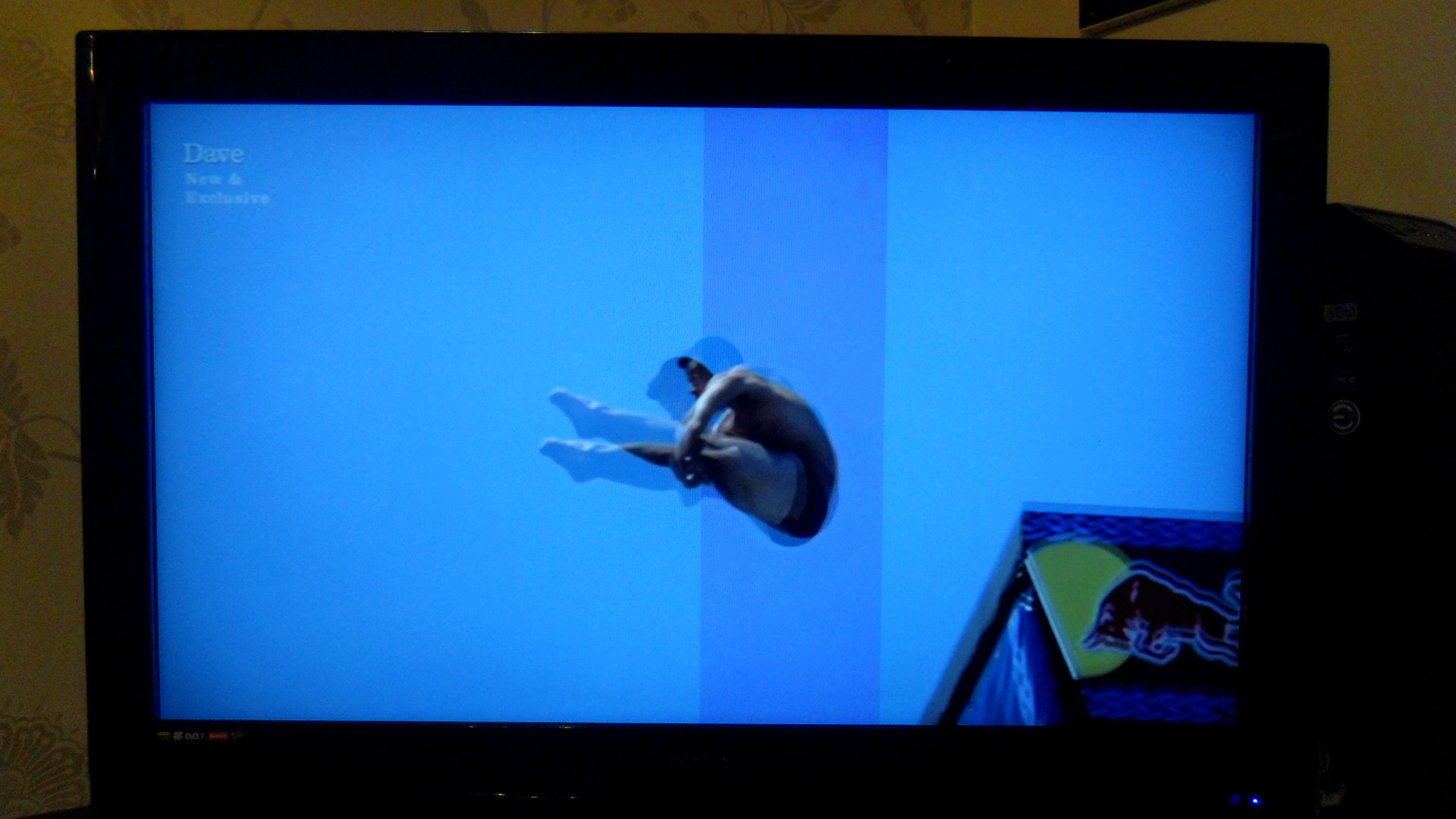

    I purchased this Technika 32-270 from a lady as faulty. She explained that when she split with her ex he tore the power cable from the back of the tv. I replaced the power cable that plugs in internally(not a kettle lead) and the tv worked but I noticed this fault with an approx 4" vertical line running from top to bottom just off center.
    Can anyone confirm my worst fears that it is a tab problem on the panel itself, or could it be a T-Con problem?

    Looks like a tab bond problem to me, but you could always try reseating the lvds cable

      Thanks for the reply selldoor. I've already tried reseating the lvds cable with no difference.
      Does a tab problem make this unrepairable? No chance it's T-con?

        Bad LCD panel in my opinion. Can try tabs - rarely successful on individual area faults though.

          Ok, thanks for the input. probably list this on Ebay for spares then.

            Since it's a Vestel, the PSU and main board are probably worth about £15-20 each.
              Re: Technika 32-270 Vertical 4" Line
              Ok, thats worth knowing. Not to bad as it only cost me £25 for the tv.
