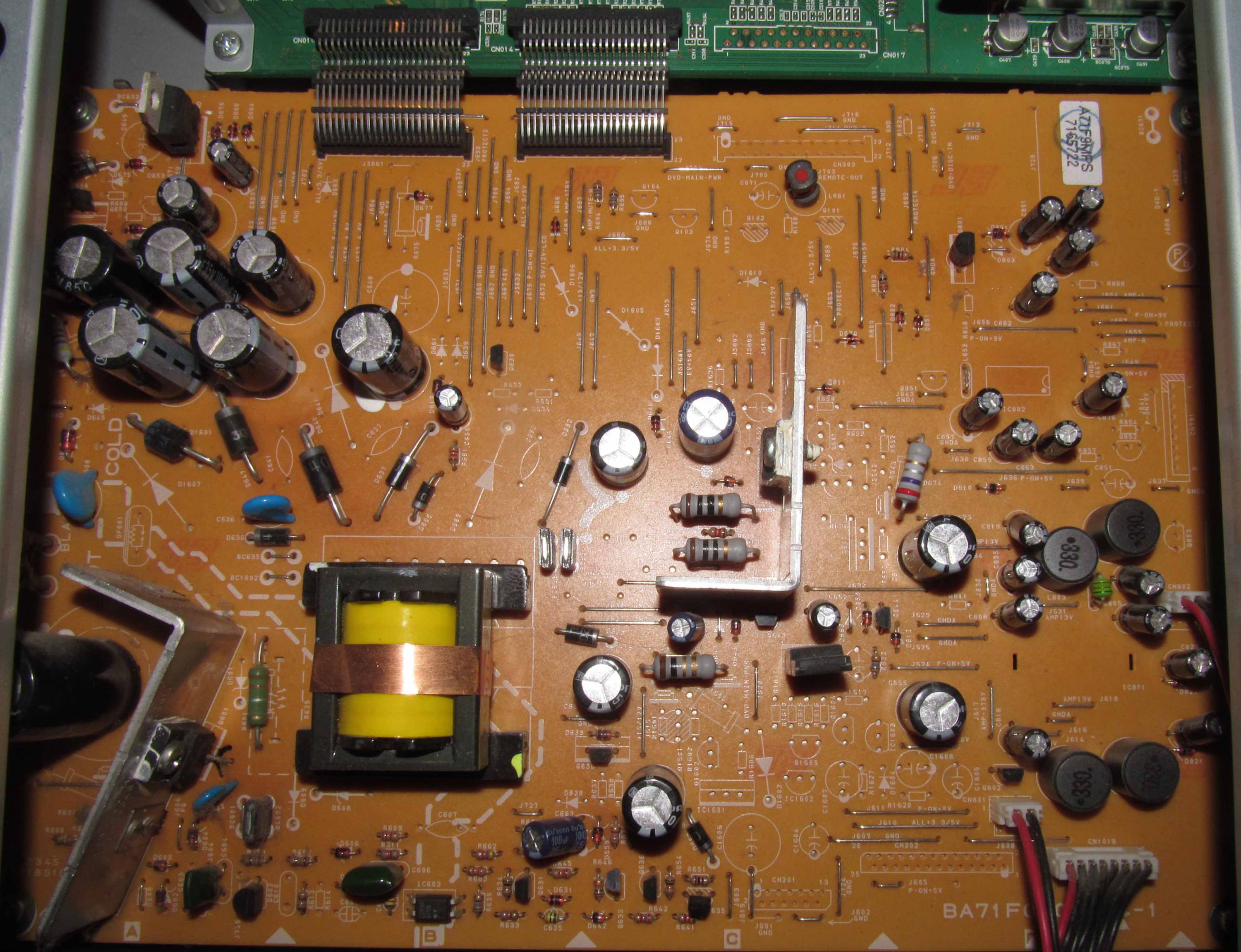

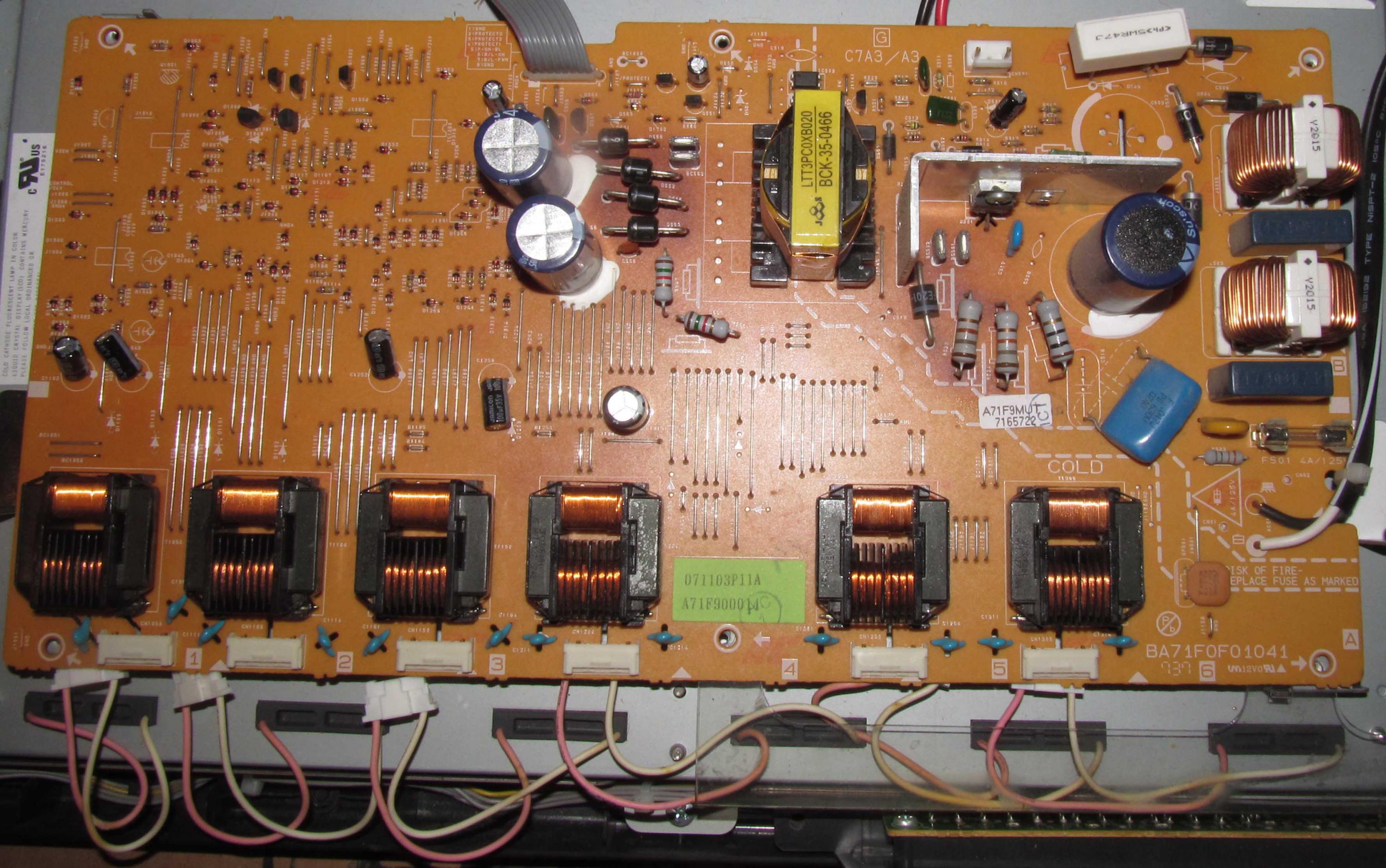

    Re: Sylvania LC320SS8 A turns on for a split second then black
    finally have it set up and opened.
    as you can see by the 2 images i've uploaded there are no bulged caps. i tested for shorted diodes (not the zener type) and output transformers all seem close to the same.
    i have a few cfl test lights and a spare ccfl from a 17" monitor. i did try various combinations, but it made no difference. i also have a dmm, scope, and esr meter.
    Better pictures can and will happen, when there is sunlight, which doesnt exist in the late pm.
    Not sure what to check from here.
                Common problem, the leads to the CCFL's are breaking down and arcing to each other. You can insulate them with liquid tape or silicone. If you move the red wire away from the white wire you can see the breakdown, or even turn off your lights and look for the arc, but be careful of your hands
                    thats the first thing i thought when googling. guess i forgot to mention it here. i had moved the wires so they wouldnt touch and still same result. i had 4 test lamps connect at once too, no difference.
                      Hard to tell from your pictures but a few of the wires from the inverter to the bulbs look to have arcing marks on them. Check out this post.
                          so, with further dis-motivation i set the tv aside for a good long while. i came back to it, on the bottom connecting to the corner pin #13 of a chip that the best i could try reading was ma9683 i found an exploded smd ceramic capacitor. i tried putting on another from a random board i had laying around (i have no idea how to tell value) but picked one of same size. the screen lasts almost two seconds now instead of less than half a second, but is still going black. all the output tansformers are good with ohms, electrolytics are good, regular diodes are good. no direct shorts on transistors.
                          bottom leftmost chip is one i am referring to, sorry for crap quality. i can get actual pic of board if you think theres a chance of getting it working. otherwise just tell me to forget it and i'll keep the boards for parts and toss the lcd.
                          • jasonbay13
                            • Jul 2014
                            • 185
                            • usa
                            : i decided also to try the test lights again, 1-4 first which ended up with no difference. 3-6 it stayed on while the lights flashed like a strobe light, going to 4-6 the same happened, but strobed quicker. i tried going further by doing 5 & 6, but it shut off after a second, looks like if i have any of the ccfls plugged into 4,5,or 6 it shuts off. but with test light it stays on and strobes.
