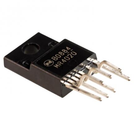

I powerd on the PS with 1,2 A fuse in place of FR929 as budm told and fuse blown and burned smell came from IC921 MR4020-7103
After that i replaced fuse (FR929) and without mains power connected i tested the resistance of IC921 and it is 28 ohms...
So this IC is dead i suppose and hard to find for replacment ?
In a store i looked i found only the one in first picture below(the burned out is second pic with long legs)
Will this work for replacement if i use wires to connect all legs as the old one ?
I have replaced it with same IC but diferent pins
Picture below is the replacment ic i used
