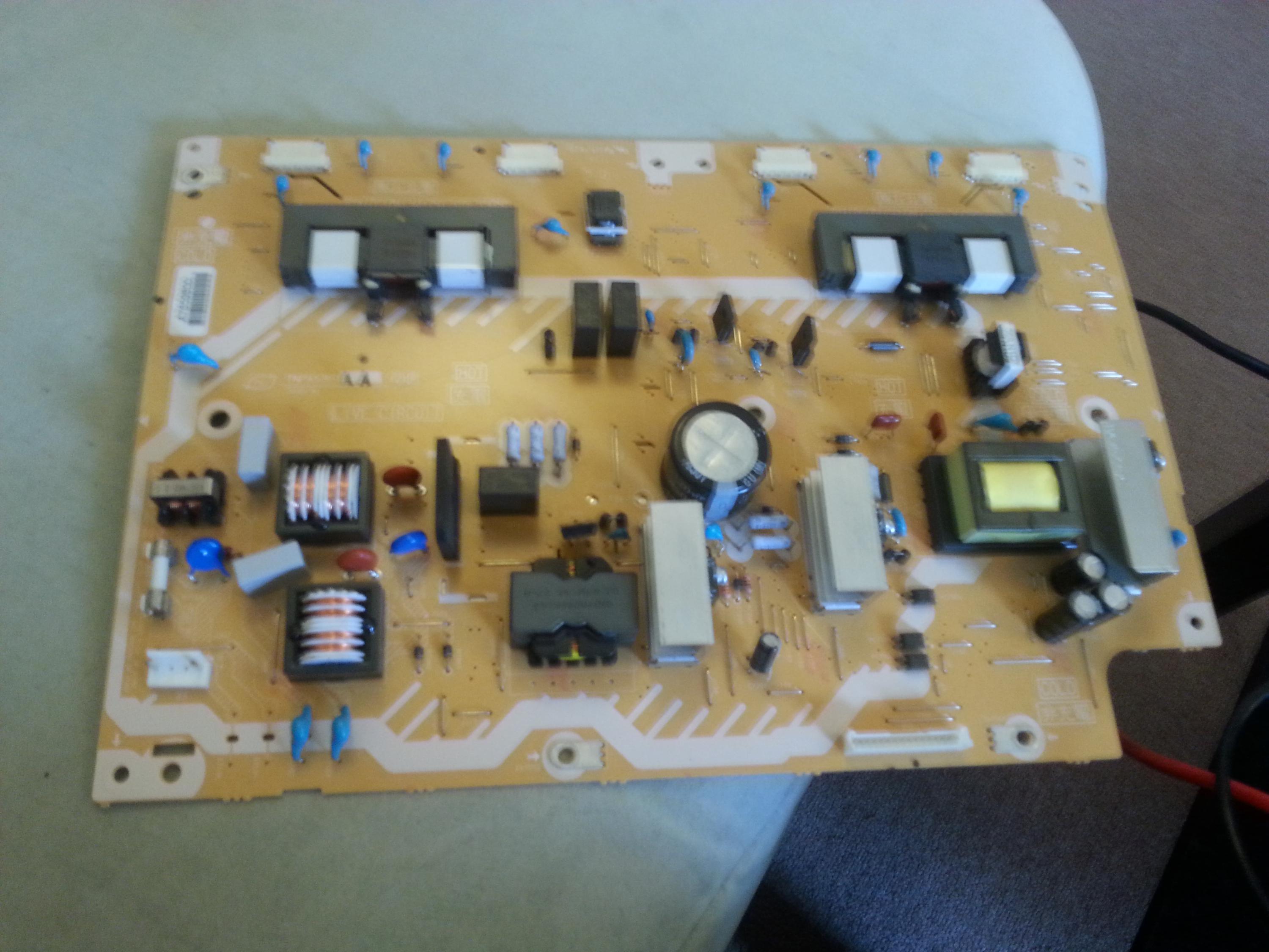

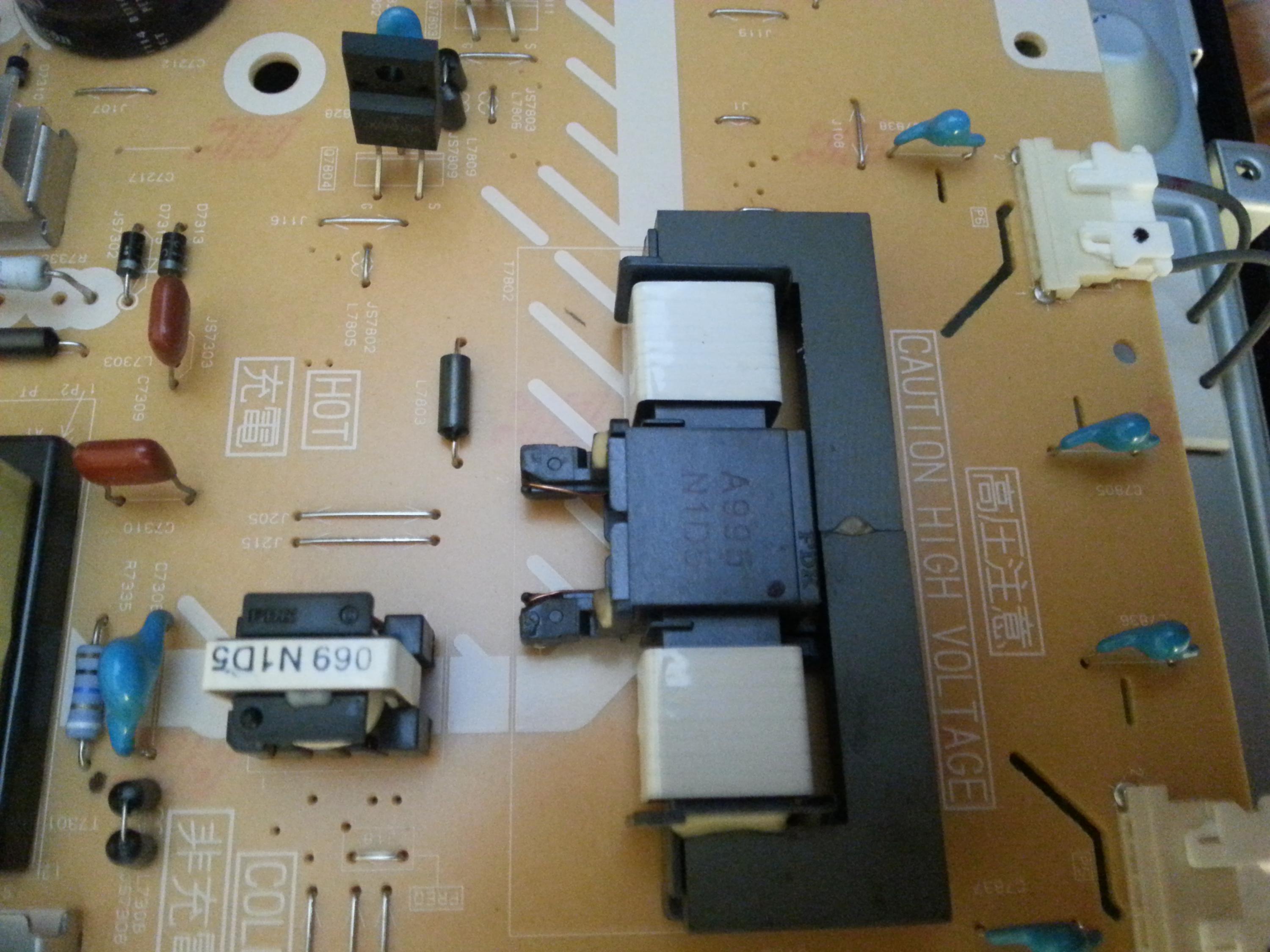

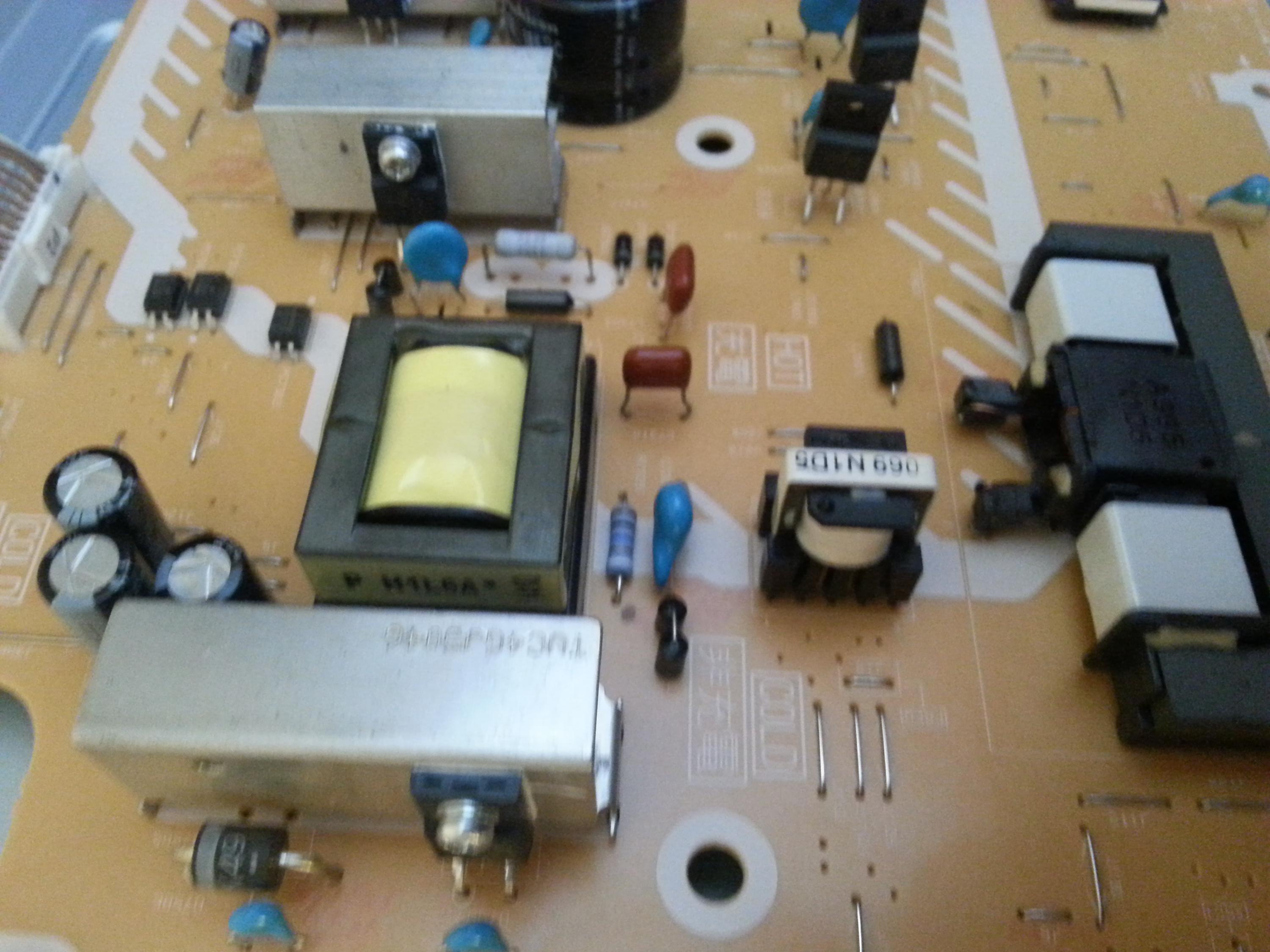

        Re: Panasonic TH-L32C30Z troubleshooting
        Here are pics of the p. board and the components that are buzzing on the P. board. I haven't got a pic of the other board at present will need to open up when i'm at home.

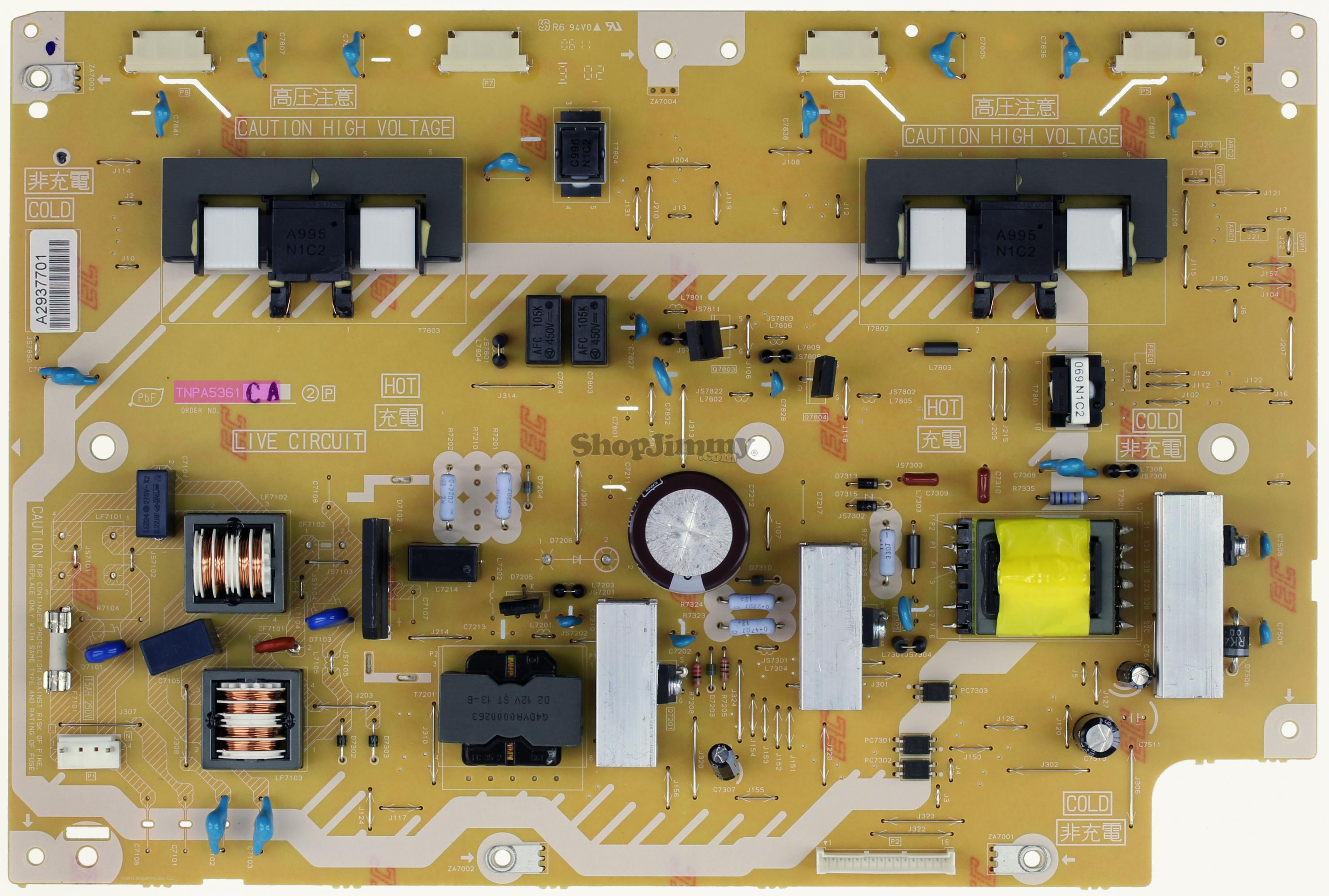

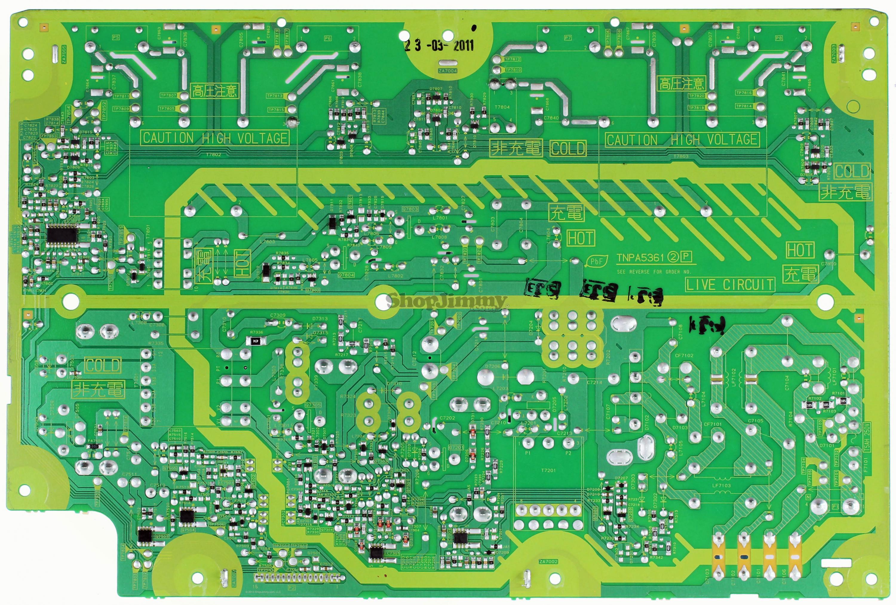

          Fitted to TC-32LX34 TC-L3232C TC-L32C3 TC-L32U3 TC-L32X30, could try searching the models or board version and see if any faults have been reported here?
          Yours is TNPA5361AA, I saw one in malaysia but not cheap on Ebay,
