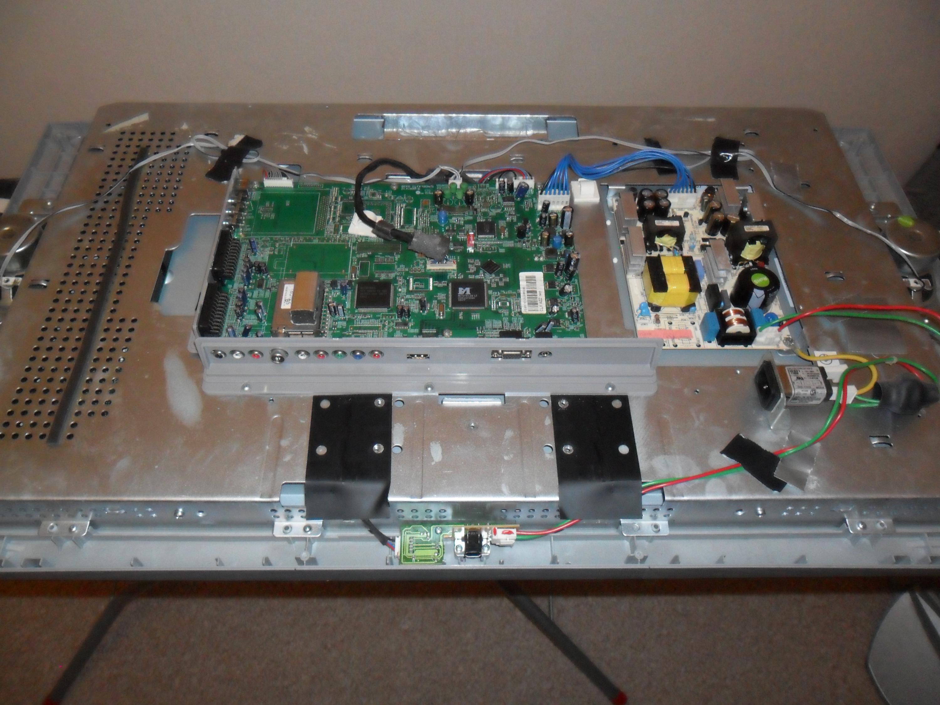

            Ok take some close up pics .
              Re: 32 inch lcd sound no picture

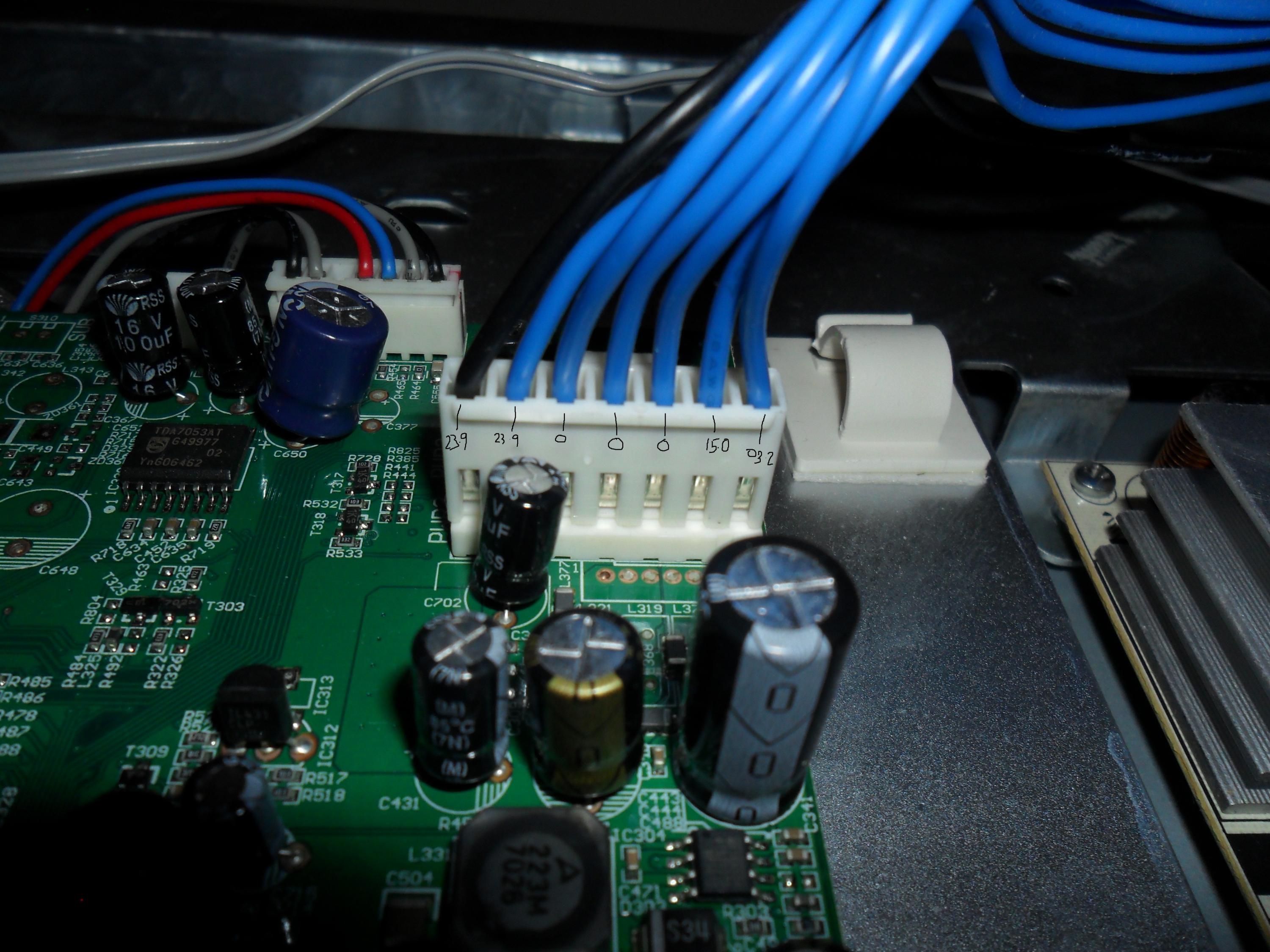

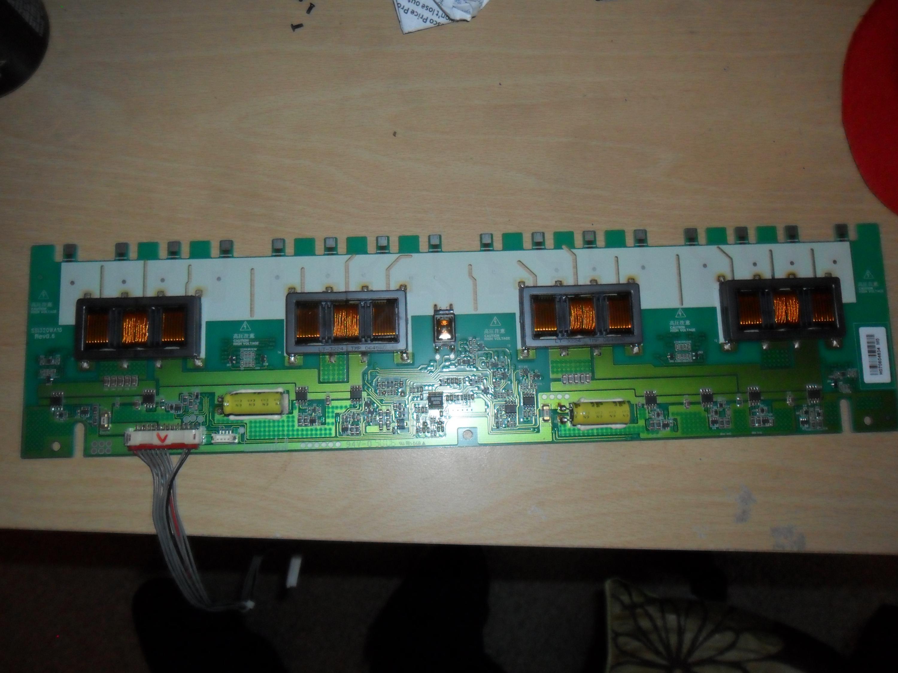

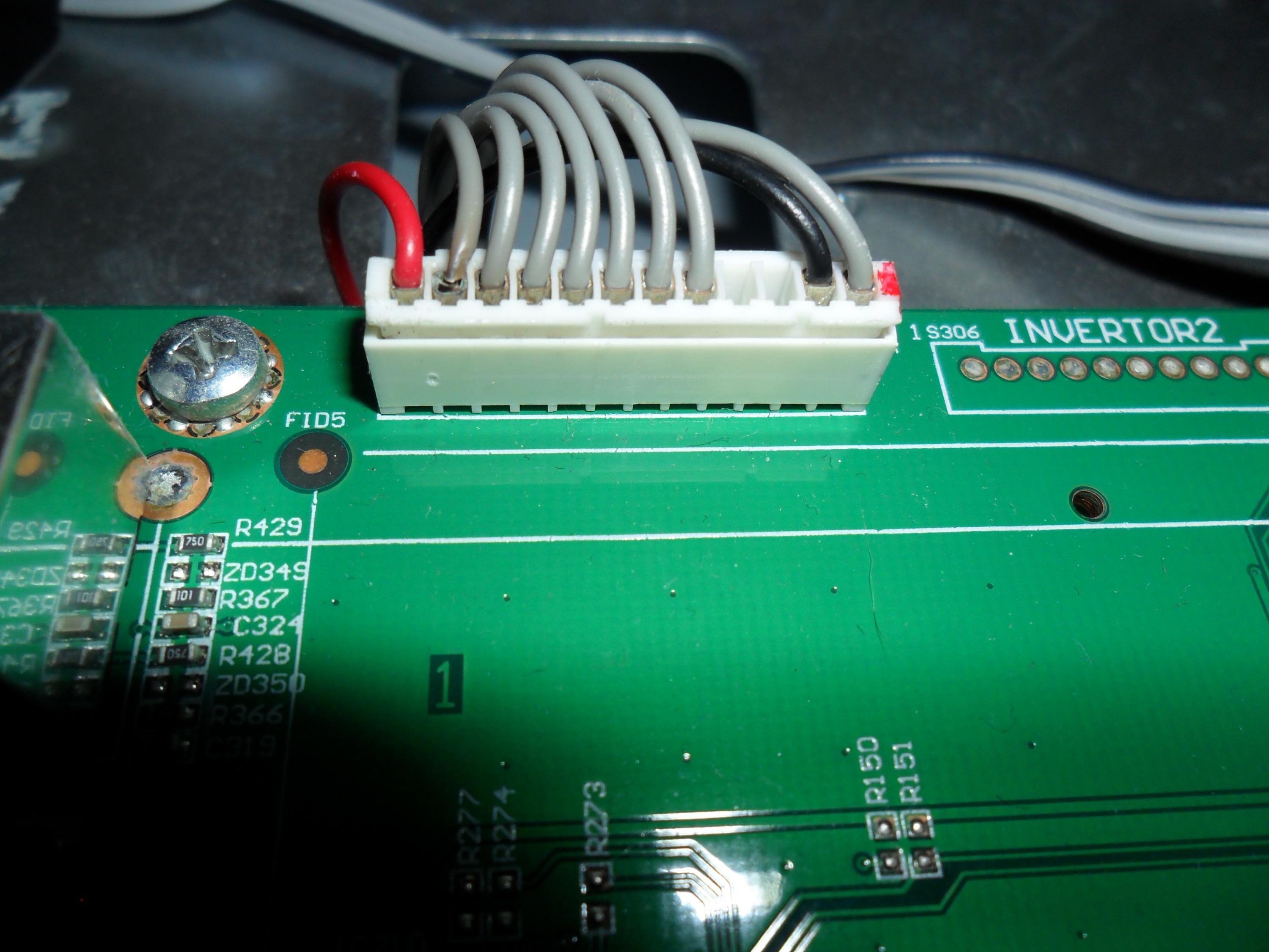

              so these are some pics as you can see in the inverter cable at the top of the mainboard not sure if that looks like a burnt cable second from the end,could that be the cause? as you can see there is no way to test the inverter while its connected to the mainboards as it is under the main chasse.i took a picture of the old inverter i pulled out.can i check voltage from mainboard to inverter from that inverter cable at the top of the mainboard.once again any help is appreciated.

                Check if the psu and motherboard are giving voltage to the inverter, dont test the inverter only test the connectors coming off the psu/mainboard.

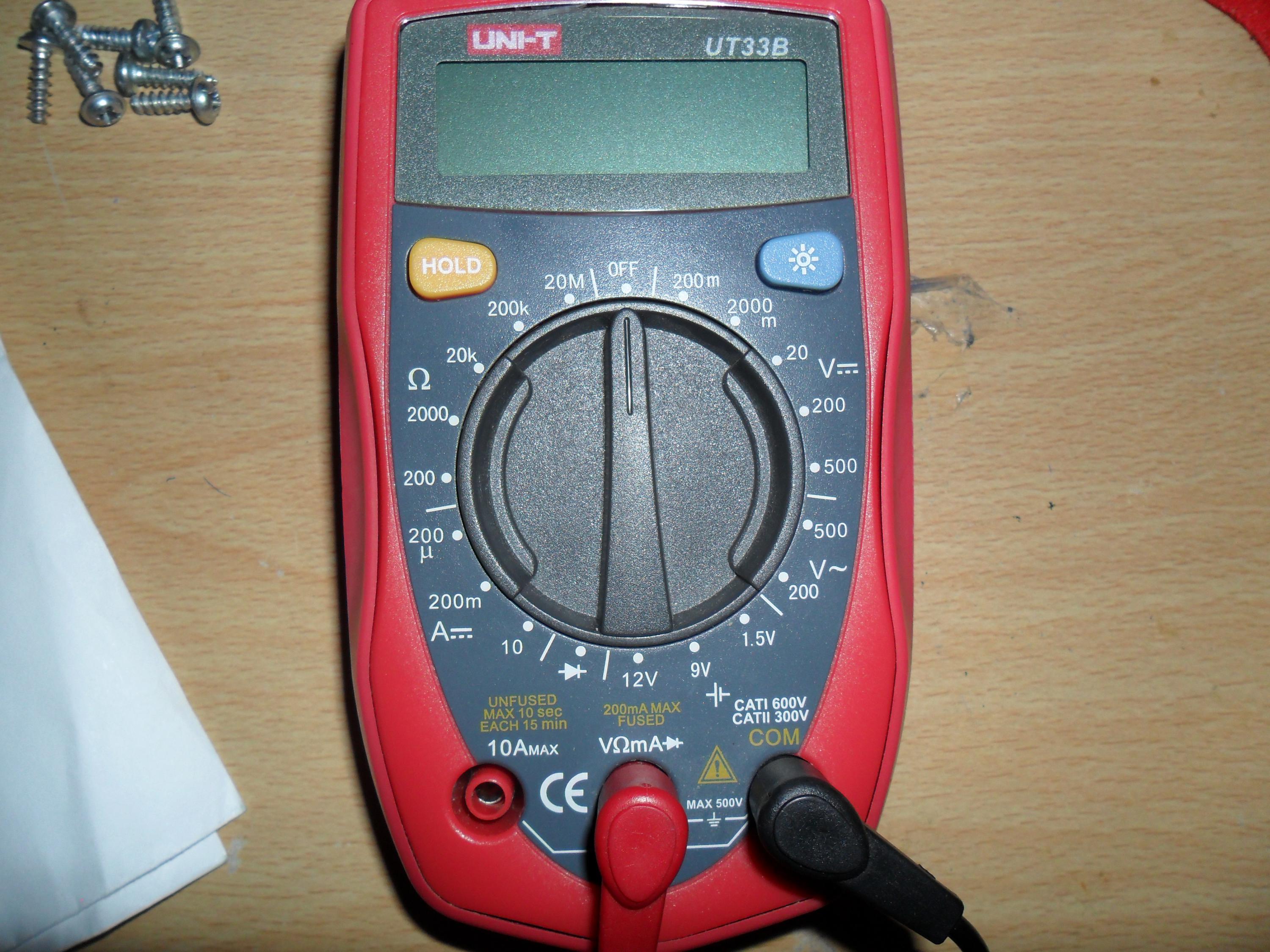

                    Can you take a picture of your meter please just help clarify things better.
                      this is my multimeter.as i say i am new to this kind of operation i have repaired things like ghd cables ghd fuses iphone screens but there basicly taking things apart and replacing voltage troubleshooting is all new to me i do appreciate your help on this

                        picture 6 the plug/socket with the damaged wire can you pull the wire block out and check the pins to see if they are melted or damaged.
                          took the plug out of the socket and the pins on the mainboard are fine as are the clips inside the plug.is there a way to cut that burnt looking cable back and reinsert it into the plug.looks like its hanging on by a thread.

                            To test that cable simply set your meter to ohms and the probe on one end of the wire and on the pin out on the bottom of the inverter and see if the ammount of ohms changes this will show if there is a connection or not make sure the set is off, also pull the wire block out of the connector and inspect it physically then resolder it if it is loose.

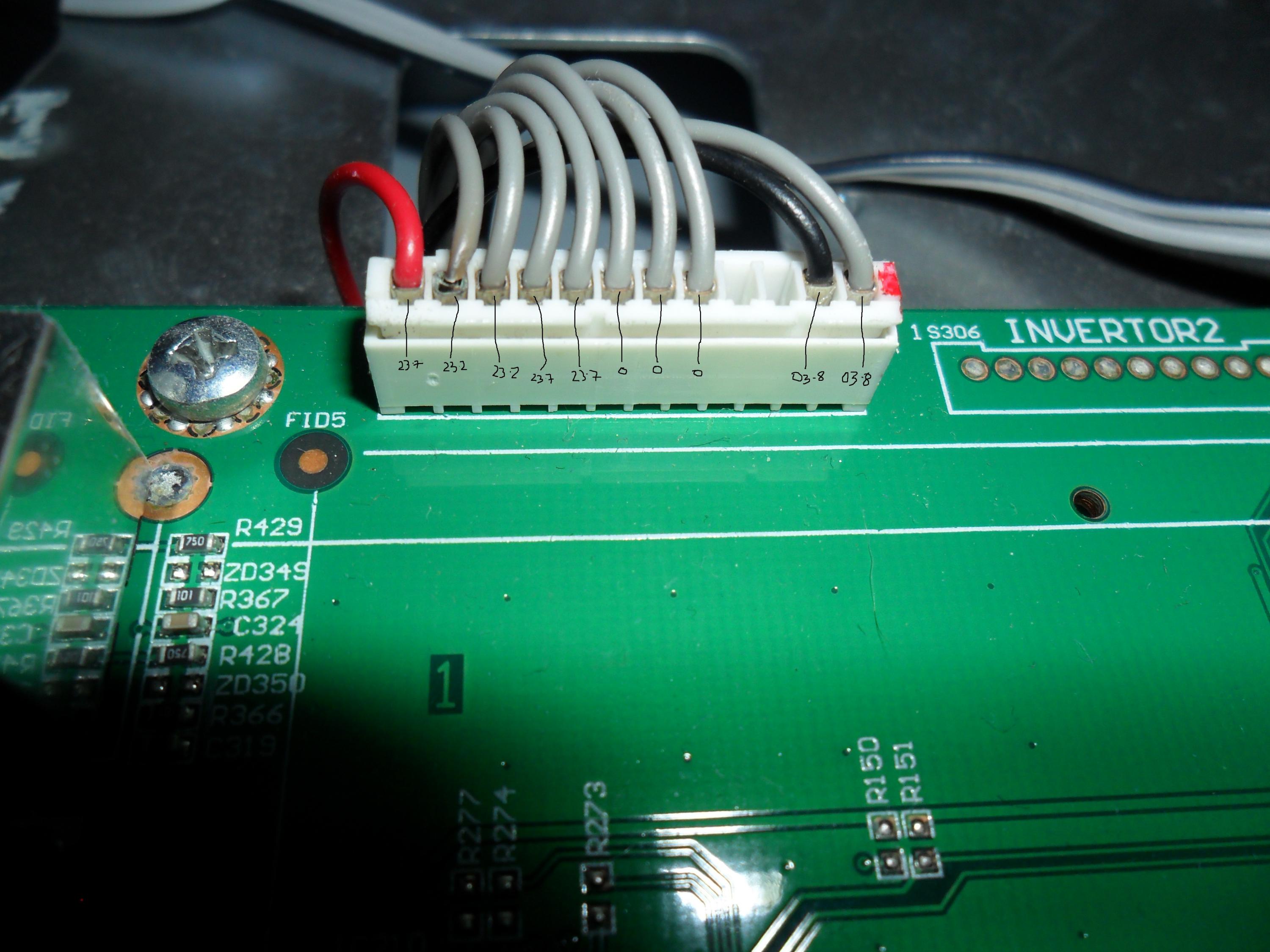

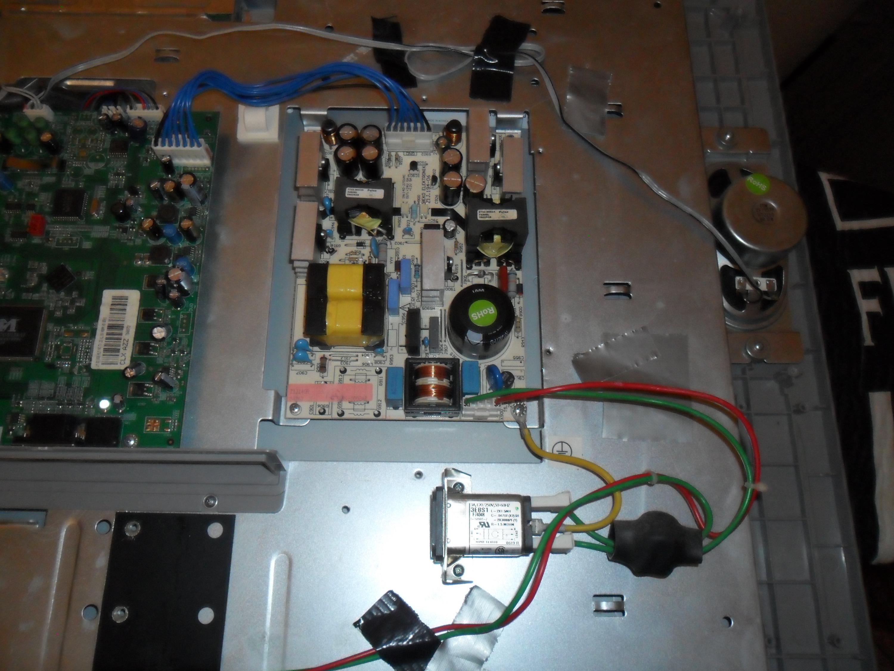

                              Ok now put the inverter back in and set your meter to 20-200v dc then put the black probe to a ground then use the red probe to see if there is a voltage going though the connectors to the inverter while the set is on, can you get the model numbers of the psu ect and I will find a pin out diagram and show you where to test.

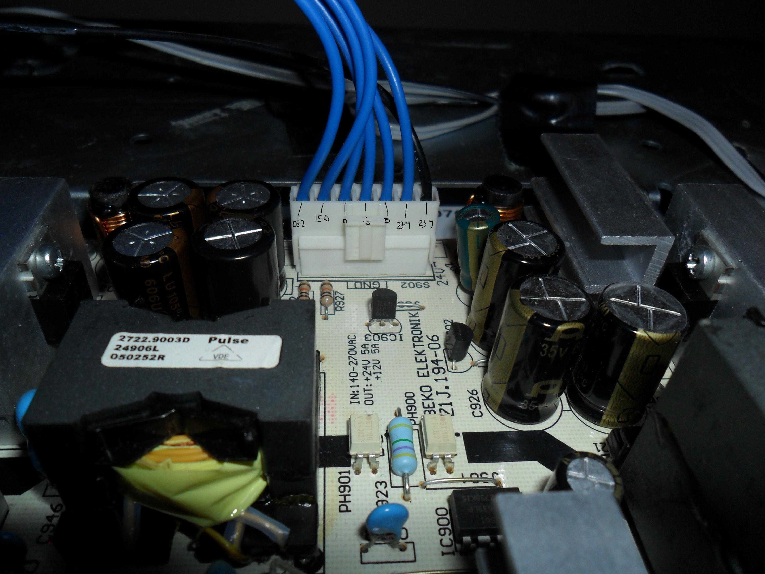

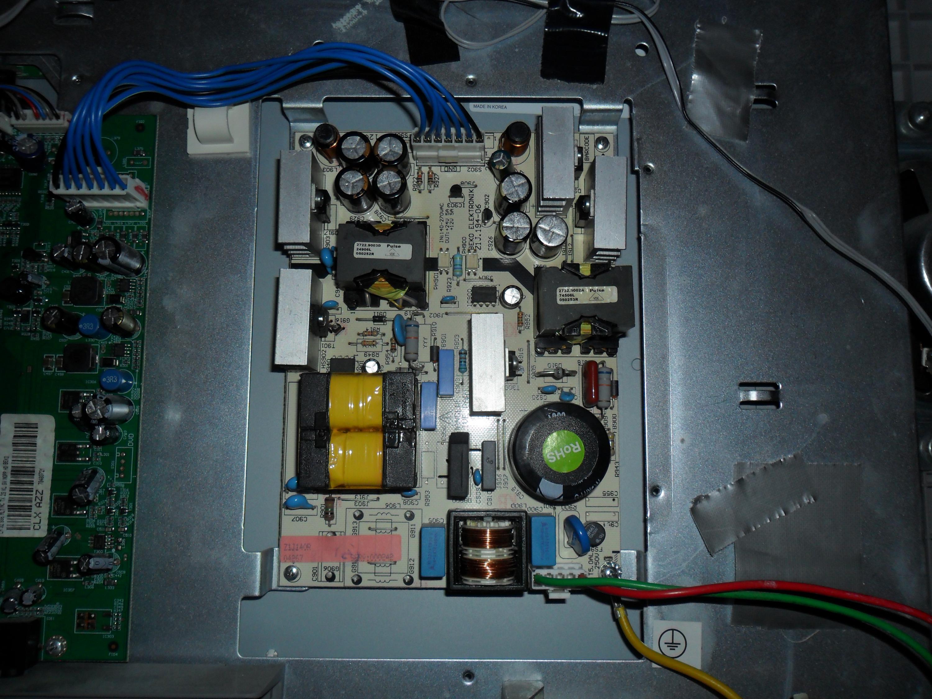

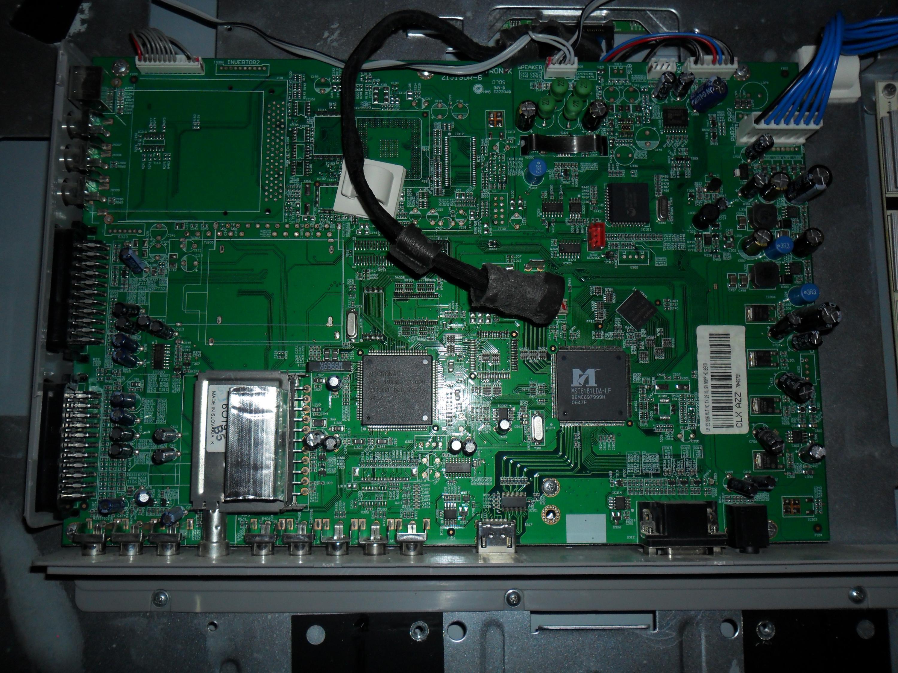

                                ok took some voltage readings hope you can read them.this was with the tv on.
                                picture 1 is the inverter plug on the mainboard
                                picture 2 is the psu
                                picture 3 is the mainboard from psu
                                  hope you can read the readings

                                        So those Voltage readings on the inverter connector as shown when the backlights are not on?
