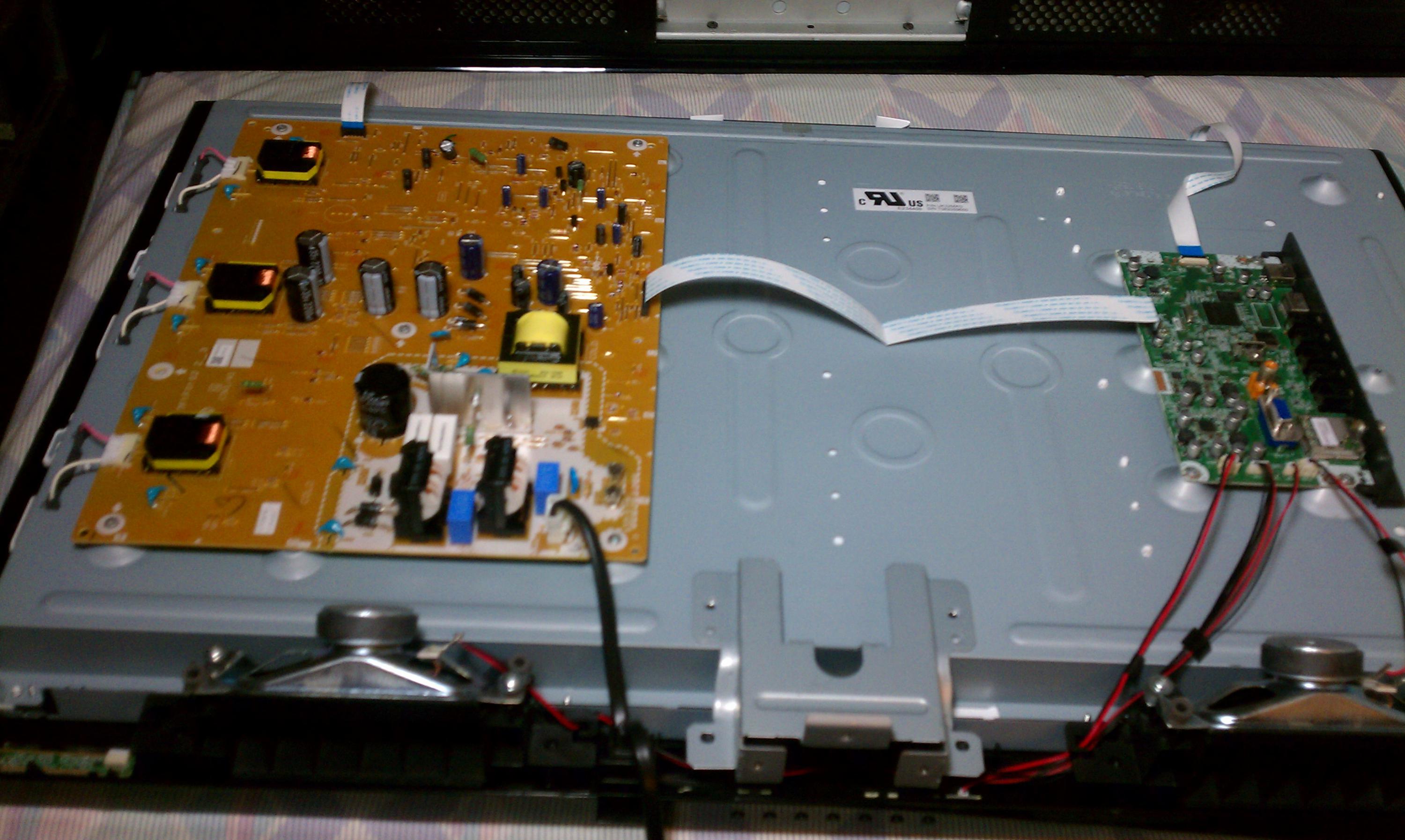

    picked up a few more tv's today and started on this one first.
    on the front it says magnavox, but on the back it says funai.
    when i got it, it had no standby light and did not respond to pushing power.
    i opened the case and realized first thing that the fuse had blown.
    i was able to find a similar fuse lying around so i figured i'd take a chance.

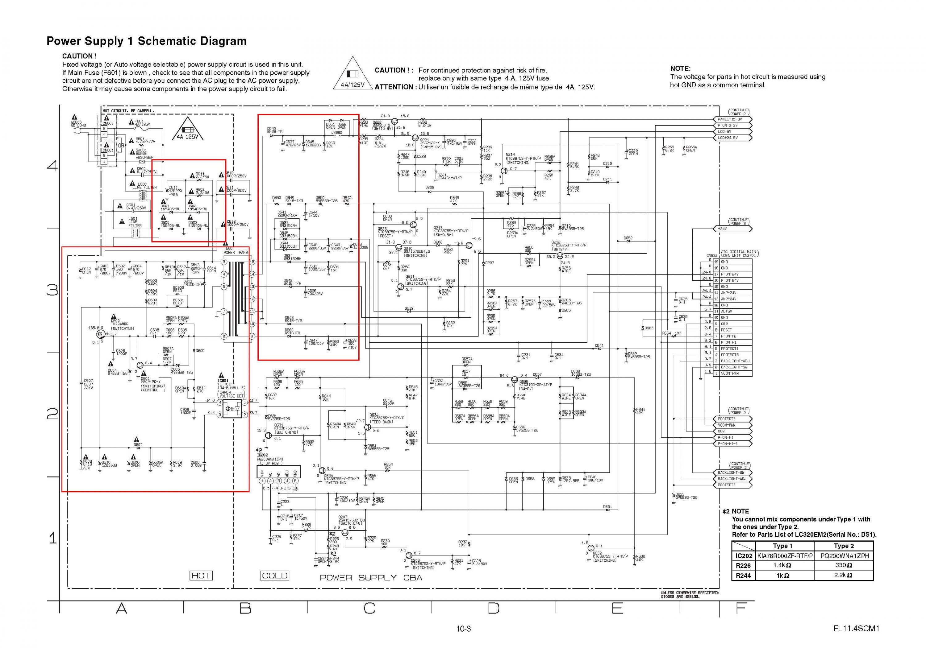

    anyway i was able to find the service manual and in the diagnosis flow chart it does have a couple things to say about if its blowing fuses...
    it says two things:
    "Check the presence that the primary component
    is leaking or shorted and service it if defective."
    and
    "Check the presence that the rectifying diode or circuit
    is shorted in each rectifying circuit of secondary side,
    can someone tell me what they mean by "primary component" ?
    and i guess im supposed to know what the rectifying diode or circuit is, but i could probably use a little help there too...

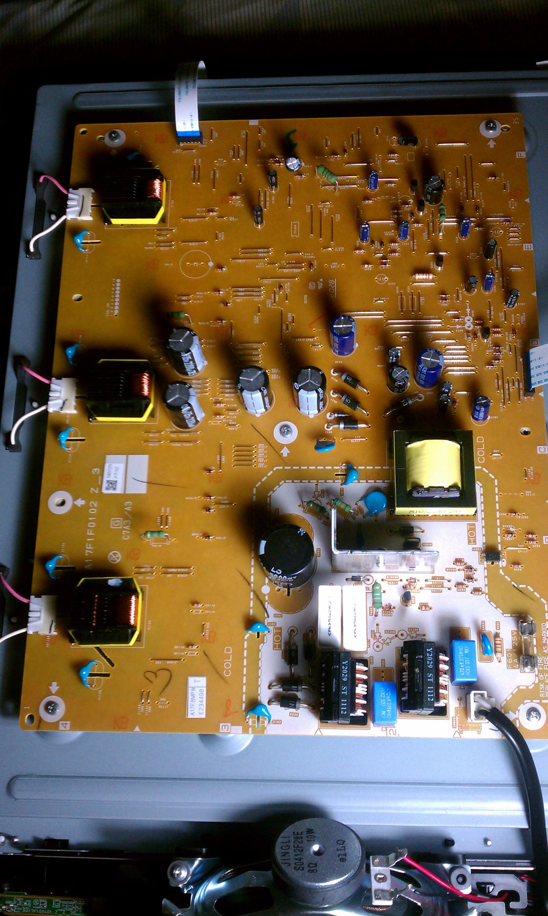

    i started checking diodes and i did notice one that seemed to be shorted (reading 0 resistance both ways) but ill have to lift a leg to be sure.
    this power supply is so huge and strange looking.

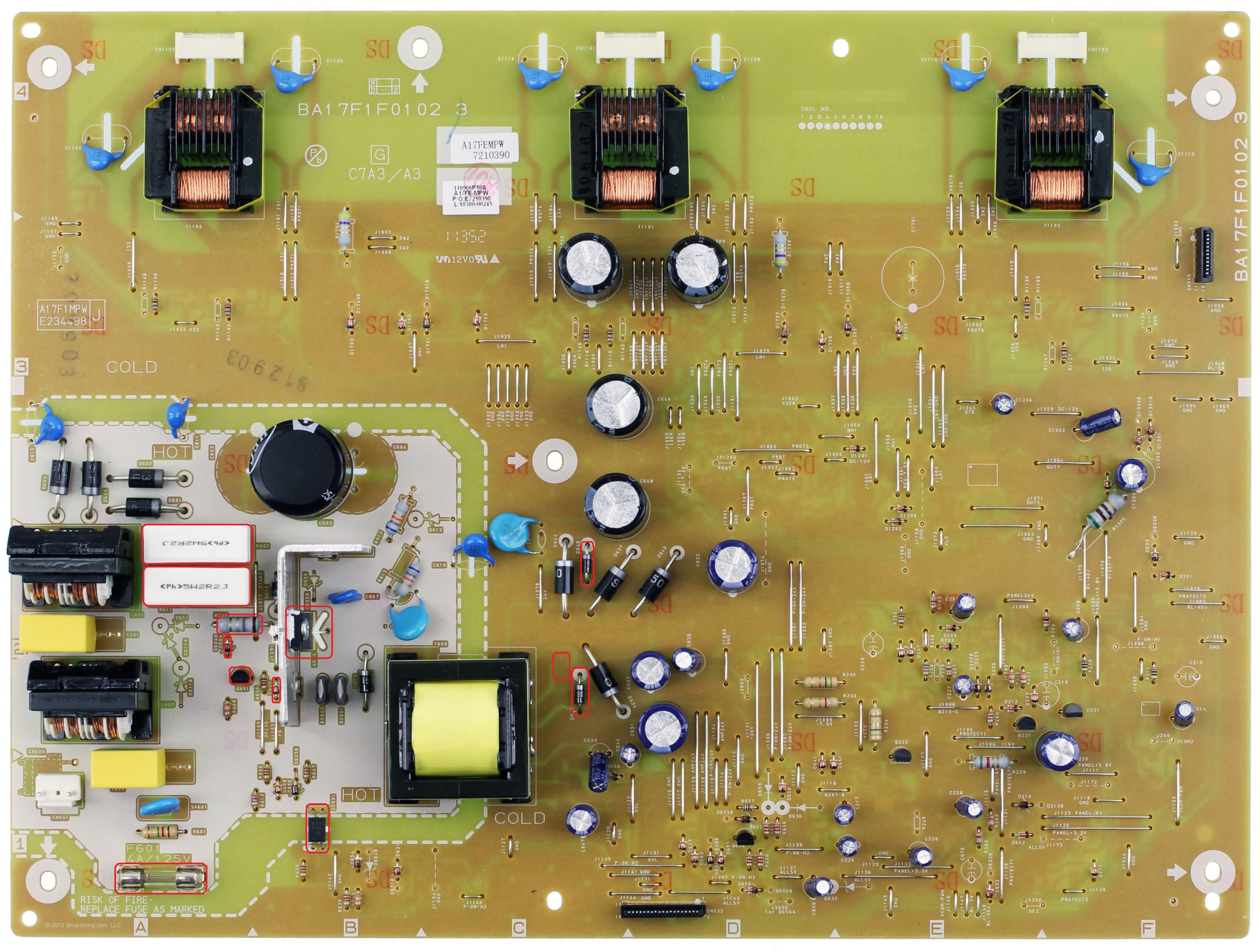

    The primary transistor is the thing on the little heatsink next to the large yellow transformer. What a sad, empty looking PSU though.

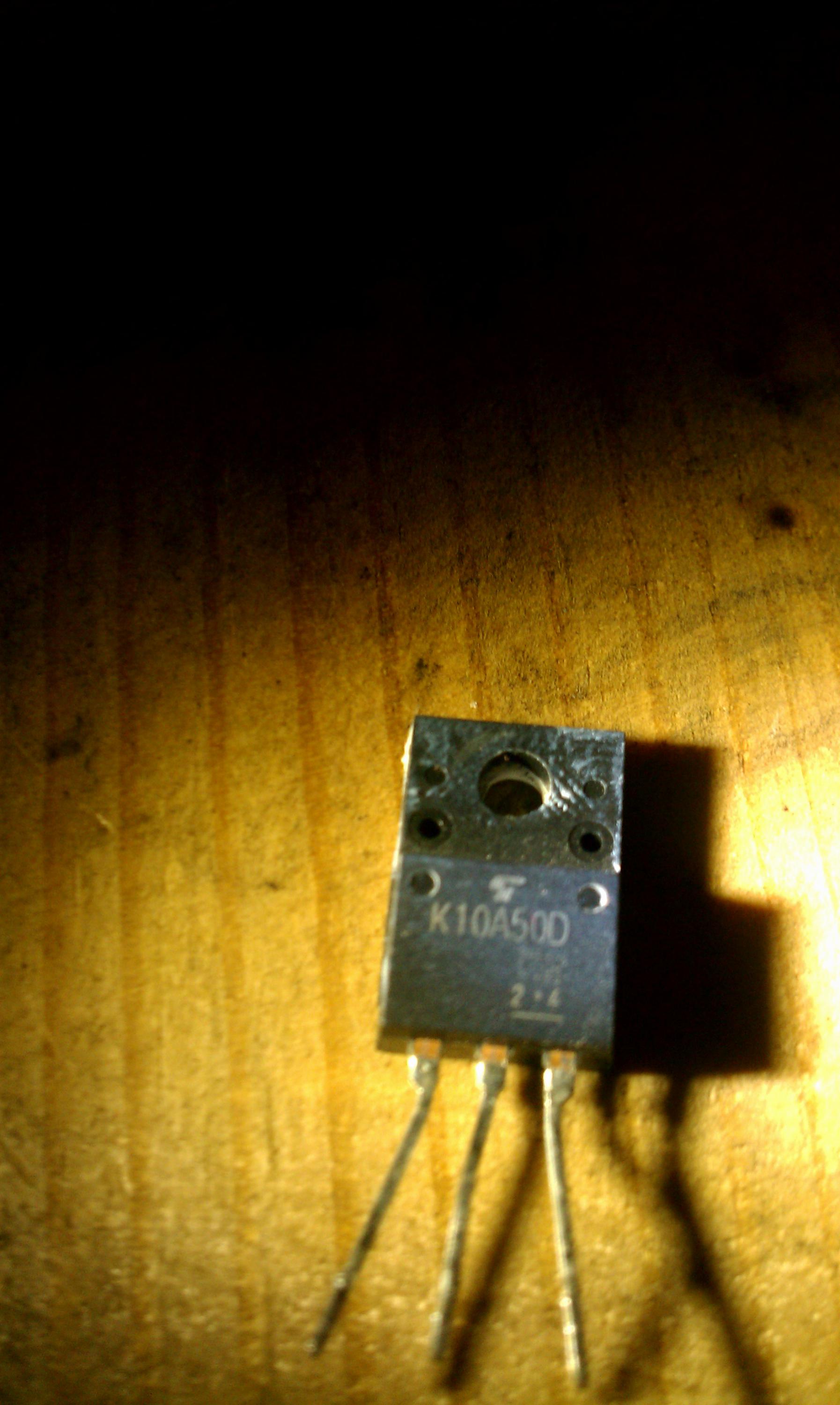

      i know, right? all that space and just a few components...mostly diodes and resistors...theres only that one transistor so naturally i took it out and tested it.
      it has shorts from all 3 legs to each other...im guessing that means its no good.
      im hoping i just replace this transistor and fuse and ill be fine? what else can i test to be sure i wont just blow the transistor again though?

        q600 will be shorted, d604 will be shorted, d640 on back of board will be shorted, d610 maybe shorted, you will also probably need to replace q601, several of the other zeners may be bad as well, you should also check those two big cement resistors as well as the low value resistor near d604 for opens. big thread on this power supply HERE When you order up replacements get spares.

          You need to check evrything (diodes, transistors, opto, resistors etc) in those red section.
          This is very similar circuit that is used in the Sylvania that you are still working on.

                ok q600 was shorted as i said
                d604 was shorted
                d640 reads shorted but i didnt desolder it yet
                d610 i lifted one leg, seems to be fine on diode check i get 707 (what does that mean, voltage drop?) one way, and infinite the other way..

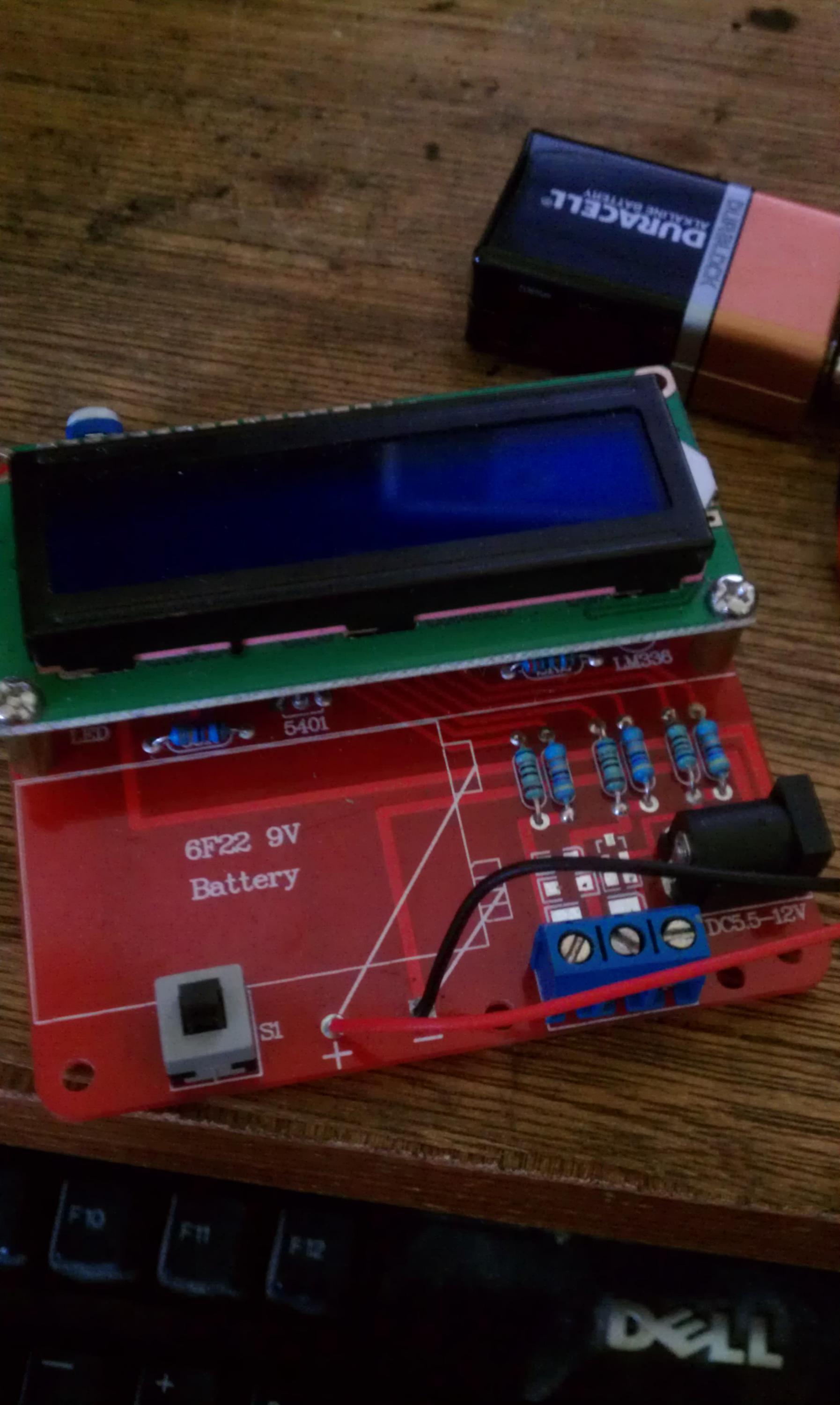

                i removed q601 and tested it with my test thing (the kit i built that can test capacitors for ESR and also tests transistors and mosfets and stuff)
                but i still dont really understand the numbers it gives. one reading i got called it an NPN and another said its a Diode... guess i gotta find the datasheet
                markings: C 5344 Y201

                    when my meter reads it correctly as an NPN, it says
                    B=19 and uf=533mv
                    not sure what to read in the datasheet to verify this....

                      I am not familiar with your meter so I have no Idea what the:
                      B and uF are for when testing the transistor.

                        yea this kit really came with no instructions except how to build it and how to use it, but not any description of what the readings mean in certain non obvious situations...
                        i know others have bought this kit, and maybe know more about it...
                        any other easy test i could do on this thing?

                          I was able to sub a bc337 for that transistor, I have a cricket transistor tester and it looks at gain as well as leakage. Both of the last two sets I repaired had good gain on that q601, but both failed the leakage test. I think when the mosfet shorts it passes too much voltage to the transistor and causes damage to the junction. if you use the bc337 you will need to insulate the emitter and wrap it around the back of the transistor to get the correct pinout.
                          Make sure you check all these parts
                          Q600- TK10A50D mosfet
                          Q601- 2sc2120y transistor
                          D604- 27v zener
                          D610- 36v 1w zener
                          D609- 4148
                          D640- rectifier diode
                          D648- 36v 1w zener
                          D645- 22v 1w zener
                          R602- 2.2 ohm 5w
                          R611- 2.2 ohm 5w
                          R608- .18 ohm 2w
                          Fuse
