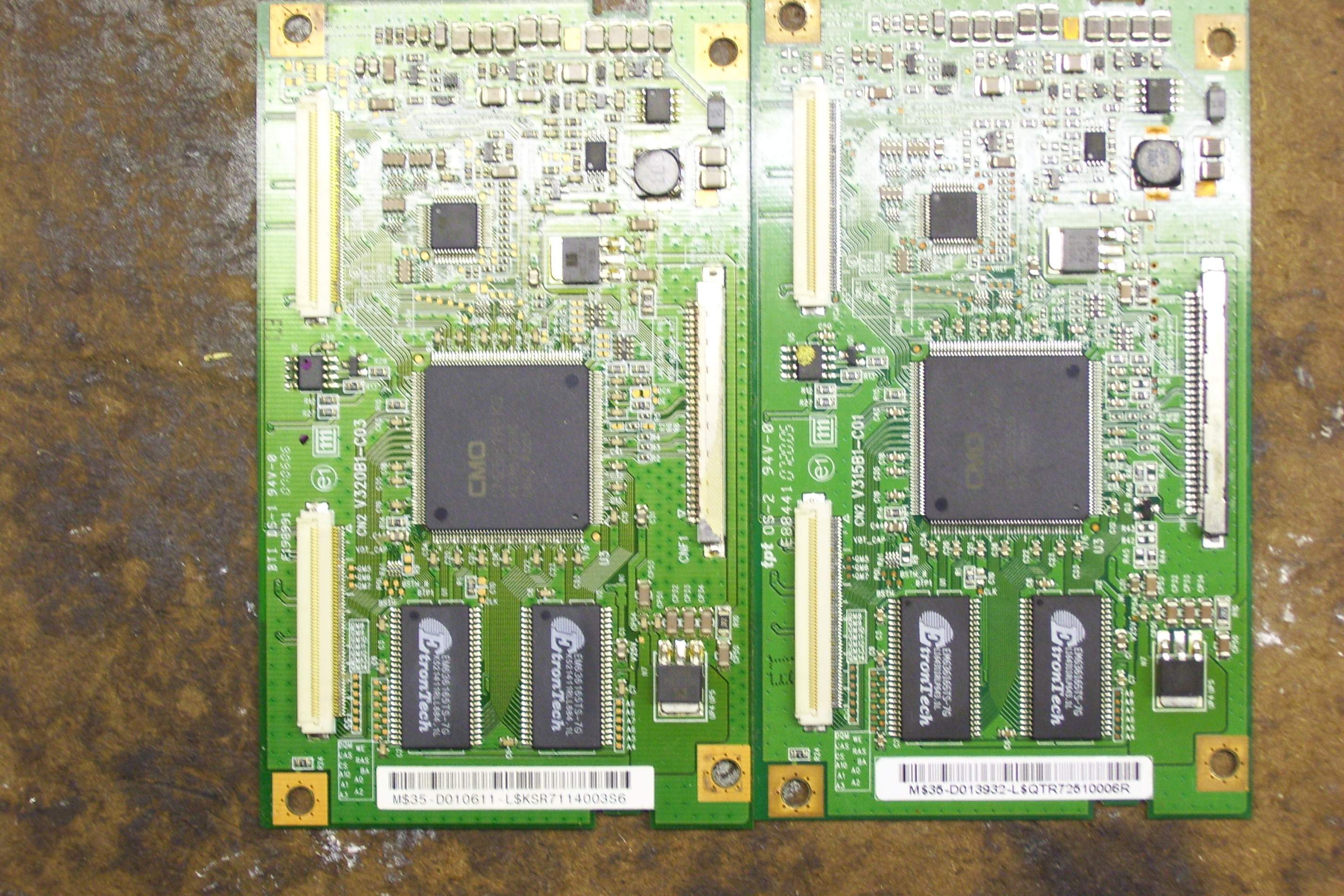

    I can't find anything online so I'll ask here
    I have 2 cmo tcon boards v315b1-c01 and v320b1-c03
    What I want to know is if these are interchangable
    I know they are supposed to match up with panel numbers
    but these boards look identical the main cmo chip numbers are the same
    except for the last row of numbers that I assumed are lot or date codes.
    Is this chip programed for the differnt panels and therefore they are not interchangable or can i luck out and they would work.
    I have seen some tcon boards that had a smd resistor soldered on
    different pads for different sized panels ie 32 or 40- etc and so i thought
    that maybe these 2 boards are the same or am I just nuts and out of luck
    Re: T-con Question
    315 is for 31.50" LCD panel.
    320 is for 32.00" LCD panel.
    What is your panel sticker? 315 or 320?

      Thanks for the info that is great to know.
      I am just keeping some boards as spare's since I salvaged them from tv's
      I get from a recycling place. these boards are in several brands of tv's
      so I thought it would be good to keep as a spare
      I might be able to use them in future tv's. I never thought about the exact panel
      size now I know that Thank you very much
