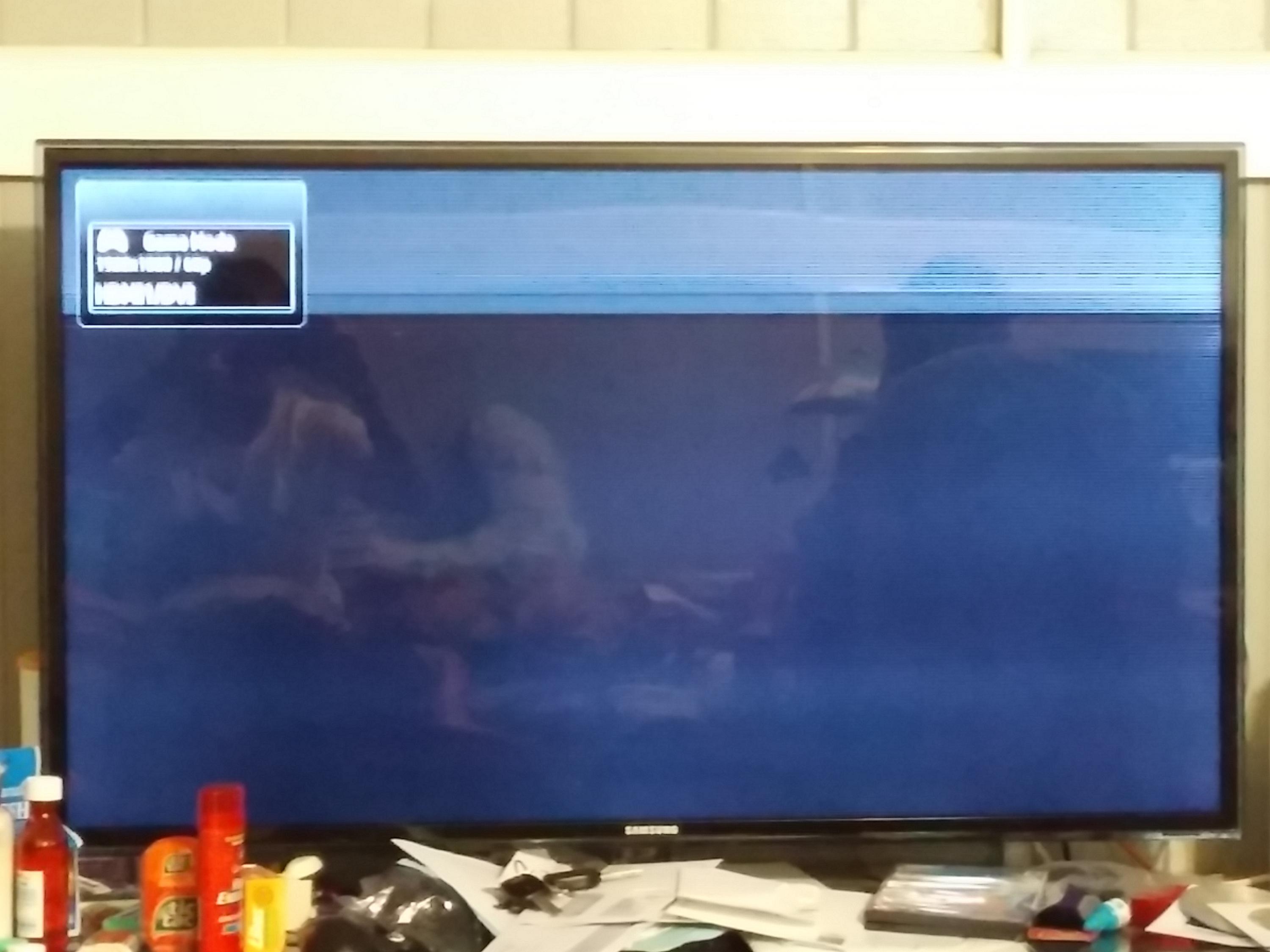

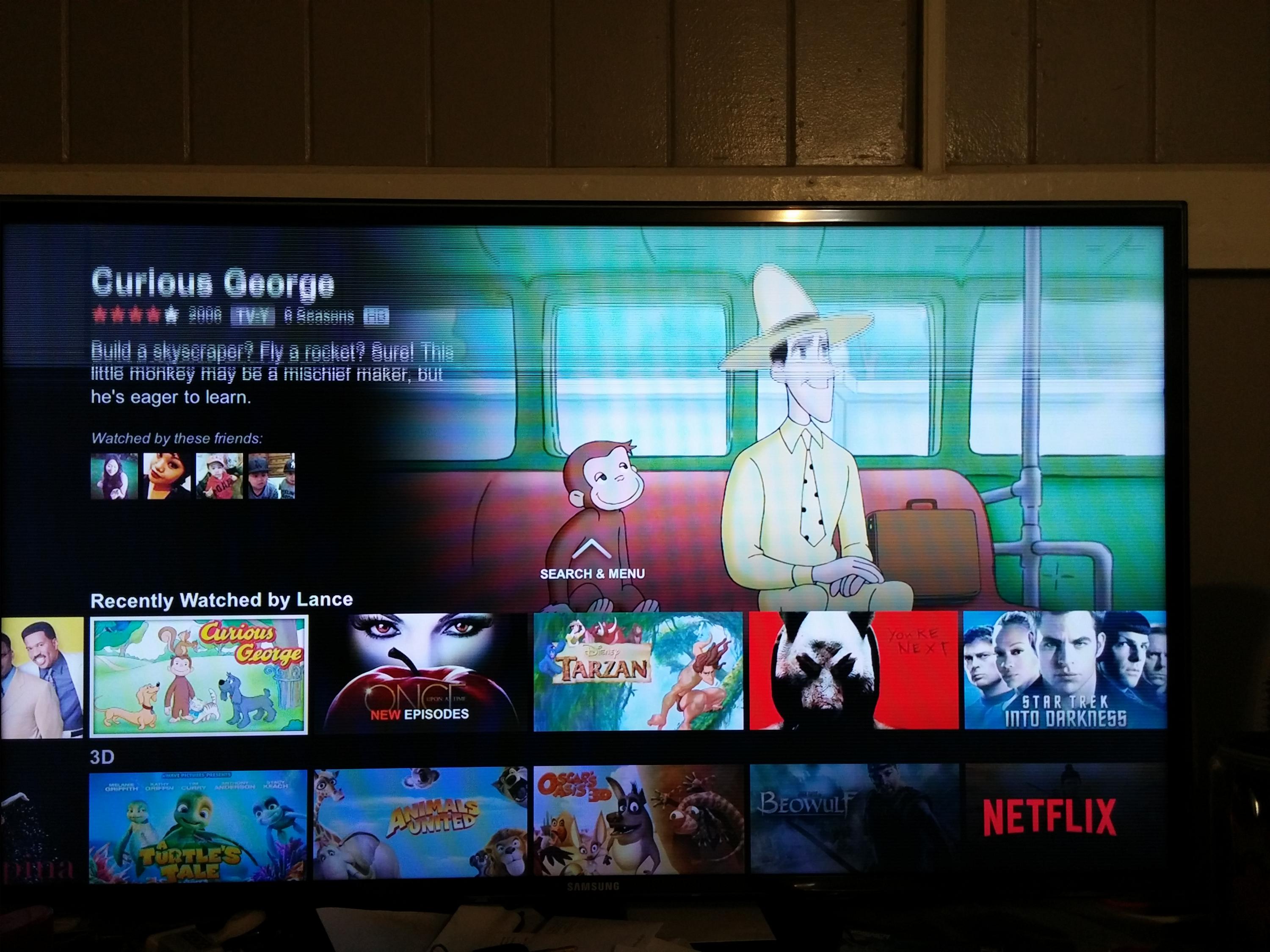

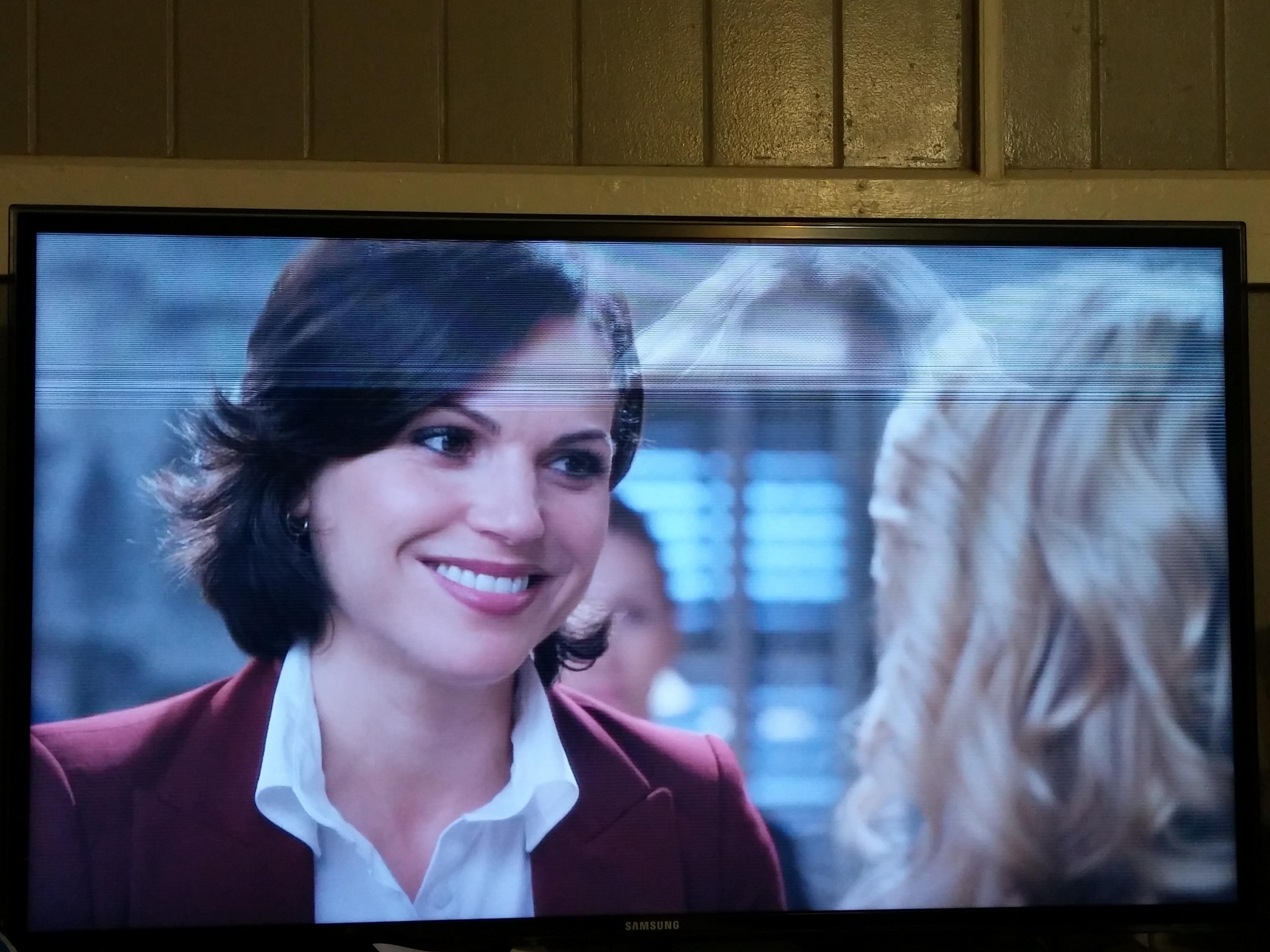

    Good day,
    I am trying to determine the cause of what is causing the lines and ghosting on my Samsung tv. The lines are always present. Ghosting can be seen 1% of the time. The line and ghosts only appear on the top 1/3 of the screen. I have not taken the tv apart yet so I only have pictures of the screen.
    There is also a round bright spot in the right edge at the bottom where the lines start showing. Sometimes the spot is black and shows no picture.
    Any help determine the problem is greatly appreciated.
    Re: Samsung UN46D6420 Vertical Lines top 1/3 of screen. Ghosting sometimes.
    This is almost certainly going to be a bad LCD panel and not repairable. I'm pretty sure that's going to be the consensus on it from everyone. Probably not worth wasting any time on.
      Unfortunately the LCD panel in your TV has failed. This will not be economical to repair.
      This is a very well known problem with D-series Samsung LED-backlit LCD TVs. You MIGHT with persistence be able to get Samsung to compensate you on a replacement. However, doing so may be like trying to get blood out of a stone, and they'll usually only give you credit on another Samsung product (given the ES and F series LED-LCD TVs also have a lot of panel failures, it's probably worth avoiding them in future.)

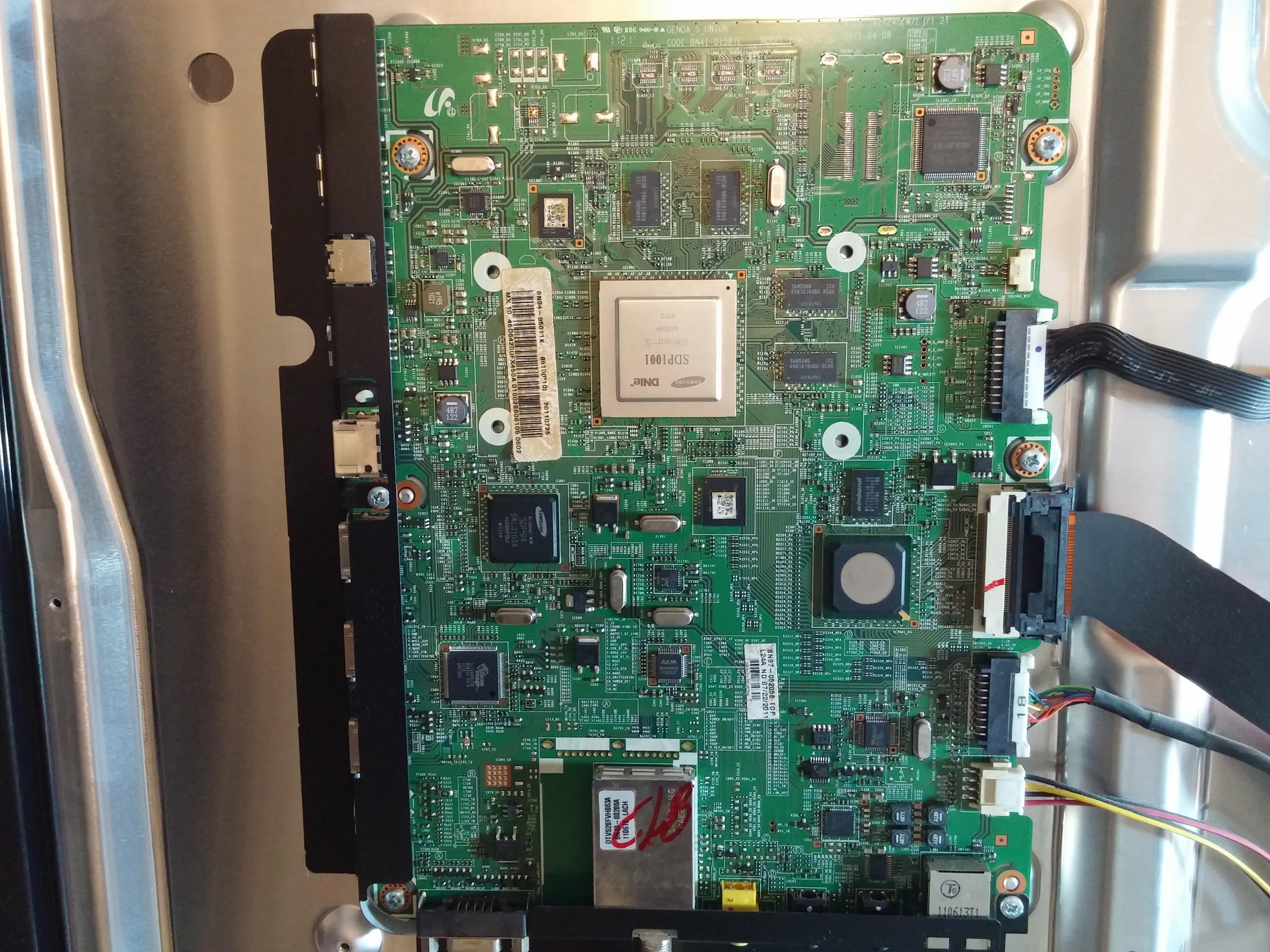

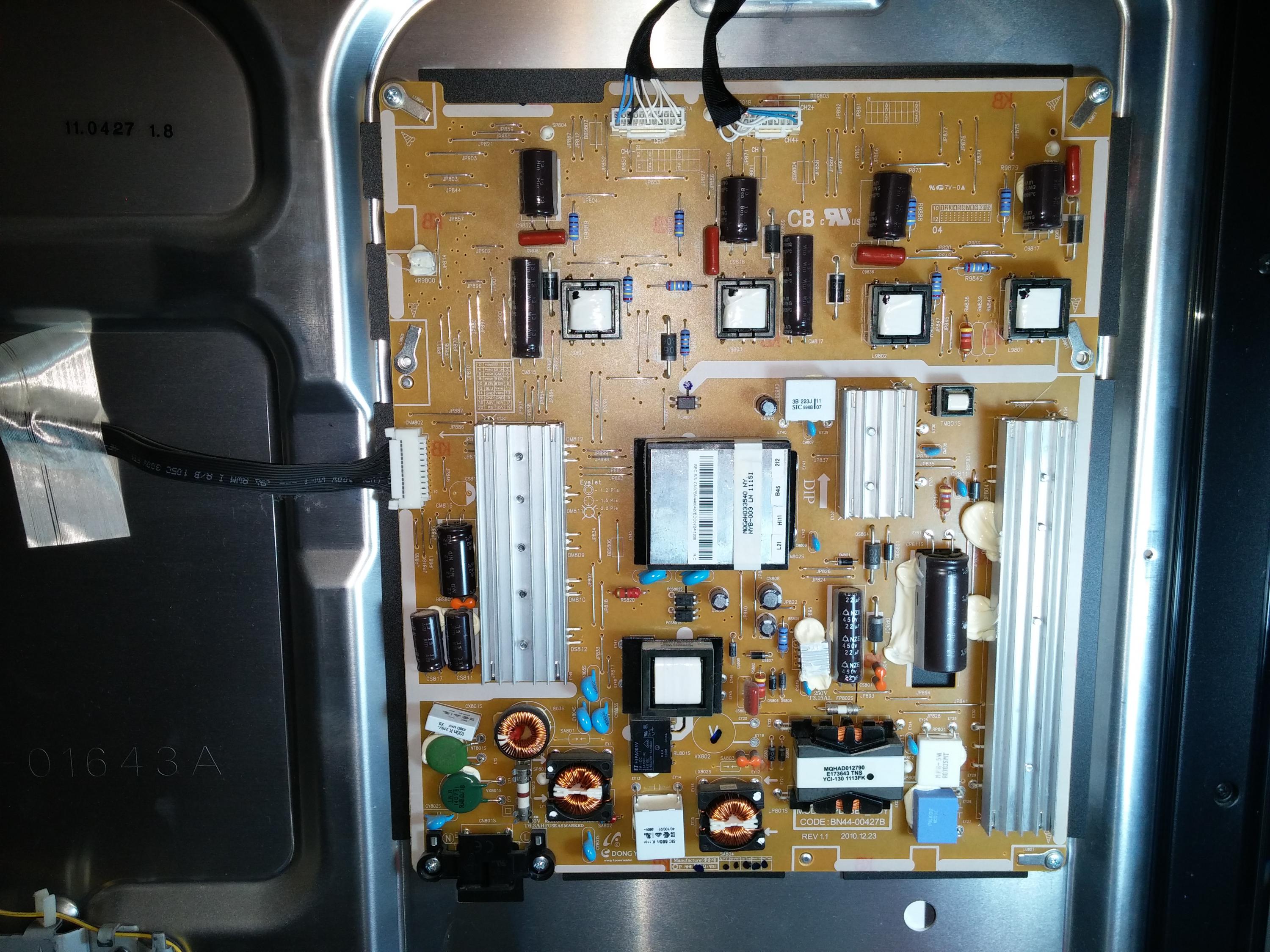

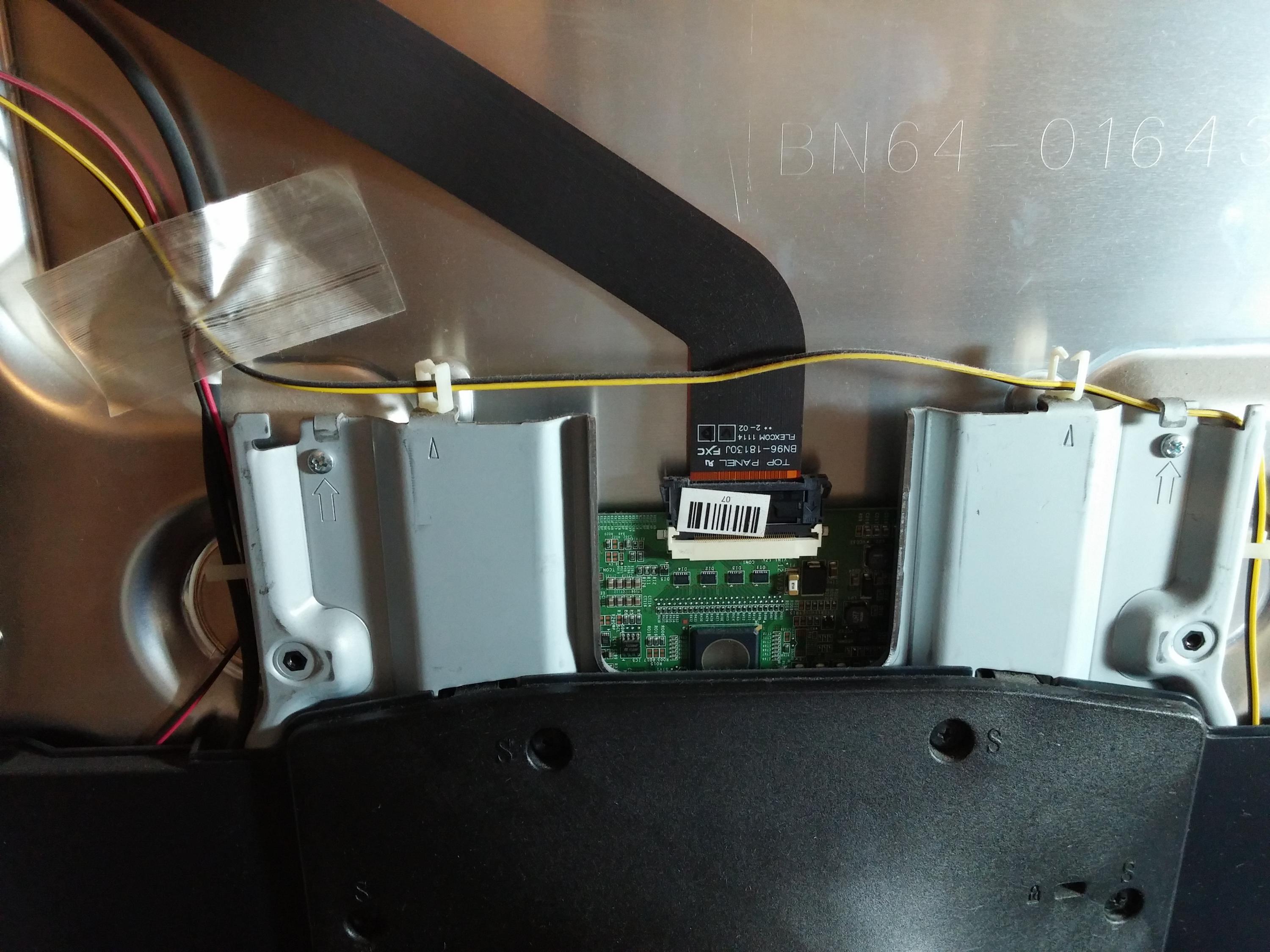

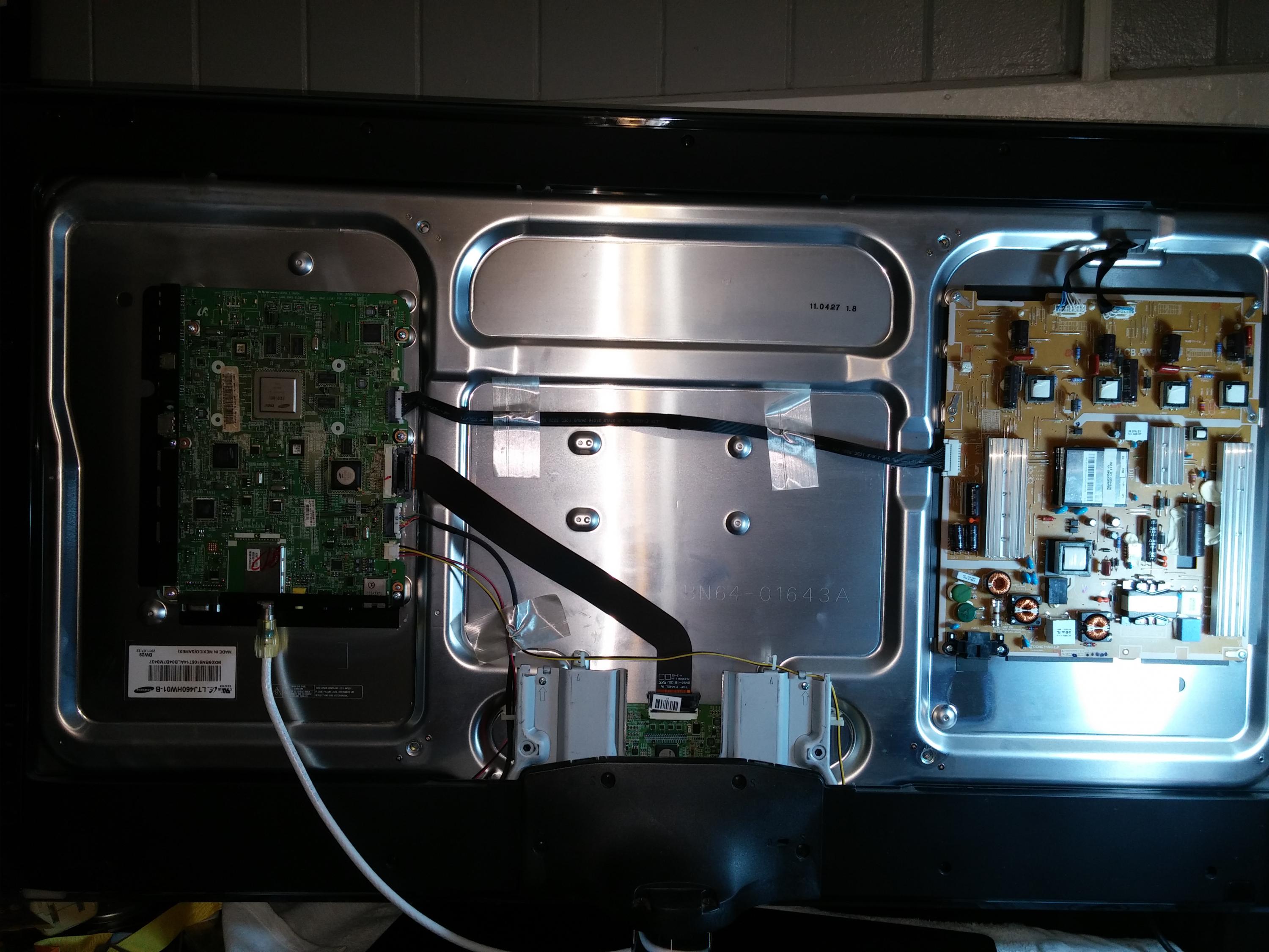

                    Just powered on today and a few white horizontal lines, but no Samsung splash screen. Also no sound from the tv anymore. I see the backlight on when I shut off all the lights. I have taken apart the tv but not sure what to check first.
                      I had this TV and it had a shorted panel.
                      I would remove the stand and the metal cover and try only one ribbon at a time ,from the T-con to panel. If one half shows perfect screen and the other side no, then the panel is bad.
                        Well, it's "more bad"... if that makes any sense... it's probably died entirely. Typical of Samsung LED-LCD TV.

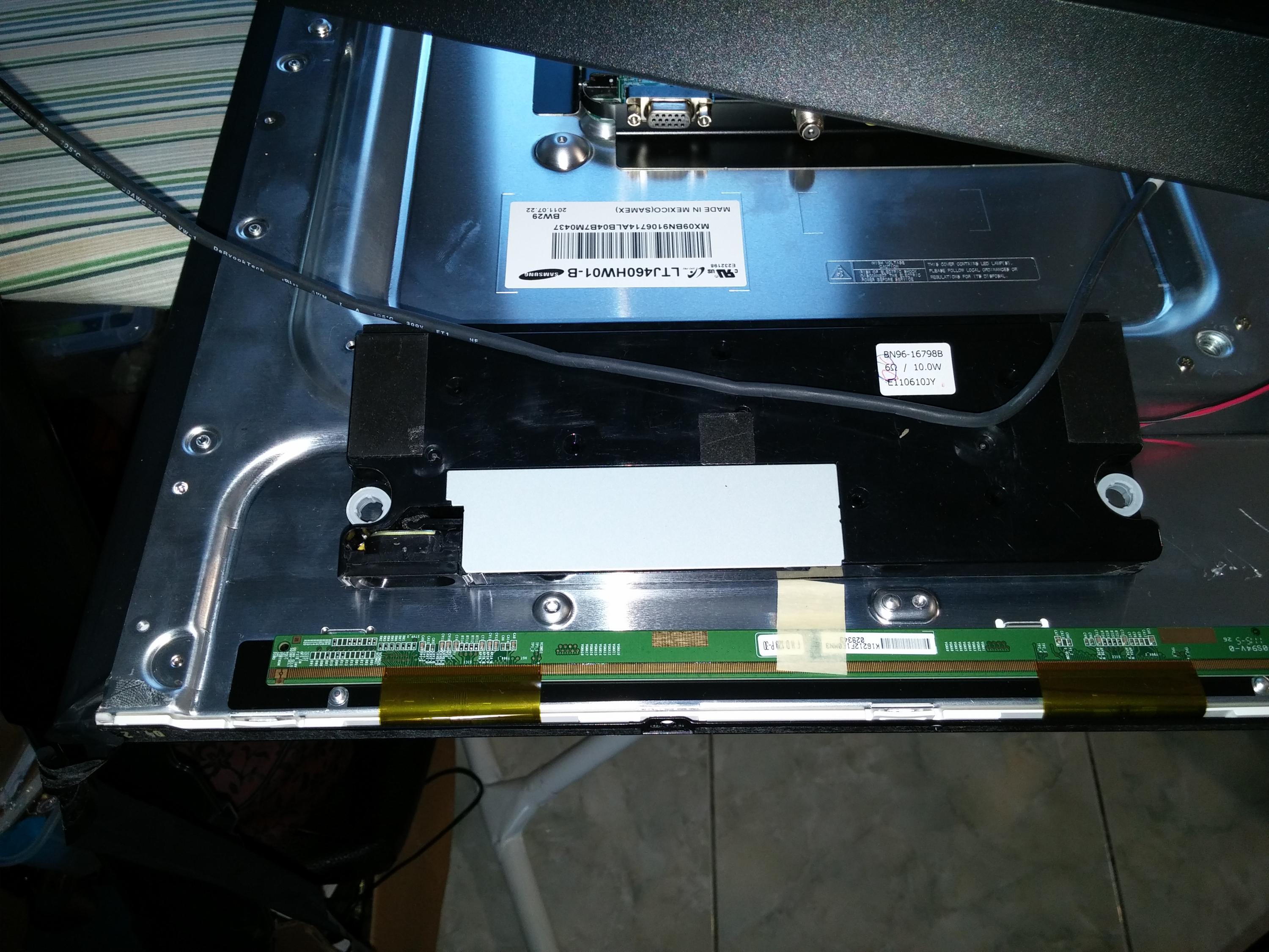

                          Took off the right panel ribbon cable, powered on the TV, the left side of the panel showed up. Put back the right panel ribbon, removed the left panel ribbon, powered on the TV, and no picture, only backlight.
                          Is this still looking like a bad panel?
                          Is there anything that can be replaced and repaired? I don't mind taking the TV apart, but if it is the panel and it I've read it isn't worth the money to replace then I'll just purchase another non-Samsung TV.
                            The test you've just performed indicates a bad panel.

                              UPDATE.
                              So I was bored today and decided to take apart the TV even further thinking I might as well learn from this and see what is inside. I got to the cable ribbons located at the bottom of the screen. I touched each of the ribbons down, I think 4 or 6 of them, pushing them down toward the circuit boards under them. With the screen faced down I powered on the TV and I got clear cable TV signal. The lines in the picture that I first posted were gone. Hmmm.
                              I am thinking it is a loose cable that is causing the my problems. Is it okay to put clear scotch tape over the ribbon to keep it pressed down? Does this cable heat up and will this cause a fire hazard?
                                You have discovered a "tab bond" problem. This is common, and is usually why these panels fail.
                                Yes you can secure the cables, but generally, the success rate is poor at best. Some people have had good results using padding material to apply pressure. It's hit and miss at best. I've never had good luck with the larger panels so I always consider any large panel with tab failure to be dead.
                                  I heave heard of people getting decent results using Thermal Pads between the tab bond and frame to put some pressure on the tab bonds - They will also help keep it a little cooler going forward so may be a little more robust?
                                  As Tom has said though, some tab bond "Fixes" last a few minutes, some last a few years so its is very hit and miss. Ultimately you have nothing to lose though so... give it a go!
