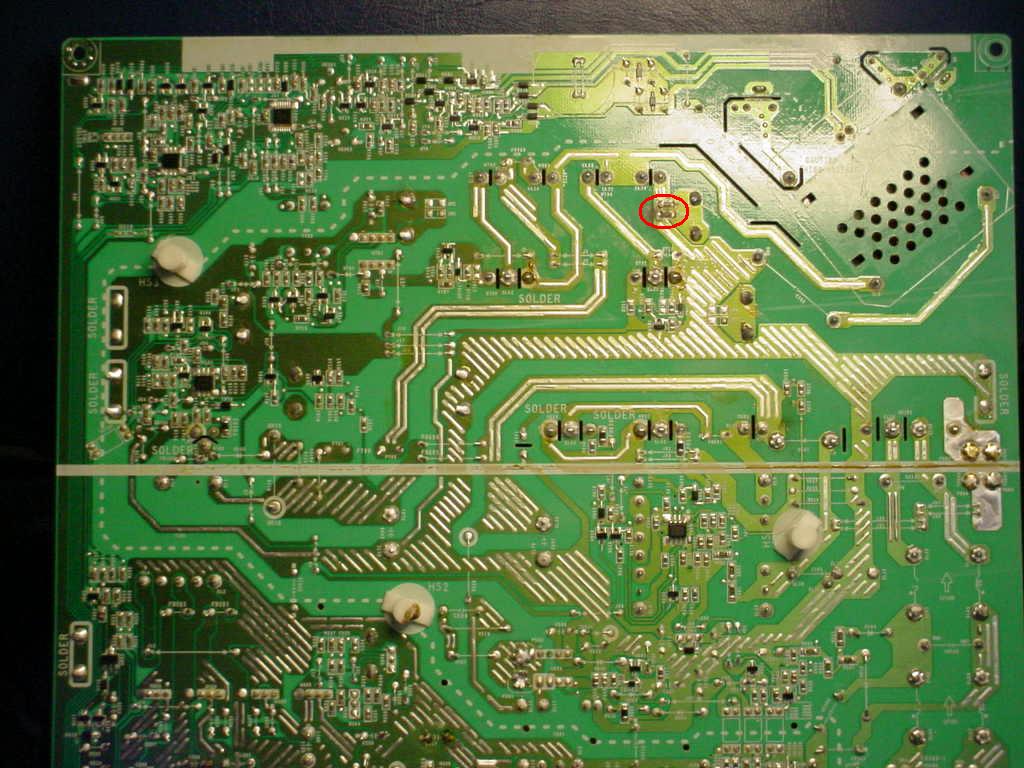

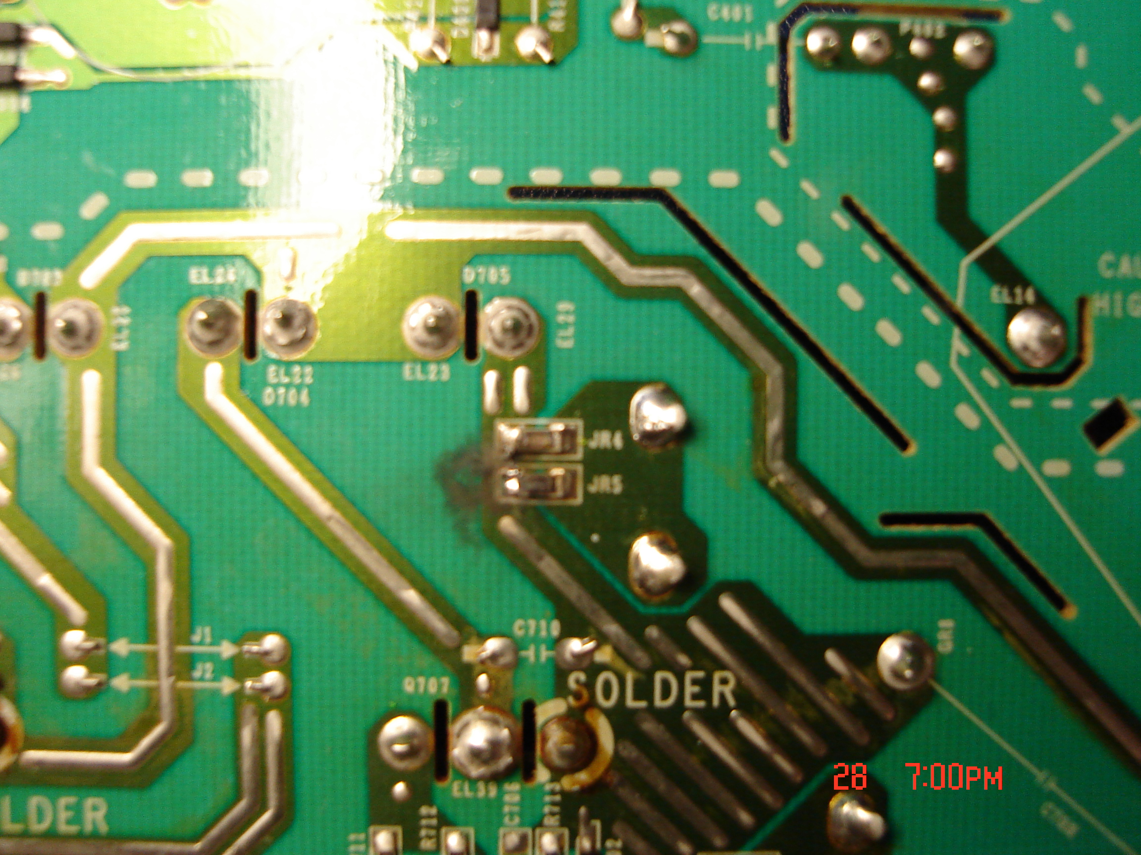

Resistor values needed on solder side of inverter/power board.
Lg 42lc7d
Re: Lg 42lc7d
Can we get the P/N of this power supply board? and good clear picture of the top side of the board. That resistor looks to be part of the RC snubber for the diode.Never stop learning

Which one of these power supply version matched yours?

Are the resistors on your board blown? Could you get a closer shot around that area?Please do not PM me with questions! Questions via PM will not be answered. Post on the forums instead!

It looks like one end is connected to the heat sink, the hest sink is connected to the circuit on the left side of the heat sink. Need better pictures of the bottom side.Never stop learning

Yes - ^^^^^^Id say that is probably correct.Please upload pictures using attachment function when ask for help on the repair

Look at the board and see if there are other components with 'JR' and see what they look like and check the resistance.Never stop learning
