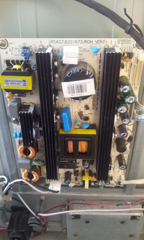

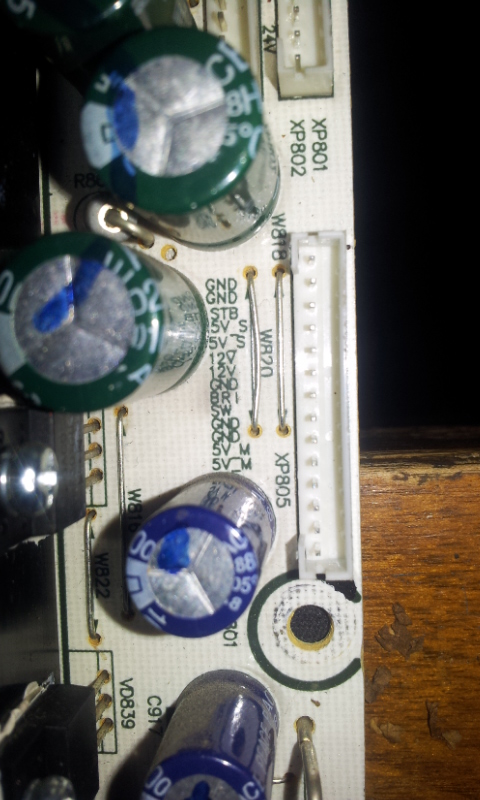

    can anyone point out which pins on this PS to jump to turn it on?

        'STB' is the PS_ON pin.
          Re: Hisense F46V89C/DYNEX LX-L40-10 DEAD
          thanks bud, do i jump stb to 5v s ? I have 4.8v on 5v s.
            You can use 100~500 resistor between stb and the 5V, but you must have the STB wire that goes back to the main board disconnected otherwise the main board will keep that low and not allow the STB to go HI.
            Since this power supply board has PFC Voltage booster, you need to check the DC Voltage RIGHT AT THE TWO LEGS OF THAT BLACK MAIN FILTER CAP (THE 450Vdc RATING), it should have about 170VDC when TV is plugged in but not turned on, then it should jump to about 360~400Vdc when PS_ON is applied, you must have this boosted Voltage before trying to fix anything else.

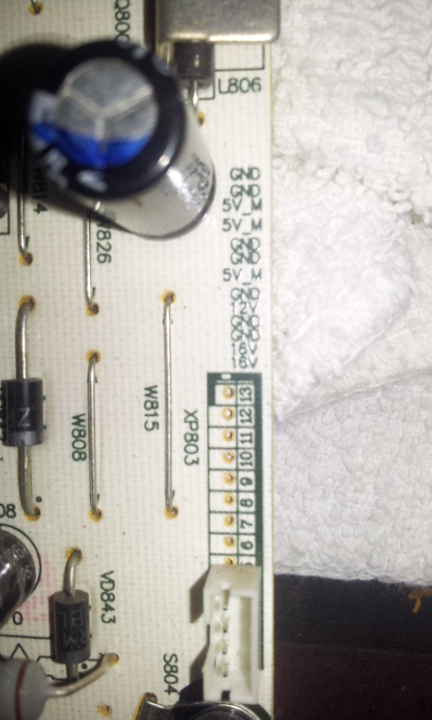

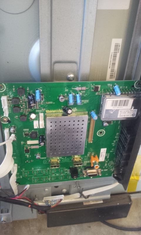

                Okay, I put a 100ohm resister between stb and 5v and all the voltages on the connector were there, i also had 16v on xp803, so i guess i got a bad main board from shopjimmy?
                  Oh yeah, I also heard the relay click when i applied power to the power supply.
