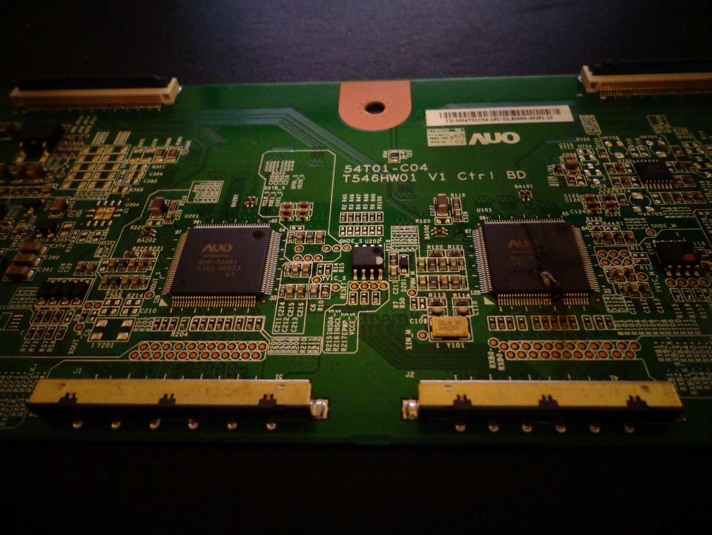

    Good Morning,
    I am looking for someone with good knowledge on Toshiba 55" LCD Tv's and a ton of patience. I have some electrical/electronic experience and wish to fix my broken 55G310U TV. The problem is as follows:
    1) Press the Power button and the green light comes on
    2) In a dark room you can see the blue glow from the backscreen ?
    3) There is no sound and no picture
    4) Picked this up from a recycling depot. Customer was told it would require a $1200 board to repair it.
    I want to do this in a logical order, I am not a parts replacer. My experience is mostly DC as I am a Professor in the motive power trade at a local community college and am quite familiar with using a meter and all the little components in this TV. Not sure what all the boards are all called, know inverter, power supply, thats about it.
    1) First step: How not to kill myself. How do I know this is totally drained of power?
    2) Where to I clip my ground leads to for test purposes?
    3) Where do I begin this logical process?
    4) Where can I learn more about TV repair. Specifically LED, LCD and Plasma

    I It should drain within 30 seconds but as it is faulty ???!!!! Use a rcd device and if possible have someone available. Work on a non conductive surface ( we have had members working on a metal bench!!!) - It is the BIG capacitors on the power supply board that can store up the power - you can test there with your meter on 600VDC to make sure it has discharged.

        What I'm hearing from your initial diagnosis points to the tcon or main board as the most likely failures. If you have a source signal do you get sound? You can push the input repeatedly to cycle through waiting a few seconds on each one. If you have sound I would then have the tcon as primary suspect. If you look carefully there should be a fuse very near where the lvds cable plugs into the tcon, verify the fuse is good....if so do a voltage check on both sides of the fuse. If no voltage on either side you can pretty much assume that the main board has a failure. Because of the complex circritry and the unavailibilty of schematics main boards are notoriously difficult to repair. There may be fuses you can test on the main as well. I've had Samsung and vizio fuses fail from fatigue with no other faults present.

          Look for T-CON board: something like this:
          http://www.shopjimmy.com/auo-55-54t0...-con-board.htm
          Tell us if this is what you have in your TV.

                Not having much luck finding a service manual on this unit. Anybody have any ideas? If I shine a flashlight on the screen, this would indicate a bad inverter would it not? If it was mainboard, I should see nothing at all?

                  "2) In a dark room you can see the blue glow from the backscreen ?"
                  You have indicate blue glow on the screen so the inverter/bakclights are on. How about the T-CON as I requested?

                    Ok here is an update. I checked all the voltages on the power supply and they are as they should be. I got loking around the TCON board in the top center section and found that it had been apart and the ribbons at the top had not been reconnected. So I reconnected them and put everything back together and turned it on. Here is what happened.
                    The green light came on for power, the screen went a whitish blue and had dark horizontal lines across it for a few seconds and then blanked out and then the top one third of the screen did this again and then it slowly faded into darkness into the top left corner. No change after that.

                      Re: Toshiba 55G310U No Picture
                      Update. So I went to the TCON board and figured I would check the fuse and nose around a little. After removing the board and getting it under a better light, I found the right side chipset, AUO-12401, had leaked smoke out of it. I guess we need a TCON. Kind of makes me wonder what else I am going to find once I have that repaired.

                                        I have attached a picture of the bad TCON board. I had to reduce it in paint to get it to come in. Hope this is helpful. Any suggestions why it blew?
