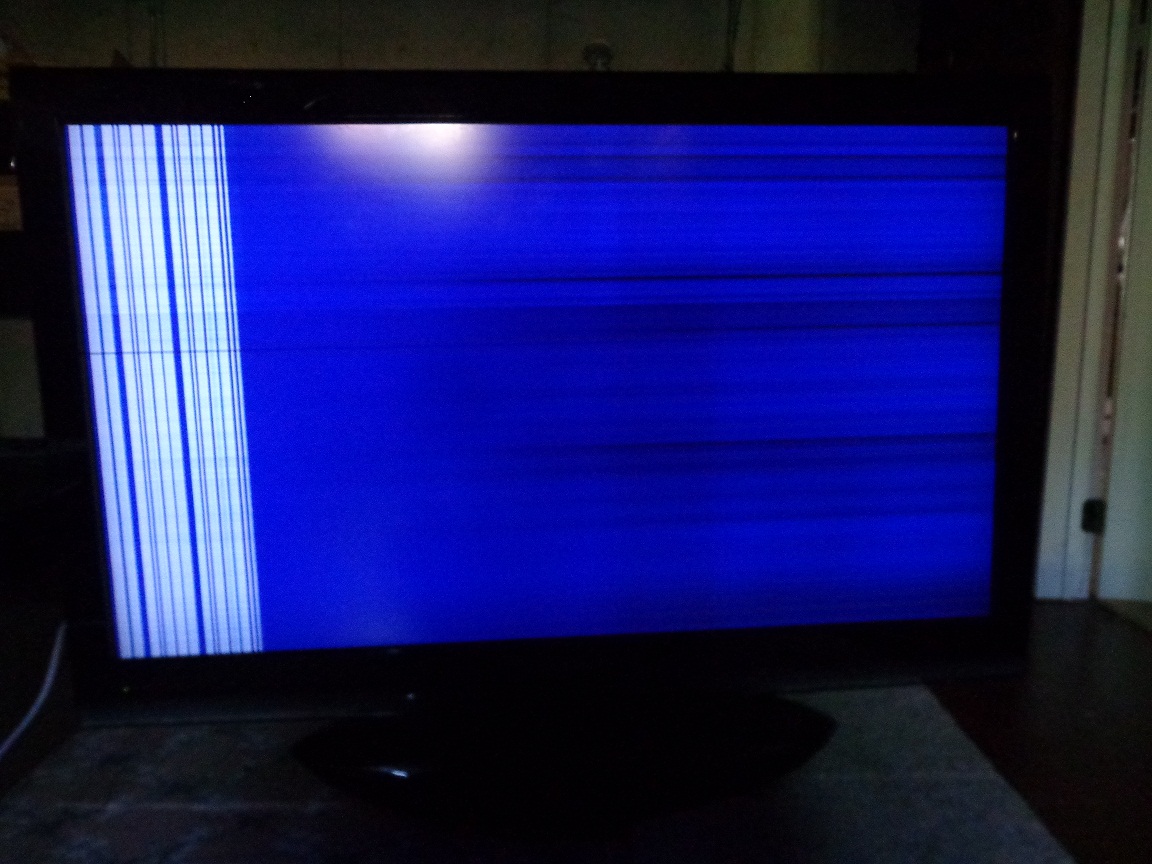

              I removed the TCON board again just to make sure it was seated properly on the four ribbon connectors and the two connectors at the bottom and they seemed to be okay. I found a connector to the TCON board a little out of its socket and pushed it back in and now here is what I have:
              The screen lights up and the left half is like a light blue with darker horizontal and vertical lines through it. The right side of the screen is dark blue with lighter horizontal and vertical lines through it. If I press the input or menu button, it changes configuration a bit but still roughly the same. Thoughts?

                Now that you have something displaying on the screen you will want to unhook the ribbons from the tcon to the screen one at a time and see if you get a picture on either half. It sounds like you may have a fault on one side of the panel.
                You should typically see about 12v on the tcon fuse, however some sets use 5v. The low voltage signal display should look like variable frequency square waves. However you may not be able to resolve them if you have an old slow scope. It may just look like digital noise instead, the main point is just to verify the main board is sending a signal to the tcon. now that you have something on the display the main is likely doing its job.

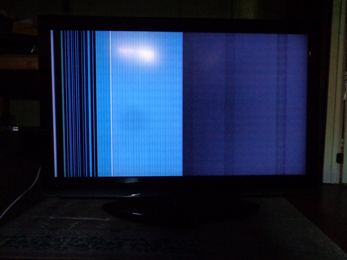

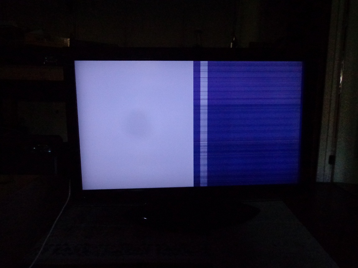

                          I have attached three pictures. The first one is with all ribbons attached and has changed since the last time I turned it on. The second one is with the two left side ribbons disconnected only (facing the rear of the set) and the third one is with the two right side ribbons disconnected only.
                          If this is a panel problem, could you explain to me what the pictures mean and if there is a way to verify the diagnosis. (Just for learning purposes).

                              I say bad panel.

                                      Does your tv have a small circuit board bonded to the ribbons along the top of the panel or do the ribbons feed directly into the panel? If the ribbons are directly bonded chances are high it is bad panel driver or tab bond failure, if it has the board across the top it may have a bad replaceable component on the board (still considered bad panel as they never intended anyone to try to work on it).
                                      I haven't ever tried checking signals out of the tcon, but in theory it should be possible. From the training manual-
                                      "Do not attempt to check for data or voltages on the LVDS connector at the TCON. This advice has been circulating around and is not recommended. In Figure 4 a picture of the LVDS connector is shown. In order to take a reading from one of the pins, you must insert your probe between a narrow area that is shielded and at ground potential. Several of the pins contain B+ for the TCON and panel. It is very easy to short one of these pins to ground and if it is a B+ line it is guaranteed you will be replacing a B board whether or not it was the original cause of the problem."
                                      I think the only concrete way to know for sure is to swap your boards into a known good panel.
