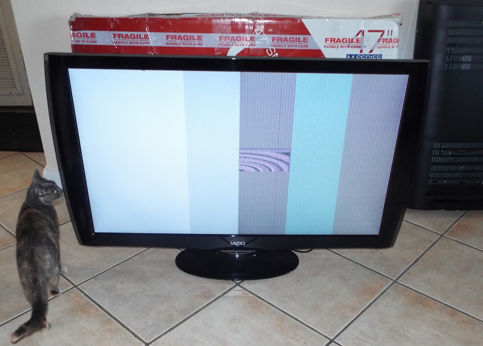

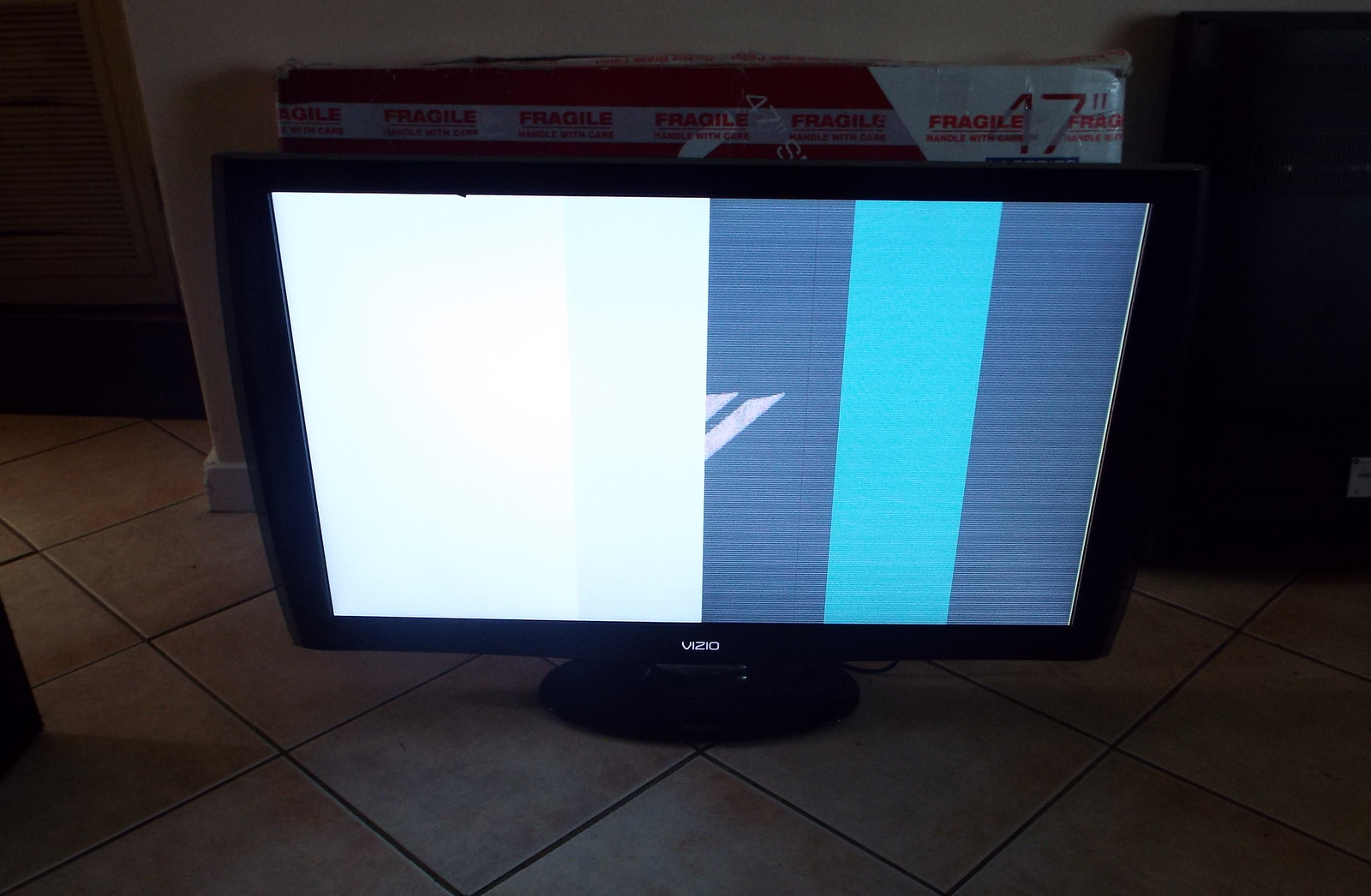

    I pick up two Vizio this weekend. One M470NV LED TV and Vizio VF551XVT LCD TV. The M470NV does power on but the picture is distorted.

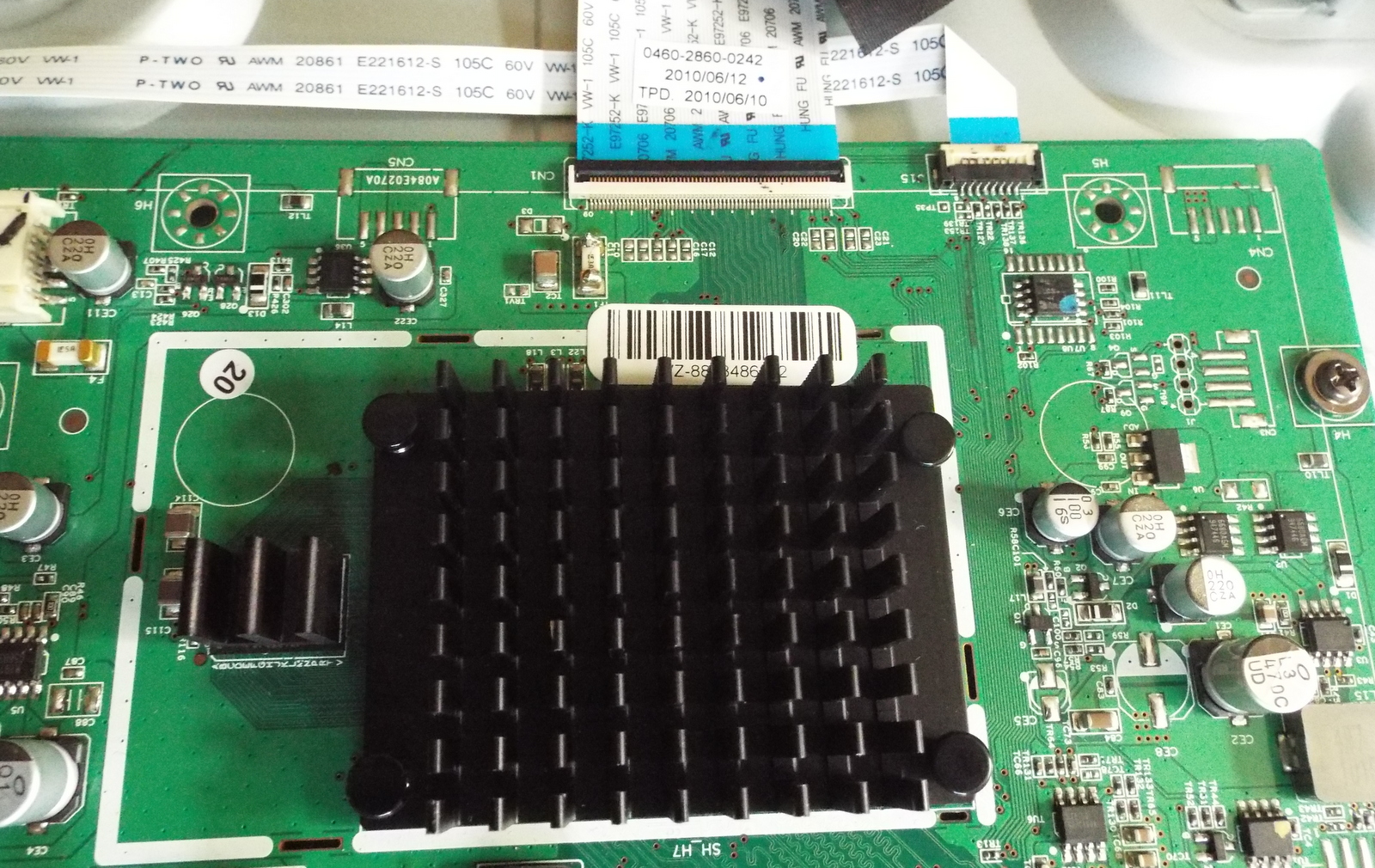

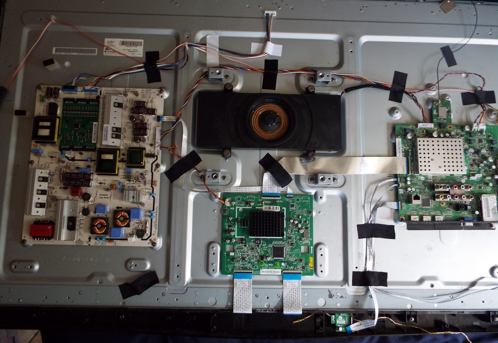

    The M470NV I haven't cracked it open yet. I'm hoping to find a ribbon cable loose or a poor connection. I'm happy its not a stuck on logo problem. I check for parts on the web, there is a PC board inside instead of a T-CON and It maybe the problem.
    I paid $70.00 for the M470NV with internet apps I believe it's about 3 years old. I will post picture of the inside later.

    Looks like tab bonds or panel to me hope I'm wrong bro.

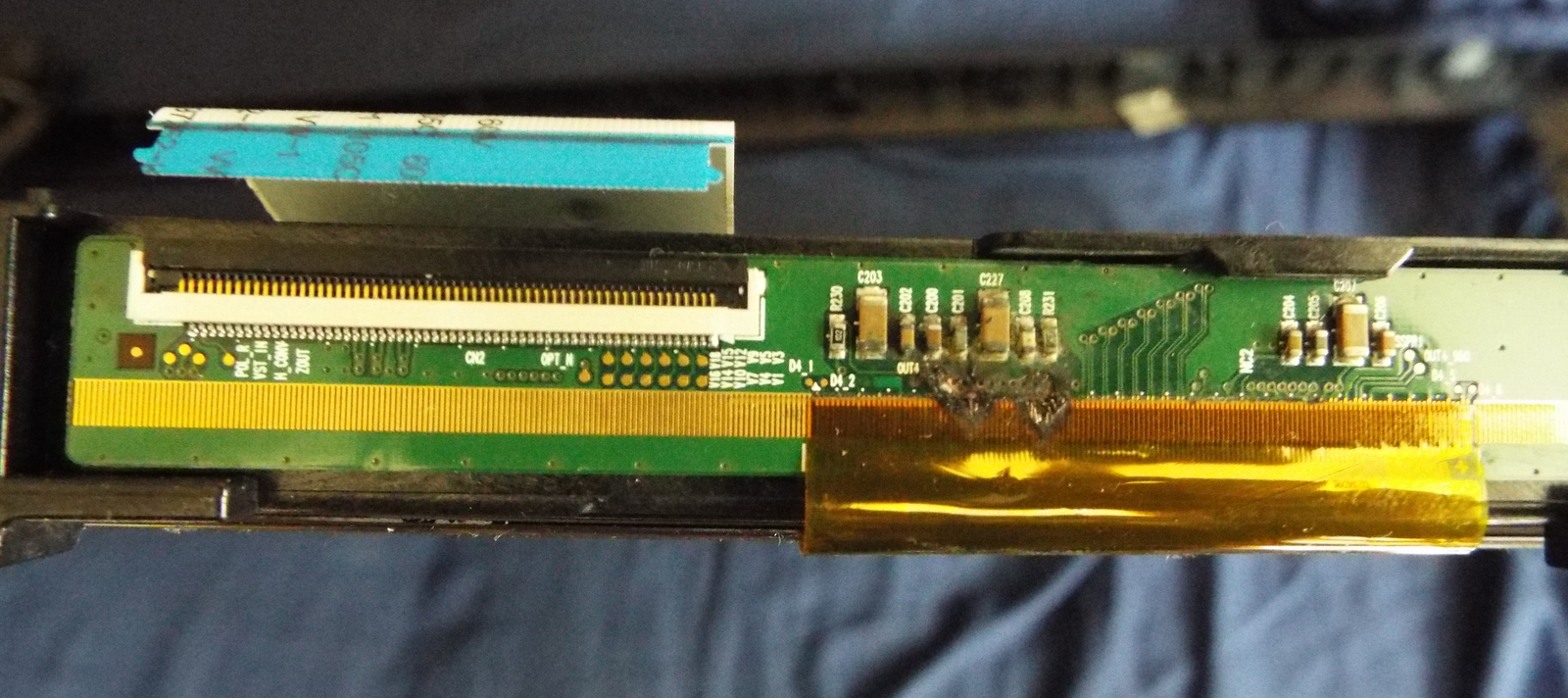

      mmartell, you are right, This look very nice and I hate to part is out. 1st the seller have been inside. I found a fuse on the PC board with a wire solder on it, so the fuse was blown. one ribbon was disconnected because it cause smoke and a burn mark on the panel board. So one of the bonding tab is damage.

        Looks like water damage is a possibility.

          Have a 42" of this series with TFT tab bond failure due to excessive windex, blue corrosion built up all over the SMD parts.

            Did some tested, all HDMI ports are working, but the image on the screen is reverse. this mean a bad PC board is possible?
            looking at the metal frame around the panel, there is a water stain residue.
            so most likely the owner was cleaning the screen and liquid ran down into panel board circuit.

              Oddly enough, we have seen bad tab bond cause a mirrored image.
