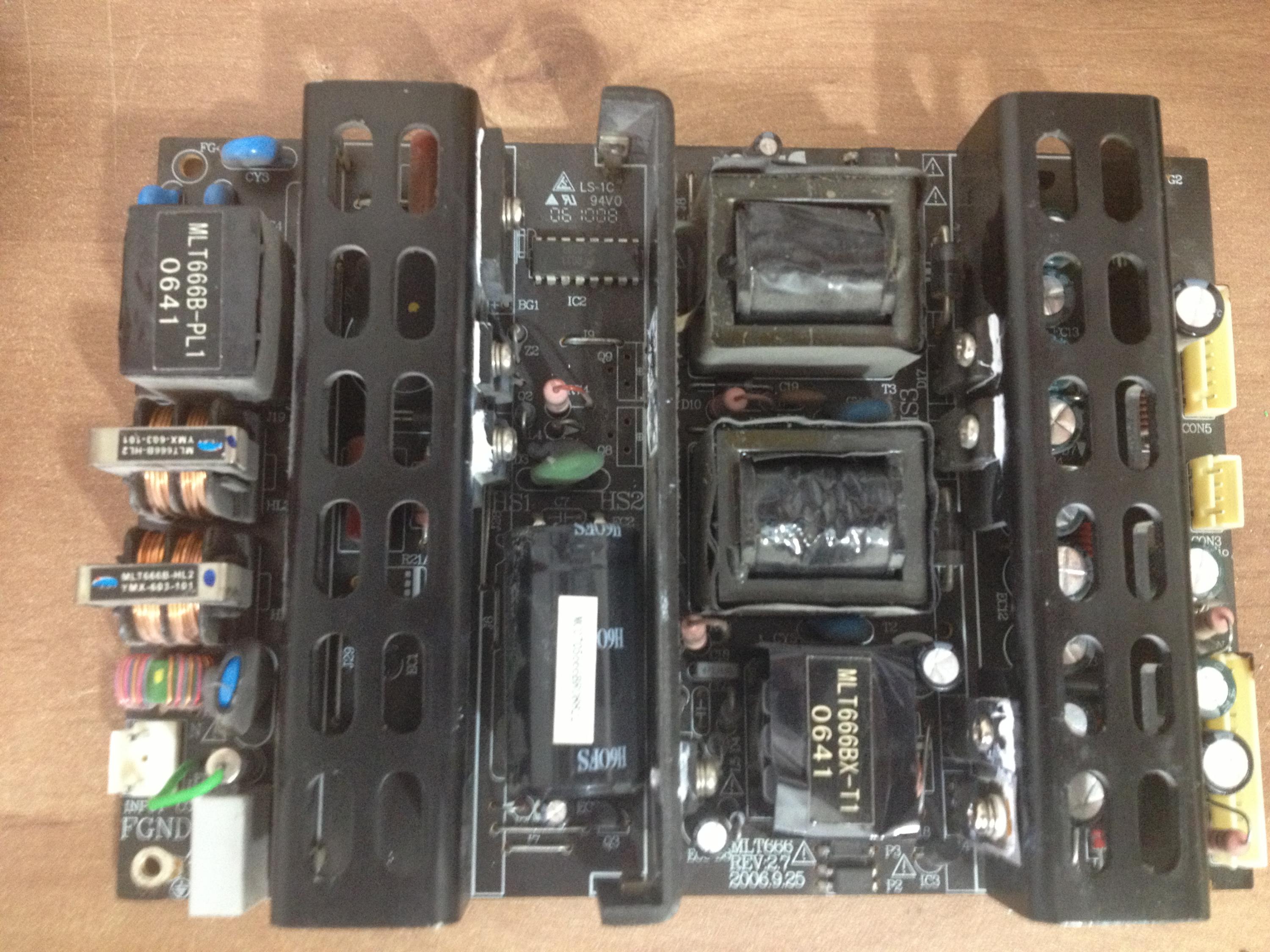

    Hey guys,
    I got this TV for repair it for a freind,
    Got no power at all,
    PSU MLT666 Rev 2.7
    Had 4 bad caps:
    3X 1000uf 10v
    1X 470uf 16v
    5A main fuse,
    I had a feeling that fuse didn't blow for nothing
    tested diode bridge, seemed fine,
    Had a quick test and big bang!
    Did another quick test and found
    2 Power Mosfets: p6nk60zfp blown
    And may got more blown transistors,
    any suggestions?

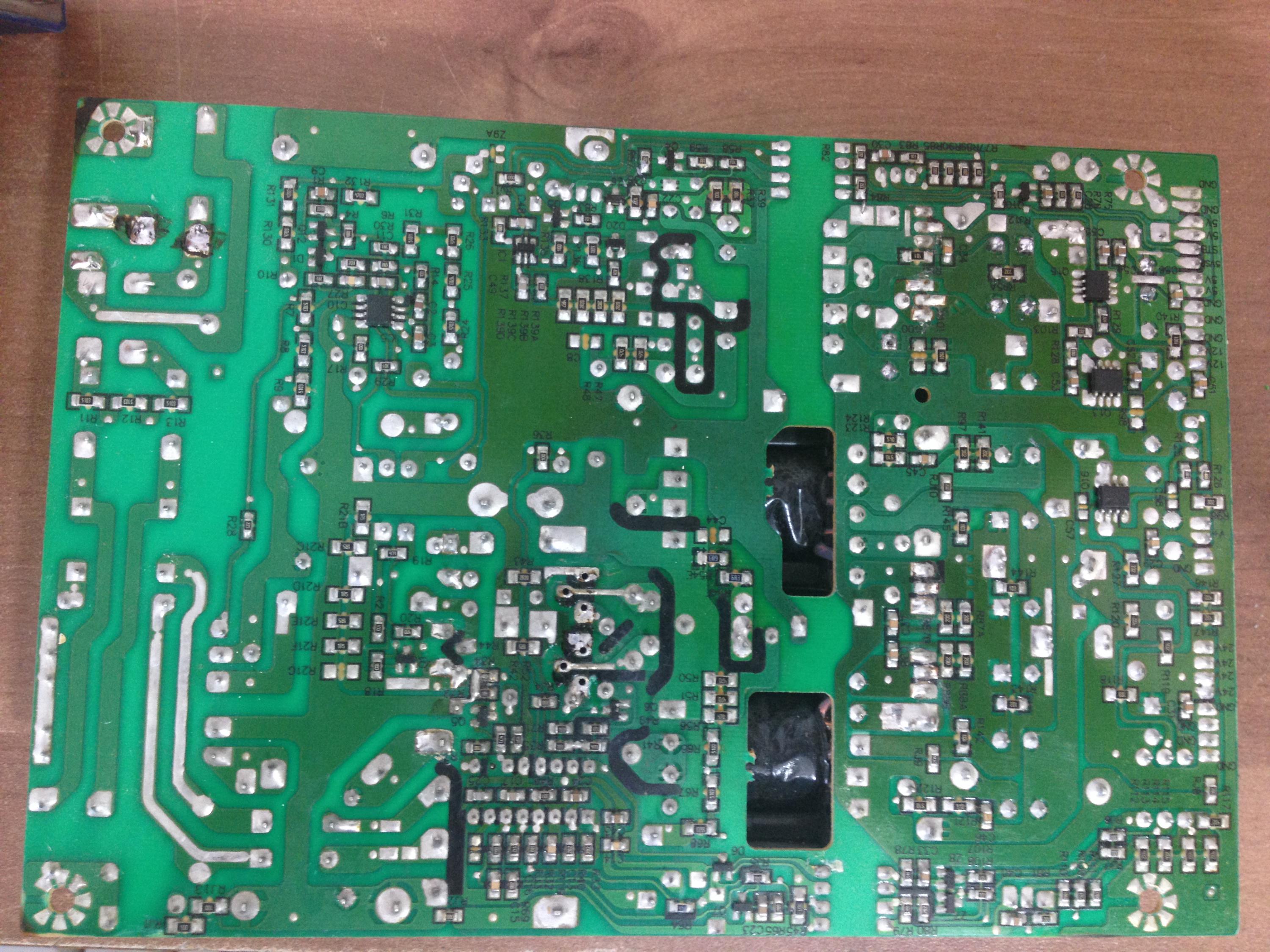

      Well assuming you are going to replace all you have found faulty there is little to add. On the back of the board picture top right are those the mains posts?
      and the brown streak across the ground screw pad has it shorted out there?
      When you have replaced all the parts next time you start it use a 75w filament bulb in series with the mains positive. - "Dim Bulb Test" - should save you blowing more components if there is still a short on the board.
      I suppose as you remove parts you could also test the pads for a dead short.
      Forgot to say - where is bad on the back check the board has not carbonised one of these
      MLT boards used to do it around the high voltage blue caps.

                                        Can I see the location where this 9.1V Zener is on the board, also the MOSFETs?
