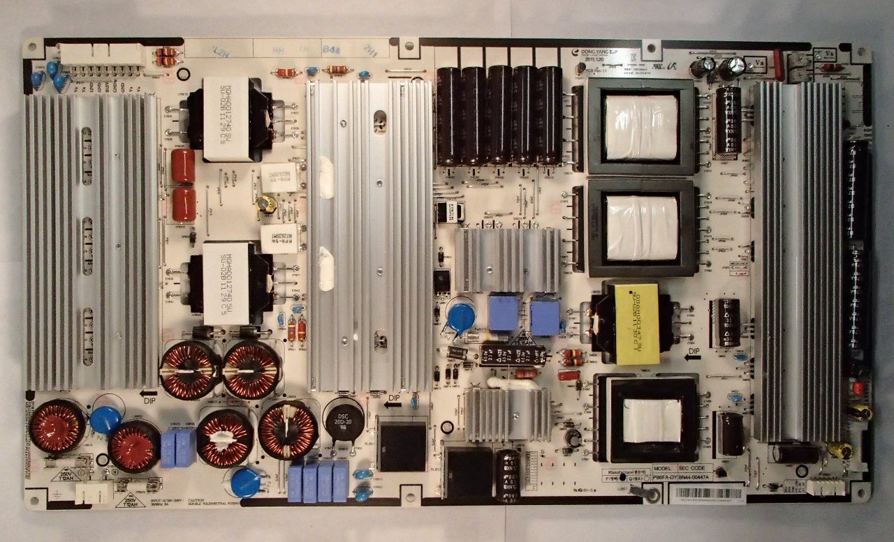

    You can use the switched 12V or the switched 24V (I would use the 24V which is typical used for the backlights inverter) but you will need to find out what you have in your TV.

      Here is my SMPS. I am thinking about using 4 - 12v .18a 80mm fans and maybe speed control

                                        if the 15v is switched with the tv, then use the 15v and put a 7812 regulator and a couple of caps on some stripboard - dont forget to bolt a heatsink on it.
                                        if you want to run them slower use a 7809 or 7808 but it will generate more heat!
