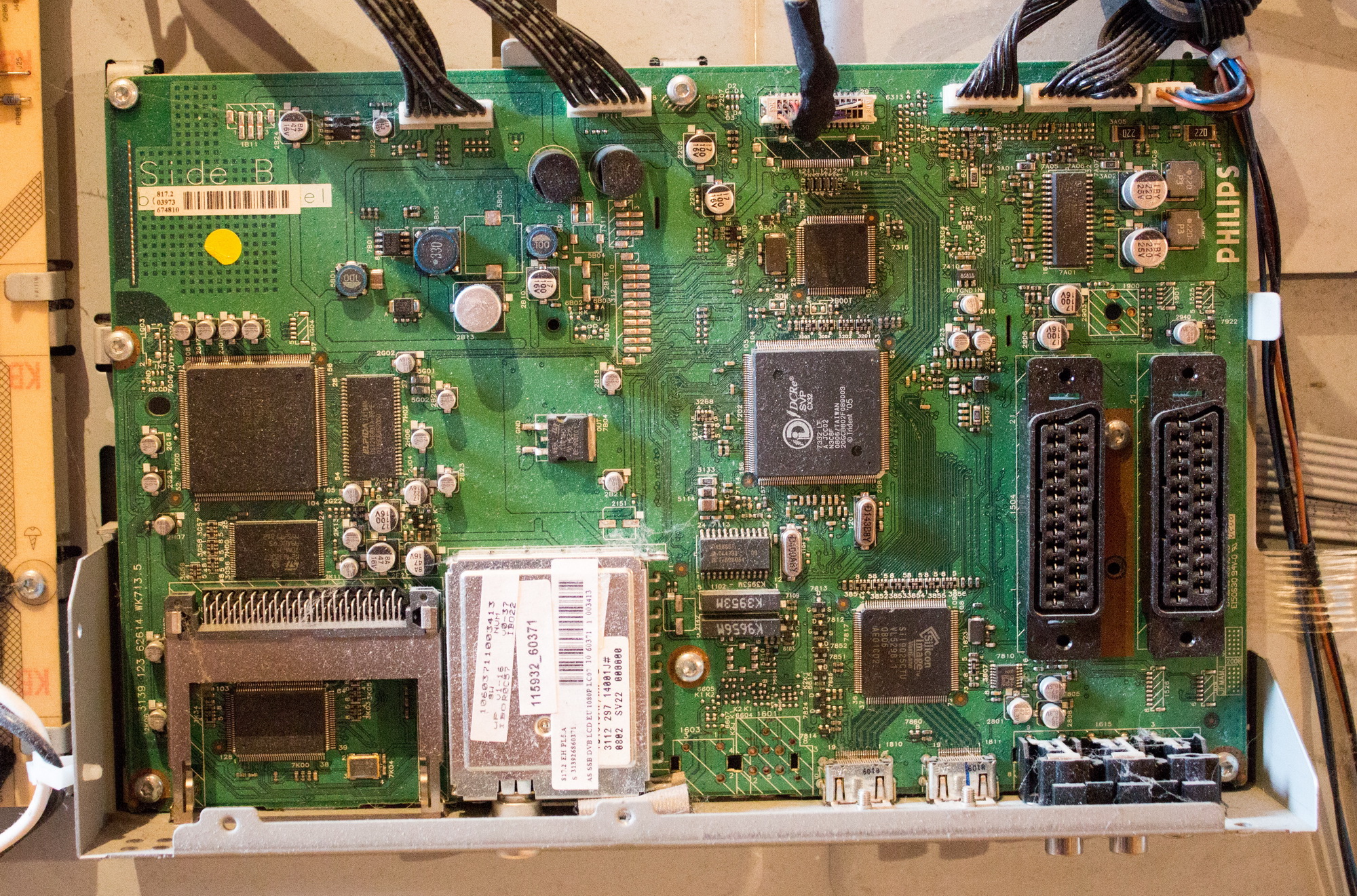

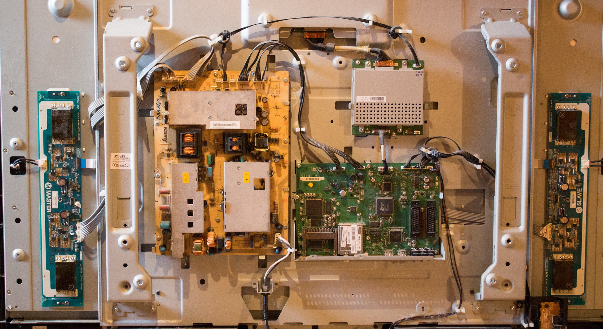

    I've turned on a Philips 47PFL7642D/12 LCD TV after about a year.
    Screen stays black, no backlight, no sound. Power-on-LED turns blue as expected.

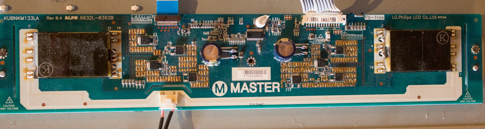

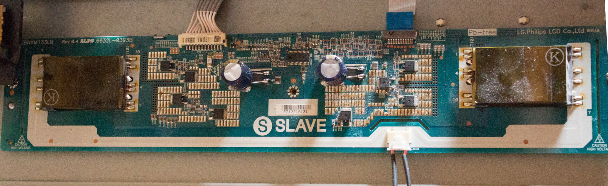

    I already replaced the four caps on the two inverter boards as they looked vented. The only fuse I found is on the power supply board and is ok.
    Where to begin?

    Are you getting 24VDC on both ends of that white fuse (chassis as GND ref for the meter) on the inverter boards? Do you also see if the backligts even flash on for seconds?

              @budm: I get a 0V reading on both ends of both fuses. Backlight stays completely off.
              So I guess the problem is rather on the power supply side?

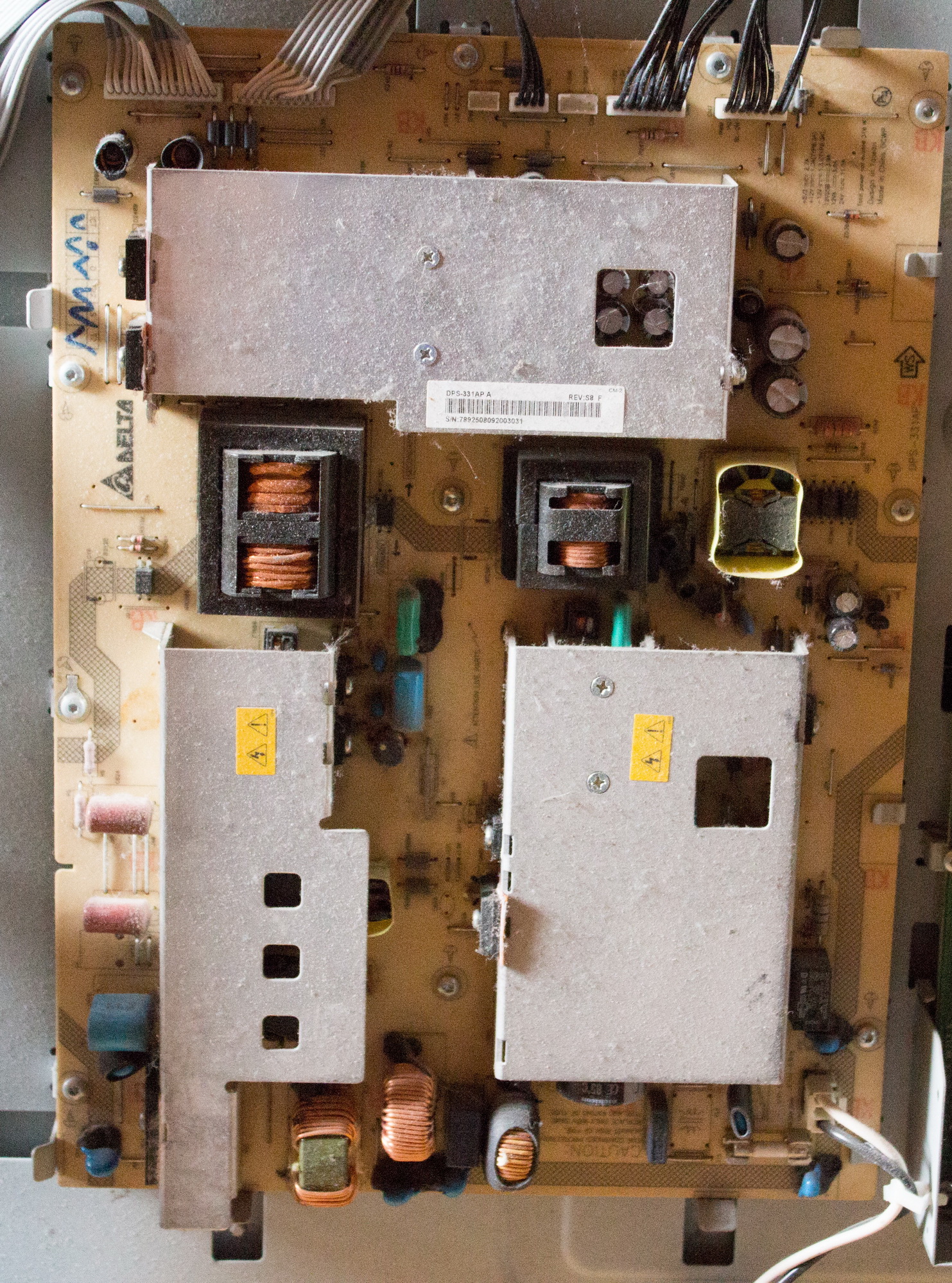

                Maybe , maybe not. try unplugging replugging all the connectors a few times to clean off any oxidation then with it all plugged in and connected up test all the pins on all the connectors post results like

                on connector cn 7 there is a pin PSON can you use meter on vdc20 and monitor what happens on that pin from plug in to switch on to fault position.

                  Also check the caps under the power supply heat sinks. The engineer(?) that designed that should be fired!
                    Re: Philips 47PFL7642D/12
                    Heureka! Found one obviously vented cap right below the large heatsink. Replaced it and everything works fine now.
                    Final question: Does it make sense to replace the remaining three old caps as a precautionary measure? I ask because this will be rather complex. They really managed to solder the heatsink to the board!
