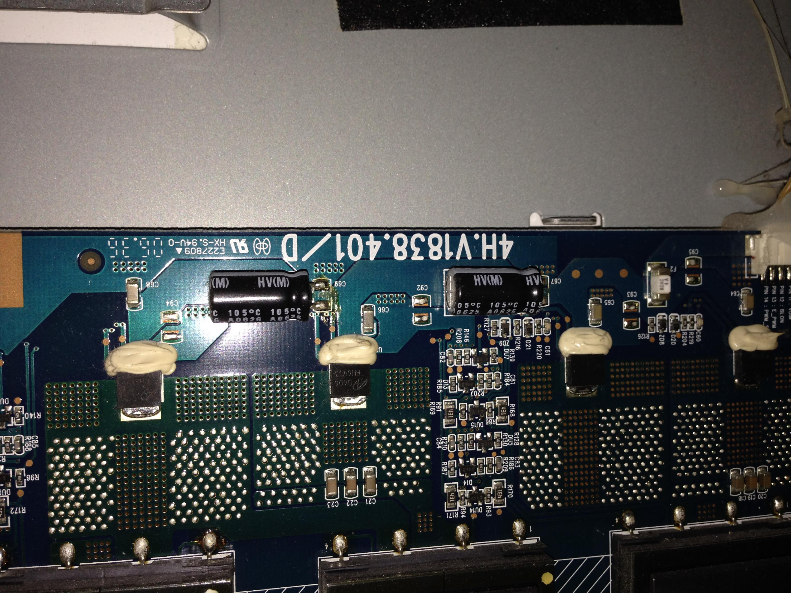

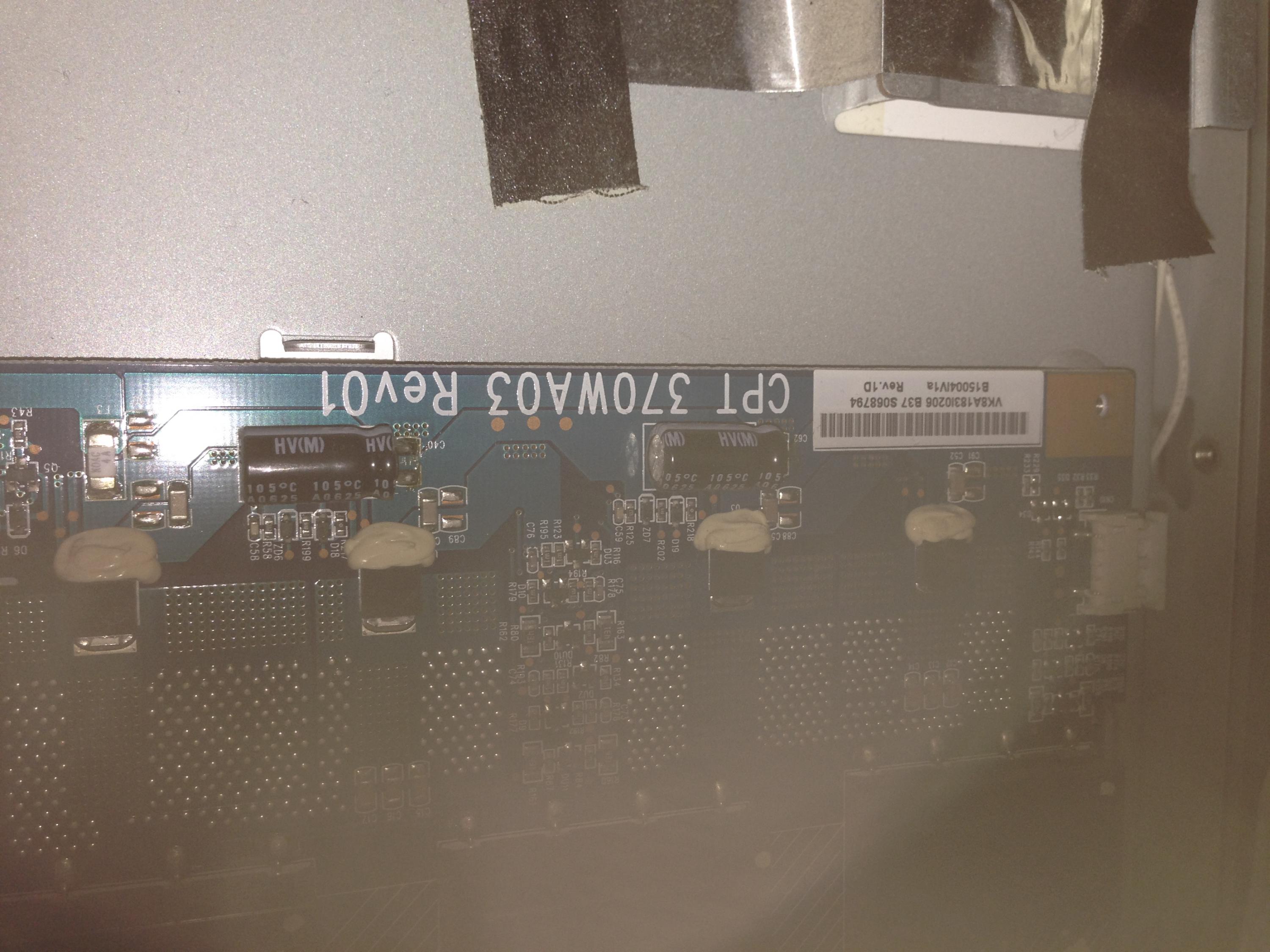

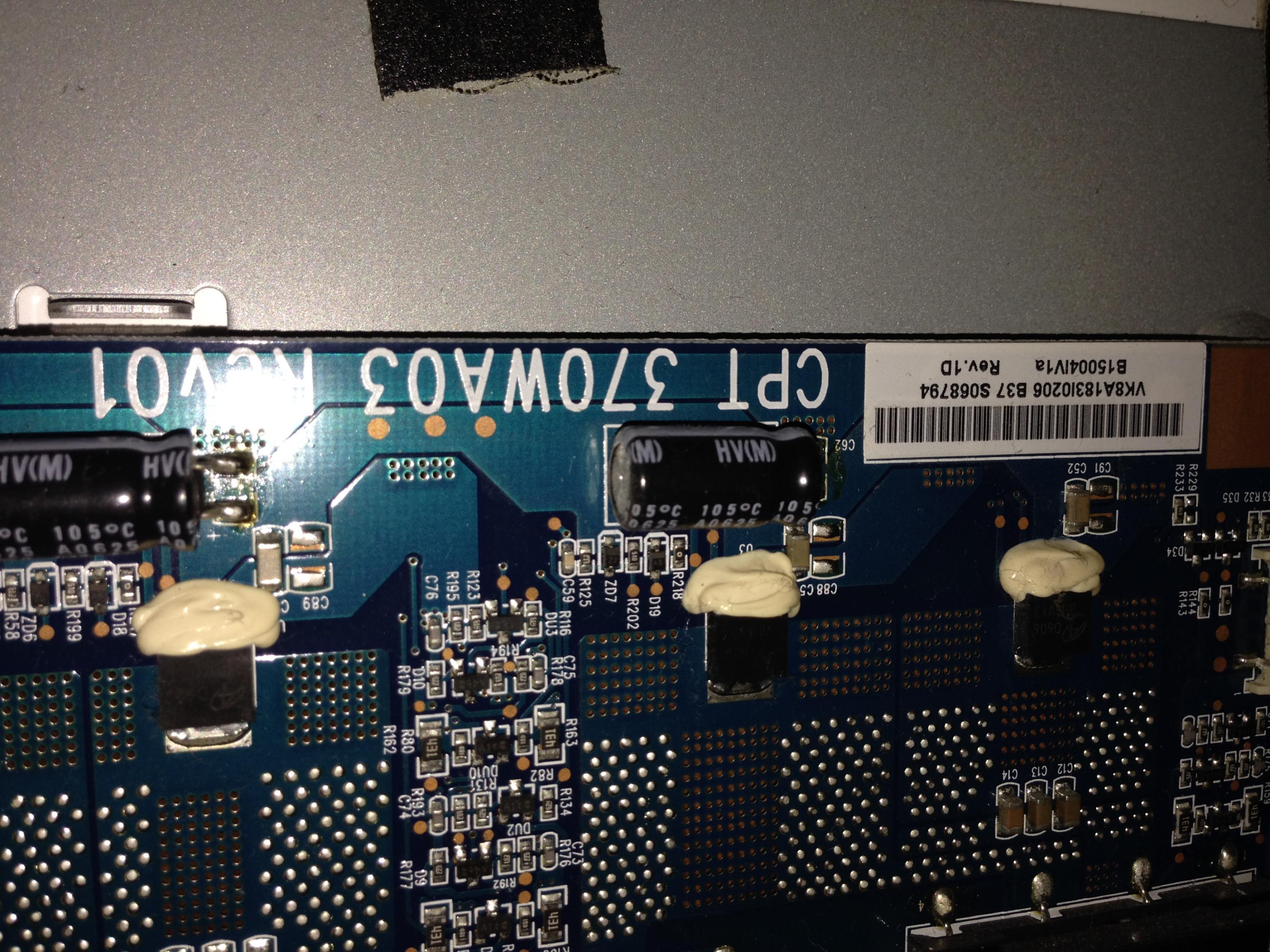

        There you go. These are from the Inverter. Do we need any more picture from any part?

          Famous DARFON transformer, check all the transformers
          Check the transformer windings resistance between: make sure to report if the reading is shown in OHM, K OHM, or M OHM.
          pin 1 & 8 = xxx OHMS
          pin 4 & 5 = xxx OHMS
          pin 5 & 8 = xxx OHMS

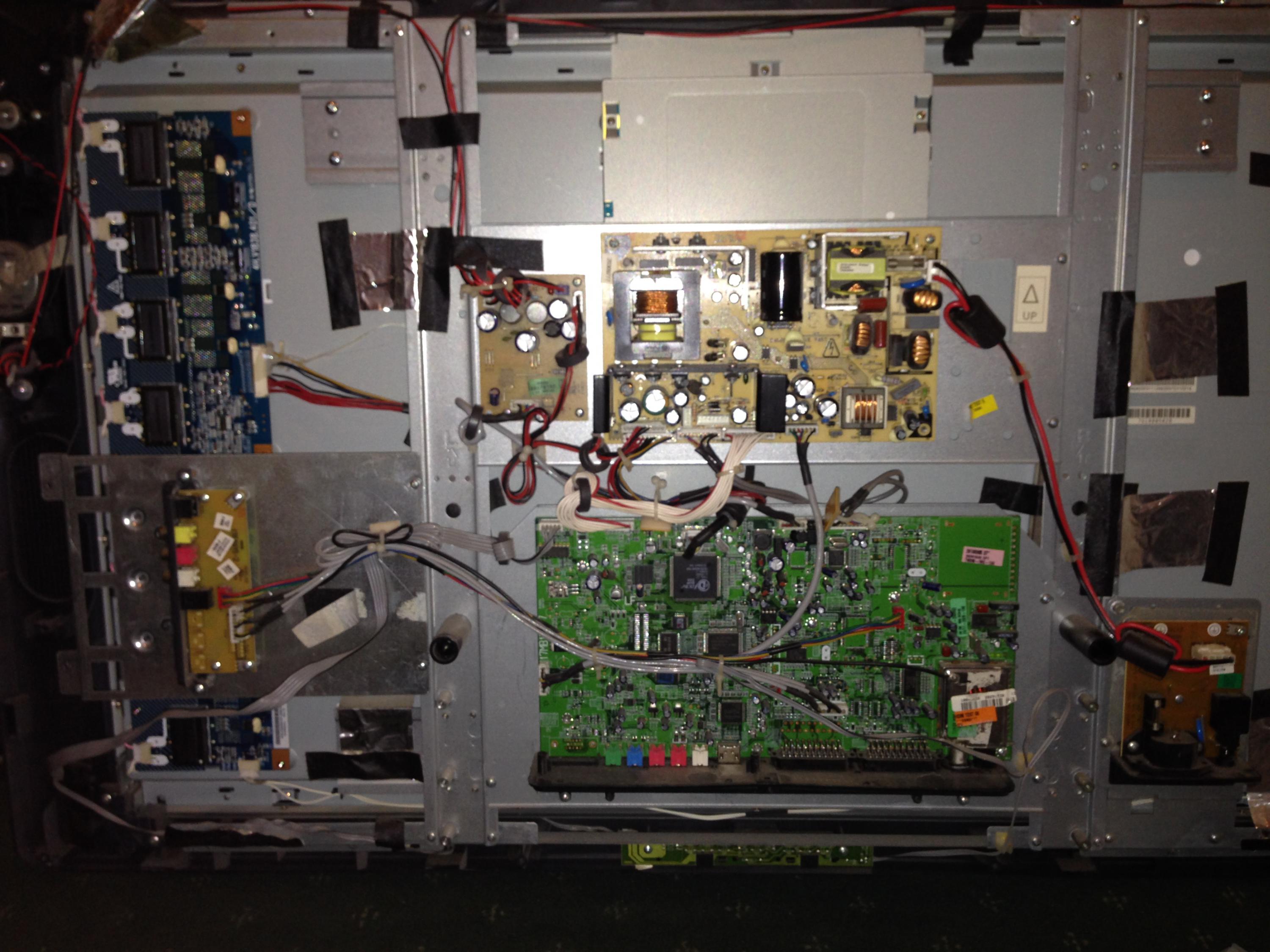

            These are the boards. This is a new PSU on the picture what I bought actually on ebay from a good seller. It was tested.
            Thanks in advance for any idea!

                pin 1&8= 2,2 Kohms
                pin 4&5= 2,2 KOhms but there was 1 transformer where 2,0 KOhms ( I guess it is fine)
                pin 5&8= 5,3 KOhms there was one where I measured 5,0 KOhms
                  Re: Techwood 37722HD after PSU change still have no backlight
                  Around here we figure that it should be within +/-3% from each other, so the 2.2K Ohms +/-3% will be 2266 Ohms on the plus 3% side, 2134 Ohms on the minus 3% side.
                  I would remove that one with 2K and inspect it closely.

                      The board pic doesnt really show enough - ideally we need the whole board even if its in a few shots
                      Straight on without flash. I can see 1 fuse but there may be more - can you test those as well.
