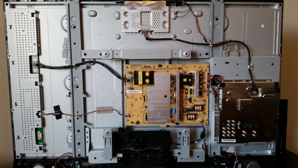

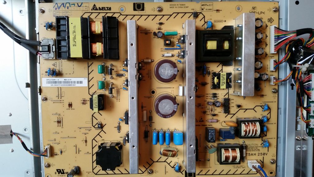

            Re: Sony Bravia KDL-46S4100 -- dead set condition
            BTW, how about good clear pictures of the back side of the TV and the power supply board.
            • gpenn01
              • Jul 2014
              • 7
              Hi Bud... thanks for the info... I have attached a few pictures as you have suggested. I am a bit uncertain as to the main filter cap you refer to... could you point me in its direction.
              Again.... thanks much....
                The two big brown caps, you must be real careful due to working in the primary side of the circuit.

                          I double checked the board and I am measuring voltages as follows:
                          B+ = 167V
                          B++ = 0V
                          Note: H.U.A. = Head Up A#%
                          • gpenn01
                            • Jul 2014
                            • 7
                            Update...
                            Replaced the G board.... unable to find this specific board (# DPS-275MP-1A) at ShopJimmy or any other places online... found and ordered a used one from Ebay.... installed it tonight and TV is now working....
