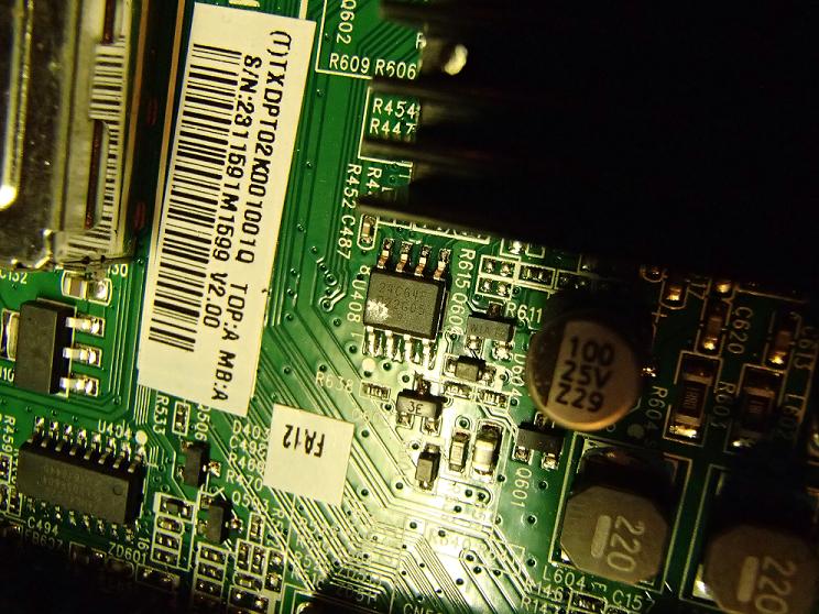

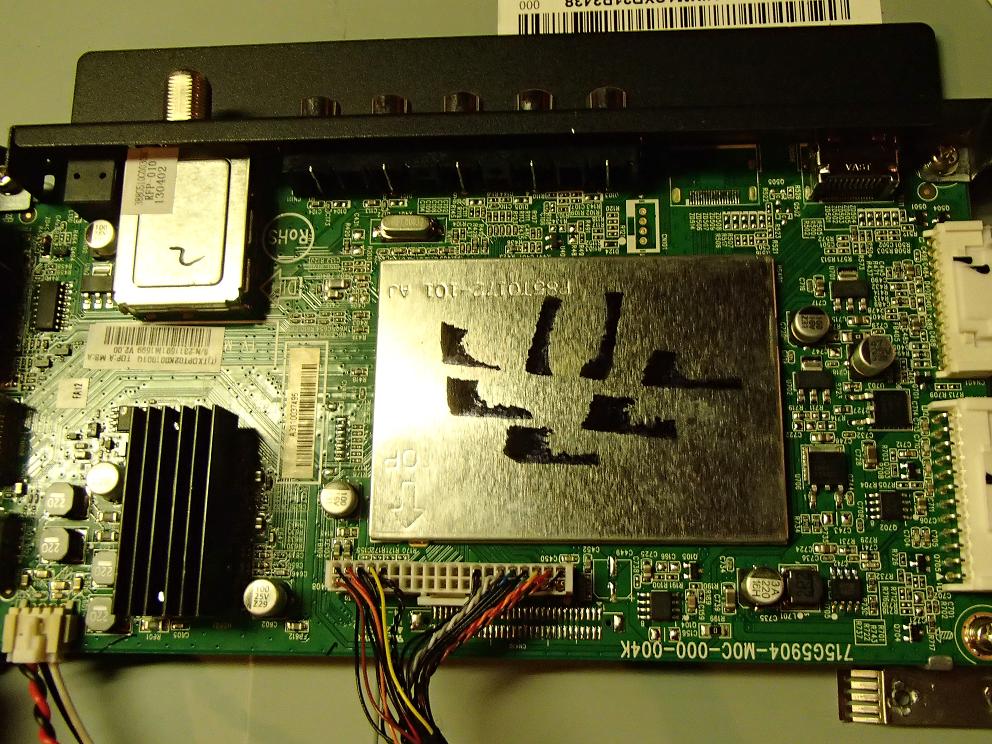

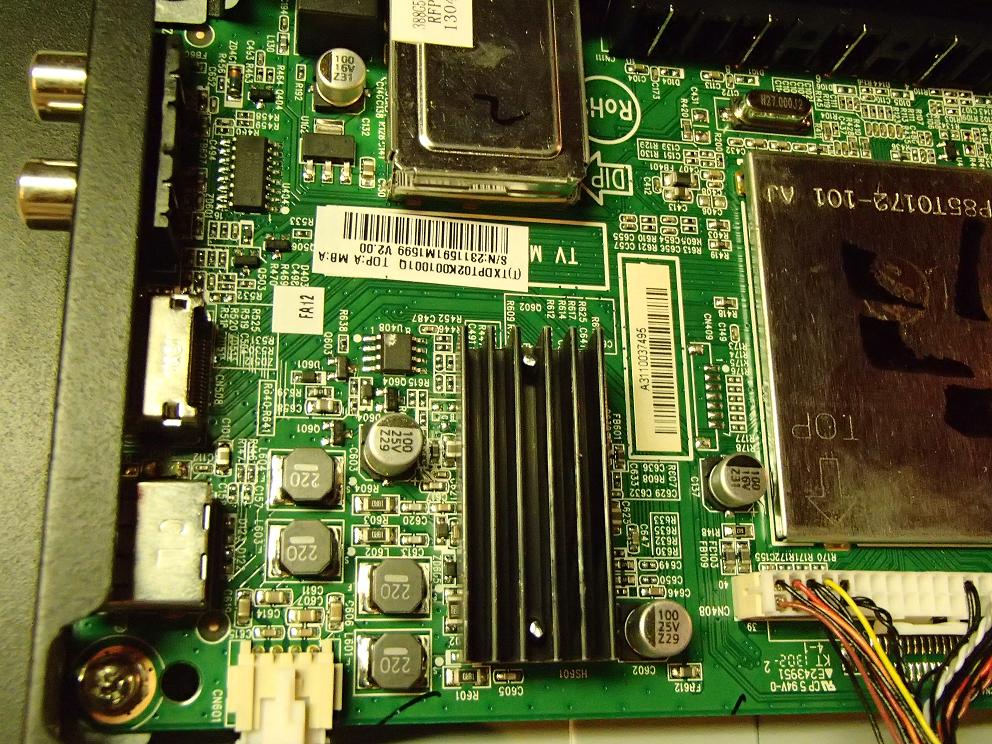

    Got tv from a friend, and it's not turning on
    When first plugged in, white light on bottom goes on, then fades out and no light are present.
    When power button is hit, the same white light goes on and stays on, but nothing else happens.
    Not getting any power at any of the terminals leaving the board to go to other boards.
    Noticed this tv has a problem with eeprom on mainboard, and it is a common issue, there is one eeprom on mainboard that has mark where others are clean, so think this may be part of issue. But don't know how to even find eeprom chip to solder in.
    Please let me know what i should be testing for.

      here are the pics hopefully
