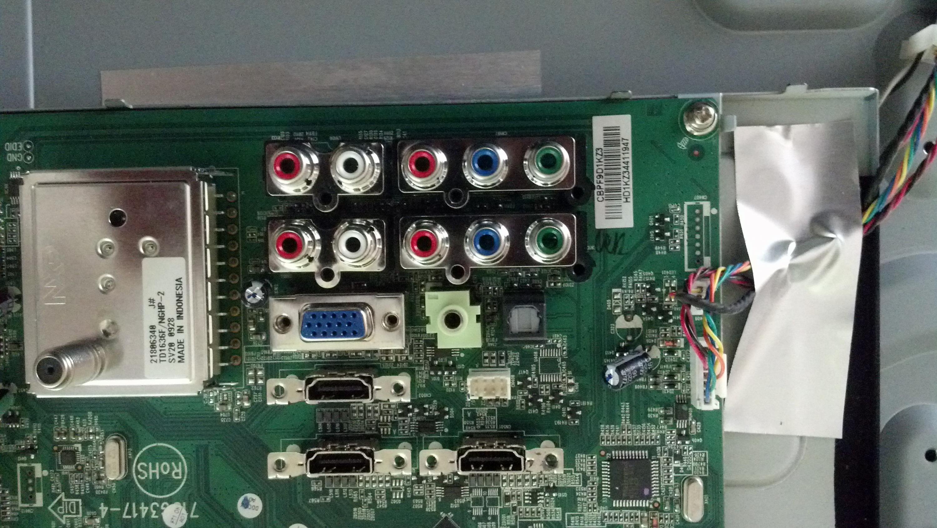

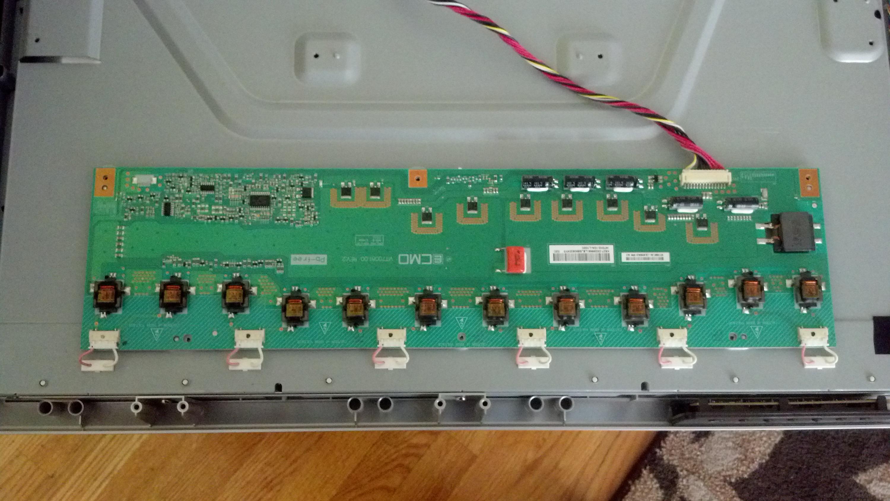

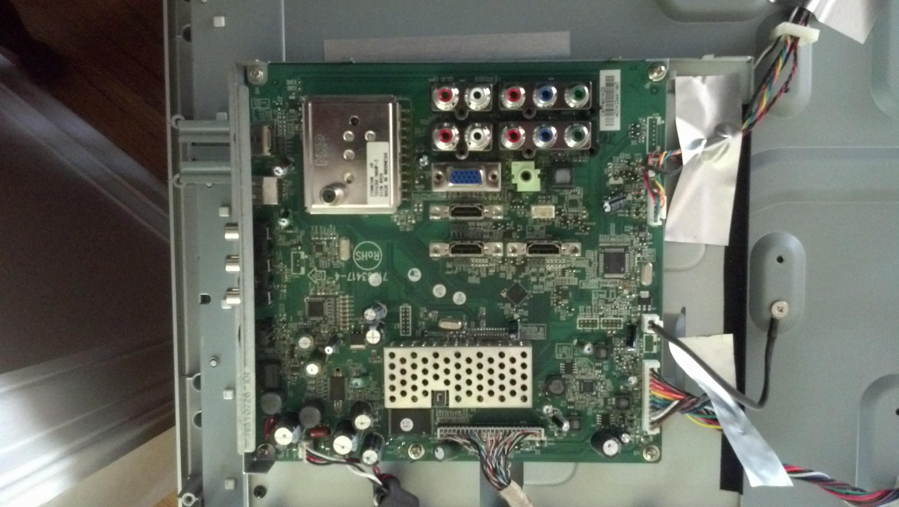

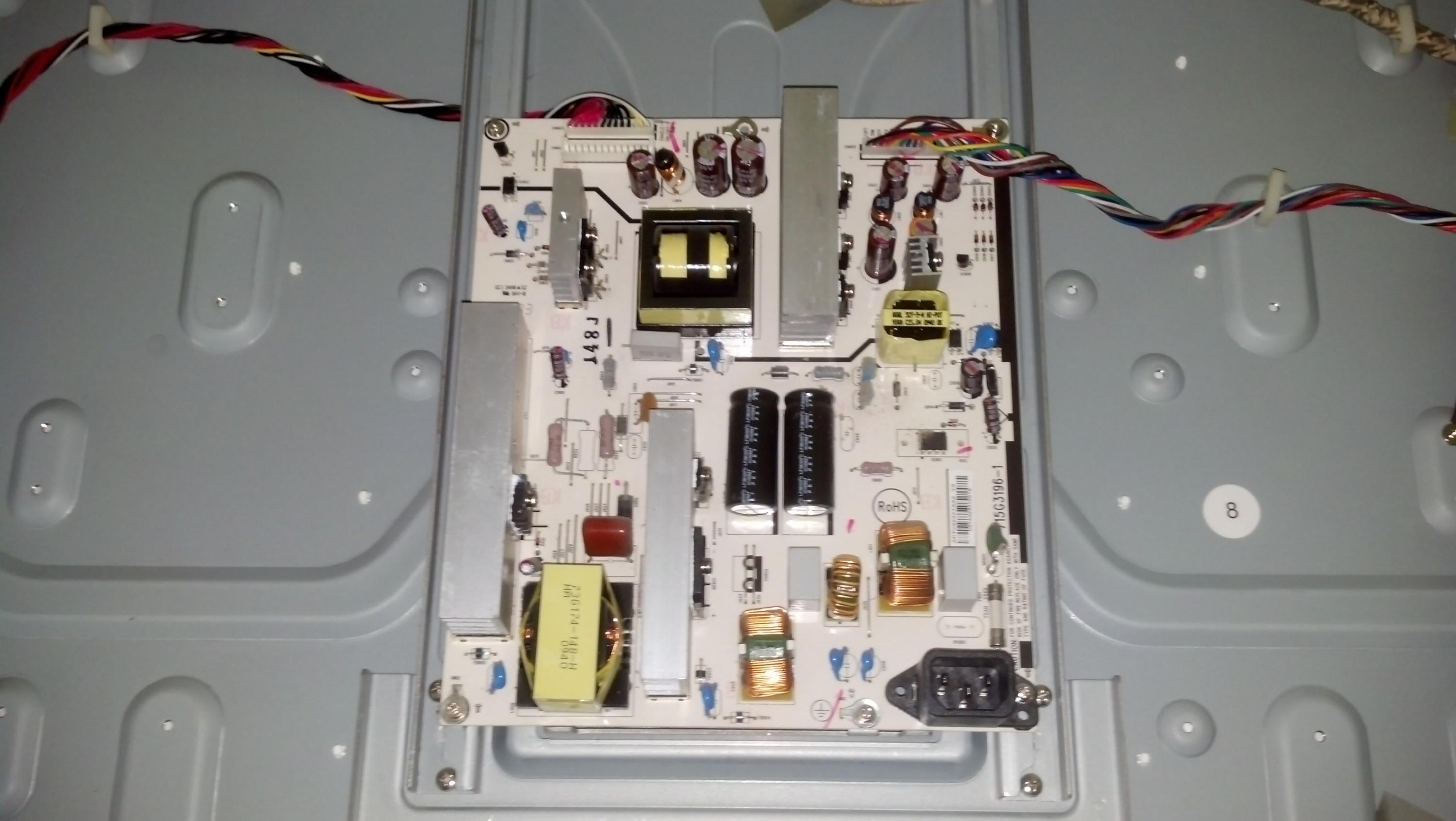

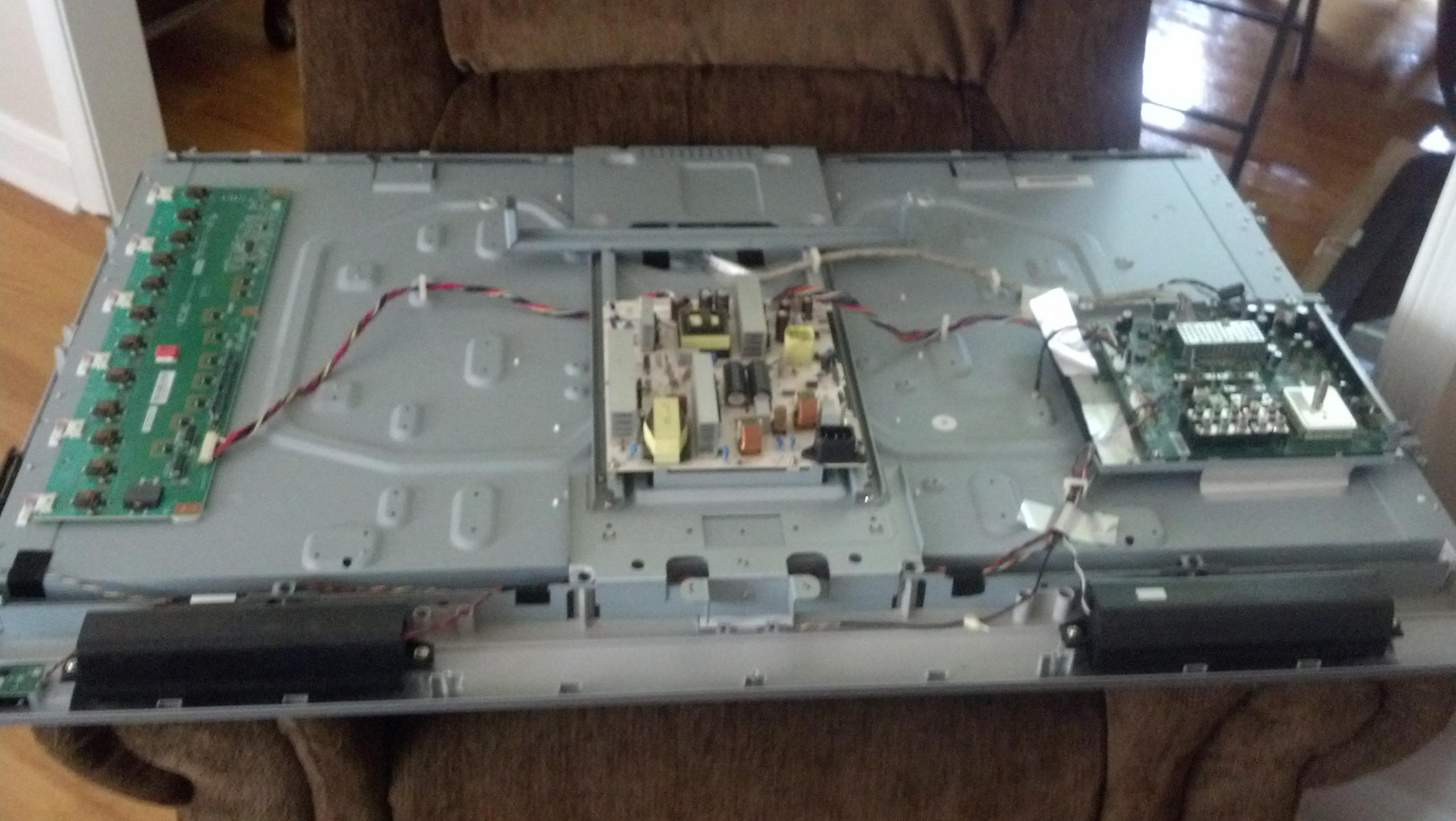

    How about uploading good clear pictures of the back of the TV so we can see all the boards, and then the pictures of each board so we can get you to do some Voltage testing to help narrow down the problem.

      I tried a bunch of times to get a good picture of the main board, all the capacitors are flat on the three visible boards.

        This model has power supply cap failures check your voltages on the 12v rail and 5v standby. I assure you it is 95% a psu problem most likely a 10v cap or two is bad. I replace all caps on Vizio psu's everytime they come with straight junk from factory, you were lucky to have gotten the mileage you did. Because the caps are not bulging doesn't mean alot on Vizio boards replace with Panasonic or better.

            Yep it appears that the 5v standby is working which is most generally the case ,but the 12 or 25v side is not because imho of bad caps on the psu. Beleive me 95% of Vizio failure is bad psu caps. Seen it hundreds of times. Check your voltages (if you can), then look at the caps on the psu,sometimes they bulge sometimes not but thats usually the culprit in Vizio lcd's. However if your baclights are working and stay on, and still no response then thats steering towards the mainboard.

                Ok if your baclights are on and stay on its not psu its most likely your main is going out or is already bad. hook up a source and try to get an image if not imho it's mainboard.

                      If the backligts are on, then you need to find out if the T-CON is getting the switched 12VDC feeding it or not from the main board, or the SMD Fuse on the T-CON may have blown, right now we are clear as to what you are seeing on the SCREEN.
