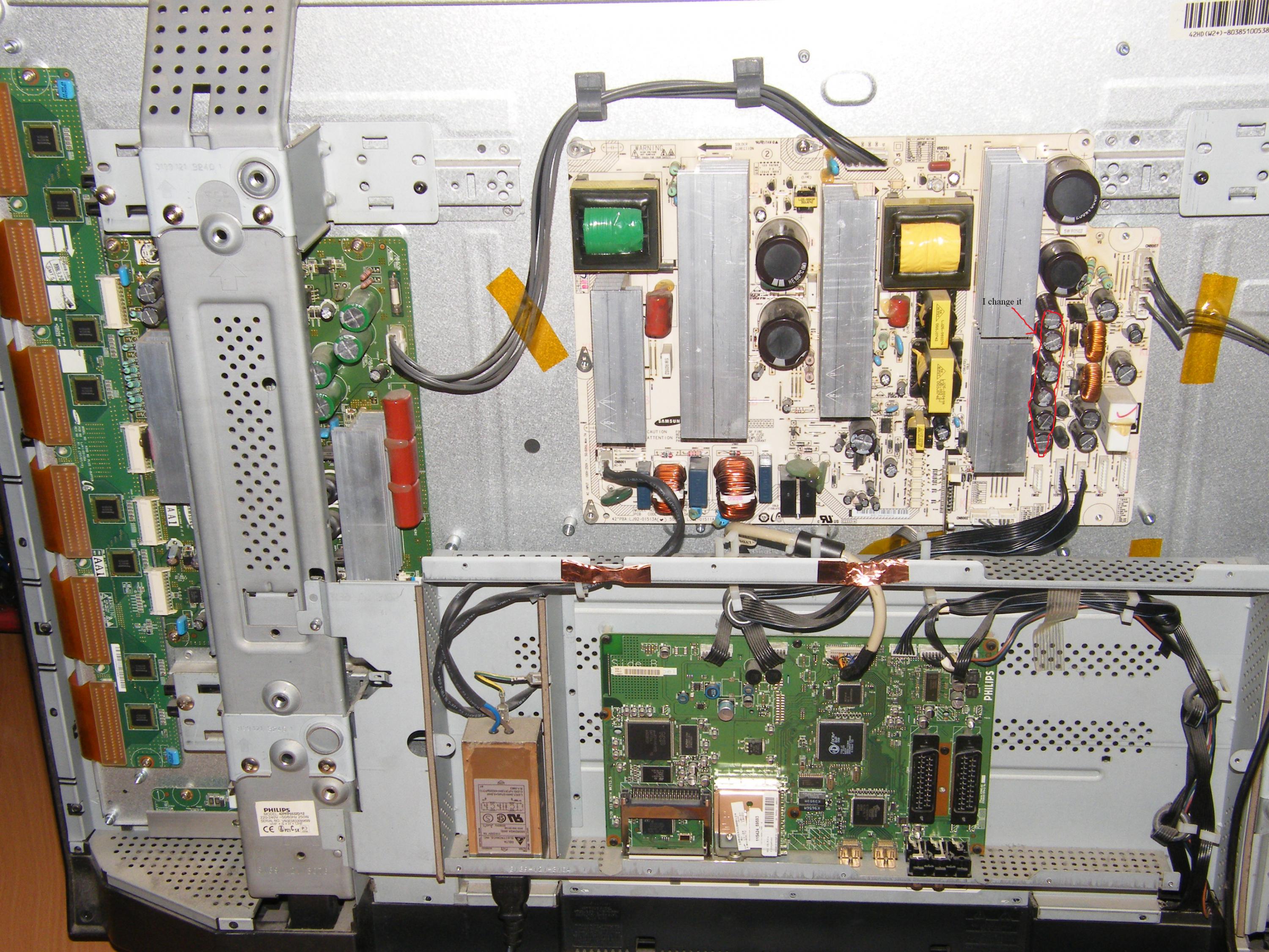

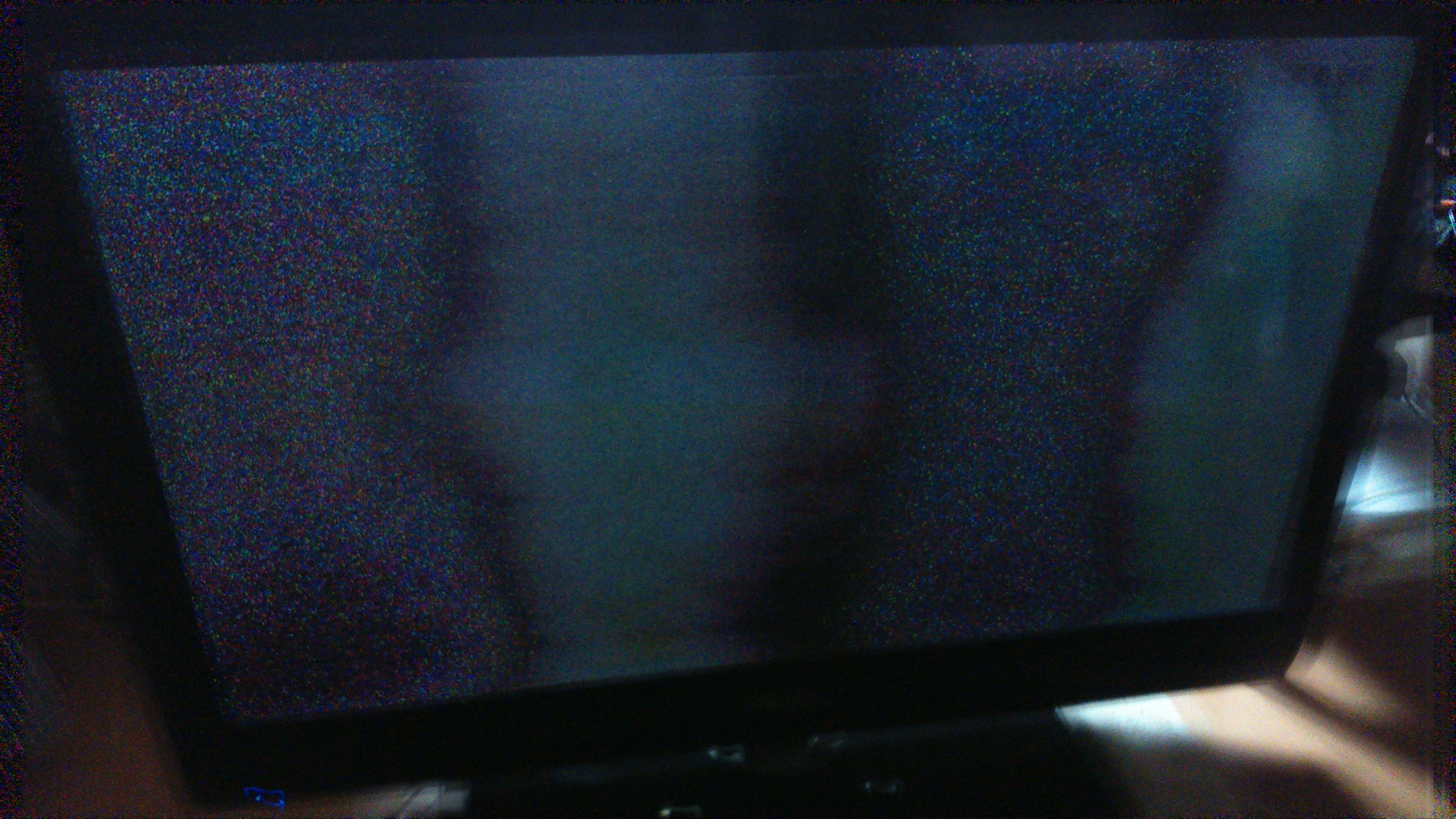

    I have big problems with my Philips TV brand model 42PFP5532D/12 I'' ve put a photo, I have sound and no picture like the picture thanks

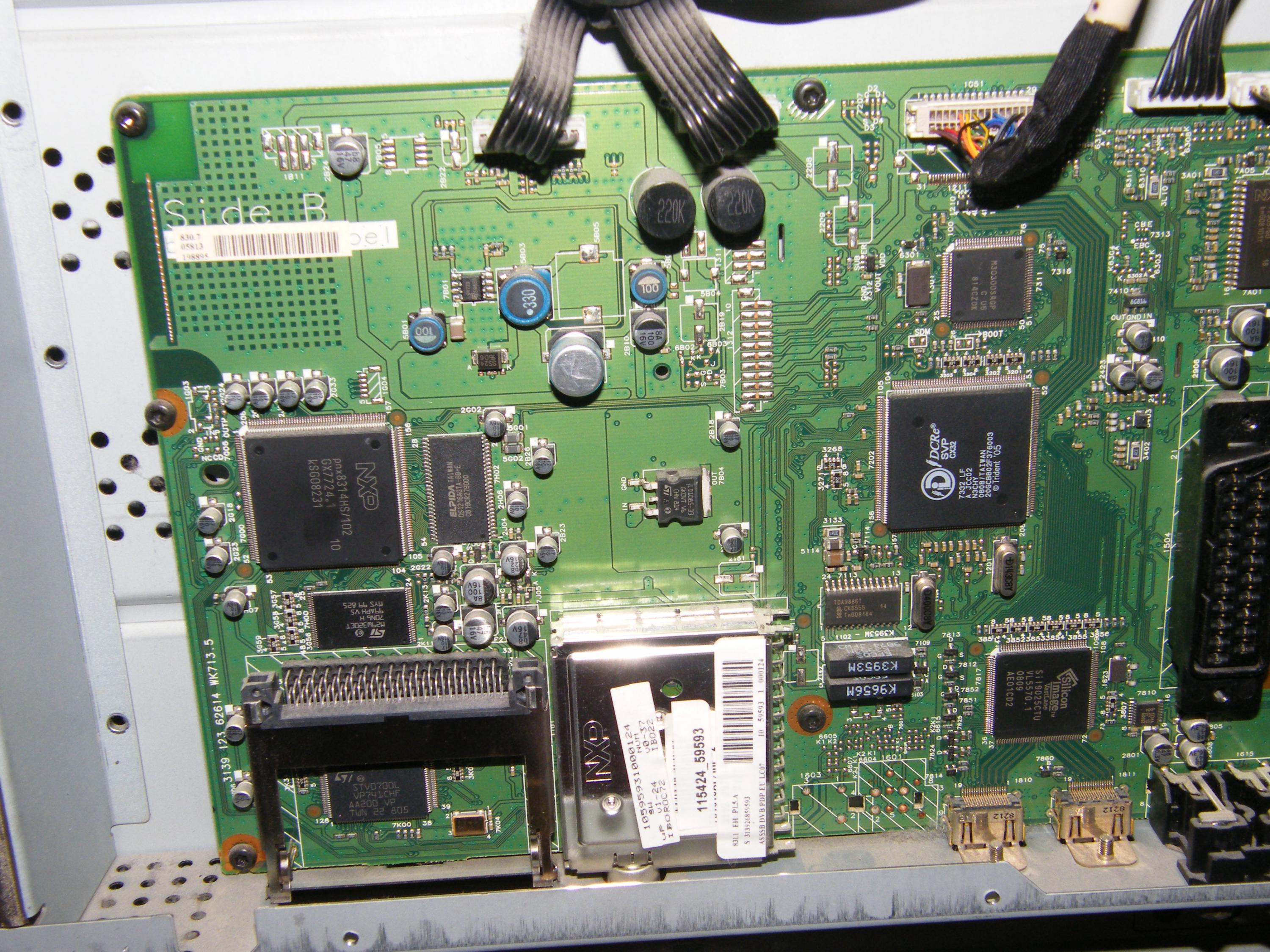

        Good clear pictures of the boards?

            I'll take pictures and put them

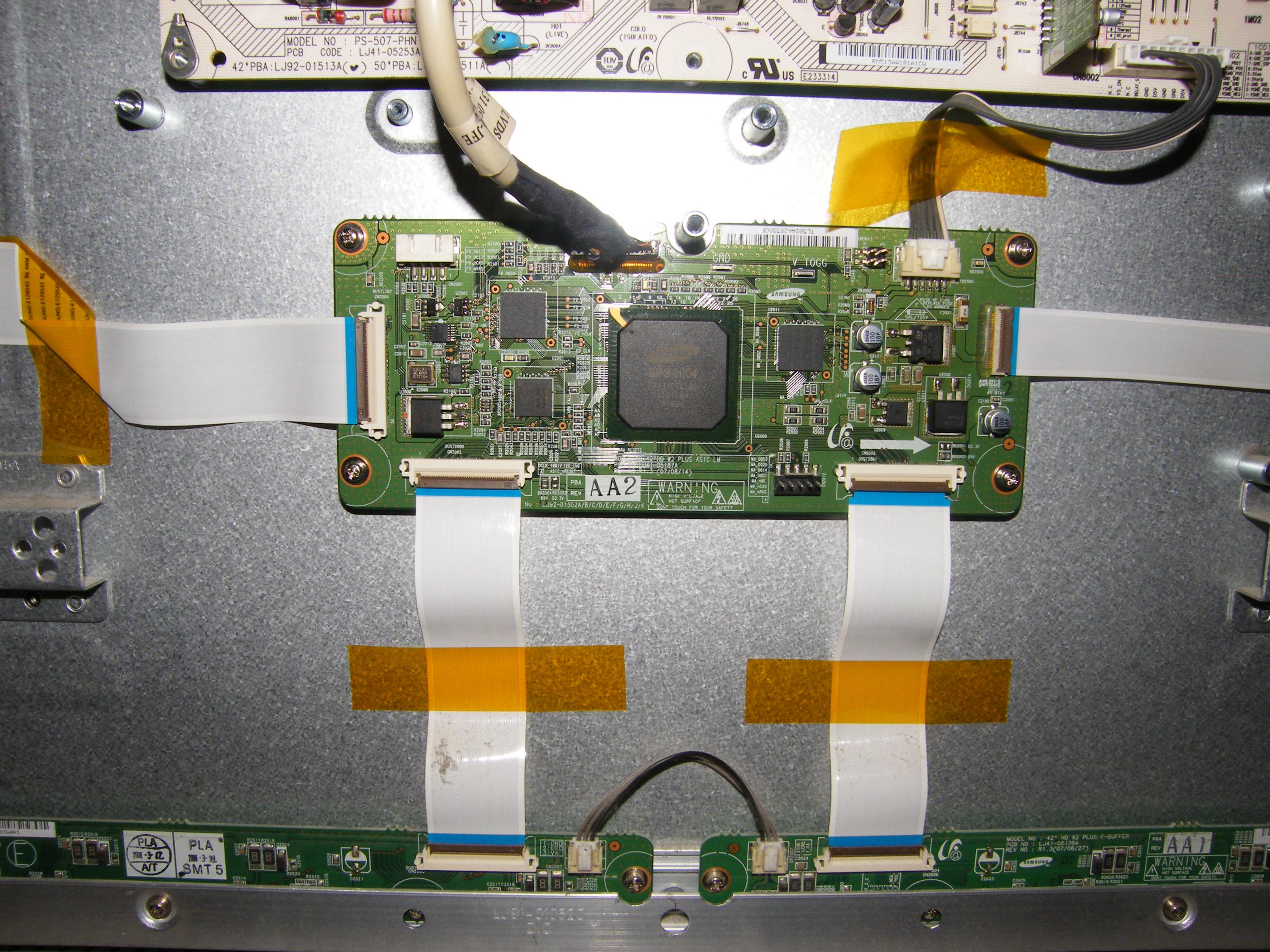

                Please take a picture of the control board, located under the main board.

                  There should also be a lvds board like this
                  https://flattvparts.co.uk/bmz_cache/...ge.570x286.jpg
                  Thats my guess and or cables otherwise a bad panel

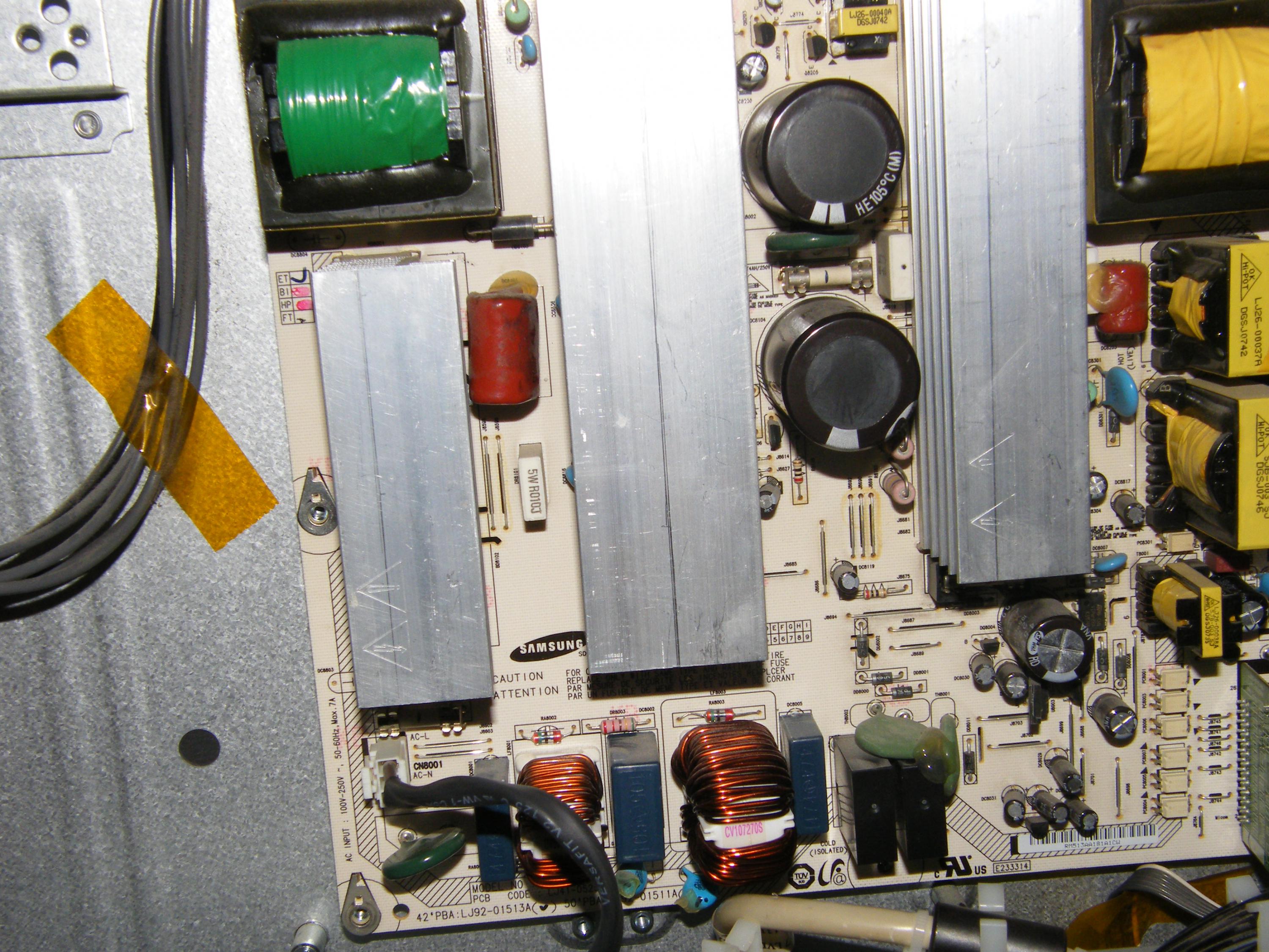

                      • 30997
                      Re: s'il vous plaît vous m'aider philips 42PFP5532D /12
                      interesting,
                      a phiilips main board linked to a samsung psu & display boardset.
                      it's not a good idea putting the power supply in with only one screw.
                        • 30997
                        cable at bottom-right is not in,
                        and who has been soldering some parts on that board?

                              Small white fuse F2001 ok?
                              What voltage on each side of it with respect to ground screw?

                                Hello there
                                Here I change the capacitors on the power board but I sound more picture, I'm looking for the diagram of this TV
