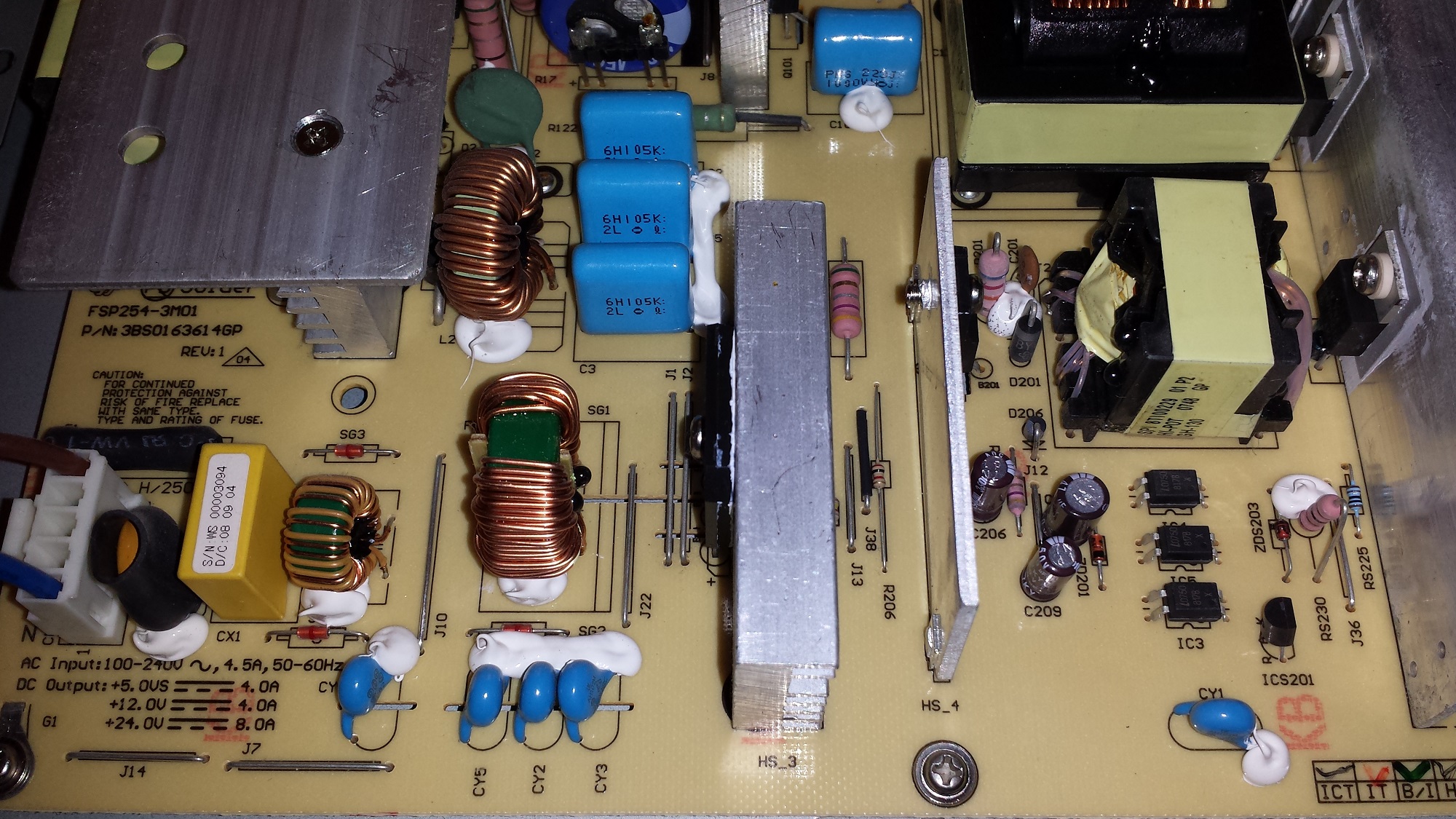

    First post, so please be gentle

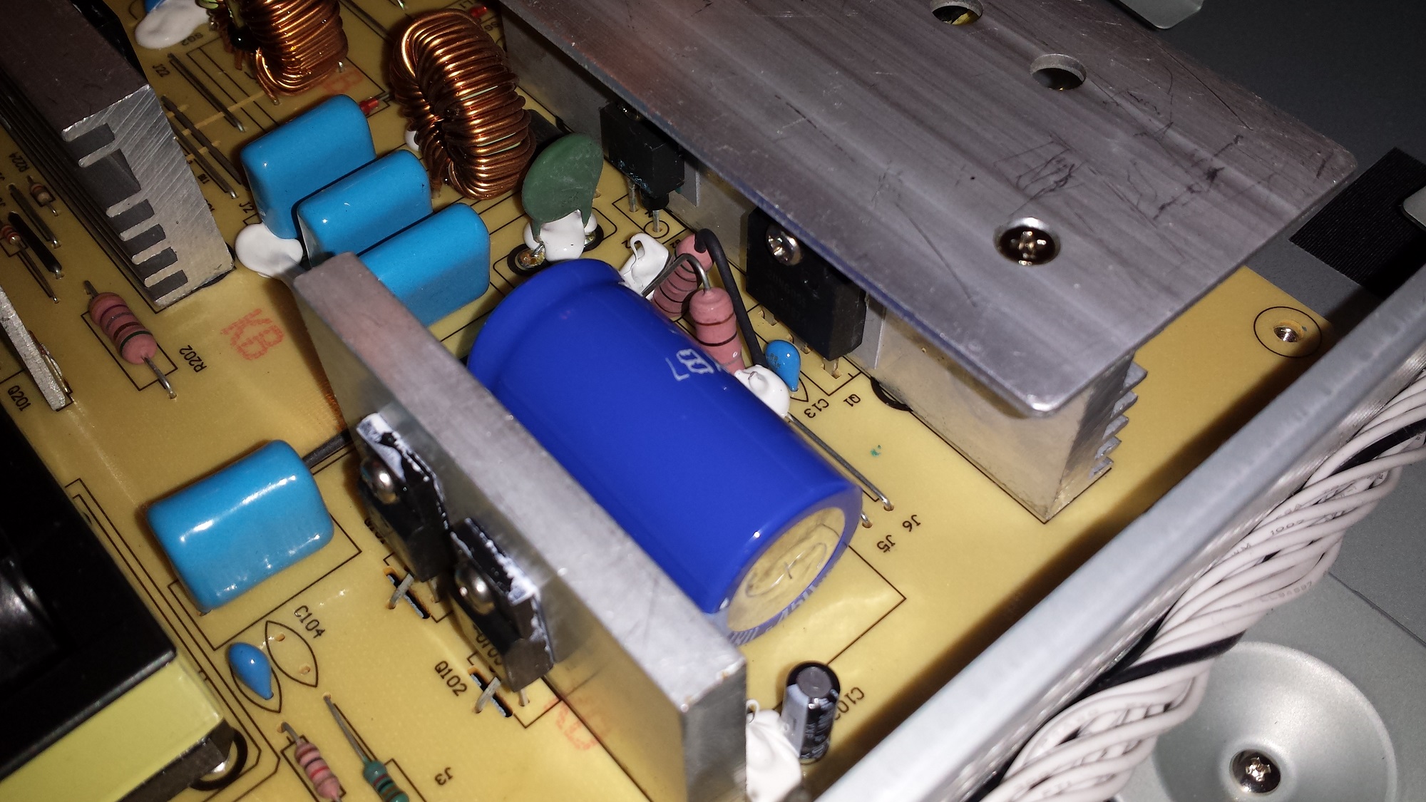

    I have a 42" Vizio LCD that doesn't consistently go into standby when you turn it "off". It usually goes from white light to no light (no orange light). In order to get the orange light working again, I have to unplug it for a few seconds and plug it back in. (EDIT: To be clear, the TV turns on and works normally when you reset it and have the orange light on).

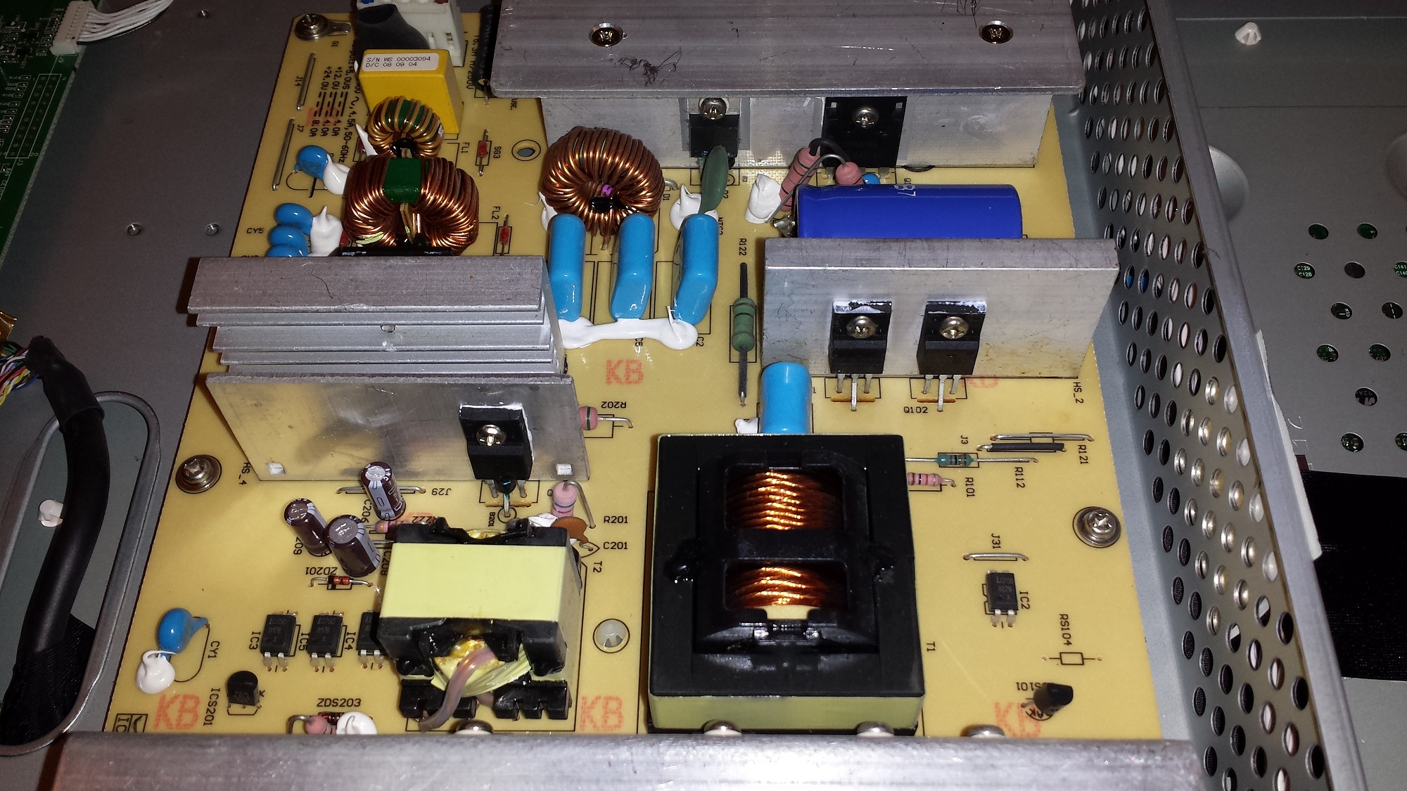

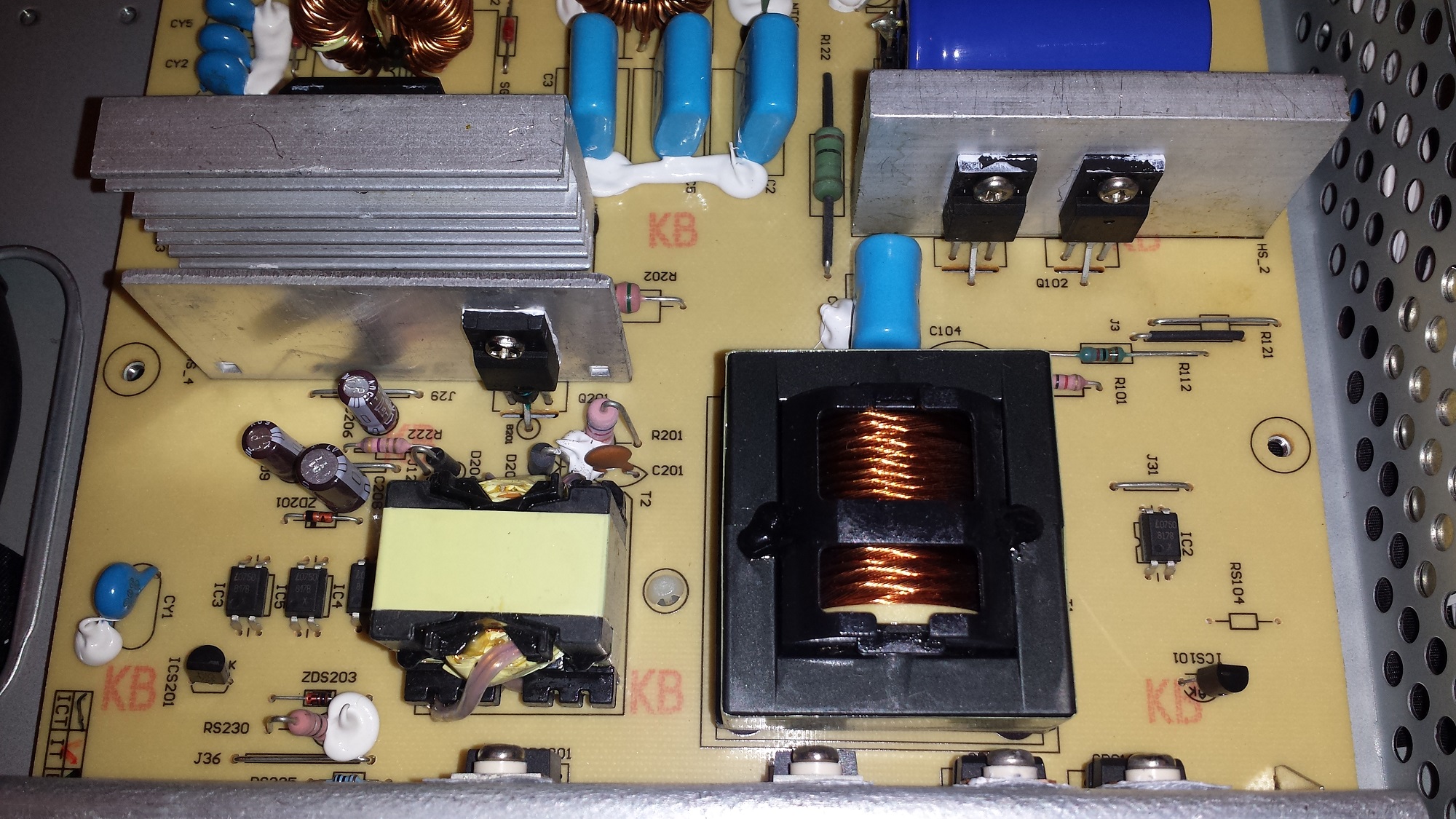

    I took it apart to do some investigating (thanks badcaps!), and found the power board to have a very light humming/buzzing sound when the set is plugged in AND the orange light is on. I can't tell where on the power board the buzzing is coming from. When the orange light is off, there is only silence (and the TV cannot turn on).

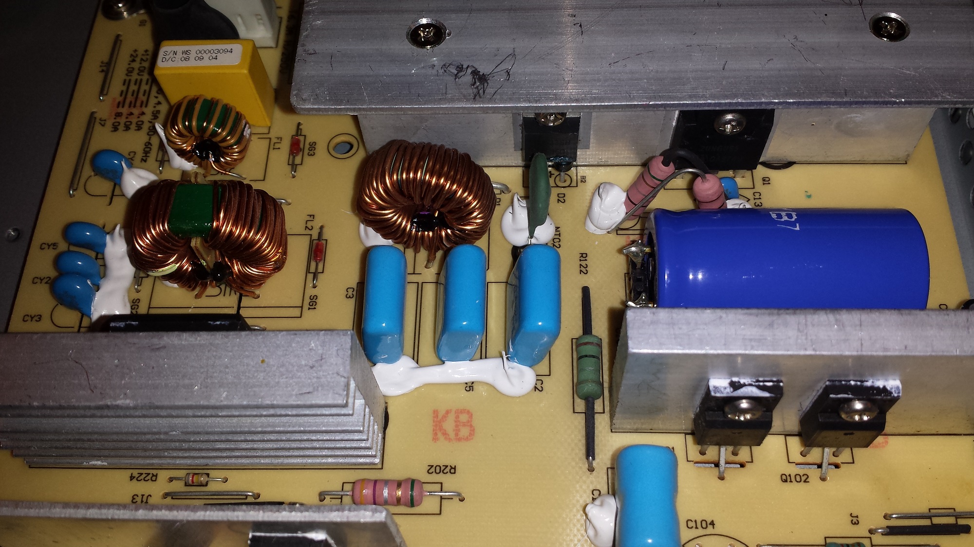

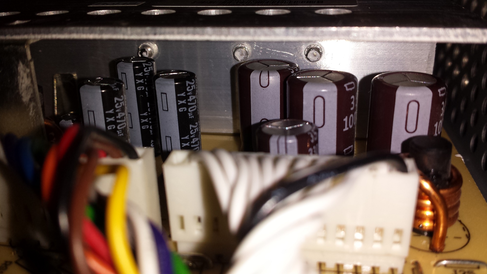

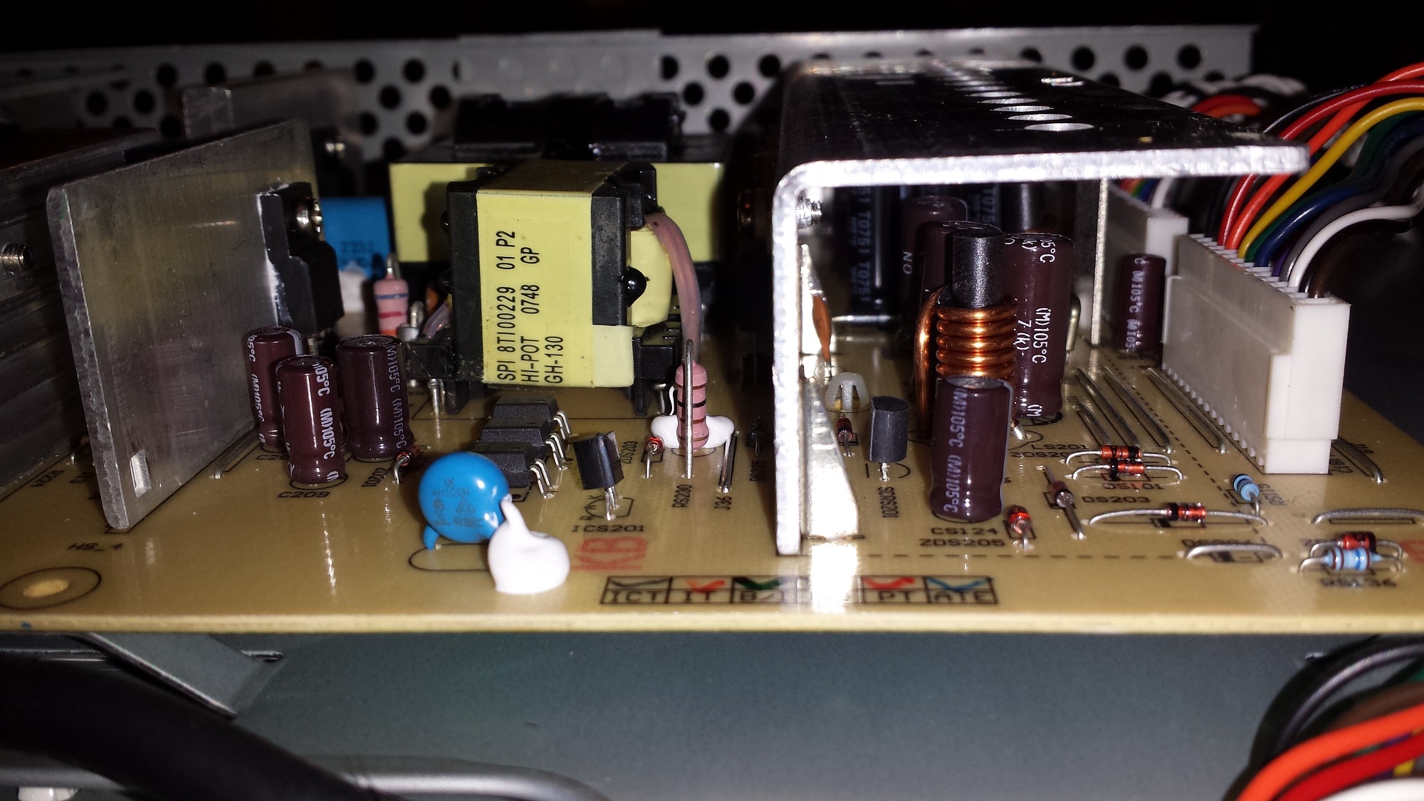

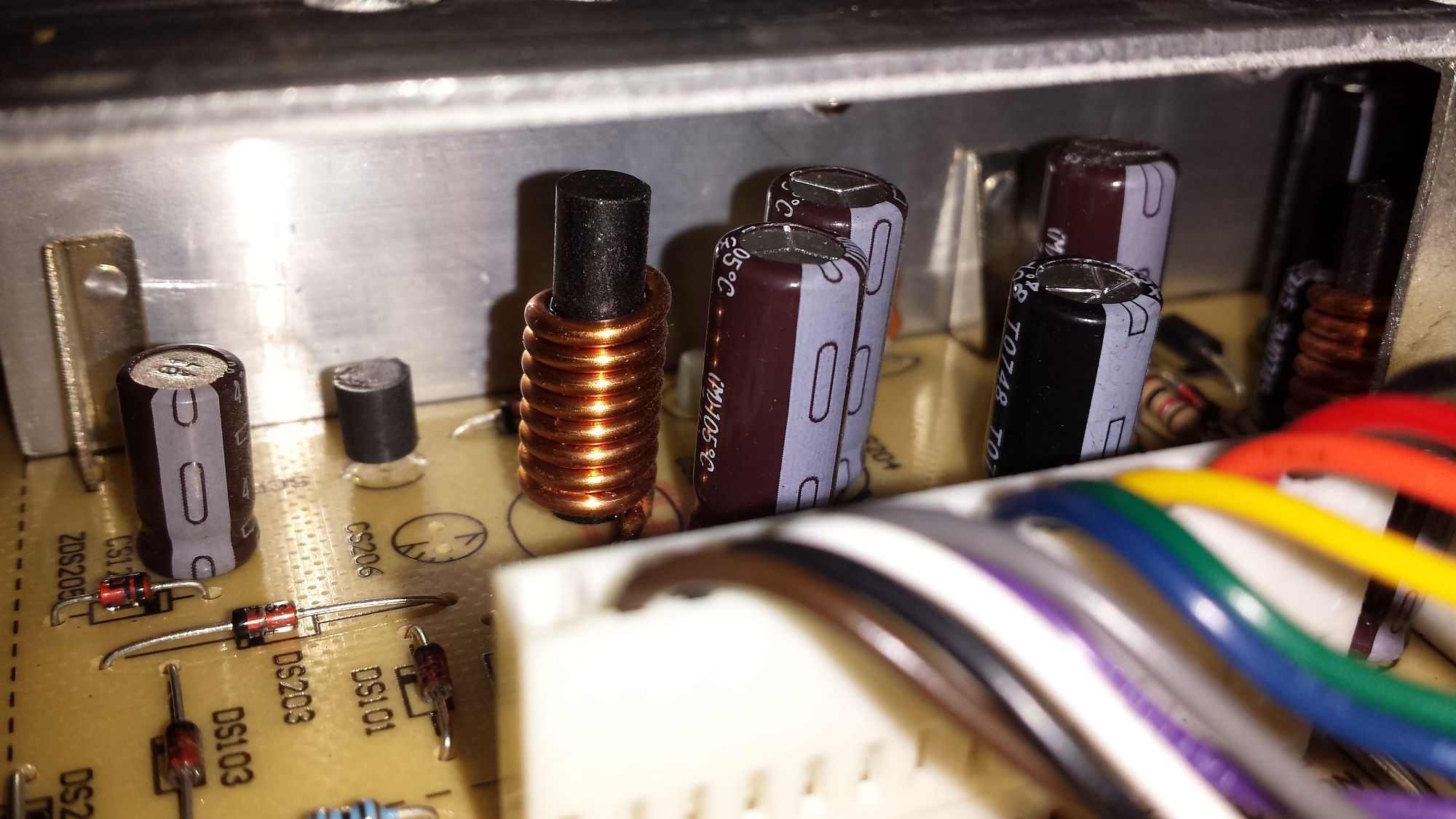

    By this point, you might already suspect bad caps in the 5v rail. I thought the same, so I visually inspected the tops of every cap on the power board...no bulging/burning (see photos) or other obvious indicators (to me) of a bad cap. I'm not sure if its possible for another component (xformer/vreg) to cause this specific issue...so I'm kindly asking for your thoughts on the issue before I start replacing every cap on the board.
    Thanks for your input!

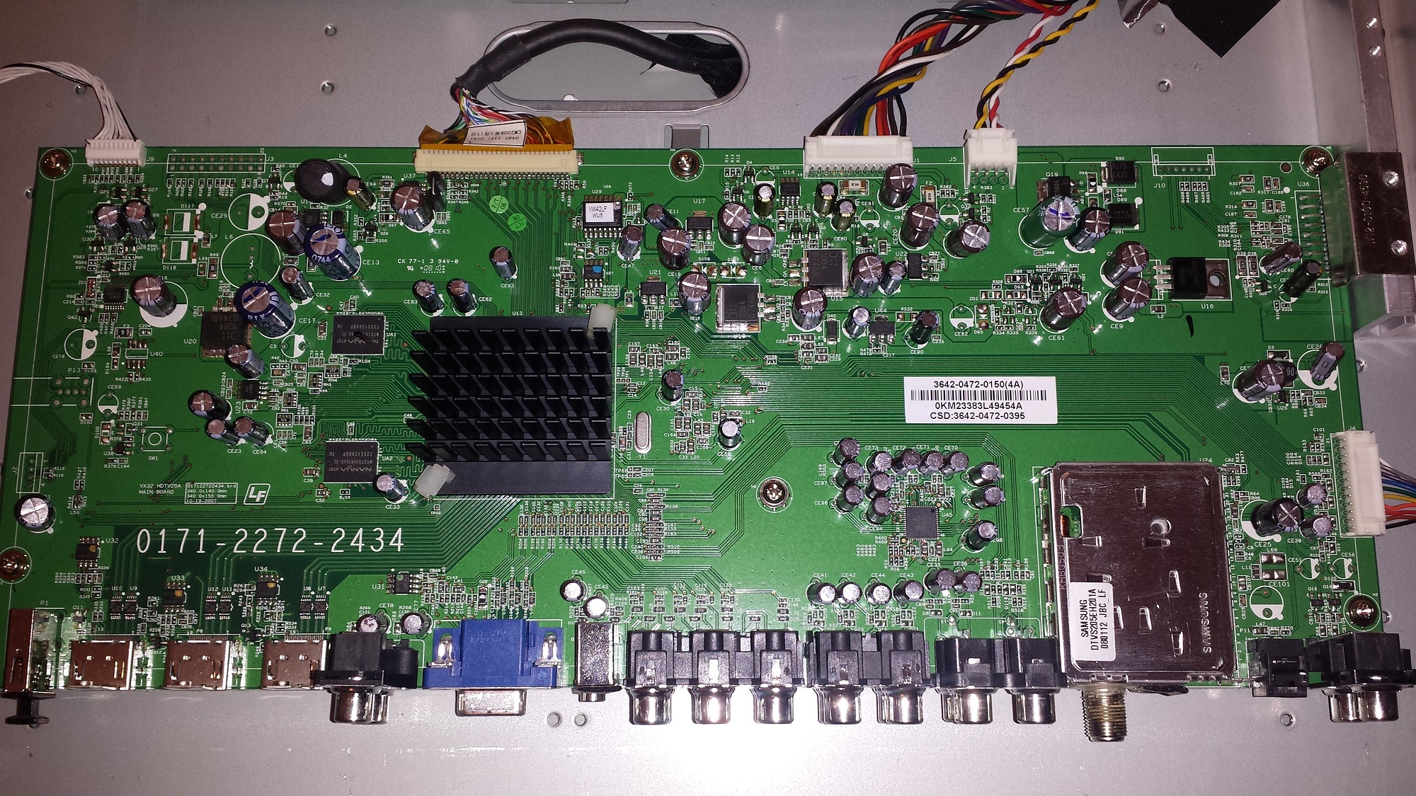

    Mainboard measurements are below, although I don't think the problem is on the mainboard (photos attached also).

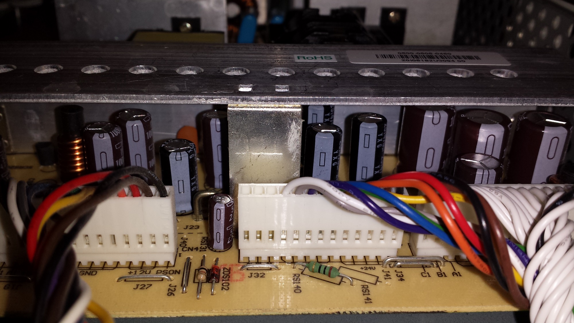

    Power board output connector to mainboard (with tv on):
    >space
    >4.99v brown (B1)
    >3.36v black (A1)
    >5.23v white
    >5.23v gray
    >5.24v purple
    >(space)
    >0v blue
    >0v green
    >0v yellow
    >(space)
    >12.27v orange
    >12.27 red
    >12.27 brown
    >1.93v black (PSON)

    Re: Vizio VW42lfhdtv10a - No standby
    To keep you busy till somebody smarter then me jumps in: When it's in failmode(no amber light) do you still have the 5v standby ?

                Thanks budm. I read the basic troubleshooting. The power board troubleshooting does apply. I measured the PS_ON output voltage with the TV on at 1.93v...does this sound like the correct voltage, or could it be just enough to get things going? (You quoted 3.3-5v in the tutorial).
                I measured everything I could coming off the mainboard - and all looks normal to me except U21. Problem is, I have no idea what u21 is supposed to do.
                I keep circling back to why this problem would be intermittent (and slightly noisy), unless it were a bad component (e.g., U21) in the 5v circuit. Wouldn't this failure mode cause the front standby light to die, and system to not turn on?
                  So, then when it is in failed mode, do you have the 5VSTANDBY or not? You can also tell if the PS_ON is high enough by measuring the DC Voltage RIGHT AT THE TWO LEGS OF THE MAIN filter cap (big blue cap laying on its side), it should have about 160~170VDC when TV is OFF and about 360~400VDC when TV is ON. See if that voltage also drops down to 170V when the TV failed.
