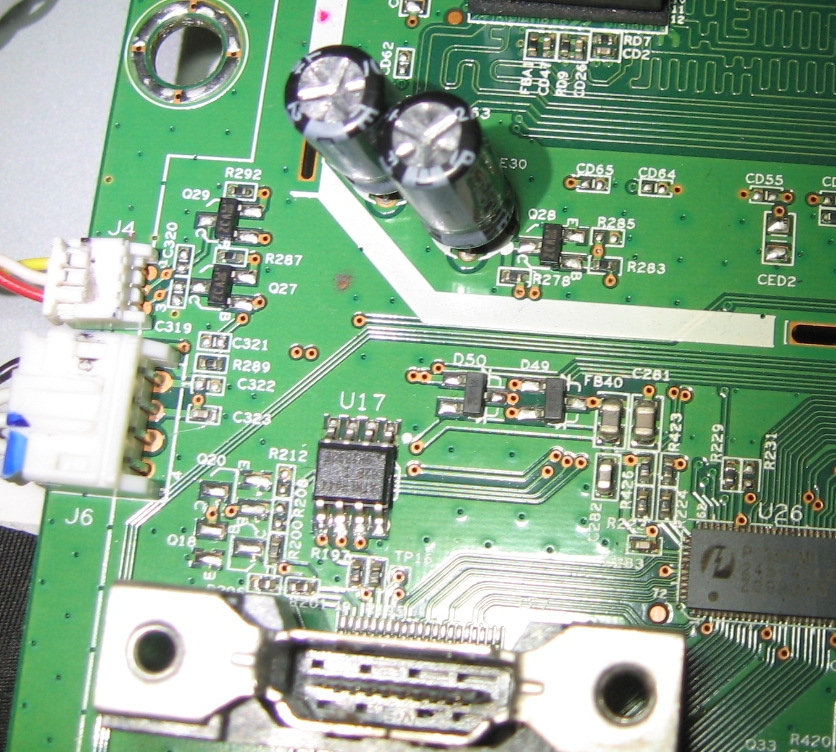

    My TV was working fine, but lately I noticed that sometimes it doesn't respond to remote, which didn't bother me much because I mostly just need turn it on and off because I'm using it with player only. Lately it got worse, now I hardly can get remote to work with it at all. Tested batteries on remote, programmed universal remote - problem still exists. I had similar sensor board from 42" Vizio so I tried to replace - it still the same. Right now if I'll turn it on manually, and would press volume button on remote continuously, sometimes I'm getting response, but it stops and starts responding in random. It does the same with both sensor boards. Solder joints looks OK and tested OK with continuity tester. I'm adding pics of sensor boards - only difference between them is that board from another TV had ZDR1 component and original does not. They little different in size, but that board respond to remote sometimes too, so I think they pretty much the same. Anything else I should look at?
    Added pic of main board too, part where sensor connects to it.

        J6 IR connector
        Good board:
        Black wire 3.88V
        brown wire 5.08V
        red - 0V
        Bad board:
        Black wire 1.57V
        brown wire 5.0V
        red - 0V

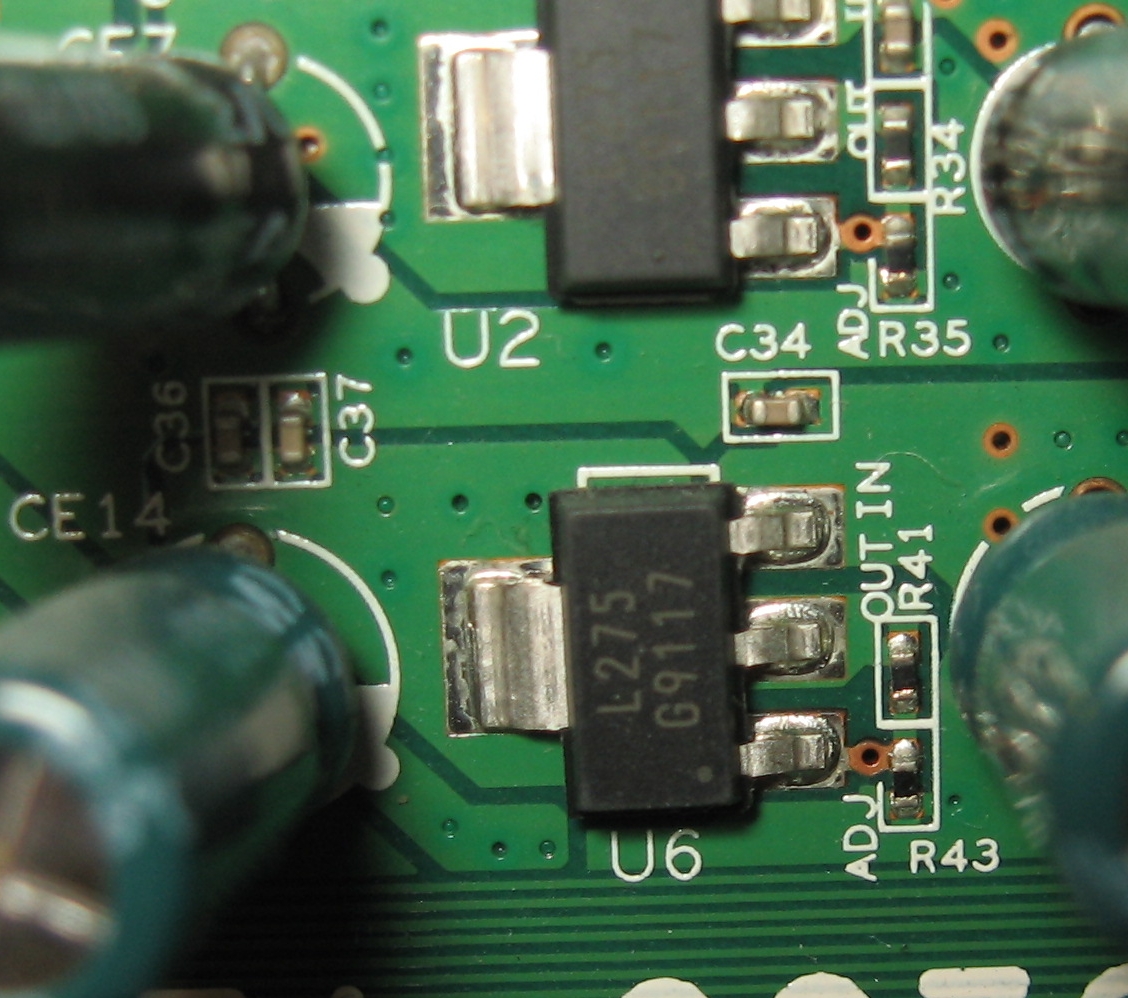

              Need a good photo U4 and U6
              • sansonet
                • Nov 2013
                • 236
                • US
                Re: Vizio SV470M IR sensor problem
                Here are pics of U4 and U6
                  "U6
                  PIN1 12.00V
                  PIN2 8.00V
                  PIN3 6.75V"
                  Are you sure you looking at the correct in/out/adj pins?
                  1 = adj
                  2= out
                  3 = in
                  U8 is fine, it is 5V regulator.

                    Sorry, I posted it in reversed order, correct readings:
                    PIN1 6.75V
                    PIN2 8.00V
                    PIN3 12.0V"
                      1117 adjustable, the output voltage should always be = to 1.25V ref + V adjust, so for this case the out put should be 1.25 + 6.75 = 8V, so it is OK.

                                Long time with this post and no final answer as to the solution. Well I got one and I have the same problem. I been lazy these last few months but I got me a Sprinter Van now so I can get some of these fixed TVs out of my way and get some more fixed.
                                So I have this Vizio SV470M and the remote does not work and the volume does not work at all. I can still turn the TV on and off. Going to open it now and check the voltage regulators.
                                OK, so I do not think it is the regulators. I am going to suspect the EEPROM.

                                    I can program them myself. I already installed a new EEPROM but I need to test the TV more tomorrow. I was able to turn the volume up and down with the buttons but I need to connect a DVD player and test the remote. I will leave an update when the test is complete.
