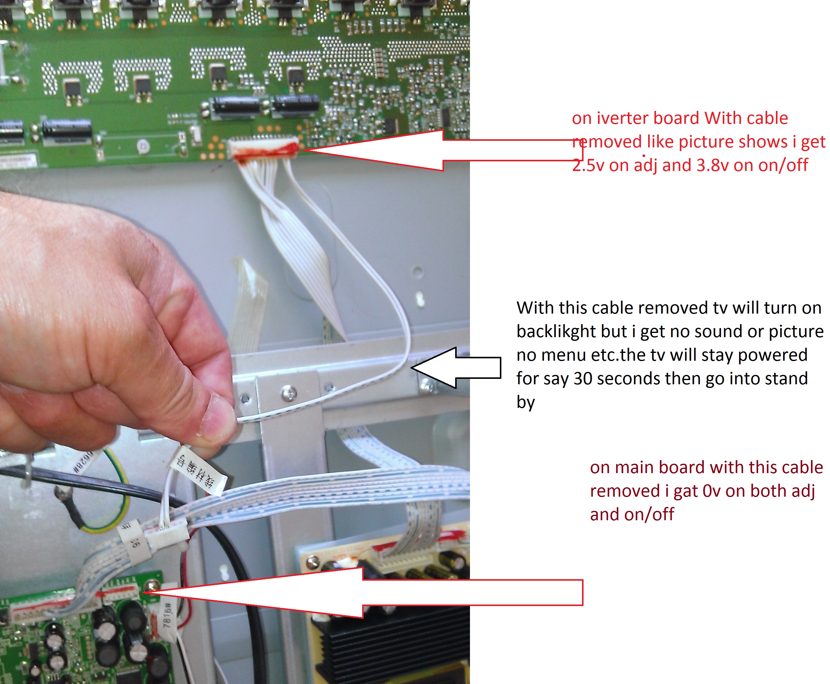

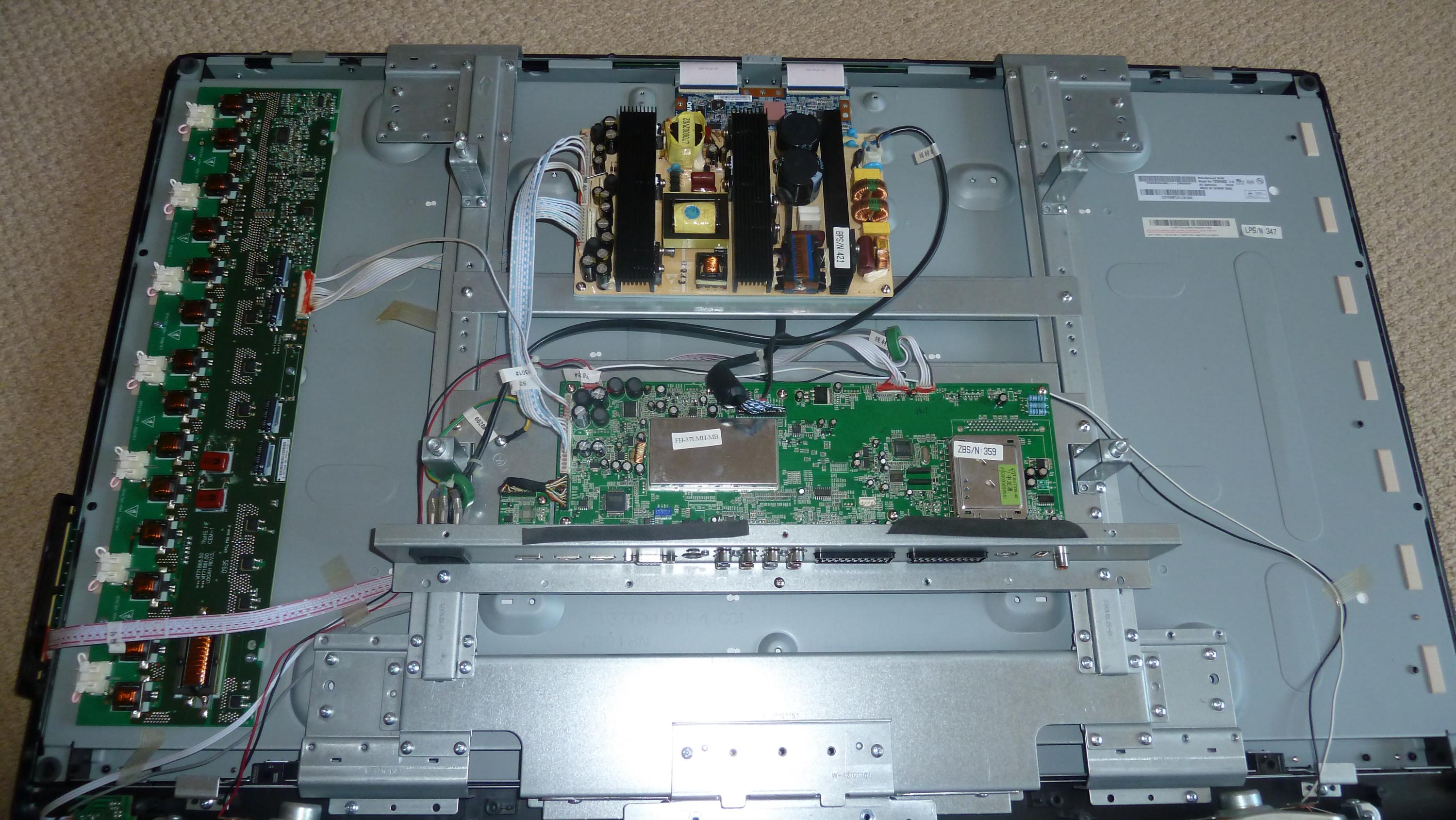

    Hi
    Need your valuable help again.
    I have this tv it powers on and then goes into stand by mode (no picture sound or backlight).I have done a bit of trouble shooting.
    1. all voltages ok coming from power board (no bad caps)
    2. I can get the backlight to work if I disconnect the on/off and adj plug from the main board to the inverter.( with this disconnected screen will light up but will shut down again into stand by mode)
    3. With this lead disconnected I get 0 volts on main board from the pin on/off and adj pin. And with this still un plugged if I test the on/off and adj pin on inverter in getting 2.5v on adj and 3.8v on on/off
    Do you think main board or inverter board ?
    Thanks for your help
    Mark
    ps can post pics if this helps

    Re: Foehm & Hirsch FH-37LMH 37" lcd no picture sound or backlight
    Hope this picture helps explain it for me.

          Hi Selldoor
          Thanks a lot for your reply. I cant get any picture or sound or menu etc have tried your idea of connecting dvd player and changing source but still no joy have connected xbox as well with no joy.
          I have monitored the on/off pin and the adj pin.
          in stand by the on/off pin has 0 volts off stand by 0 volts back to stand by 0 volts.
          in stand by the adj pin has 0 volts off stanb by 0 volts back to stand by 5 volts but quickly drops to 0 volts.
          Looks like main board not giving inverter signal to turn on
          Im thinking main board what do you think?
          Mark
            I know very little about tvs - it does look like main board is the problem but others may suggest more tests. Could even be both as even when the lights come on they shut off again which could be inverter or the bulbs.
            Perhaps try it all together but with the cable from the mainboard unplugged in case there is a problem on the tcon causing the main to shut down.
            perhaps post pictures - one showing the whole set with the back off and one of each board. Someone may spot something.

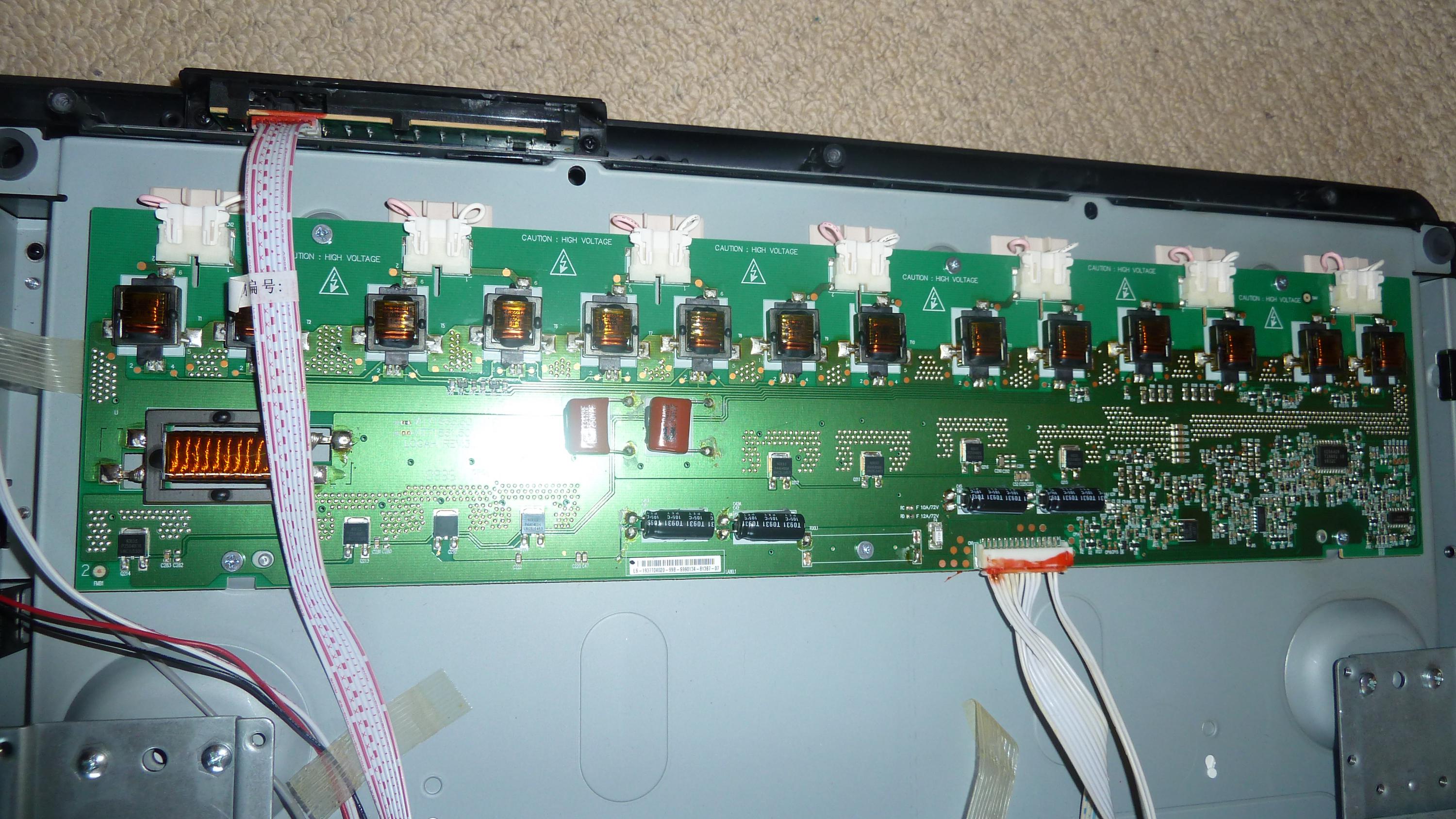

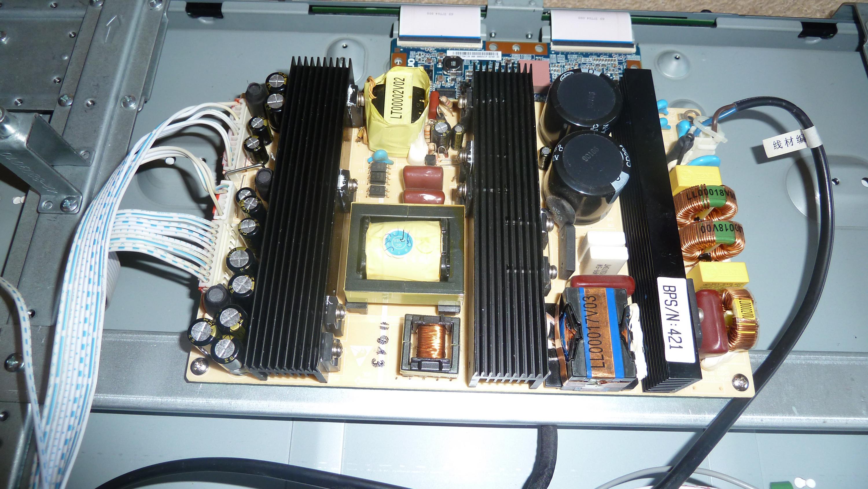

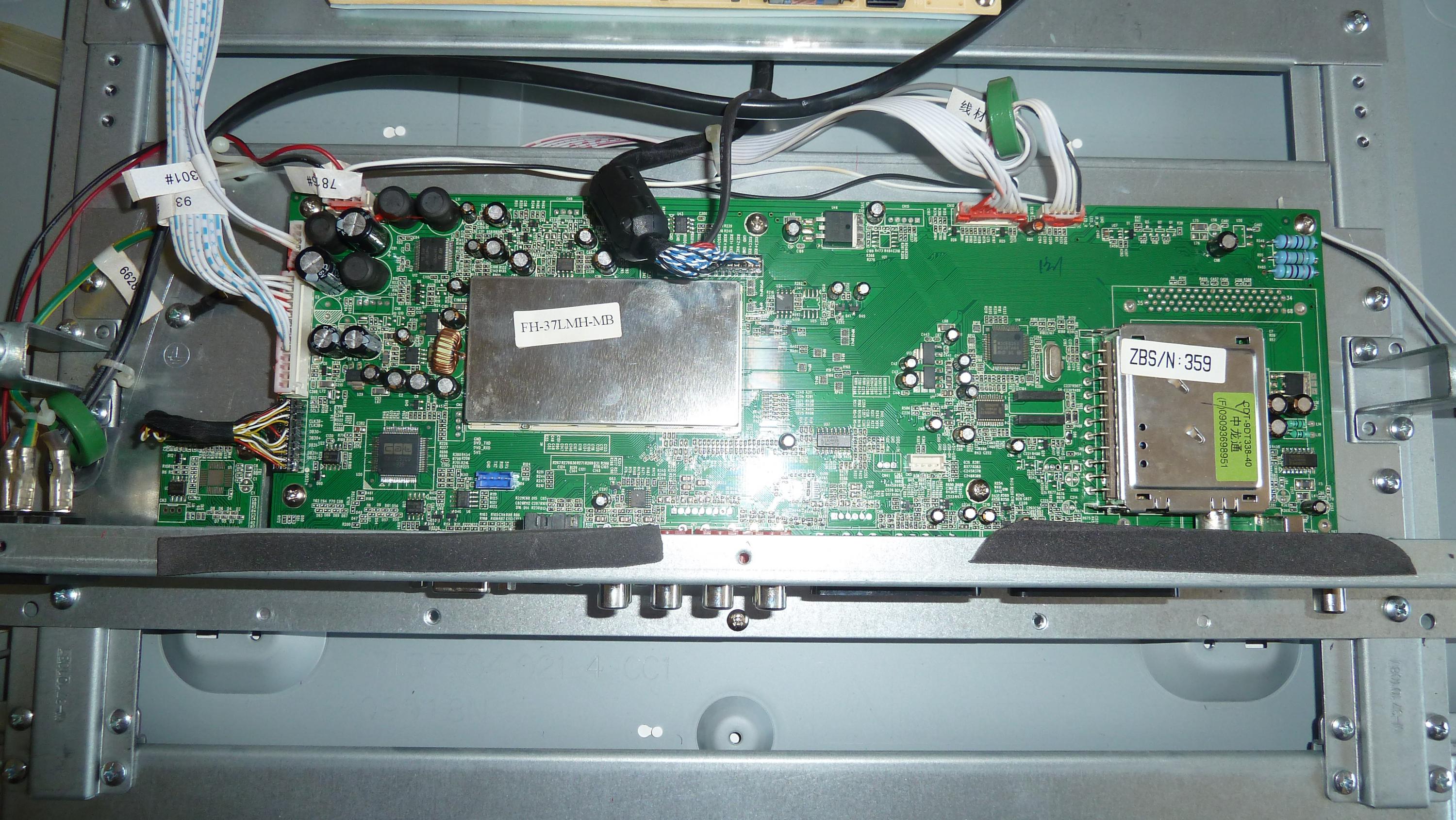

              Hi tried connecting it all back together then disconnecting cable from main to t-con board but still get the same result
              Also attached are pics of back of tv and pics of the boards
              Hope it will help
                more pics
                • homerclone
                  • Jan 2014
                  • 53
                  • uk
                  Last pic :-)
                    Another test is to unplug all the bulbs except one and power up - see if it flashes then unplug that and plug in bulb 2 and see if that flashes and so on. They will never stay on but it may show up a totally broken bulb it will not flash at all or may flash dimmer than the others.

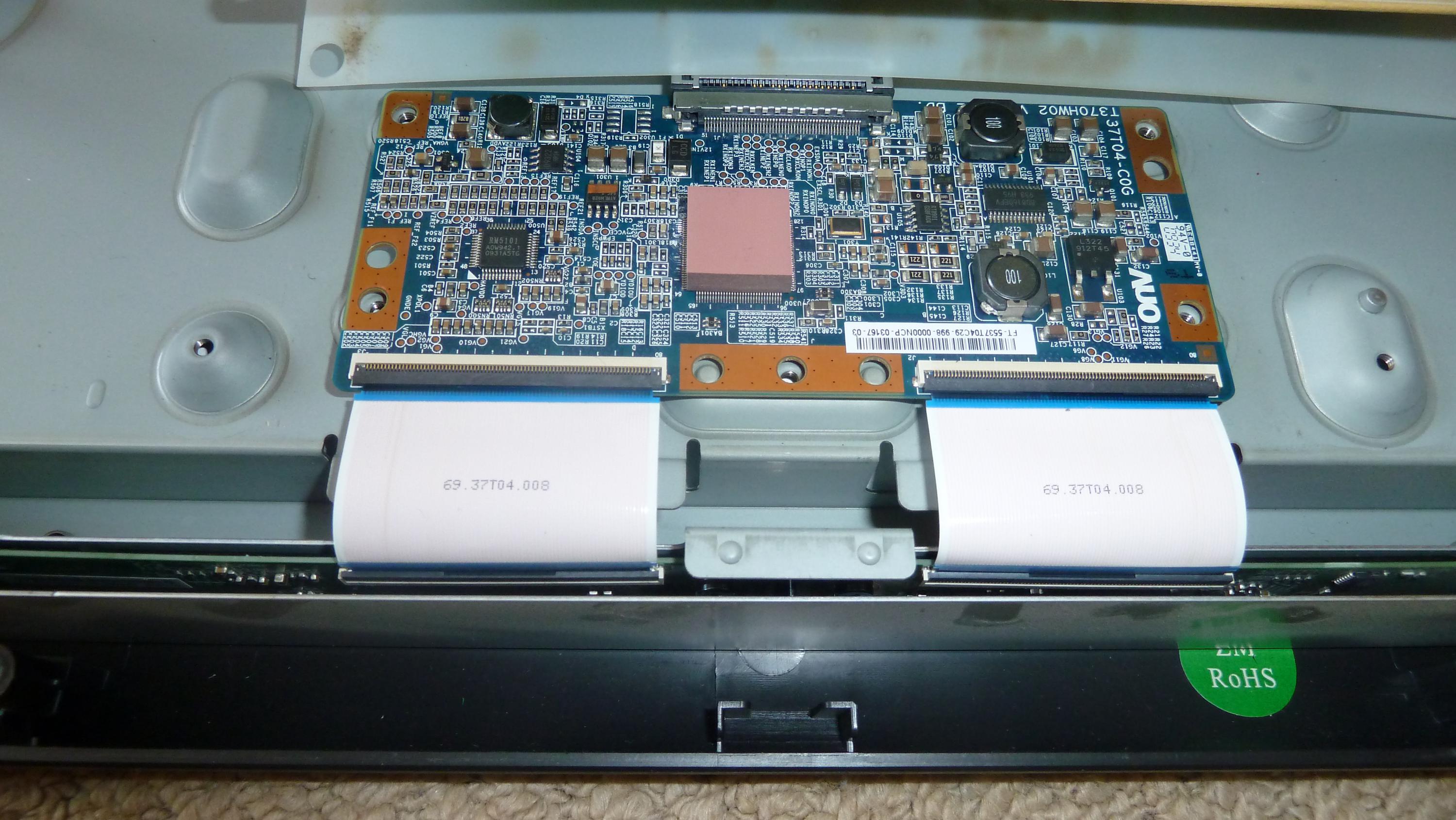

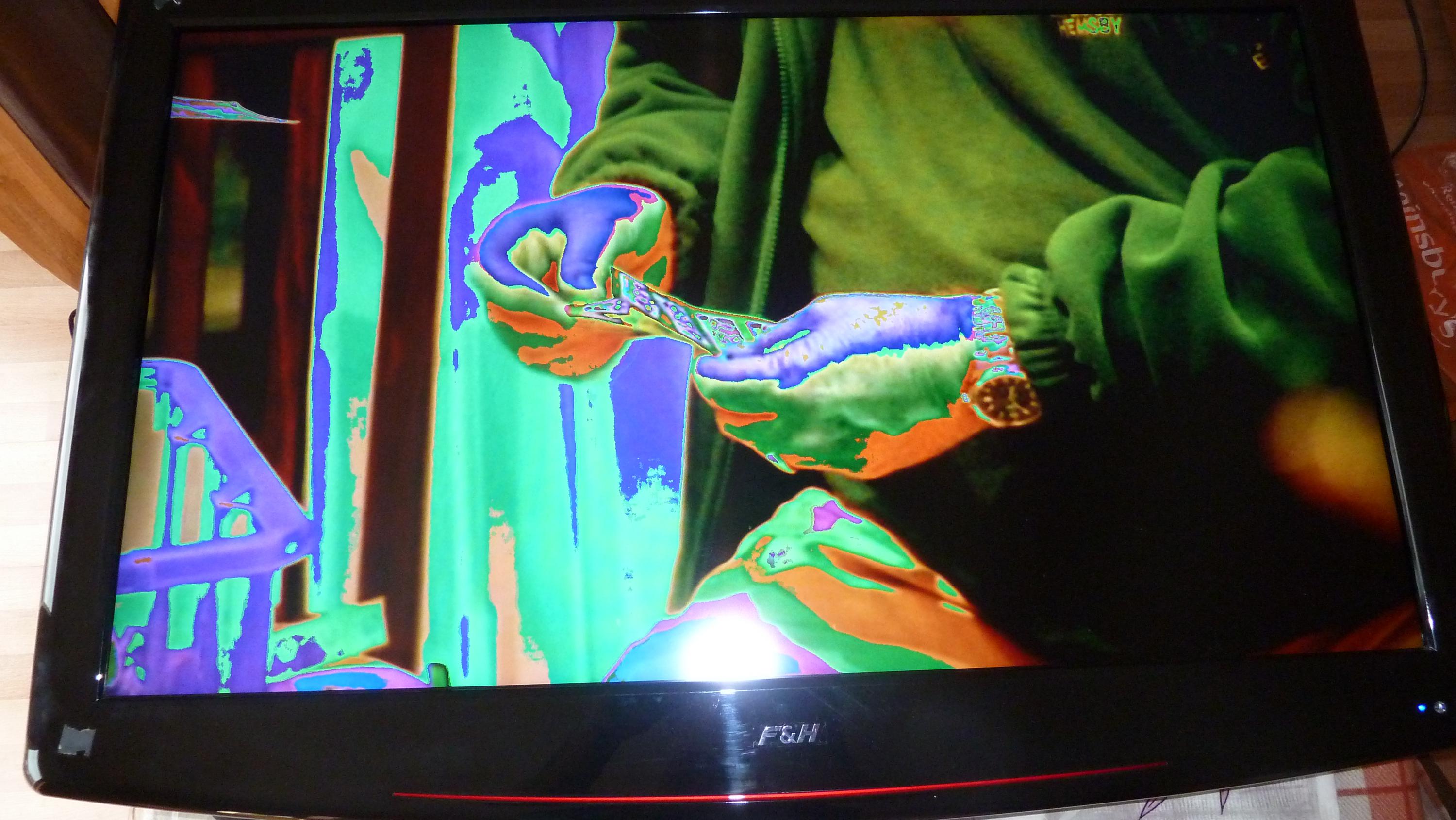

                      Hi
                      Just an update and a request for some help ref this post.
                      I could only purchase a main av board from a 42" set and have fitted it.
                      The good news is the tv now displays a picture. However the colour images are bad see pic.

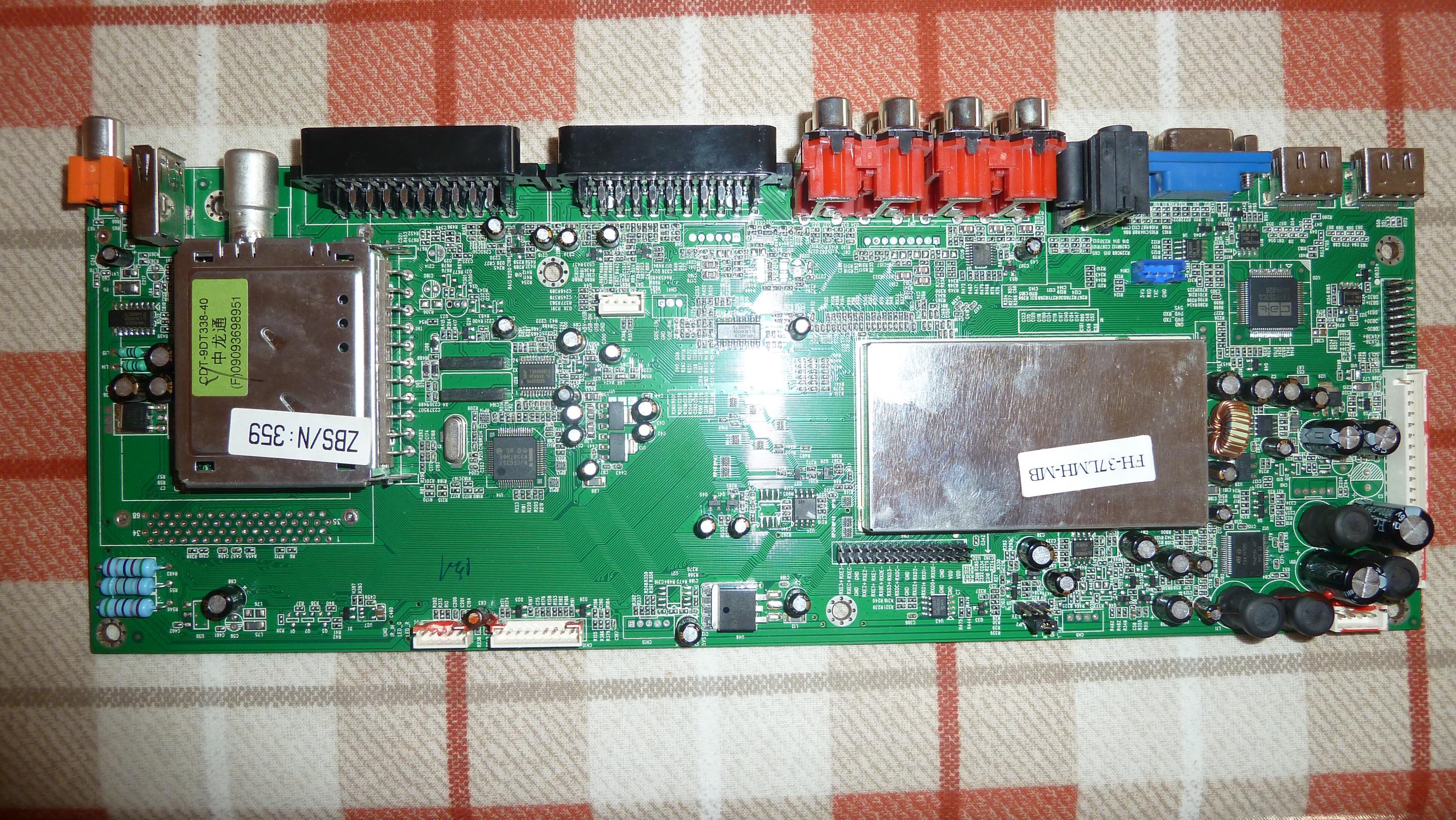

                      I think it has something to do with the firmware as its a board from a 42" and not the 37". I cant get into service menu (as I don't know how).
                      Could I remove the chip that stores the firmware from the 37" board and attach it to the 42"?
                      If so what chip holds this info (attached is picture of board).
                      Has anyone tried this before?
                      Mark
                        could be the 2 atml chips top right in your pic but not certain
                          That is solarized picture which is due to bad GAMMA Voltages on the T-CON board, was it like that before the TV went out? U500 on the T-CON is the GAMMA Vref IC.
