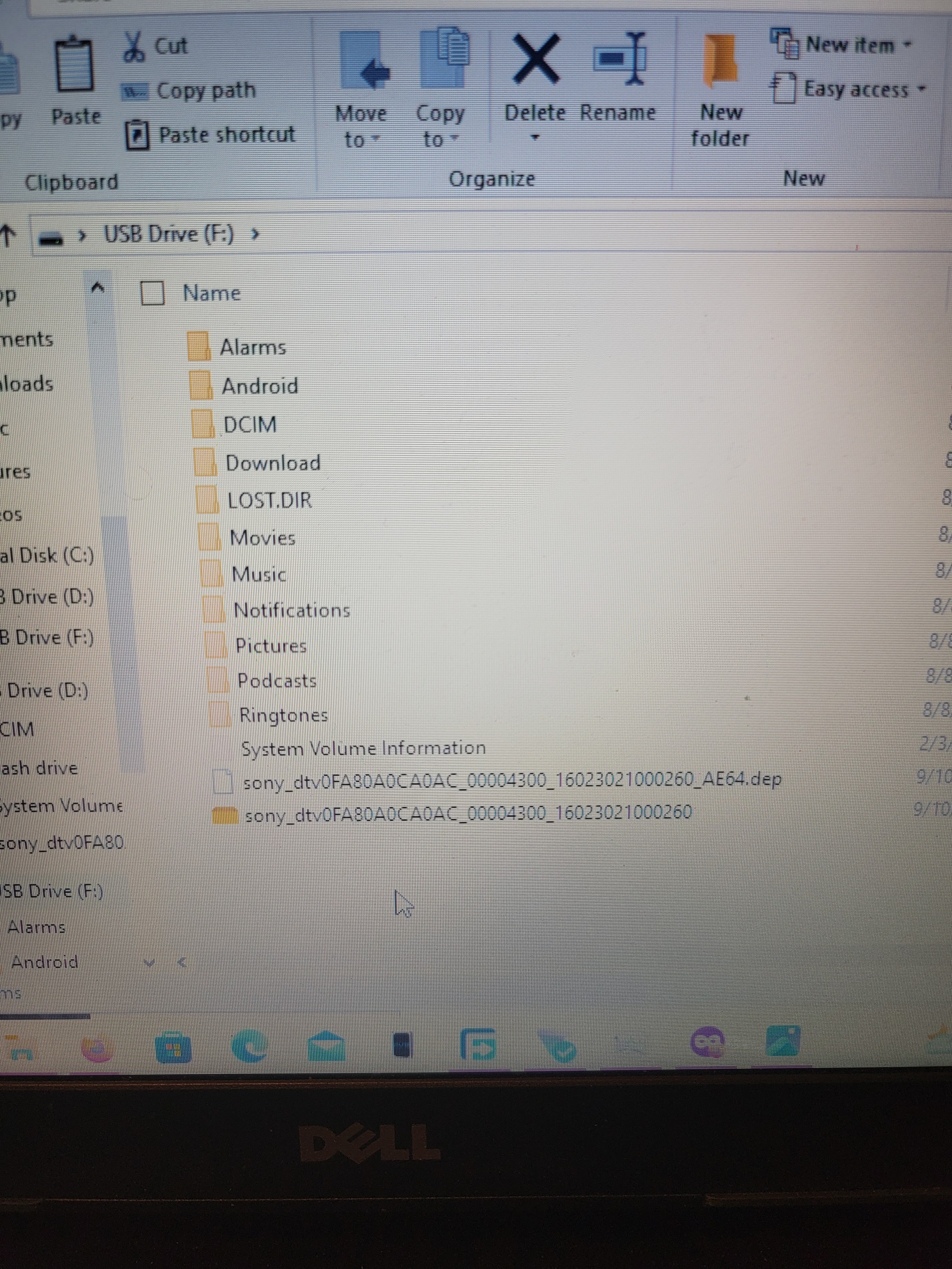

    Yeah I send some messages to friends but no one seems to have any that small. Do you think a sd card is a usb reader would work to deliver the update? I do have one of those that small. But yeah I know I need to try it with the correct USB size to rule that out.
    As far as errors, no. The green and amber were before this model. These would only blink red if there were any error codes. But it doesnt blink. And I can even play YouTube videos, just no picture. I guess I'll try the SD card route first since that will be quicker than waiting a few days for shipping on a 4gb flashdrive

        Yeah, I mean if this doesn't do it I'm pretty sure it's the panel because everything else has been replaced with the same results. SD card didn't work. It did the same thing the other drives did where it makes a dozen other folders on the card (see photo). It's weird how it's so specific on. certain models, while I've used a 64gb thumbdrive to update my 83a90j without issue when I replaced the main board.
          these files and folder are correct. acopy of yours Android system on TV.. it mean yours Main Boards 100% fine and the firmware too its boot and worked as it should..
          useless to replace MB... the issue some where ells on the set... T-CON or Panel

                That is very helpful. It must be the panel then (unfortunately) because everything else has been swapped without no change. And 3 t-cons have been tried. > know it's not the main board. This is the third main board that has been in the tv now and nothing changed. Only thing I wasn't sure of is if the update was being applied but you're saying those folders being created means it worked correctly. if that's the case, then it's the panel itself.
