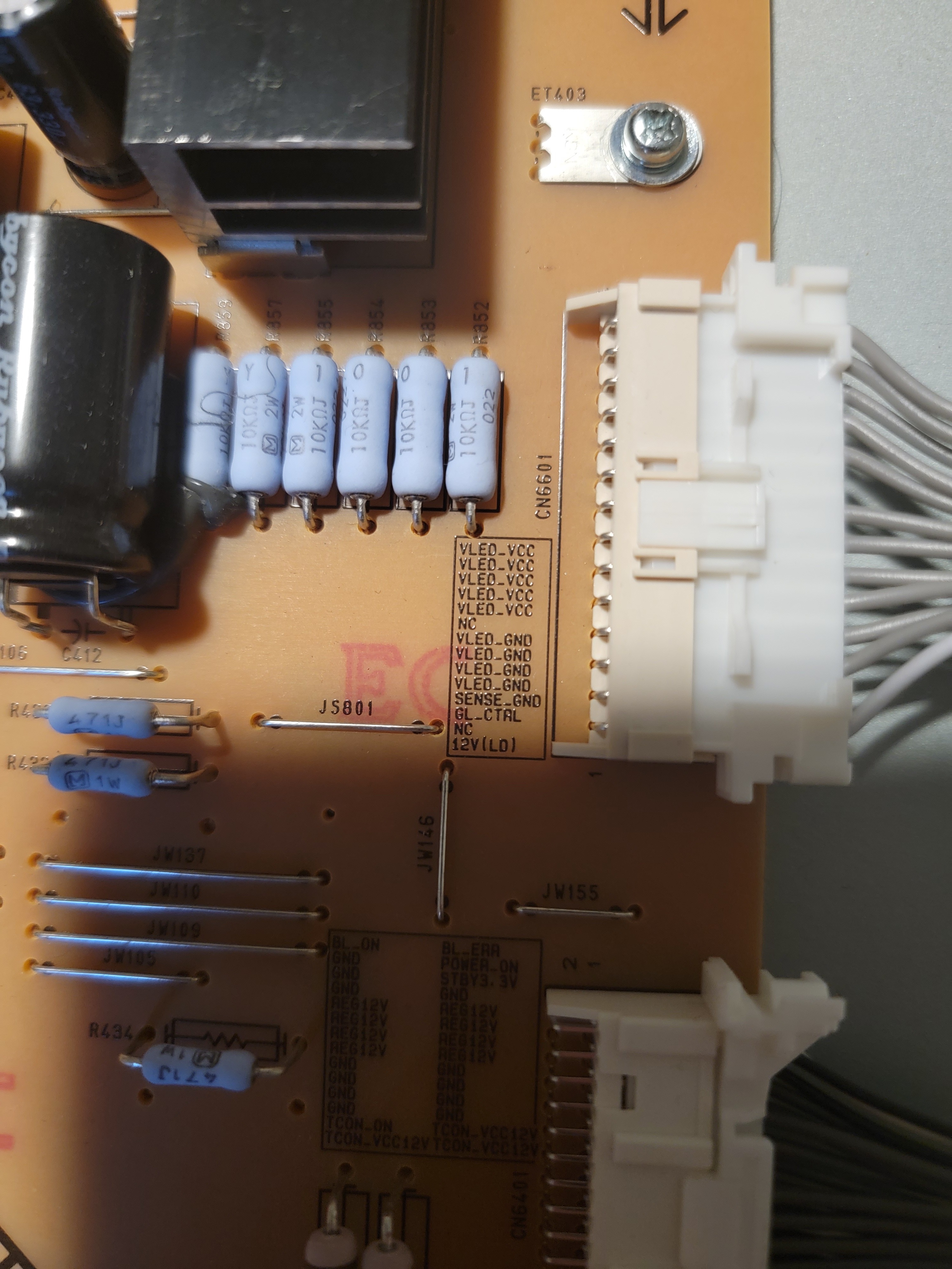

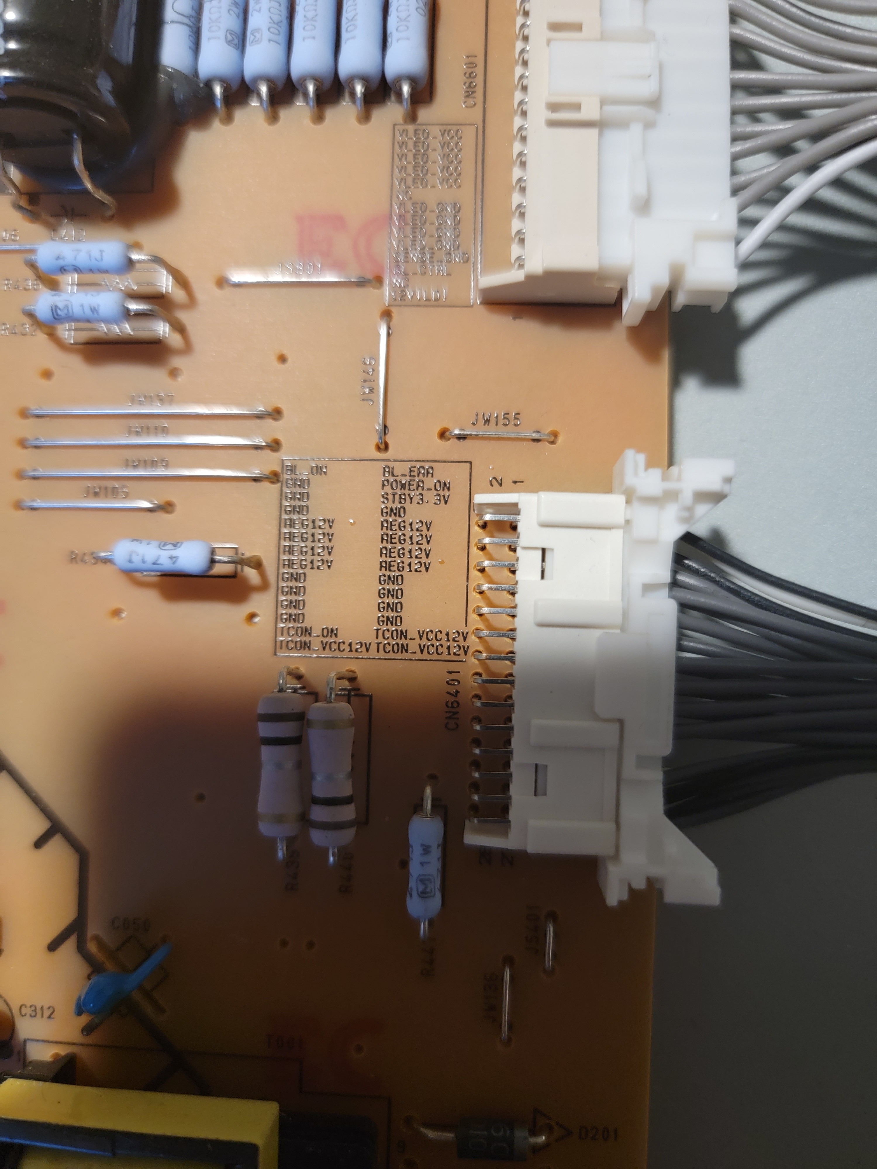

    Test the screen.. first take a pick of the PSU legend clip that goes to main board and the one that goes to TCON to verify and then we can give you directions

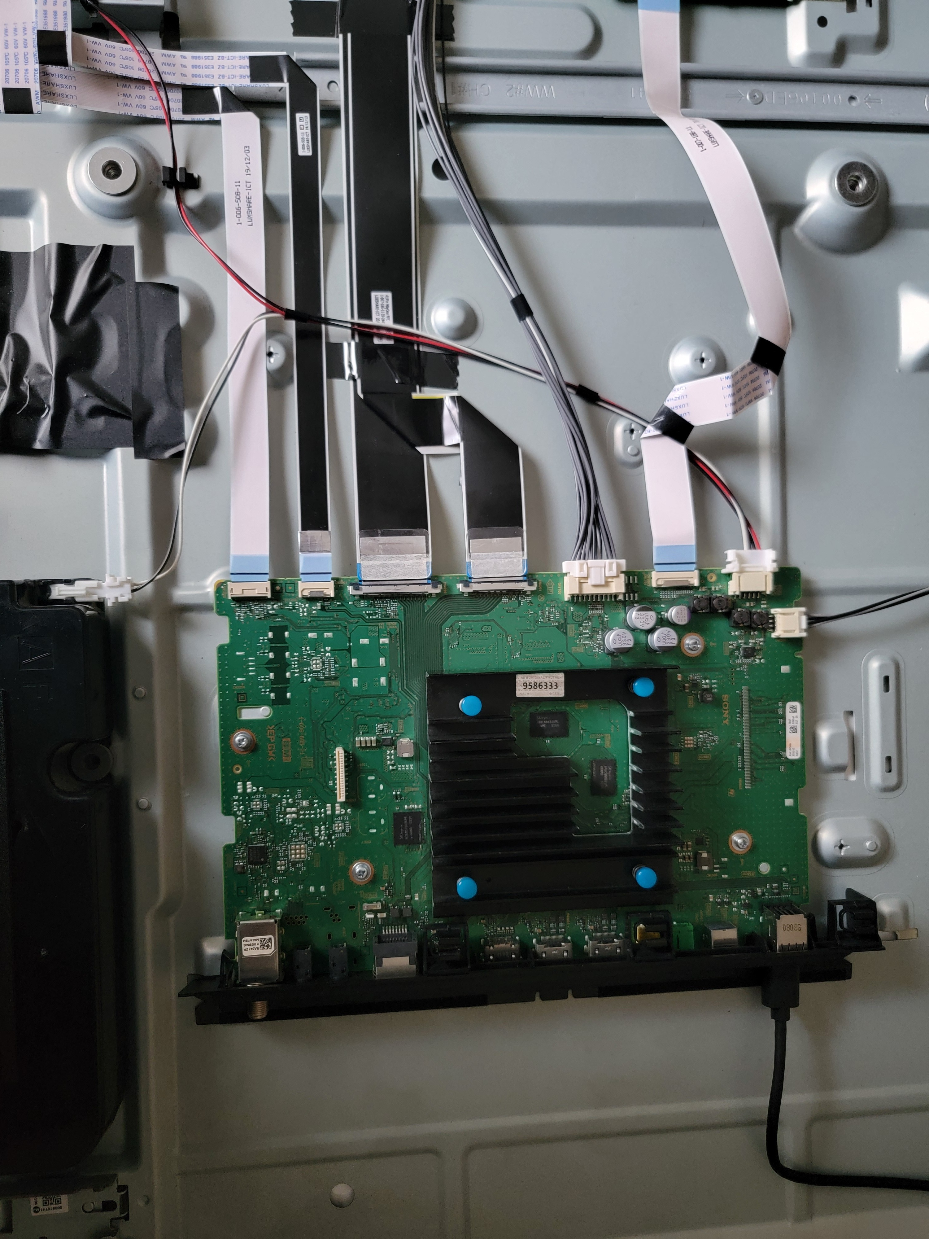

          Need to make sure the numbers on the sticker of the mainboards match, it isn't enough to just match the model of tv.

            I didn't ask to confirm the power board is working. This is too test screen.
            You need to disconnect the connector from the PSU to the main board at the main board. Then you need to disconnect the LVDS cable from the t-con side to the motherboard no cable should be connected to the t-con except for the PSU. Then you need to jumper the PS- on the standby the t-con on and the BL-on. In doing so you should have a screen pattern show up on the screen with red green and blue images. Let us know what happens.
              that is how I confirmed it was the right one.

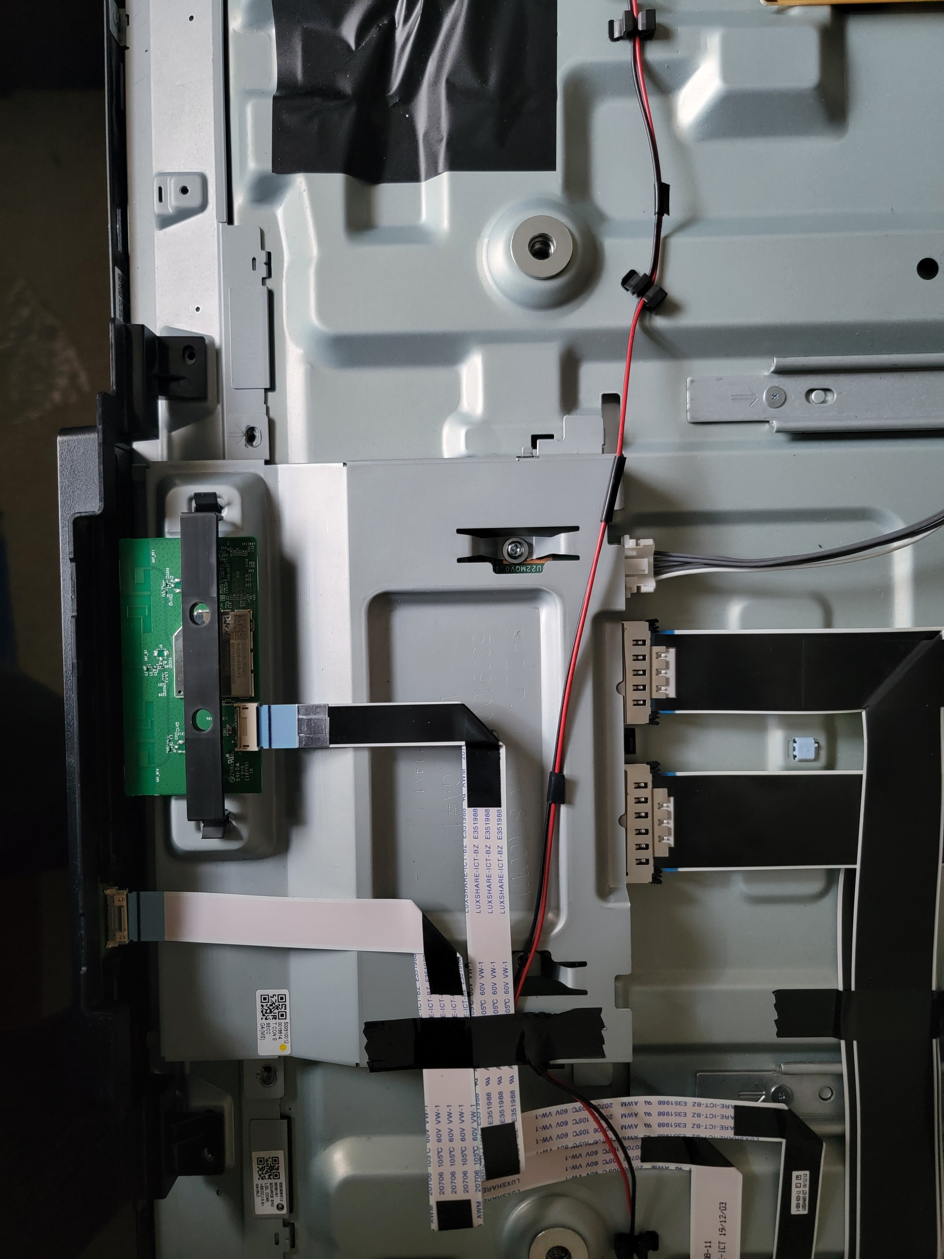

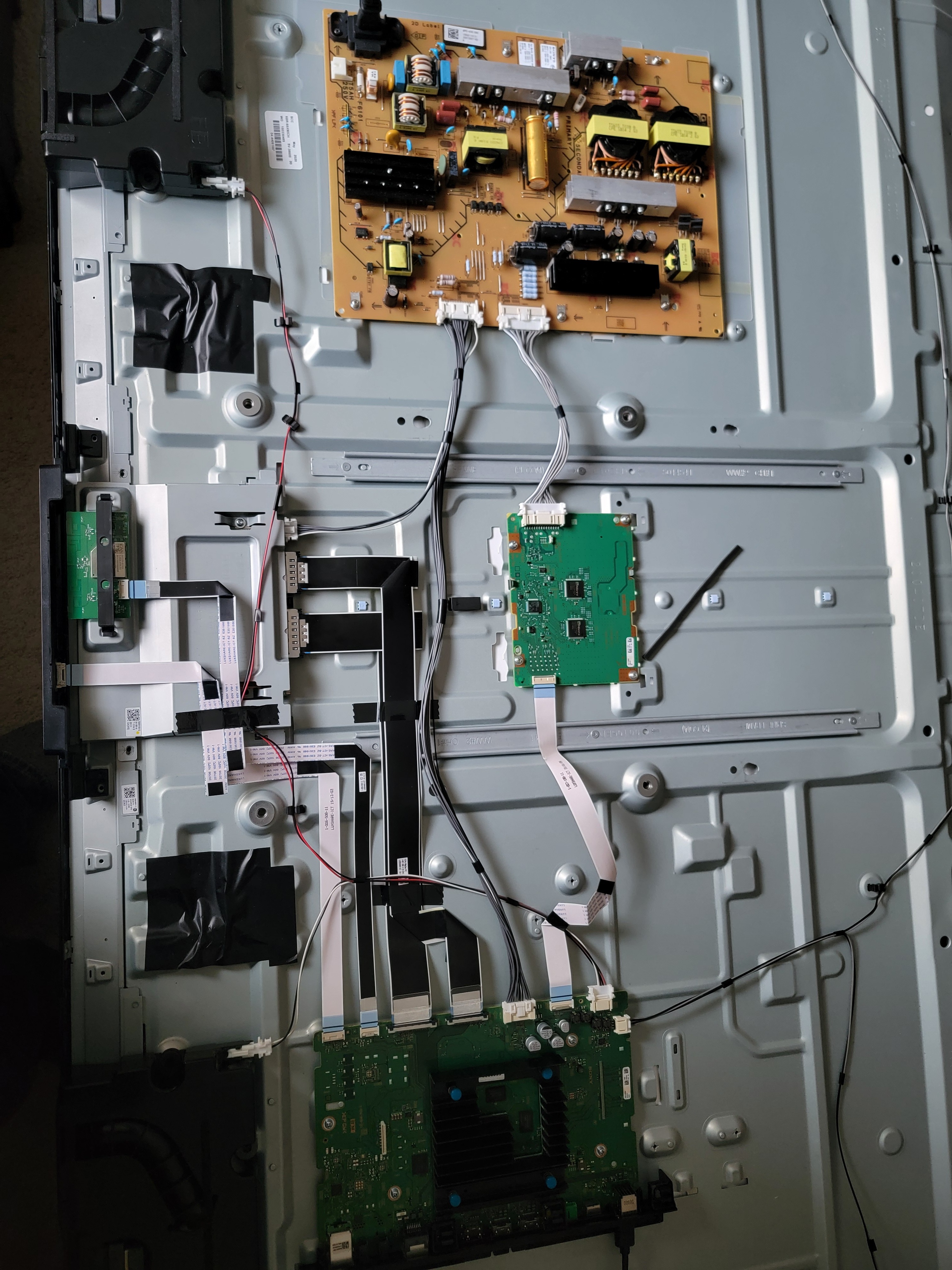

                      How about a picture of the whole back to see what kind of animal we are dealing with.
                      • Adam Russ
                        • Sep 2024
                        • 39
                        Alright. It's a pretty typical Sony LED layout.

                            Replacement mainboard could be bad. The tv is 4 years or so old, that's about the time that the eMMC dies and needs replaced. Maybe check some fuses there's one on the LD board, some sonys have a few little fuses on the mainboard.
