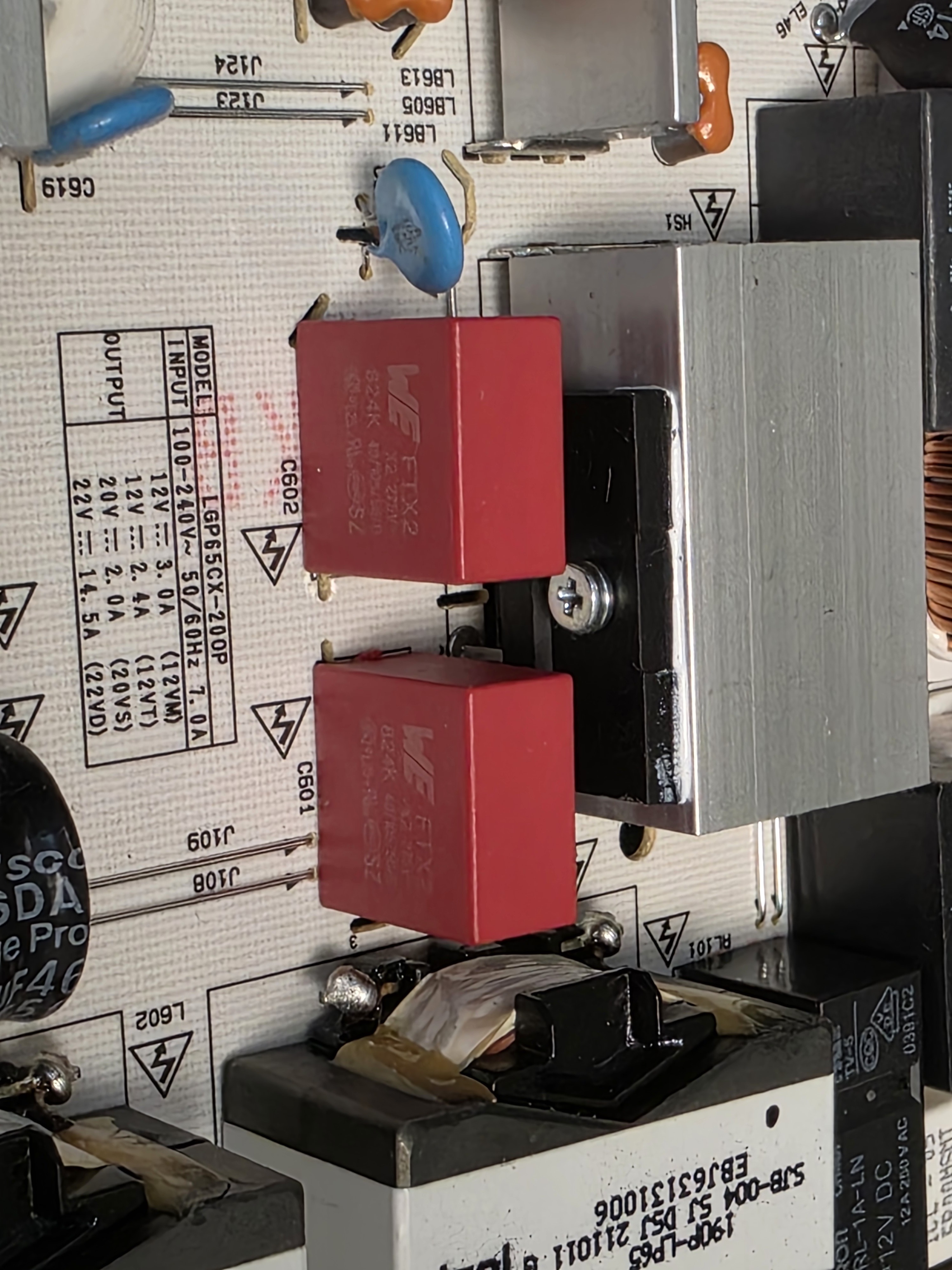

    So I had the time to take my TV apart again. I soldered out C601 capacitor. I measured it. It was 720nF instead of 820nF. I ordered the spare parts but unfortunately I didn't get them yet, I was just curious how bad they are. As far as I understand these capacitors are for interference filtering. Do they really influence the power supply of the TV?
    Another note: Sometimes my TV's LED turns off and only comes baxk, if I unplug it from the wall for a few minutes. Does it make the capacitors more suspicious?
      remove the comma... :-)
      820nF minus 20% of tolerance is less than 720nF, so i think the problem is not there.. a filter is important when the input is dirt, when it is not i guess is irrelevant for the set, if

        Hi Titus6, did you ever find the faulty cap?

          Hi Nousernameavailable!
          No I didn’t. Right now I’m just dealing with my TV as it is. Still working, sometimes I have to
          unplug it from wall socket and connect it again.
          I spoke with a local LG service not far from me, but I didn’t take my TV to them yet. They said in the phone that according to my symptoms they guess my Main Board is the problem, but they have to investigate it in person. Unfortunately they don’t come to my house, I have to deliver my TV to the service. Since it’s a pain in the ass I only take the TV to them if my symptomps getting worse.
          Long story short, no solution yet

            Ok thanks for the reply anyway. I found some more info in another (German) forum https://www.repdata.de/wbb2/forum/in...t-das-netzteil
            I'm going to try replacing C601 + C602 with WΓΌrth 890324025047CS.

              I changed the caps and all is well again πŸ‘
                why you linked external answer and in this threat the answer was there post #3 ?!

                    Thank you for letting us know your results. As Diah mentioned he already suggested this solution in this thread. I also ordered the same WΓΌrth cap and I will try it as well.
                    Hope it solve my issue too.

                      Hello guys. Finally the caps arrived and I changed them, and... half a year of stress and anxiety is gone finally. I can say that after two days of testing my problem is REALLY SOLVED. The Stand-by LED is always on. My TV was able to do the Pixel refreshing again.
                      I can't thank you enough you guys for sharing your knowledge with us.
                      Diah Your post was really the solution, I set it as the answer. Thank you for your effort, you're truly amazing.
                      Nousernameavailable Thank you for sharing the exact type of the cap (WΓΌrth 890324025047CS) what I need for the repair. Actually you gave my motivation back, when you wrote down the exact type of the cap.
                      Also one added note:
                      I checked the Power On/Off Status with the service remote. There are no more entries of I took a picture of the entries OFF_BY_EDID_WRITE and ON_BY_LAST_WARM. So this problem solved as well, now I know it wasn't normal to see these entries.
                      So guys, you are awesome and I hope this conversation will help others with the same problem.

                        That's great, glad to hear yours is repaired too!

                          Well done Diah, you solved it with one post.
