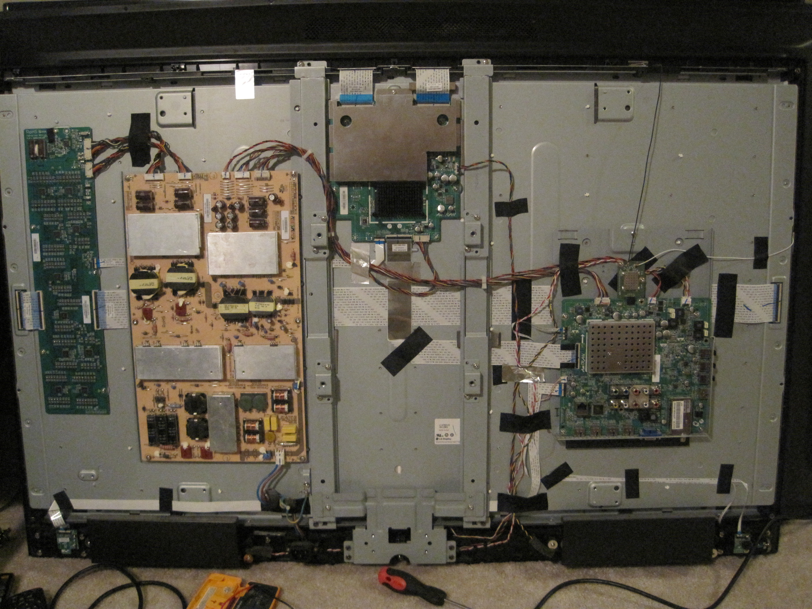

    Hey all, I got a LED tv with no picture and a blinking logo. It used to occasionally power up. Now the logo just blinks until I unplug it. I have a little experience fixing plasmas but I've never opened up an LED and I can't find a service manual. Can anyone point me in a good direction? I have a DMM, O-scope, ESR meter and soldering station to work with.
    Below is a pic of the back panel.

          Re: Vizio XVT3D474SV No Picture, Blinking Logo
          your TV doesn't power ON right? its maybe your main board and not the T-CON board.You can check the fuse and the voltage on your T-con BOARD. And disconnect the t-con board and try to power up your TV. its should power on if the t-con board is cause a problem
            Thank you for responding. The unit seems to go through a sequence when attempting to turn on, involving blinking LED/logo which switches to the normal white logo, yet the screen remains w/o a picture and is unresponsive to remote or Jog controls.
            There appears to be power going to the T-Con and the fuse passes a continuity test. Disconnecting the T-Con has no effect on the power up sequence.
            Since disconnecting the T-Con produces no change, is it likely a main board problem and, if so, is there a way to test the main board?
            Thanks, again, for responding...I was ready to buy a T-Con (if I could find one) but now I'm rethinking that coarse.
              The flash of the LED/LOGO is normal, the LED it should STOP blinking on yellow, not white. The LED/LOGO should turn "White" when the power is button is press.If the last state is "White" then its your main board
              You can check the fuses, regulator, and caps on the main board. Also check the HDMI chip and the main CPU for overheat. This is a smart TV so there is a good chance your EEPROM is corrupted you can try to resolder that chip as as a last resort. but be careful not to do solder bridges.

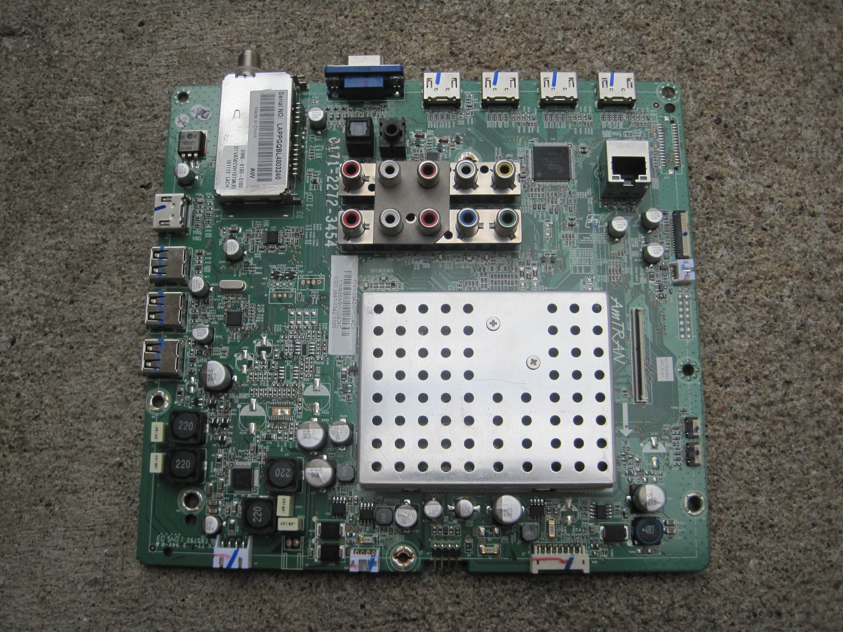

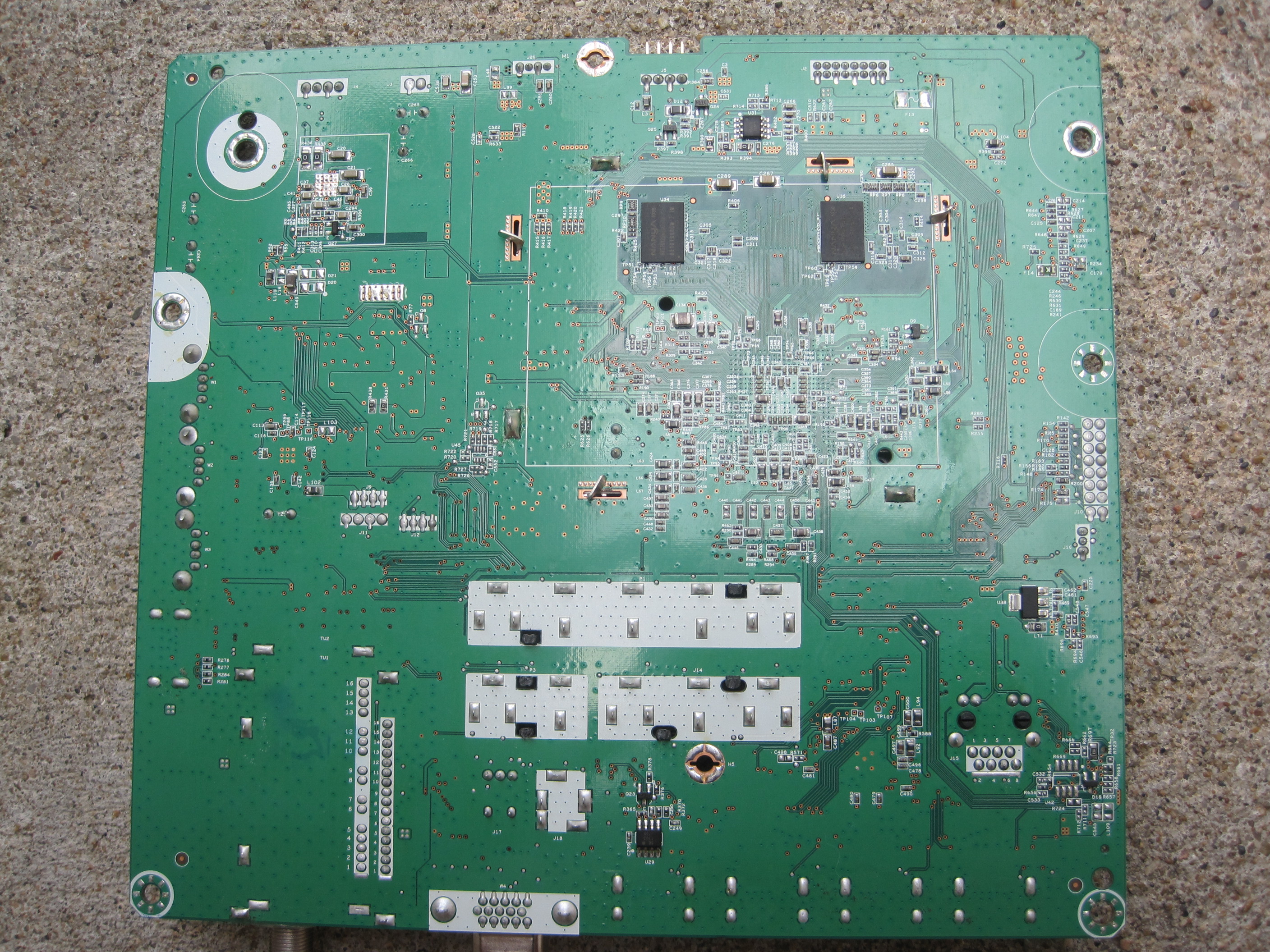

                I've read where this model commonly has EEPROM problems that require reprogramming (I been wondering if a Bus Pirate could reprogram). I'm not yet sure which chip is the EEPROM but I have a soldering/reflow station and lots of my homemade liquid flux for reflowing.
                • ecking767
                  • Oct 2009
                  • 492
                  THE EEPROM chip is under the heat sink shield. TSOP48 chip
                  • Robb
                    • Sep 2013
                    • 159
                    Thank you. Looks like I need to desolder the heatshield to get to the EEPROM in order to reflow it.
                    The HDMI chip shorts to ground on pins 77 & 78. I'm trying to find a datasheet to see if that's normal.
                          the state of your TV now is:TV power on, (with white logo) no back light, and wont power down with remote? Don't try power off with the Jog wheel because a quick menu will pop up asking you to select volume or channel, or power off etc...
                          You can also try disconnecting the LED driver board to see if the status changes
                          and if you know the last input the TV was using, hook up a source to try to get sound.
                            Yeah, when I plug the tv in the wall the VIZIO logo blinks amber (not really yellow) & white for over a minute & then it stays amber until I power it on.
                            When I power it on, the VIZIO logo turns white but there is no picture. At this time only, I am able to get 5V, 11V & 18V on the main board fuses. After a little while, the white logo starts blinking amber & white on it's own and then turns amber until I power it back on.
                            I will try unplugging the led board (I'm assuming it's the leftmost board) after Equador beats Honduras in the World Cup.
                            I have no idea what input was used last but I'll try plugging in as many devices as I can to see if they produce sound.
                              Unplugging the power cables to the led board produced no change on power up.
                              I watched the power sequence after hitting the power button a little longer and noticed it cycles endlessly between blinking amber/white > white > blinking amber/white > amber > repeat.
                              • Robb
                                • Sep 2013
                                • 159
                                Correction: I watched the power sequence a little longer: after hitting the power button, it cycles endlessly between blinking amber/white > white > blinking amber/white > amber > repeat.
                                  I wouldn't mess with the EEPROM, sounds like a bad T-con board.
                                  • Robb
                                    • Sep 2013
                                    • 159
                                    Thank you for your input. I was considering getting a new main board...perhaps, I should be considering a new t-con. I have read that the t-con can be difficult to diagnose.
