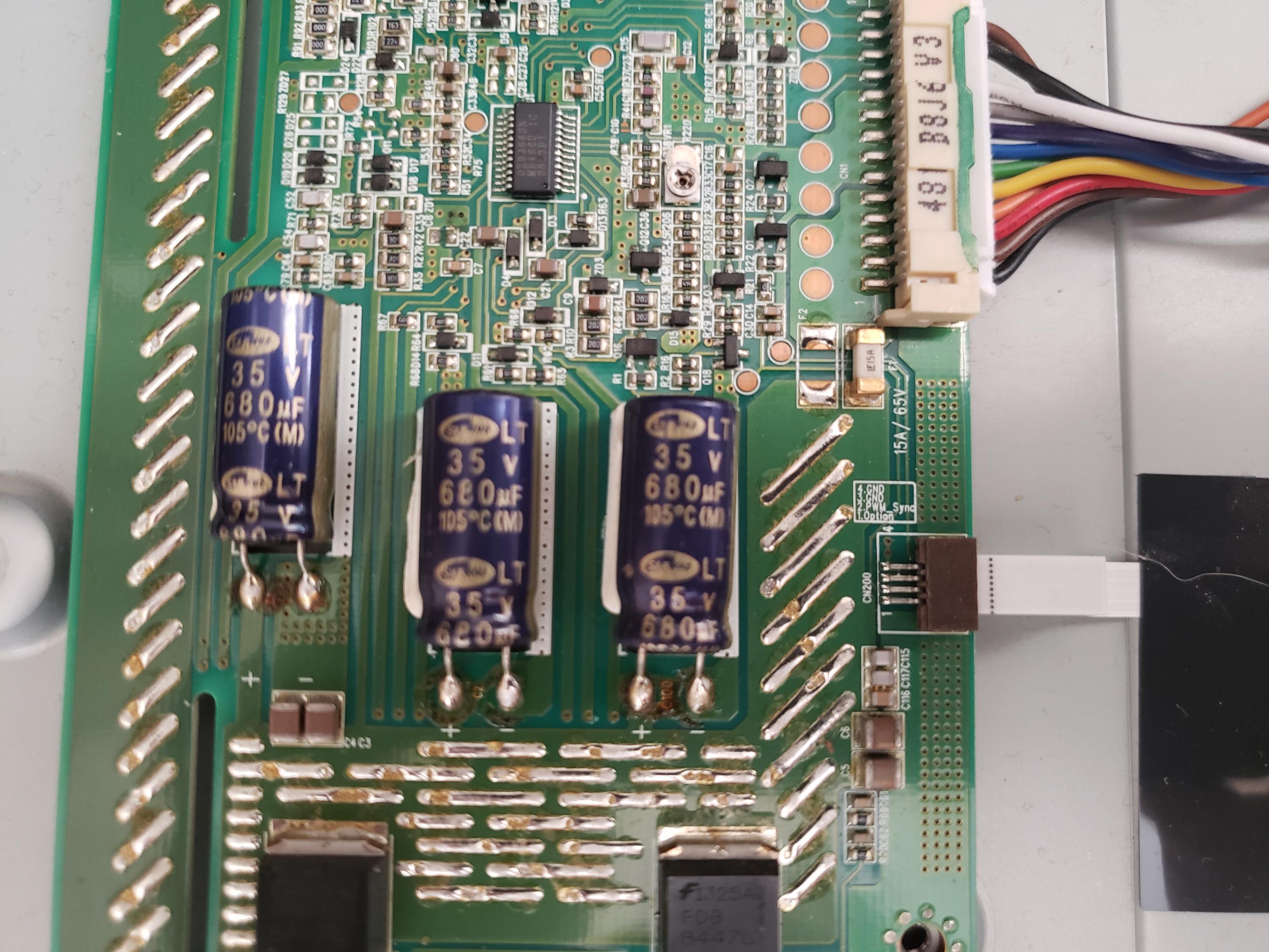

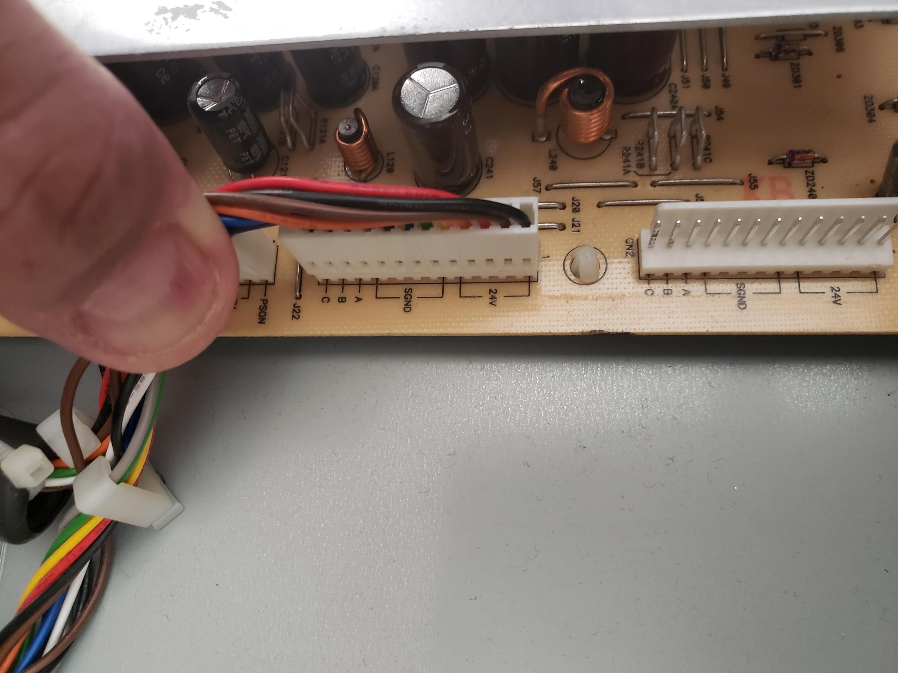

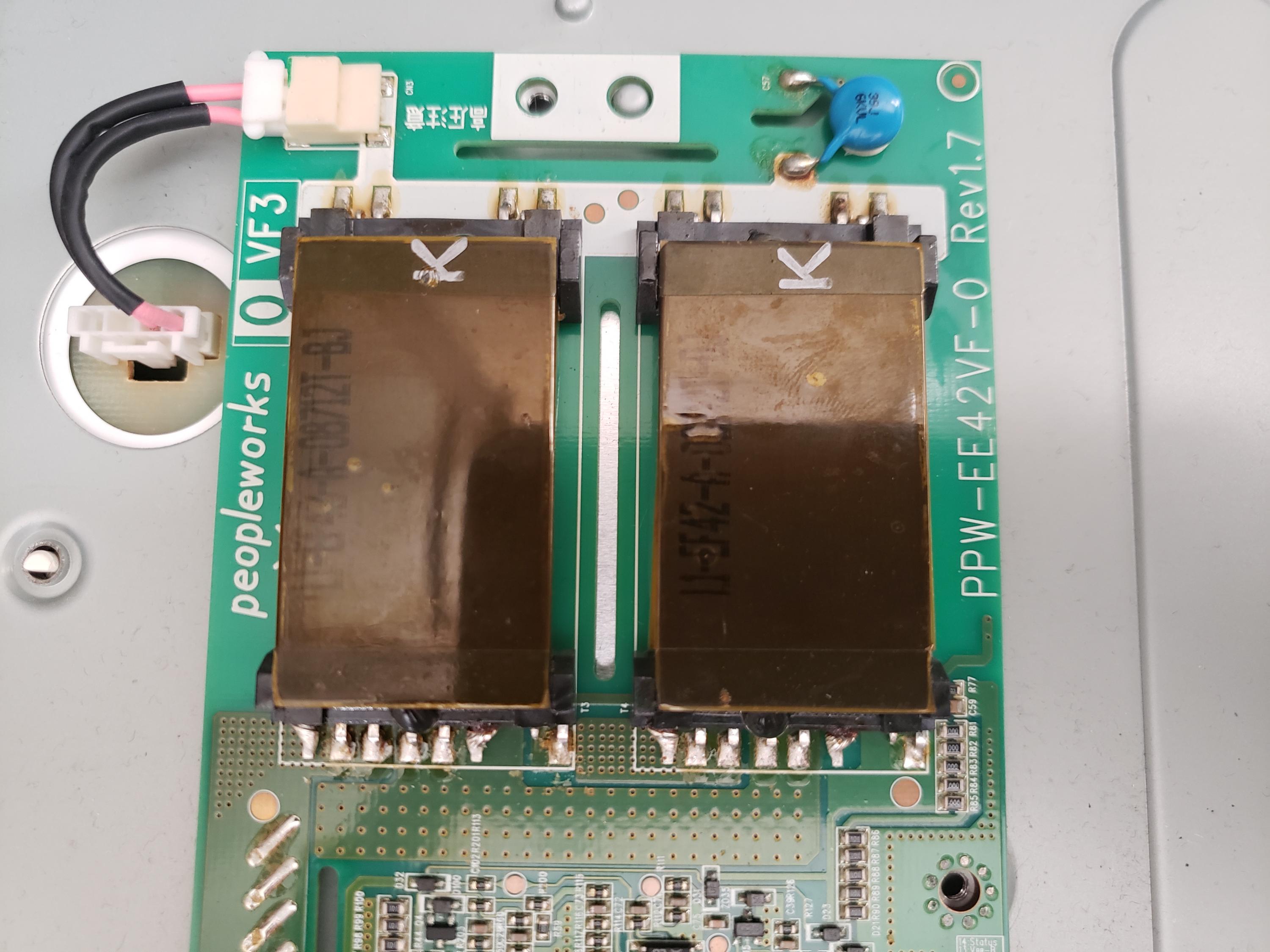

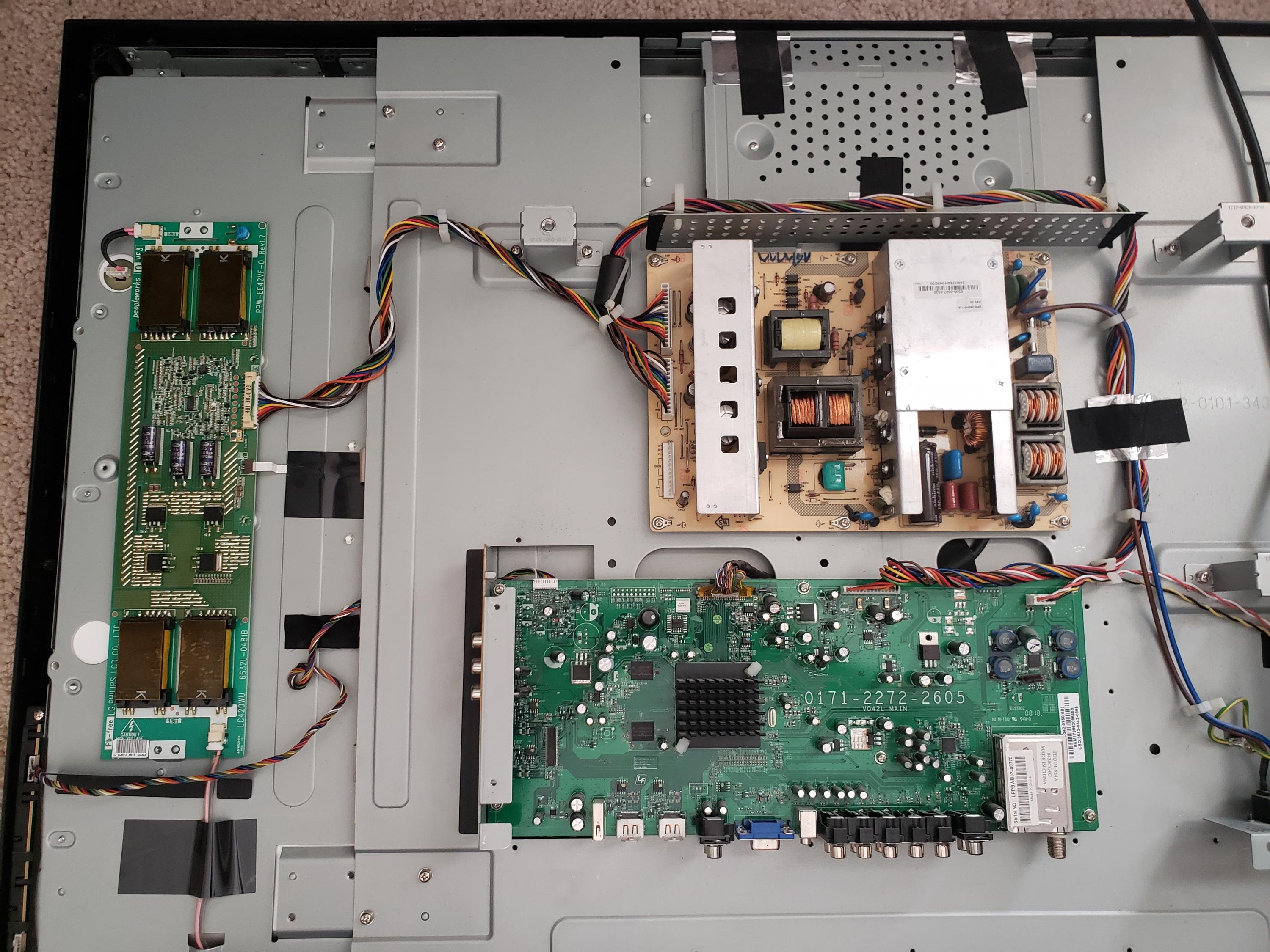

    Hi all! I've got a Vizio VO42L. Plug it in, and logo flashes orange/white for a bit, then solid orange. Press power, and logo changes to white. There is no backlight.
    From reading some of the posts here I thought the inverter could have been the problem, but I've replaced it and still have the same issue. I noted that shining a flashlight on the screen shows nothing, so now I'm thinking main board?
    I took the following readings with the TV powered on. I also tried taking the readings with the CFL connectors unplugged - no change.

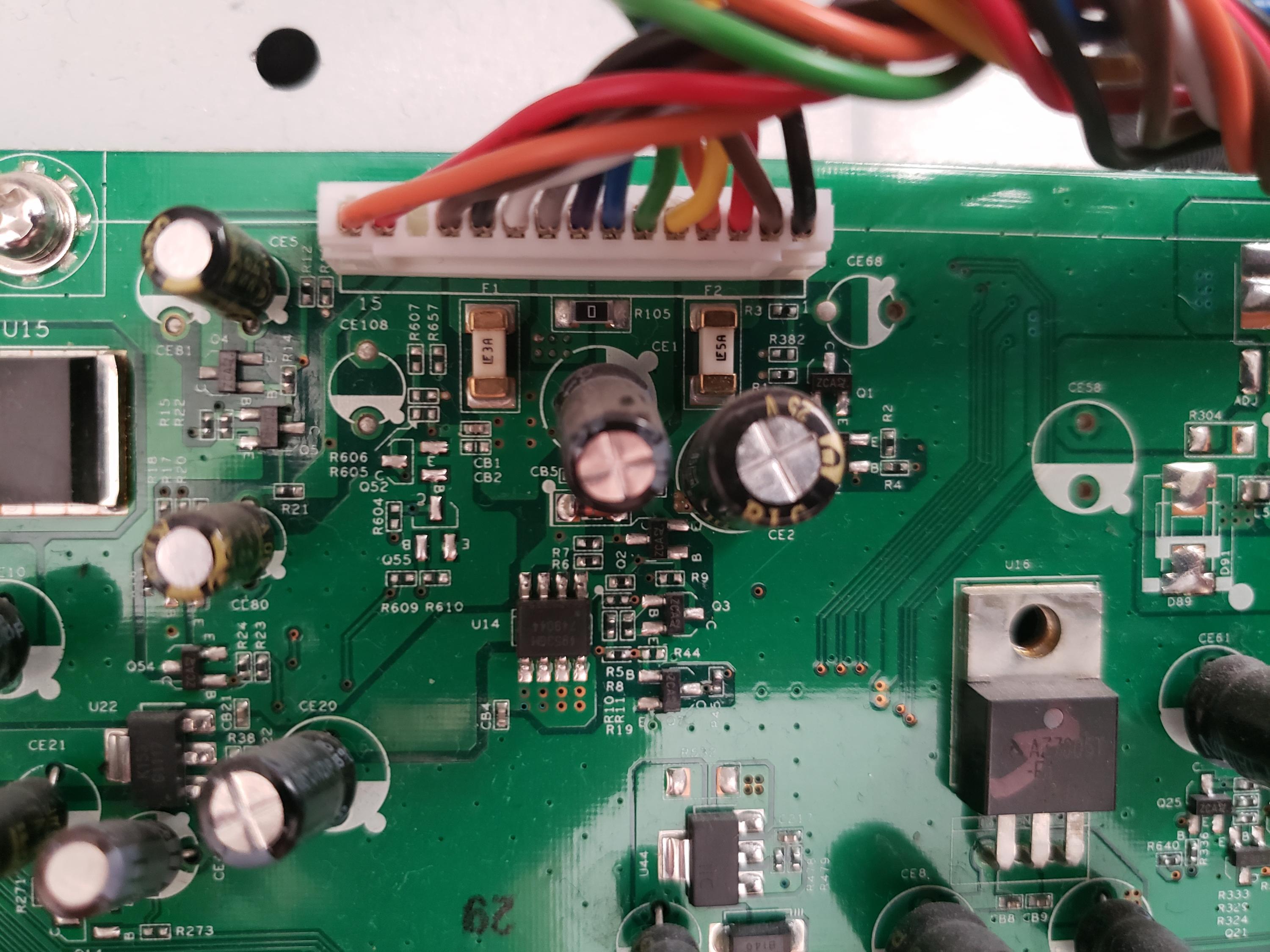

    Main board:
    Continuity across F1 & F2 = GOOD
    F1 = 5.12v
    F2 = 11.57v
    PSU Connector 1 (J21?):
    24V = 24v
    SGND = 0v
    A = 0v
    B = 0v
    C = 0v

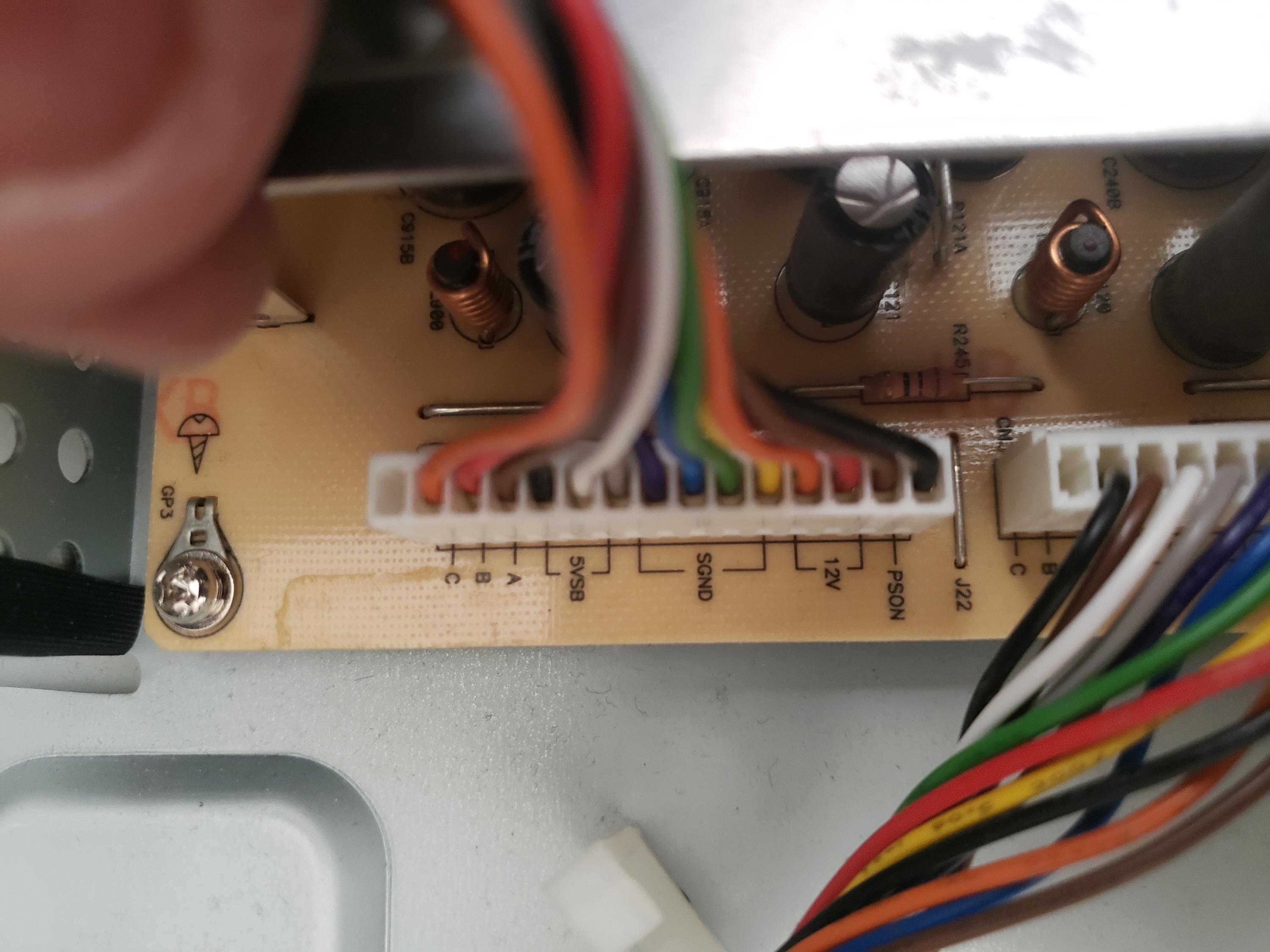

    PSU Connector 2 (J22?):
    PSON= 3.27v
    12V = 11.57v
    SGND = 0v
    5VSB = 5.16v
    A = 0v
    B = 0v
    C = 0v

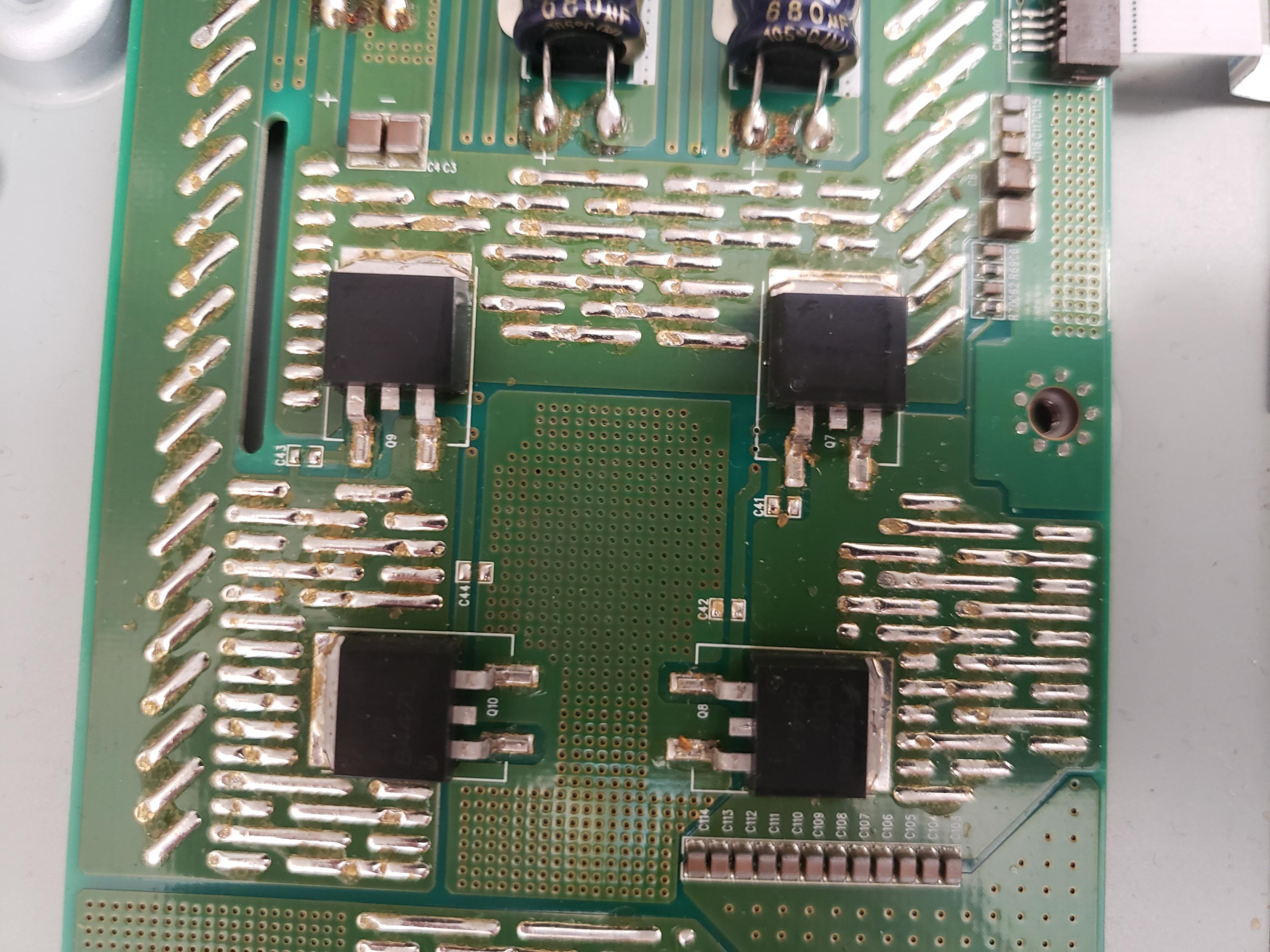

    Inverter:
    Continuity across F1 = GOOD
    Left leg @ Q7 & Q9 = cycles between 0v-1.2v
    Middle leg @ Q7 & Q9 = 24.96v
    Right leg @ Q7 & Q9 = cycles between 0v-1.2v
    Top leg @ Q8 & Q10 = 0v
    Middle leg @ Q8 & Q10 = cycles between 0v-1.2v
    Bottom leg @ Q8 & Q10 = 0v
    Voltages @ connectors to CFLs = 0v
    Do you think I got a second bad inverter? Or do I have a bad main board? What should I try next?
    Thanks in advance for your help!
    --Dave

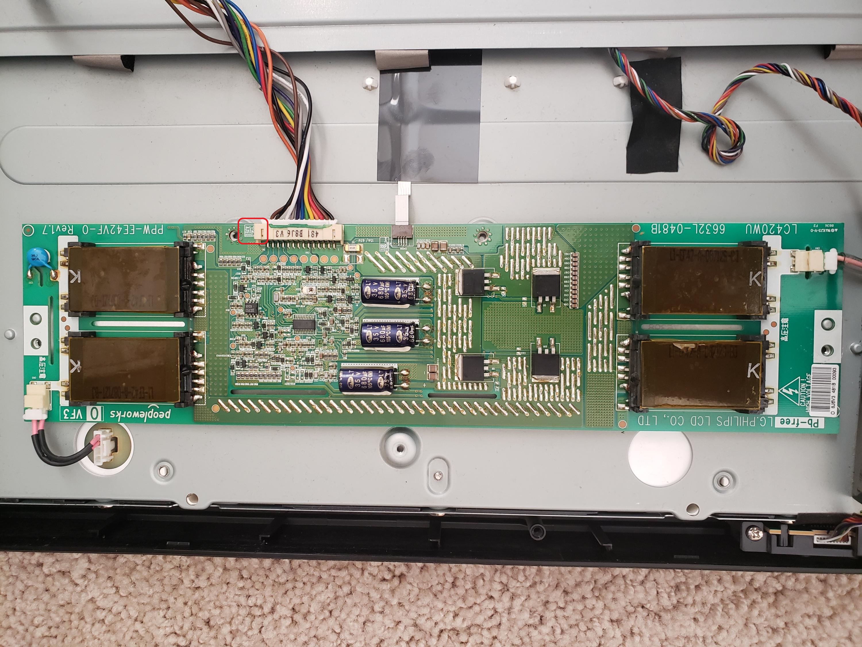

    Re: Vizio VO42L, white logo, no backlight, no picture
    What voltages do you have on the Inverter Board connector
    1, 2, 3, 4 & 5 =
    6, 7, 8, 9 & 10 =
    11 =
    12 =
    13 =
    14 =
    Is the white fuse F1 showing continuity?
    • Daveleone
      • Apr 2016
      • 267
      1, 2, 3, 4 & 5 =
      6, 7, 8, 9 & 10 =
      11 =
      12 =
      13 =
      14 =
      That connector is directly connected to PSU Connector 1 (J21?), so:
      1-5 = 24v
      6-14 = 0v
      I double checked the voltages just to be sure the cable was good.
      F1 does have continuity.
      • dick_barton
        • Aug 2015
        • 6643
        • Wales

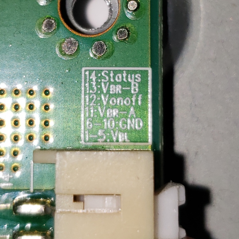

        Can you provide a close up of what's given in the red box please.
        The Inverter On signal appears to be missing.
        • Daveleone
          • Apr 2016
          • 267
          Yes, I think you're right.
          12: VOnOff is 0V
          What should that voltage be? Should I jumper it to some other pin to see if the backlight will come on?
          Thanks!

            You need to check where the VonOff signal comes from. I would expect it to be around 3V when VonOff = On
            Have you checked the two fuses shown in photo 6 of 11 in your first post.
            • Daveleone
              • Apr 2016
              • 267
              That wire is connected to "B" on the PSU Connector 1 (J21?) (photo 3 of 11 in my first post)
              Main board:
              F1 = 5.12v
              F2 = 11.57v

                I jumpered PSU Connector 2 (J22?) 5VSB to PSU Connector 2 "B" (which connects to Inverter Connector VOnOff). The backlight comes on with both inverters that I have. So, the main board appears to be the problem.
                Anything else I should check on the main board? Or should I just order a replacement?
                  I would start checking LDO Voltage Regulator IC's on the main board.
                  There is Main board repair kit and EEPROM also.
                  https://www.shopjimmy.com/search.php...ery=Vizio+VO42
                  • Daveleone
                    • Apr 2016
                    • 267
                    Just to close this out, I was able to get a replacement main board for $20 from ElectroParts, so I decided to order it and save my time (instead of working on the defective board). The replacement main board worked.
