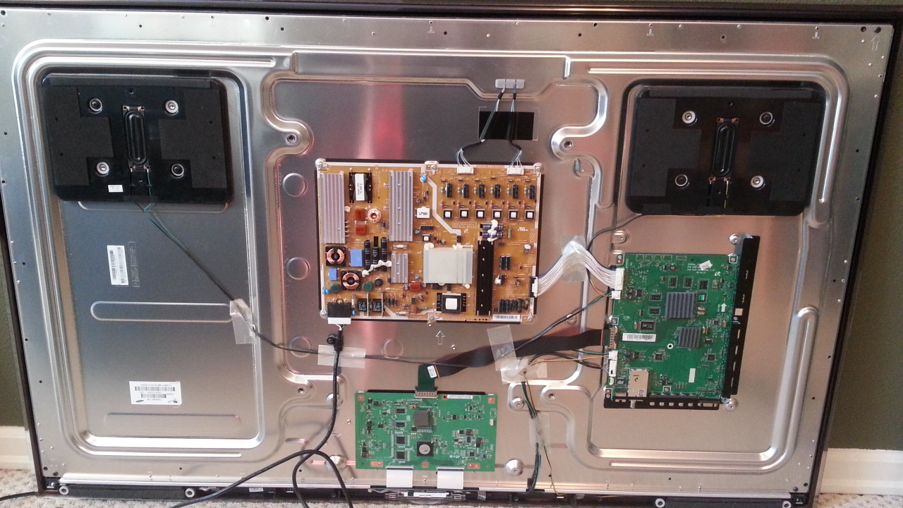

    It can be that the T-CON is not getting the 12VDC from the main board, or the fuse on the T-CON is blown, or the T-CON is dead even though the fuse and the 12VDC feeding it is OK, or the main board is not sending the LVDS to the T-CON.
    So take good pictures of the backside of the TV so we can see how all the boards are connected together first. Do you have test equipment?

        Here is a photo of the back of the TV. All capacitors look fine. The two black squares at the top left/right appear to be back-firing speakers, though it has down-firing speakers on the bottom. The whole TV is a little over an inch in depth. Also I do have a very basic voltmeter but my experience in using it, or any test equipment for that matter, is extremely limited.

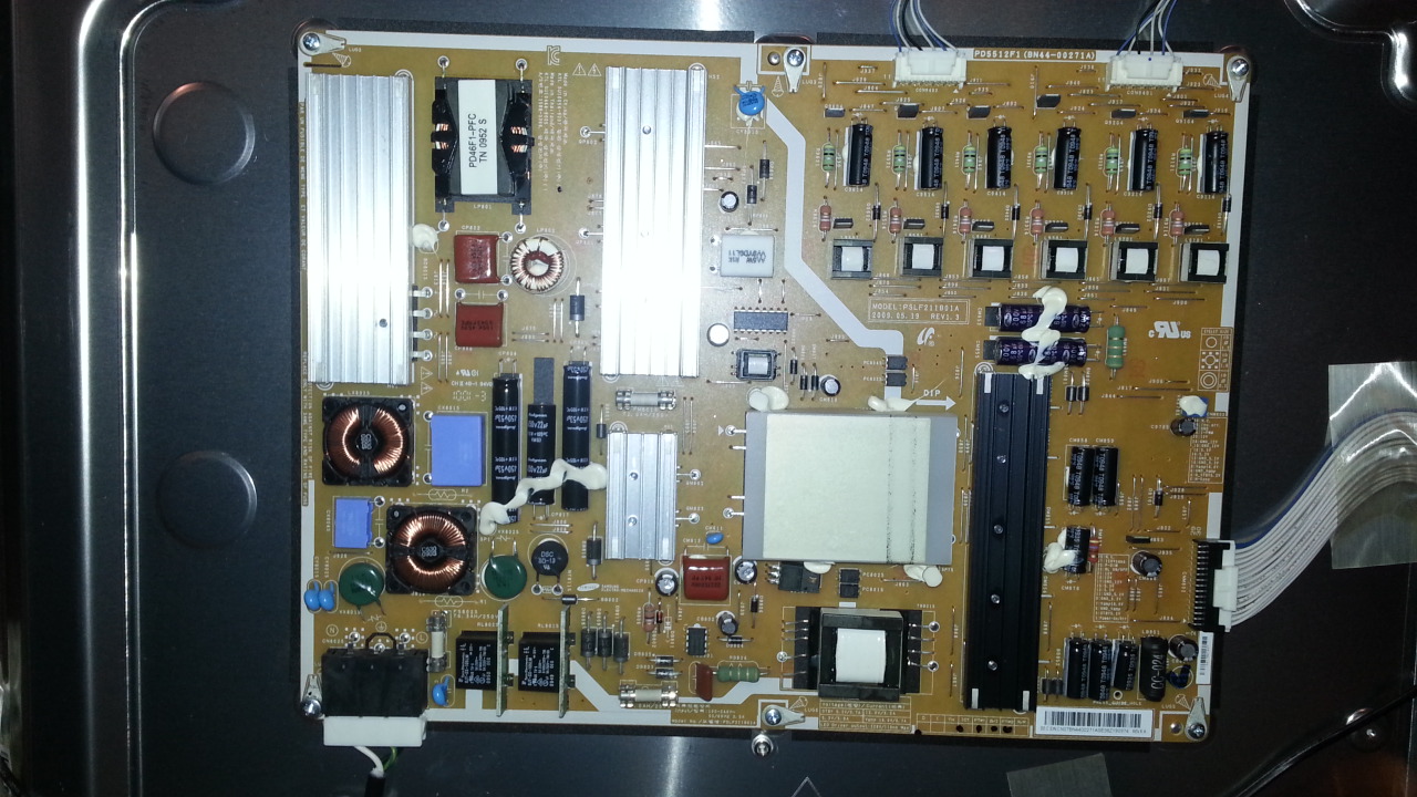

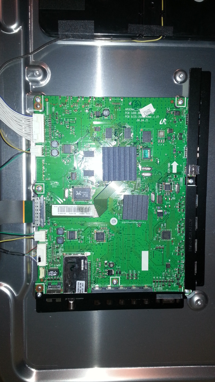

          We also need pictures of the boards so we can see what to tell you to look at
          We prefer just the thumbnails - not posted in line.

              Will do. I did take some closeups of the boards, but they came out blurry and are fairly worthless. I'll take more when I get home tonight and repost.
              I'm not experienced with uploading photos on this forum and took me 30 minutes of searching this morning before finally figuring out how to post the pic above.

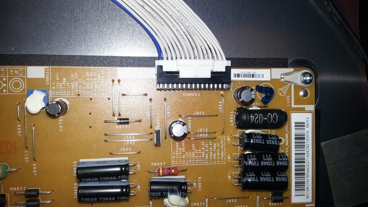

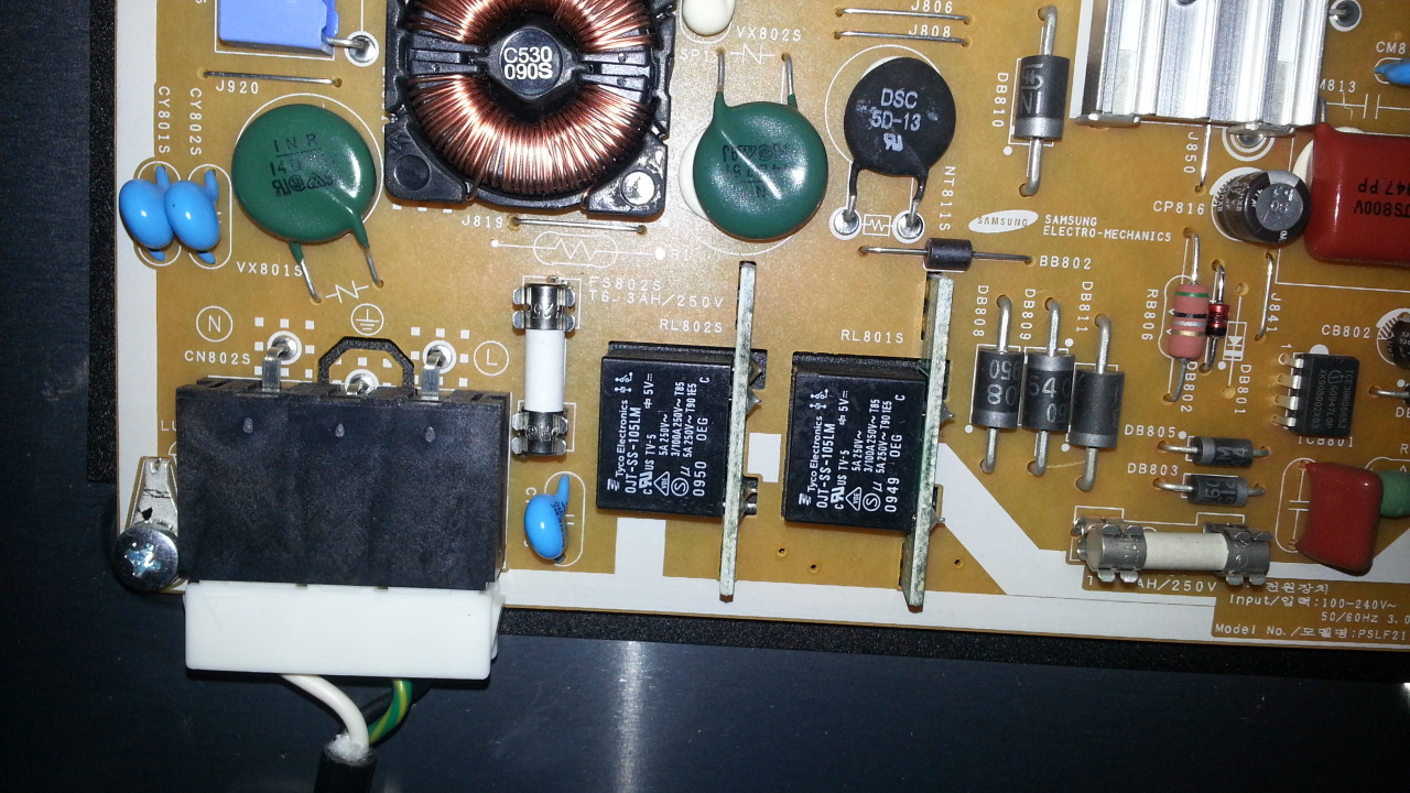

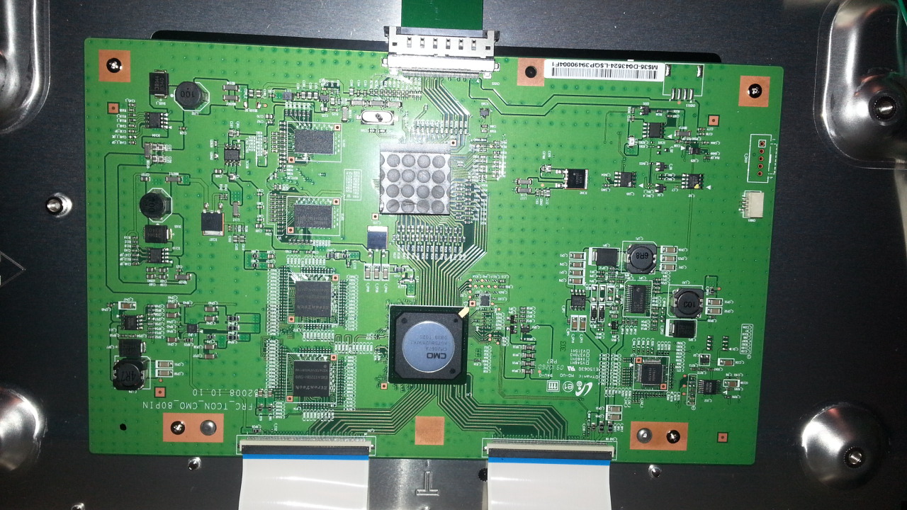

                Here are photos of the individual boards: Power, Main, and TCon (I presume).

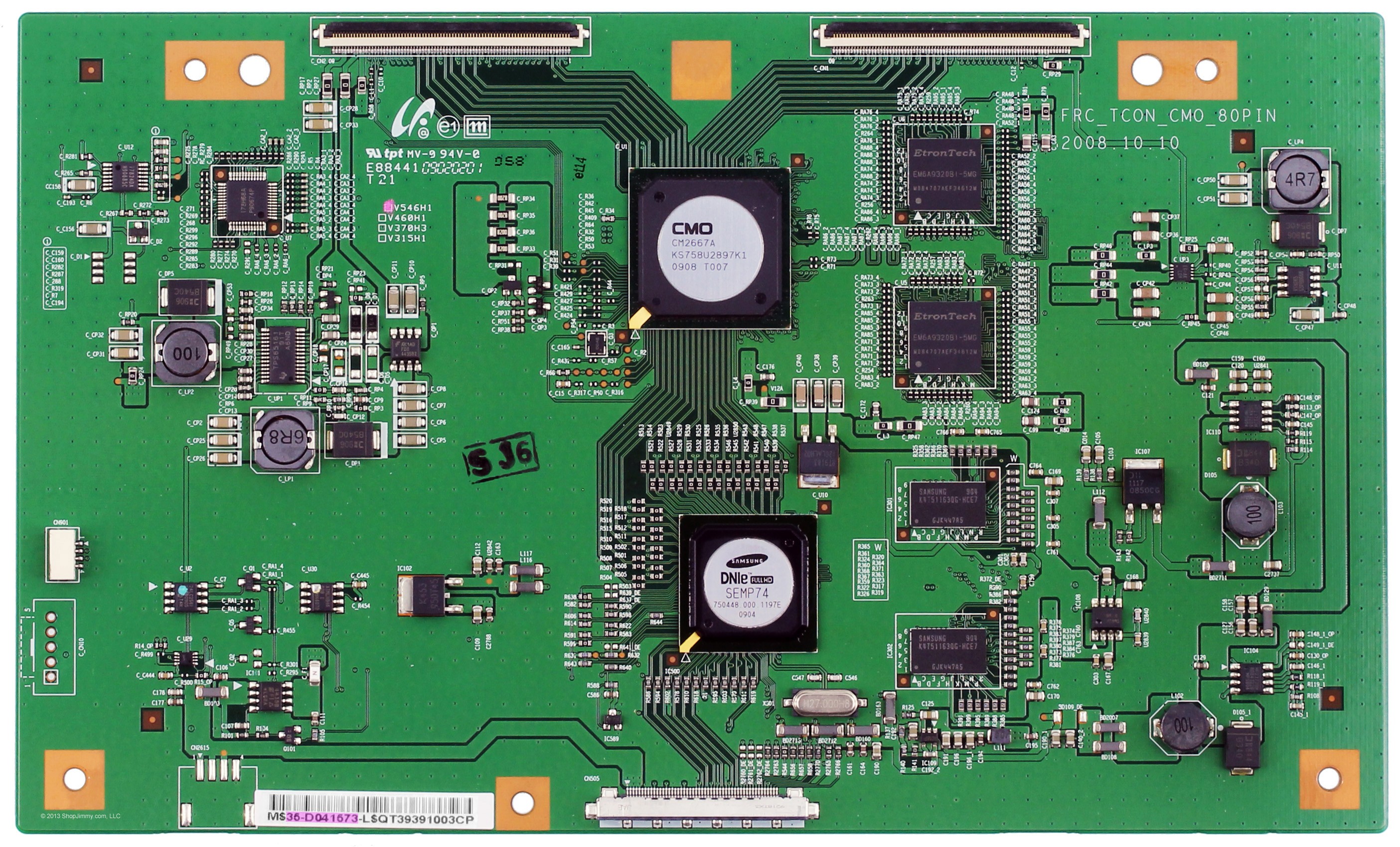

                  stole a better pic from shopjimmy for you from the T-con...

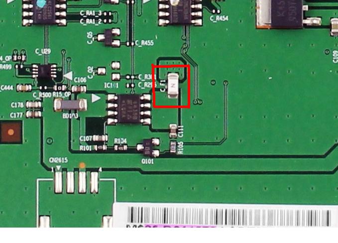

                    White FUSE CF1 on the bottom left of the board with 'N' printing on top. Also check the voltage right at the CN505 (or 605?) at the pin with a white triangle which indicates as pin 1.

                      Are these the areas you mentioned? I know the pics weren't ideal. I also don't know how to test voltage or current or for shorts...meaning I don't know what im measuring for or what numbers I should expect to see on the multimeter readout.

                        Check that fuse.Set your multimeter on ohm position.

                          Anyway the fuse budm is talking about is in the picture posted by Martino

                            Thanks for the feedback and I did find the fuse and the white arrow on the TCon board. It's installed upside down on the unit so I couldn't find anything in the "bottom-left" when I looked initially.

                              I would wait a sec with ordering a t-con...
                              Theres a few easy steps you can measure to kinda be sure you are ordering (or repairing) the right board....
                              To check that fuse on the t-con is easy.TV OFF(unplugged),set multimeter on ohm scale,on beep mode is good(touch both probes of meter together,you should hear a beep) and put the red probe on one side of the fuse,the black probe on the other side of the fuse....do you hear a beep?Does the display read 0.3 ohm?
                              If fuse seems good(0.2 to 0.3ohm is good) then put the multimeter on DC 20 volts....
                              Now turn on the TV(careful,don't touch anything),put the black probe on the chassis of TV and put red probe on one side of that same fuse,read voltage on meter,put red probe on other side of fuse and read again...
                              Report back your findings

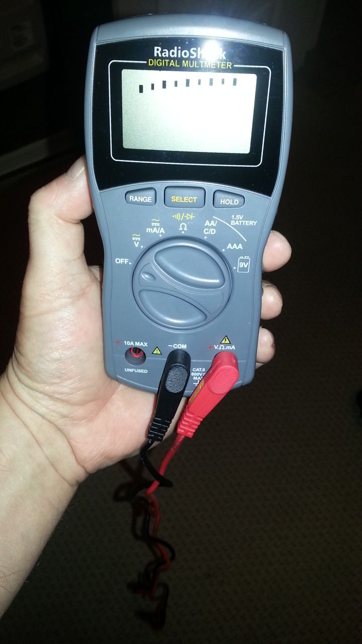

                                OK...my multimeter advised that the fuse circuit is open (vs shorted) but there was no readout of any ohms...merely says open or shorted and beeps accordingly. Again...the unit beeped when the probes where touched together, but no beep when placed on either side of the fuse. I tried different settings under "Ohms" but nothing came back with any readings I then turned it to measure the volts, and grounded the black wire to the chasis and probed the red wire to both sides of the fuse as suggested (with the tv plugged in and my wife standing by ready to dial 9-1-1). The reading came back 0.0000 for both sides assuming I had the setting correct.
                                I've also included a pic of the multimeter I have. A simple $40 unit from RadioShack but I was told it was a decent if not minimalistic. The instructions are extremely basic as well and not a whole lot of help unless you want to check batteries.

                                  zero volts on either side of fuse seems weird... Was the tv turned ON or just plugged in?
                                  TV will have to be ON in order to get voltage to t-con.
                                  Also make sure that on your multimeter,it shows a solid line with dots underneath on the display when on volts,NOT a ~ symbol.

                                    Yes - i thought it odd too- easy test is set it on what you think is vDC and test a
                                    battery AA AAA PP3 whatever.
                                    If that reads the volts you are expecting the next place to test would be on the Connector
                                    CN505 on the inverter board. Set powered up, meter on 20vDC - you see the five pins at one end between the two dark lines - they are all connected and it is the voltage feed from the main board. So black on chassis red on pin 3 say.
                                    Also its sometimes only good using the chassis if the board is screwed hard down
                                    otherwise put in one screw and black lead on the screw.
