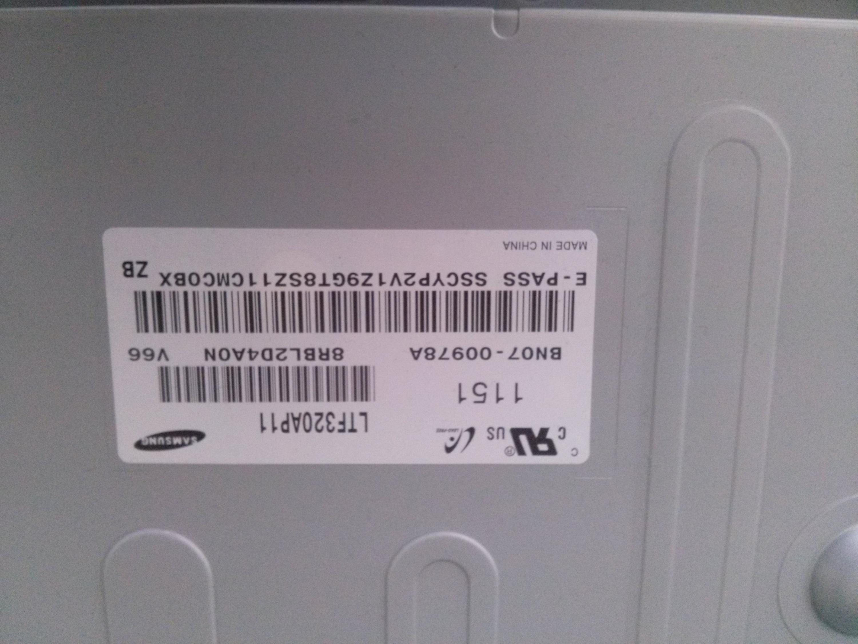

    Samsung LE32d400E1W has gost image.
    Seems like the red colour is offset by 1mm down.
    4cm on the bottom of the screen is working fine.

      would need a picture of the inside of the unit from the backside showing the boards and the lcd panel model number

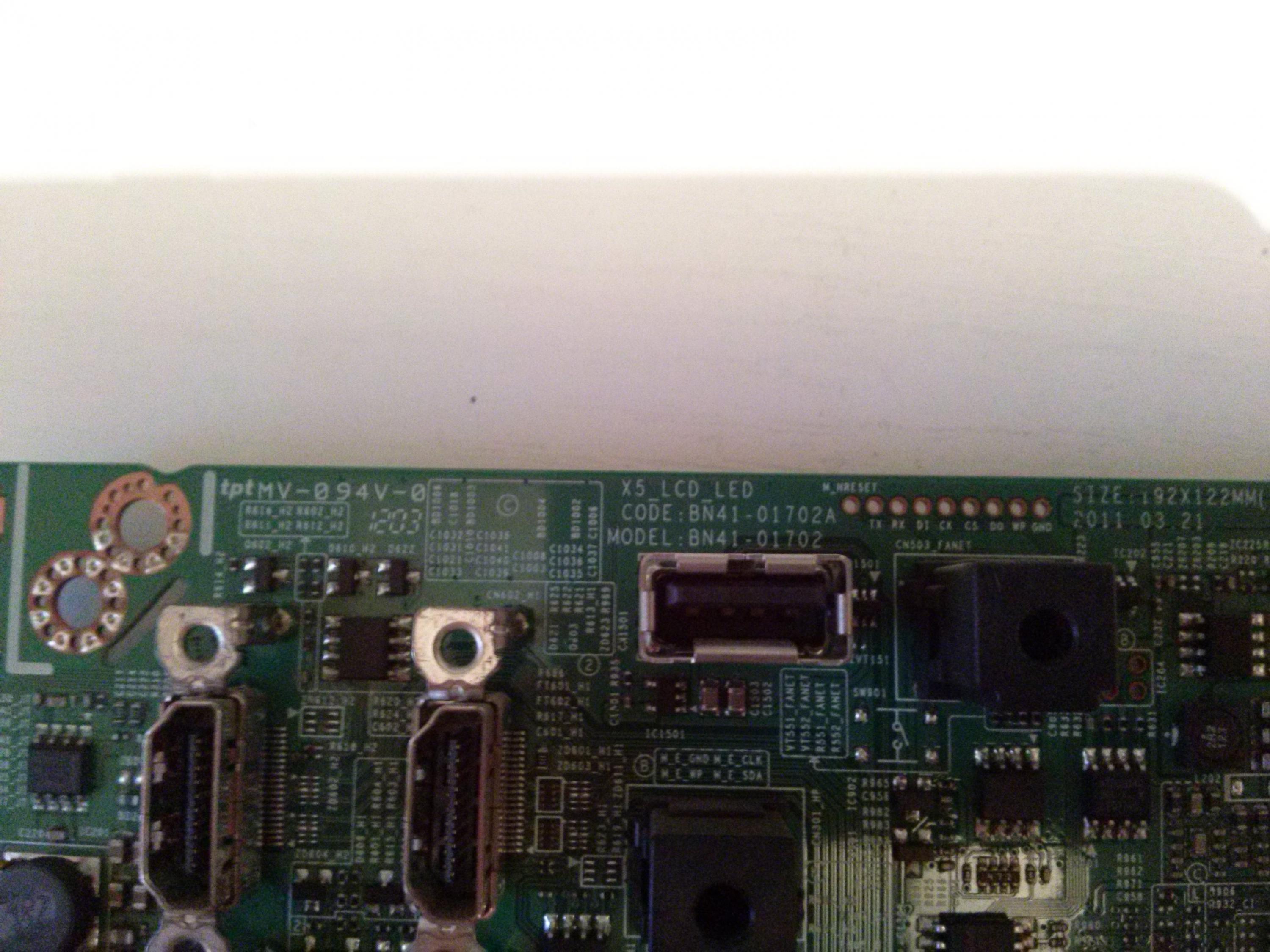

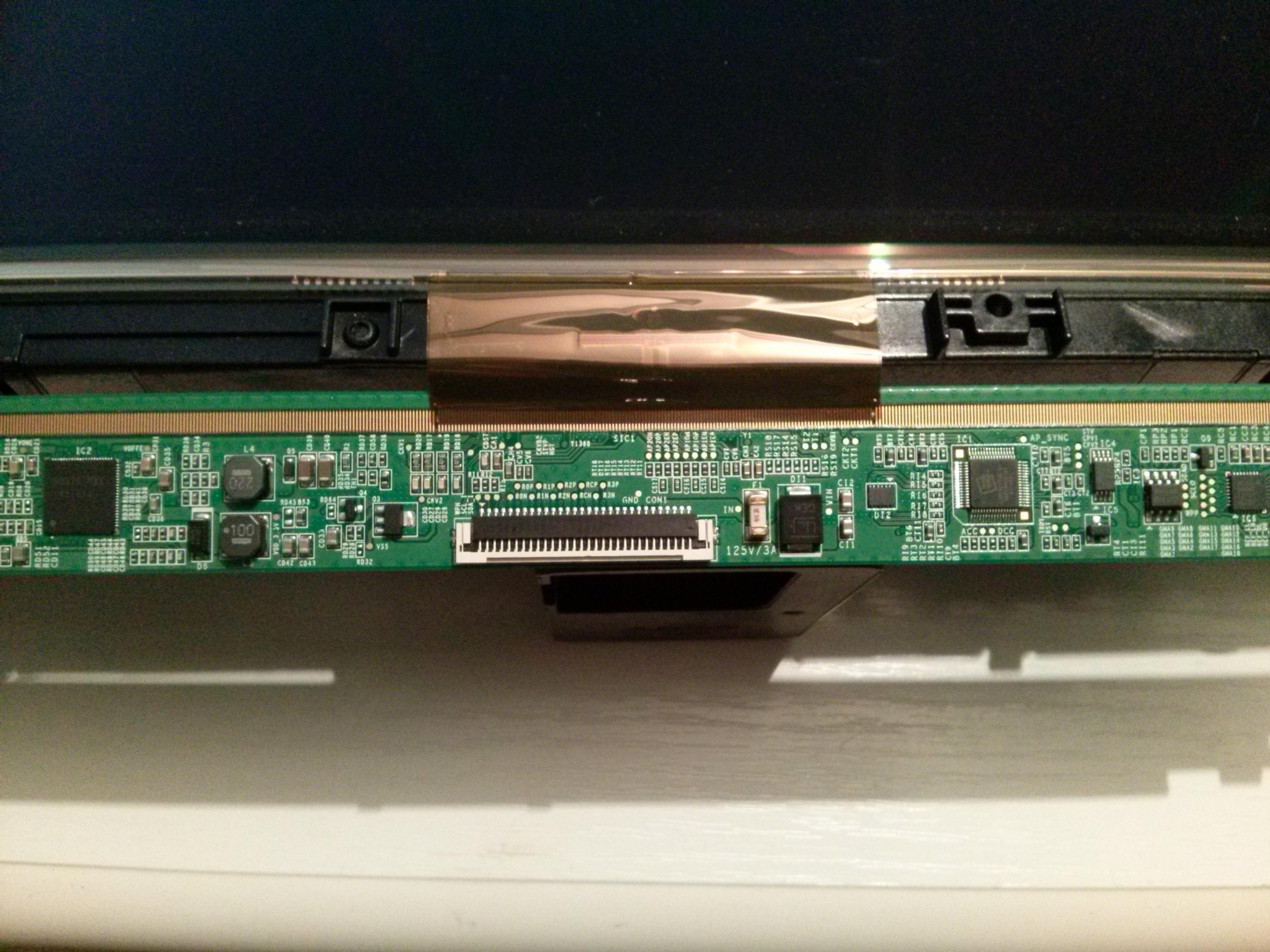

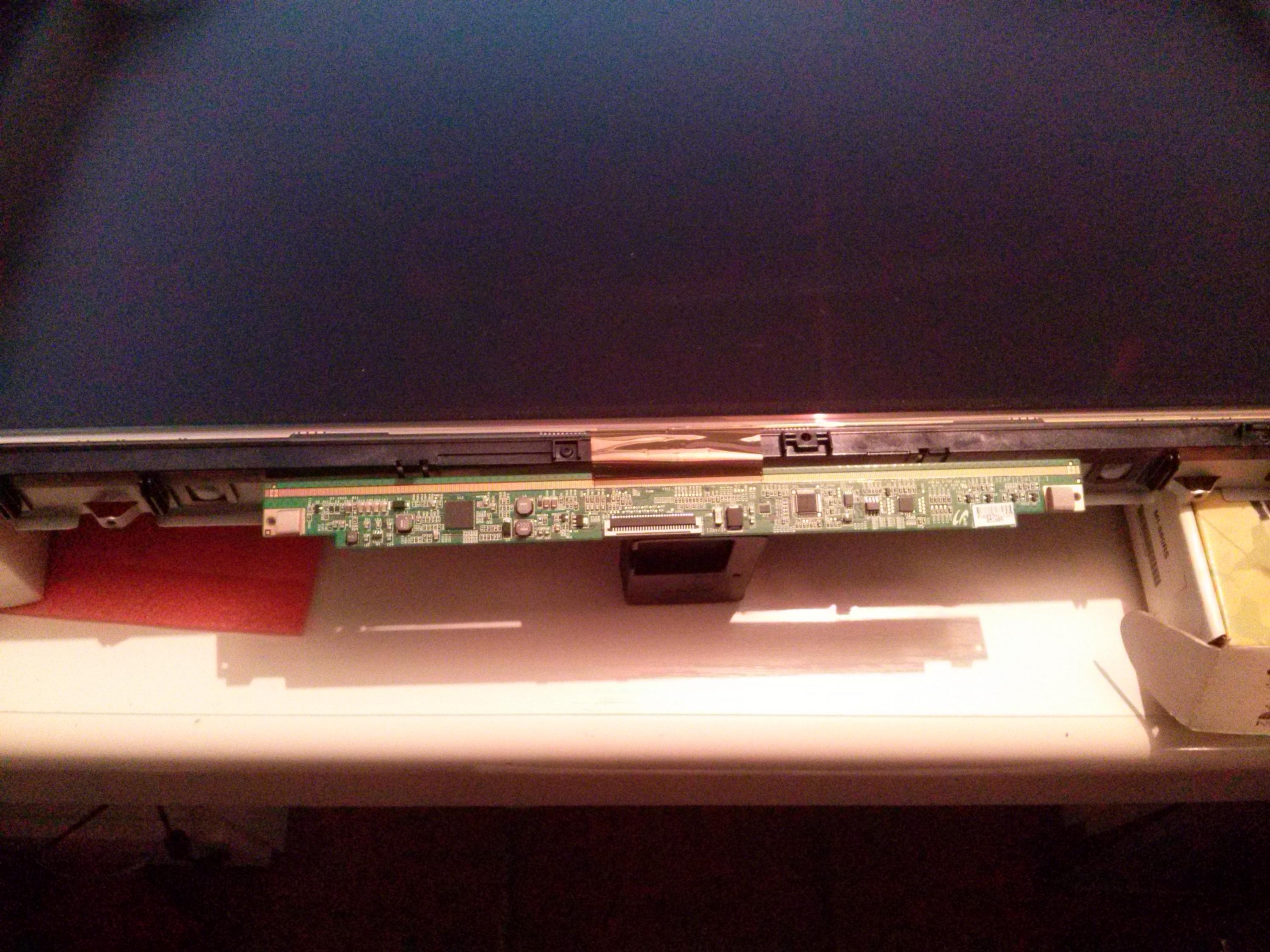

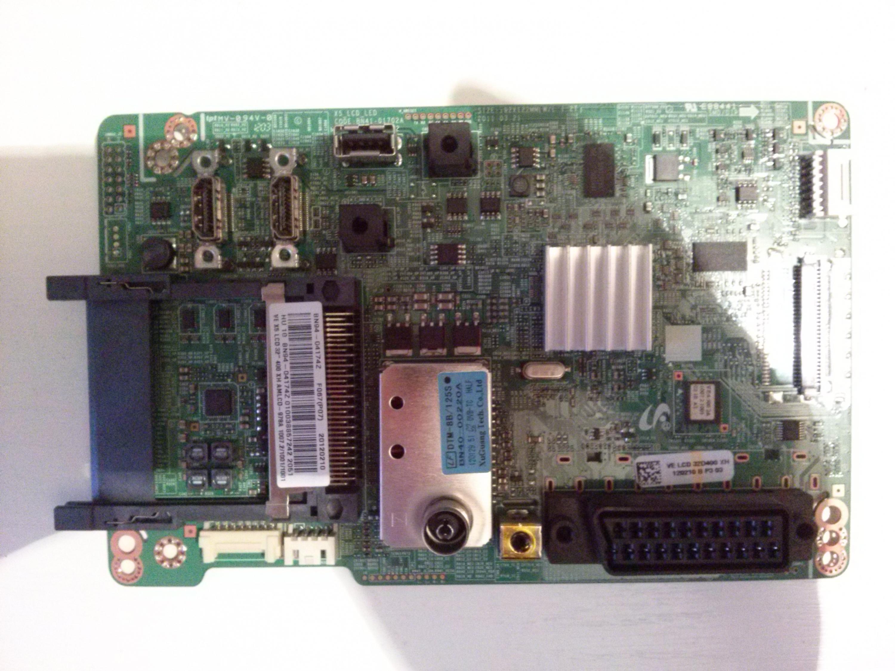

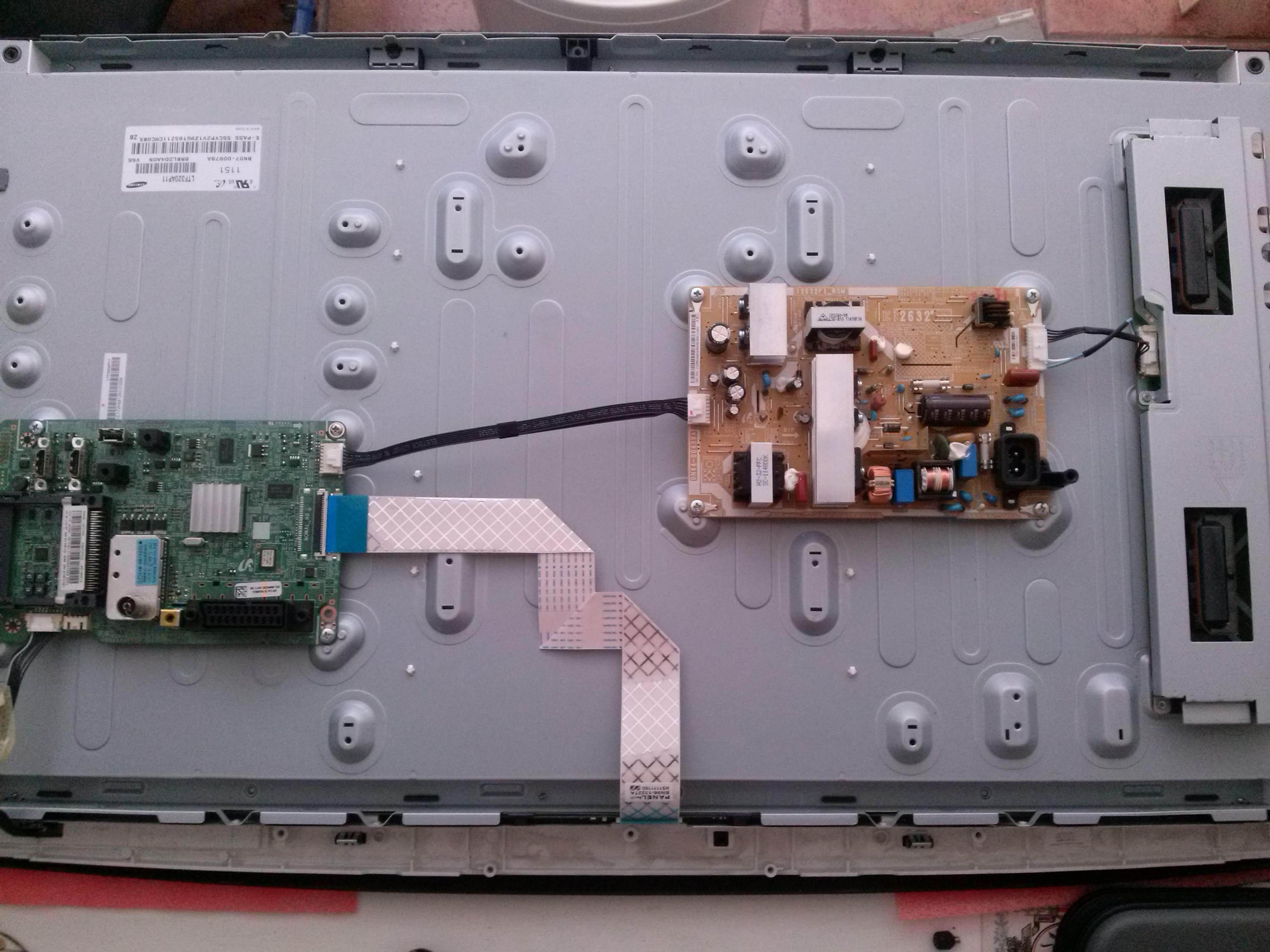

            Here are the pictures
            Tcon is mounted directly to the bottom of the panel, flat cable that comes from mainboard is detachable, the second one from Tcon to panel is glued.
              Re: Samsung LE32d400 double image
              That cable is more than likely removable, but That probably is not a factor unless you are losing some power that feeds the screens pixels ??
              Since the board is on the bottom (which is good for heat but bad for spills and condensation) and since the bottom works, then it is probably the panel.
              It looks like not enough power is making it to the upper sections.
              If you feel ambitious , you could remove the front frame, then remove the metal frame around the lcd, then look for the plastic tabs that are on the bottom edge and probably on the right and left side (There probably is one right where the picture changes from good to bad).
              Then, once you find those, with rubber gloves, try applying a touch of pressure to the ribbons and where they meet the glass. (basically targeting the end ones on the bottom and the side ones (If any) near where the problems change) this may give you an answer
              also , once the trim is off, you'll get a better look at that ribbon mount. and for hahas, you can clean the contacts if you see a way to disconnect it.

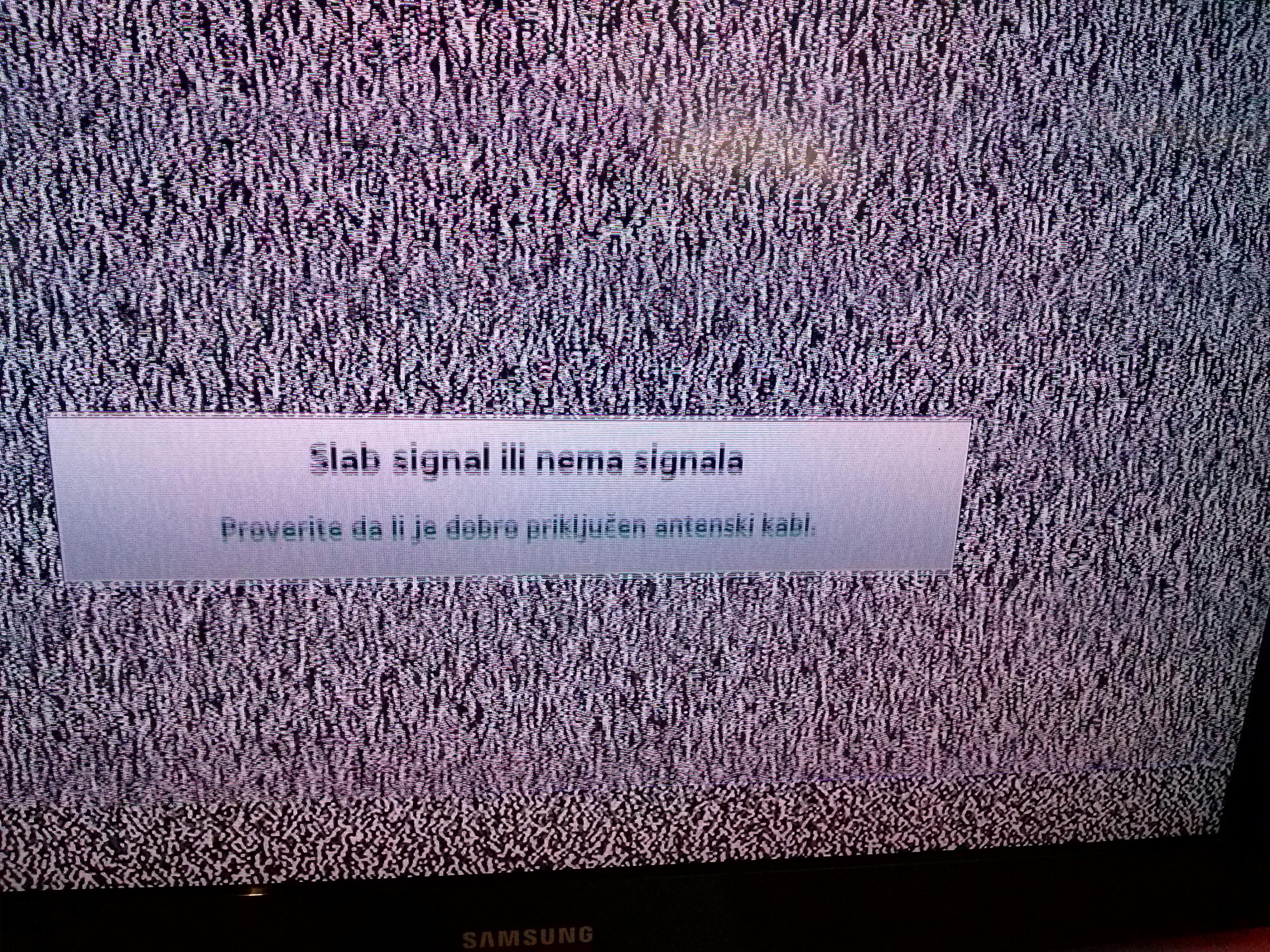

                              here is an excerpt from the handbook - maybe worth a try or perhaps try another aerial or is it on all inputs
                              English DigitalNoiseFilter(Off/Low/Medium/High/Auto/AutoVisualisation): If the broadcast signal received by your TV is weak, you can activate the DigitalNoiseFilter feature to reduce any static and ghosting that may appear on the screen. N When the signal is weak, try other options until the best picture is displayed.

                                Yes there is only one brown ribbon with some little black element stuck in the middle of that ribbon as a part of it and it is hot. I have disassembled tv earlier it is not that ribbon from the picture. I will add picture of it later today.

                                Picture is bad in all modes (inputs)

                                  Here are the pictures of t-con and that braon one flat cable
                                    That IC on the flexible PCB is the TFT driver IC, it does run hot.

                                        This is the new design, the gate driver is embedded in the panel (known as "Gate in Panel" design.) Inherently, that SHOULD be more reliable... no tab bond to fail and the gate drivers usually don't run that hot. It seems the failure is actually in the drive signals from that top tab not reaching the panel.
