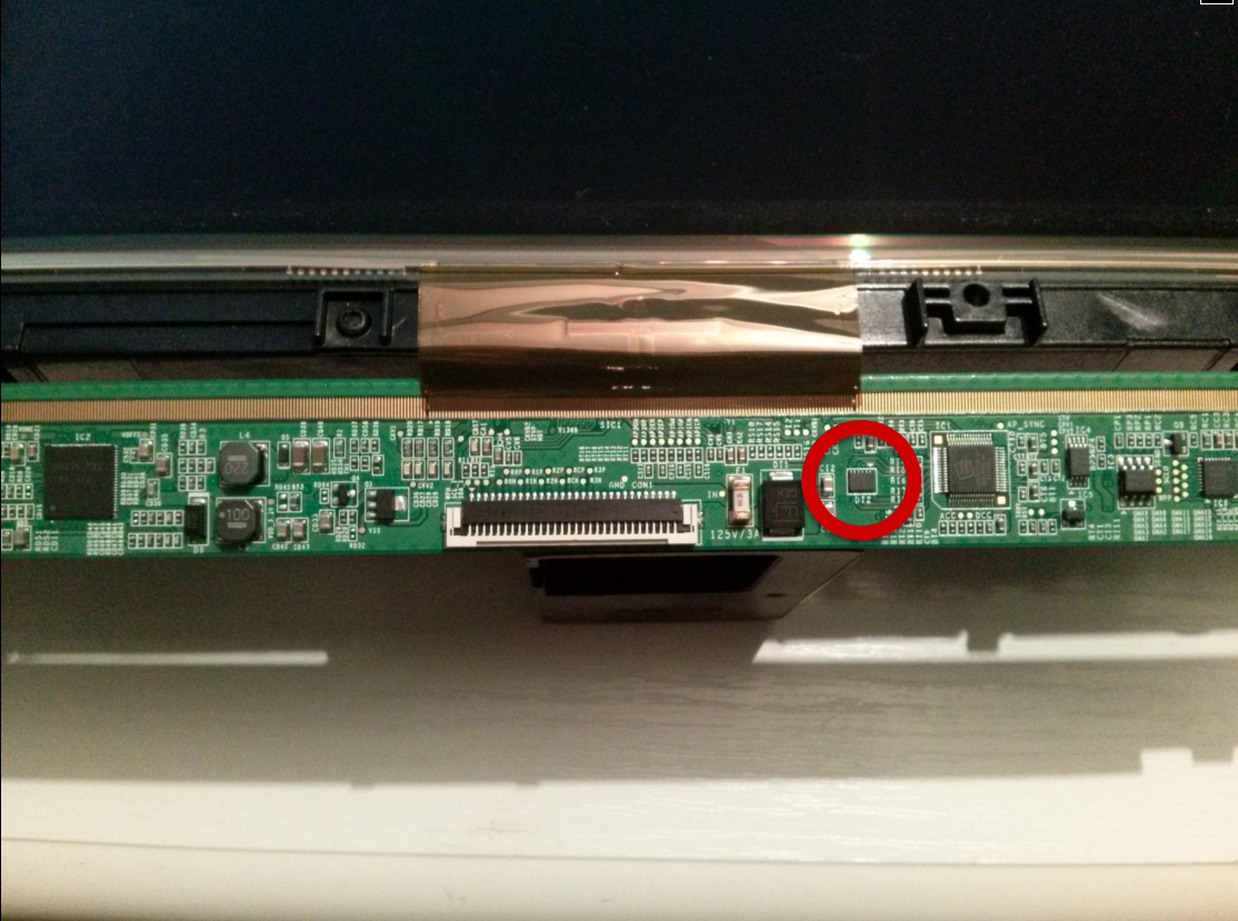

    Originally posted by branislav18
    Here are the pictures of t-con and that braon one flat cable
    I know I'm late to the party, but here's the issue for anyone still potentially having this problem.
    The problem 99% of the time is the TVS diode array, it's the IC labeled 7512N.
    I've circled it in one of your photos. I've also uploaded the datasheet for it. You can find the replacement on Aliexpress/Mouser.
    Replacing it fixes this issue.
