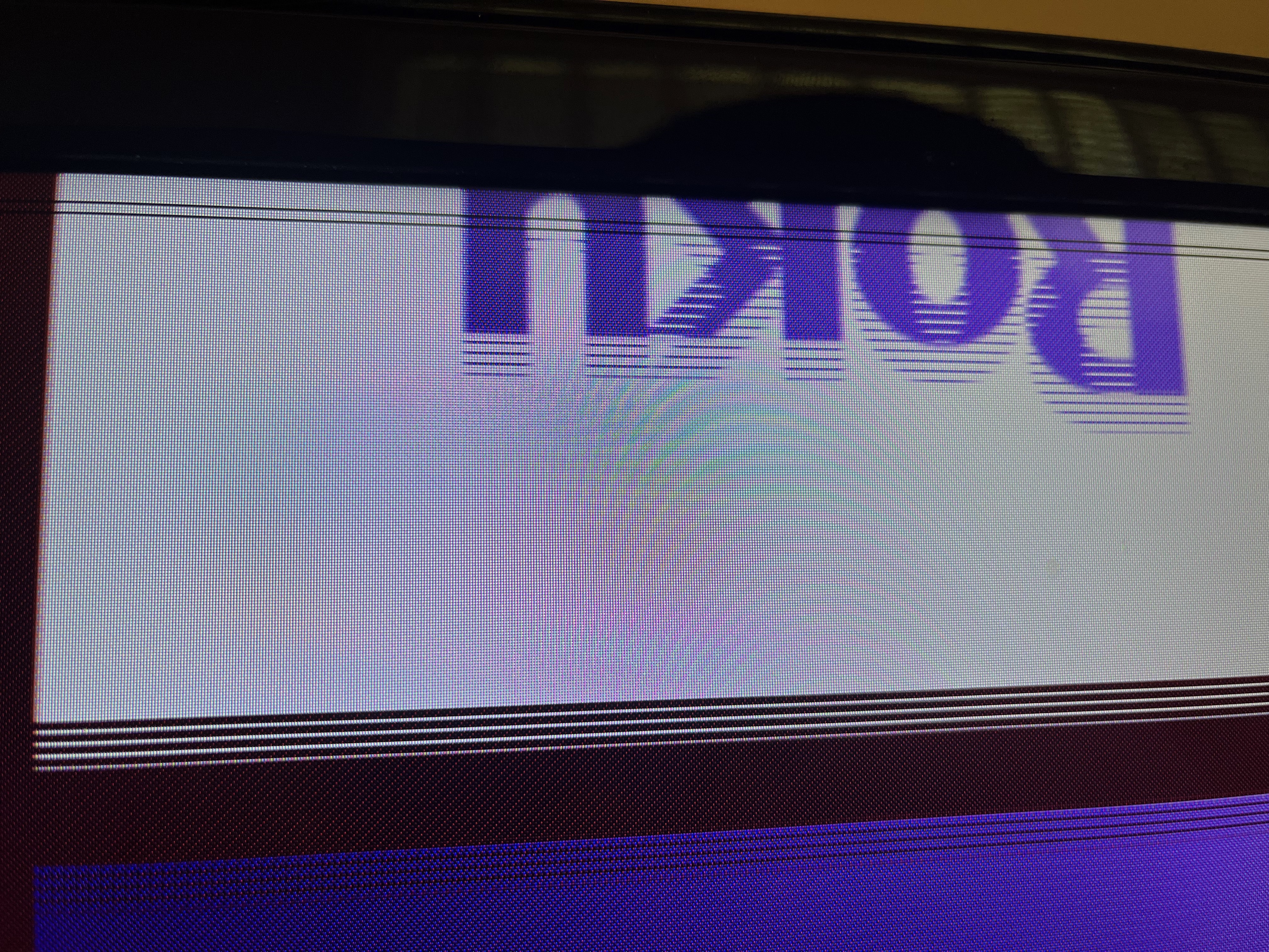

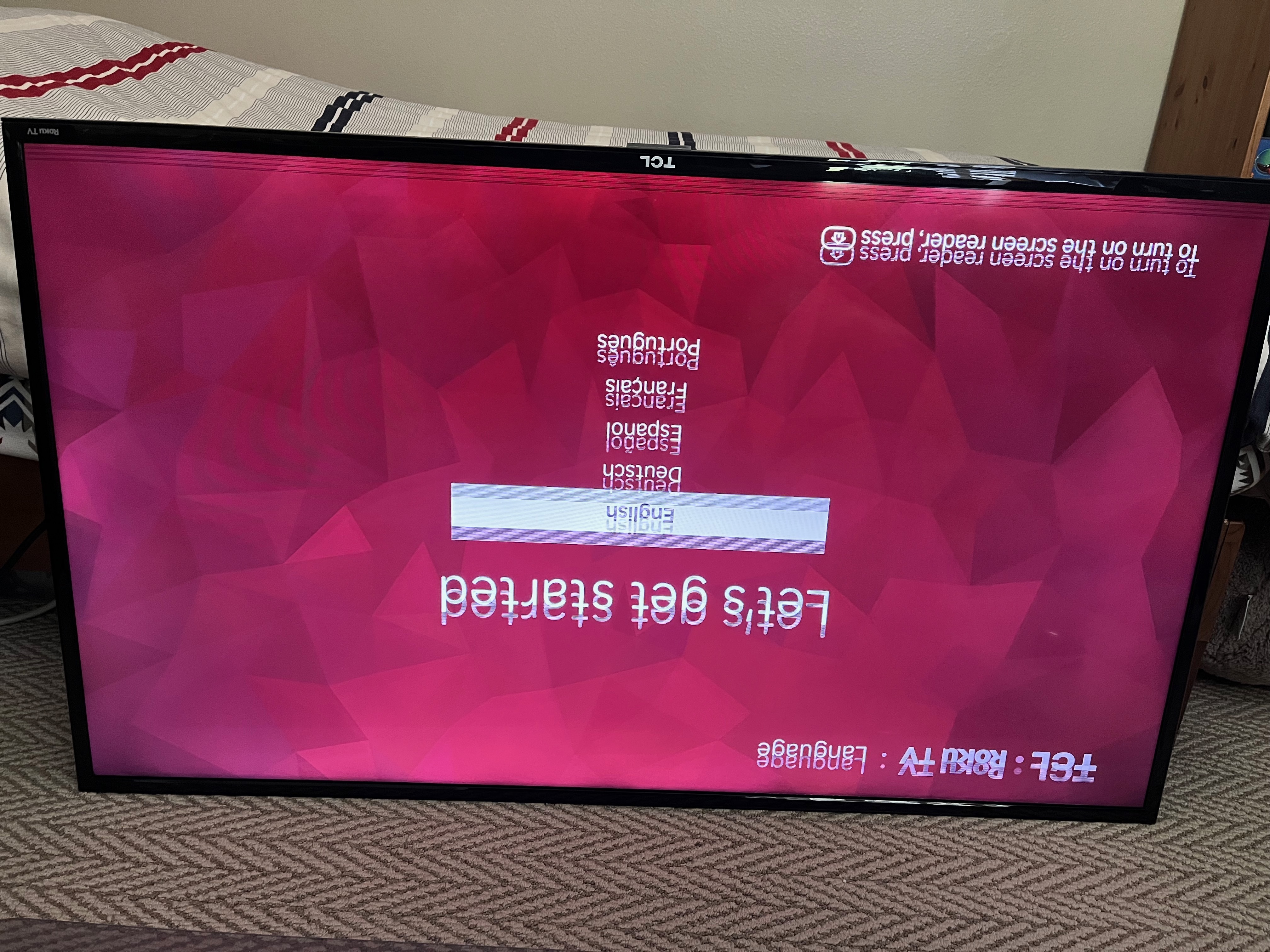

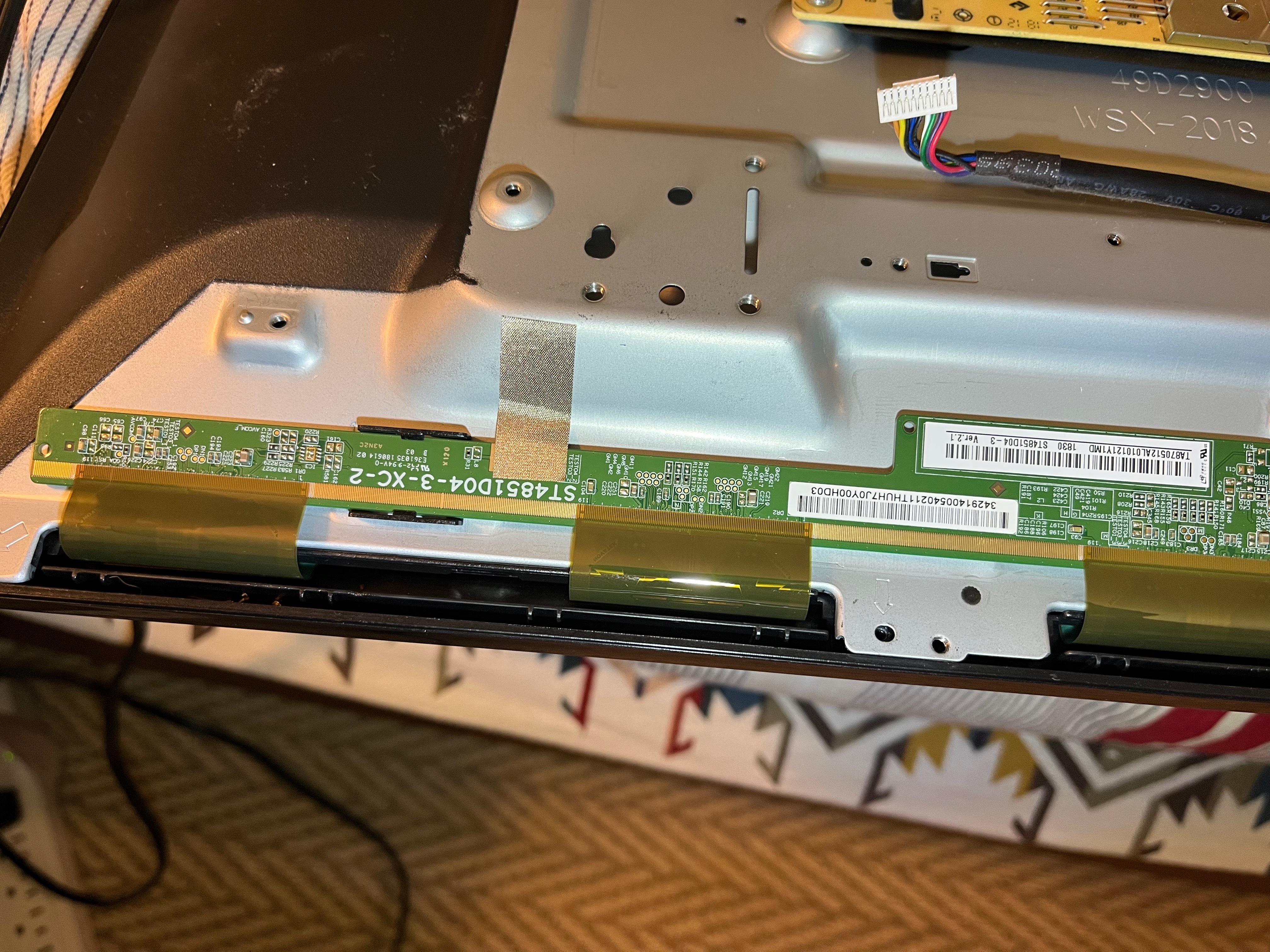

    TCL 49S405 double image

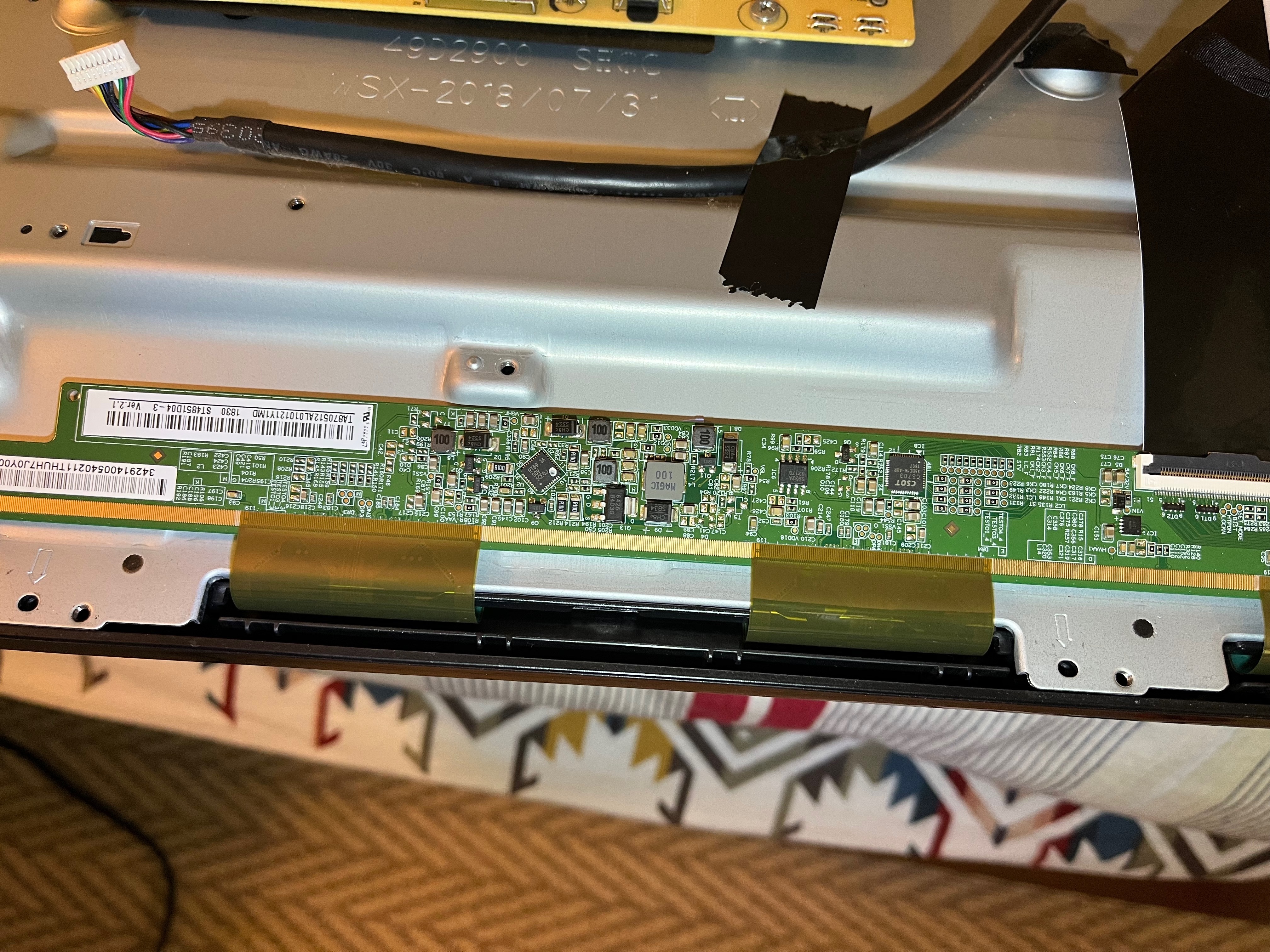

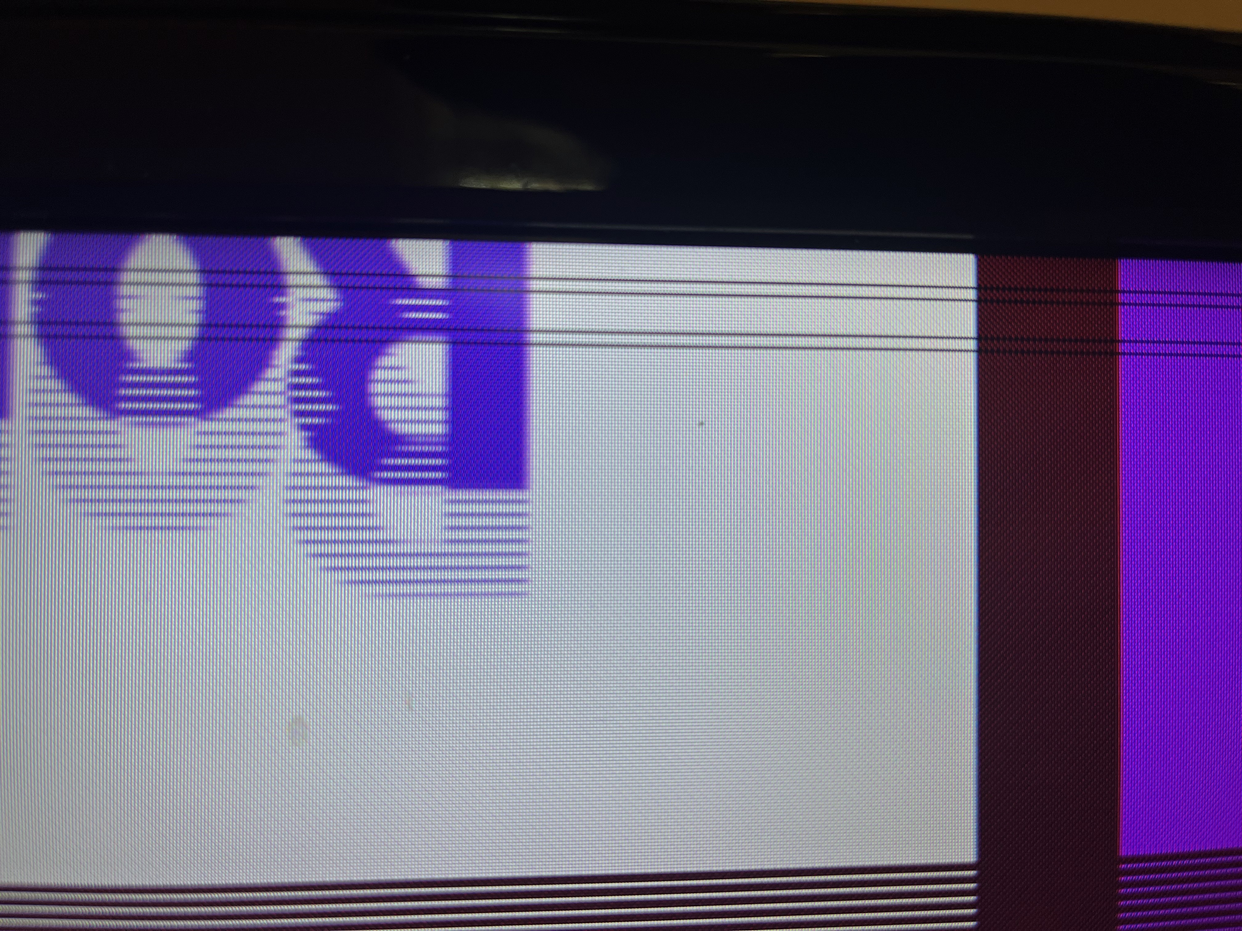

    LCD displays a 2nd image slighty offset vertically. And multiple pairs of black lines along the bottom. Probably common as google "TCL 49S405 double image" pulls up this ifixit post ( link ) with identical ( nearly, but their fault seems to be on the other half of the panel than mine ) problem without solution.

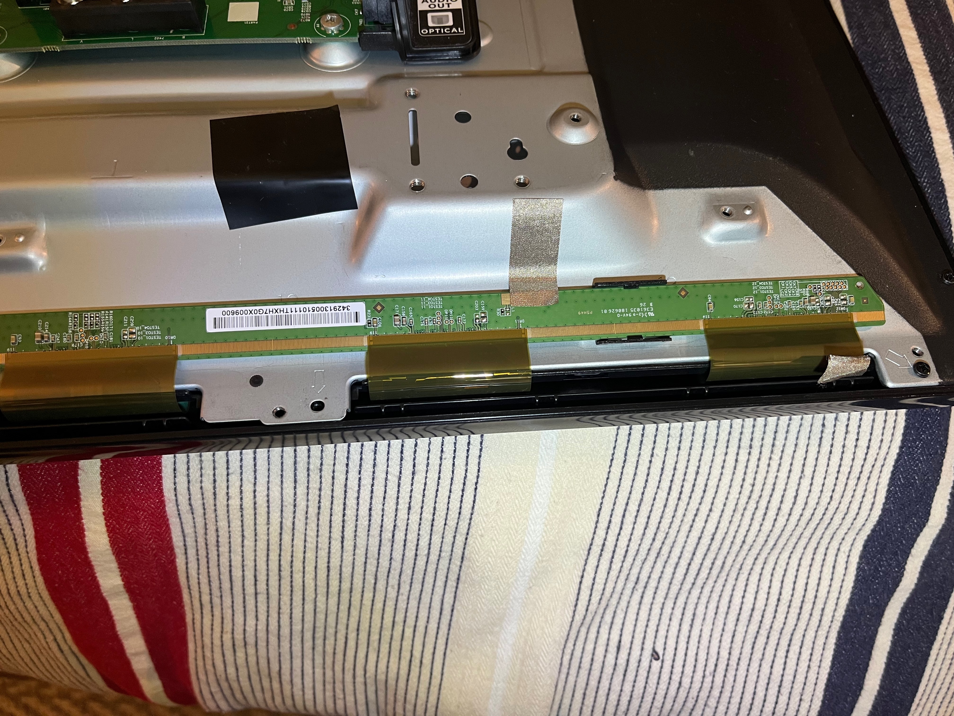

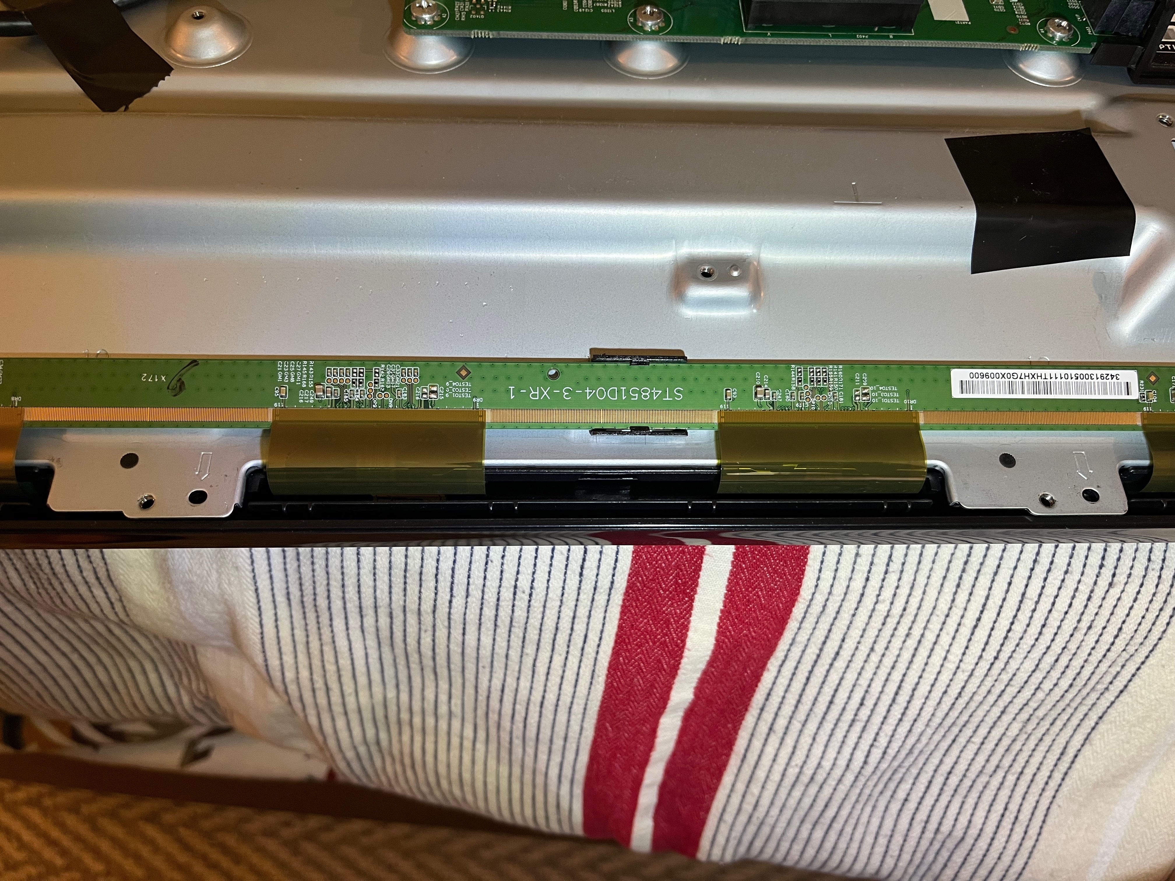

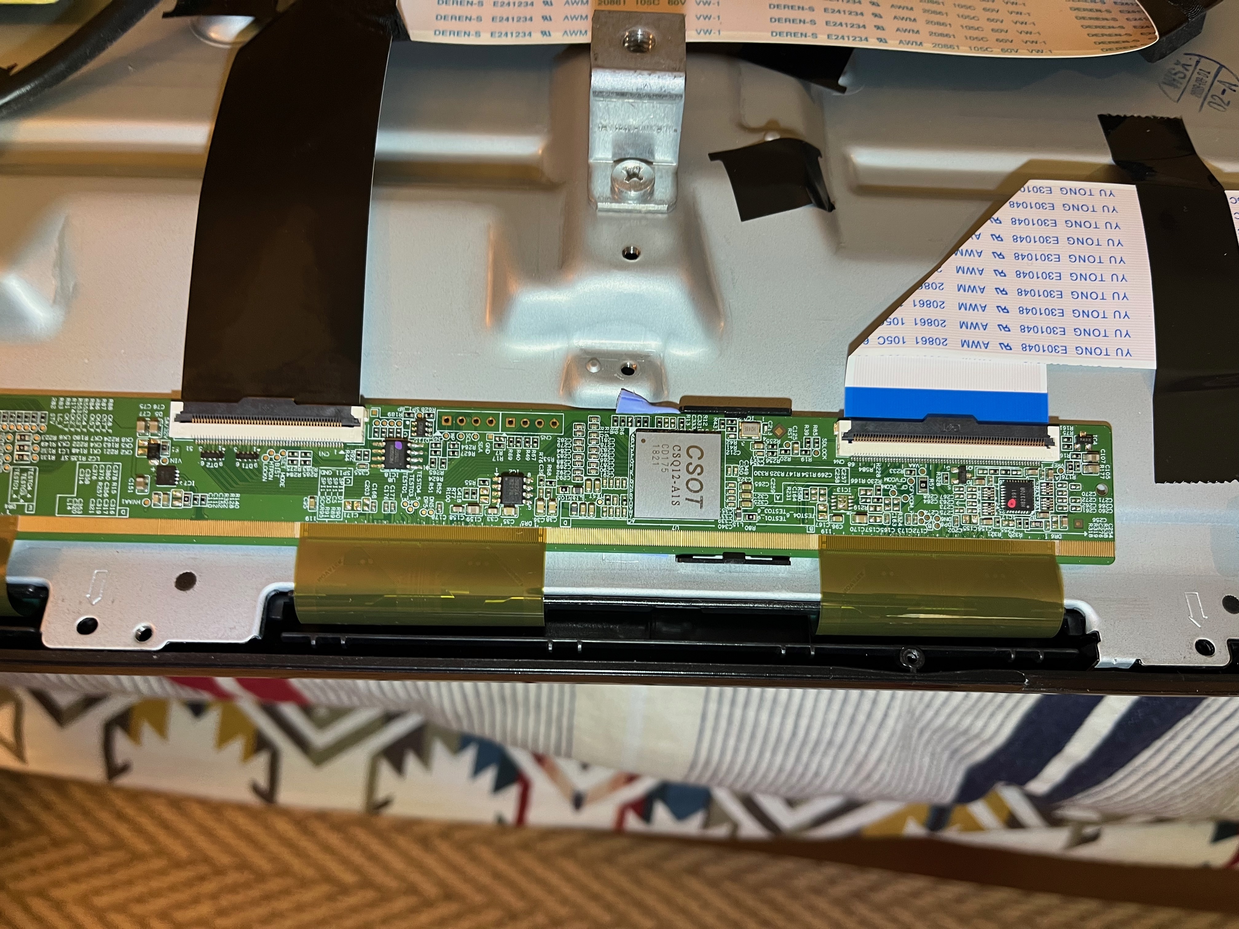

    This one looks to be a more difficult to diagnose because most? of TCON seems integrated ( CSOT BGA on buffer baord) into the left panel edge board ( looking from rear of TV) There are 2 buffer boards for each 1/2 of the screen. Main connects to the left buffer board where TCON is, then flex connects left buffer board to the right board. Disconnecting the right board gets double image on the left half and white on the right half. Unfortunately, with TCON integration on the left buffer board, can't disconnect the left half of the panel while driving the right half.
    No shorts on all the caps on the left buffer board.
    There are 1x to 4x pairs of black lines cross the bottom of the panel (see pic) When TV is first turned on, there will be 4x pairs. After few seconds, 3x pairs, after about 1/2 min 2 pairs and couple of minutes later, only 1x pair remain which unfortunately never goes away.
    No circuit at the outer ends of the buffer board looks like gate driver line resistors I can remove like an LGs I previously fixed.
    Randomly masking off main to left buffer board connection doesn't fix anything as expected on this integrated design.
    Any suggestions how to go about this ultra integrated more difficult panel to diagnose the faulty component?

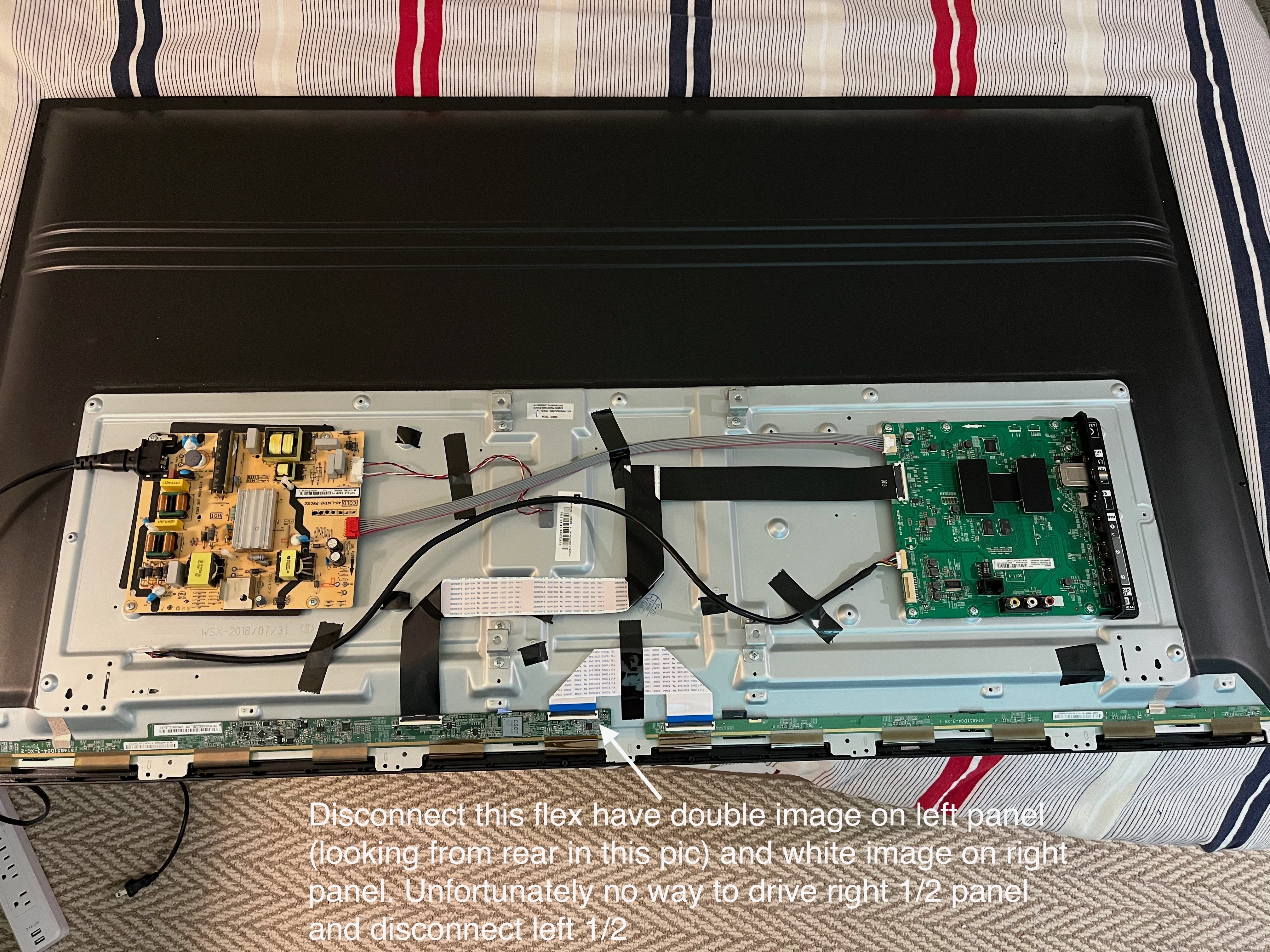

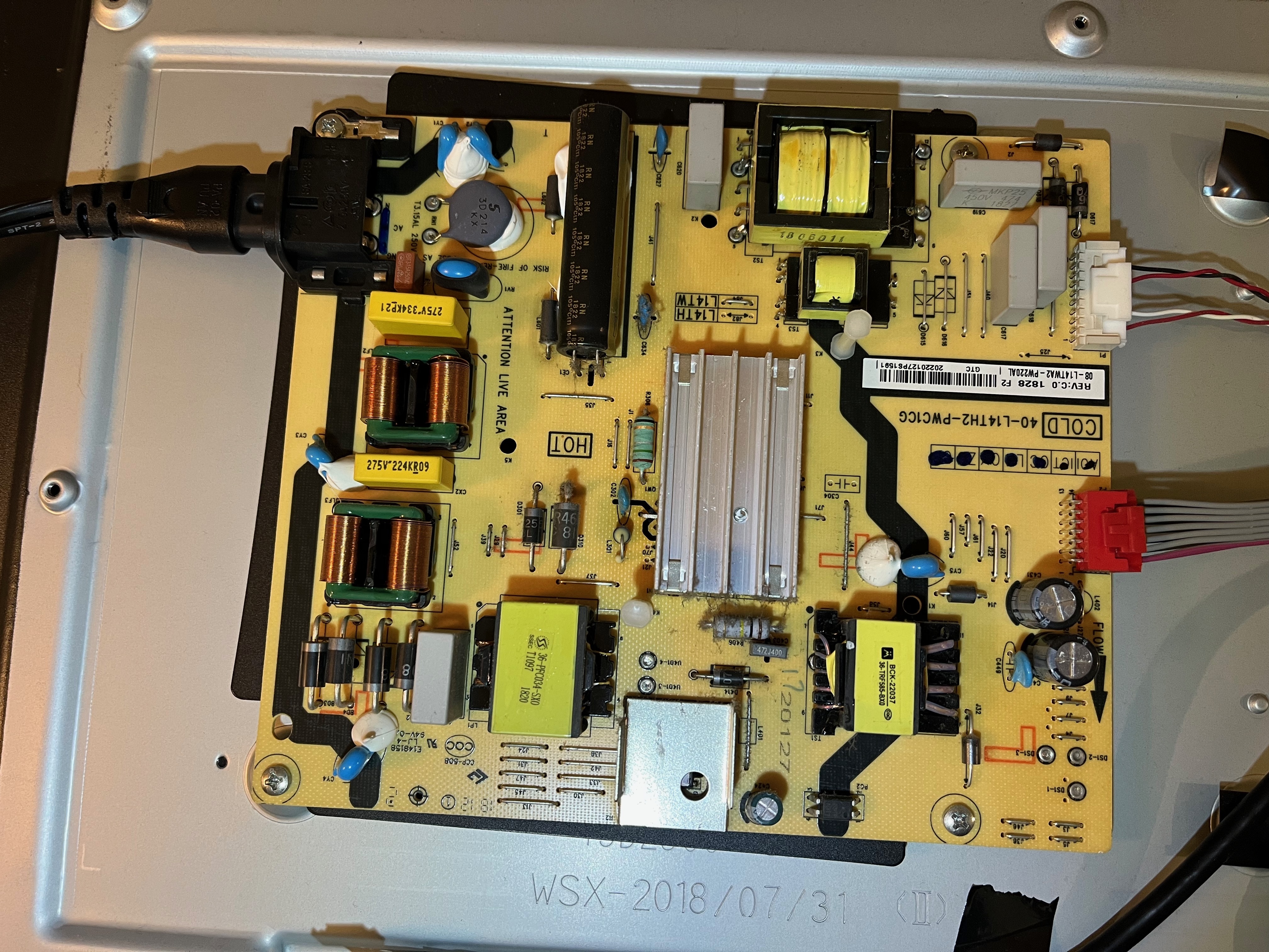

    Panel short. Not fixable. That's my thoughts.. try and Google fixing TV with tape.
    With these TCL when you disconnect each half of TCON you will see full half image on each side. If screen is fine will be no lines or defects on either side.

      Thanks, unfortunately can't do the typical trick of disconnecting each 1/2 of the panel and tape trick. Connection path is main -> left buffer board -> right buffer board noted in the original post (probably too wordy). Disconnect left and you lose the connection to the right. And tape is not going to matter since tape is blocking main -> left which then also kills the right. So no way to mask one edge signal and use the other edge.
      But I found the smoking gun and will follow detail pics in next post.

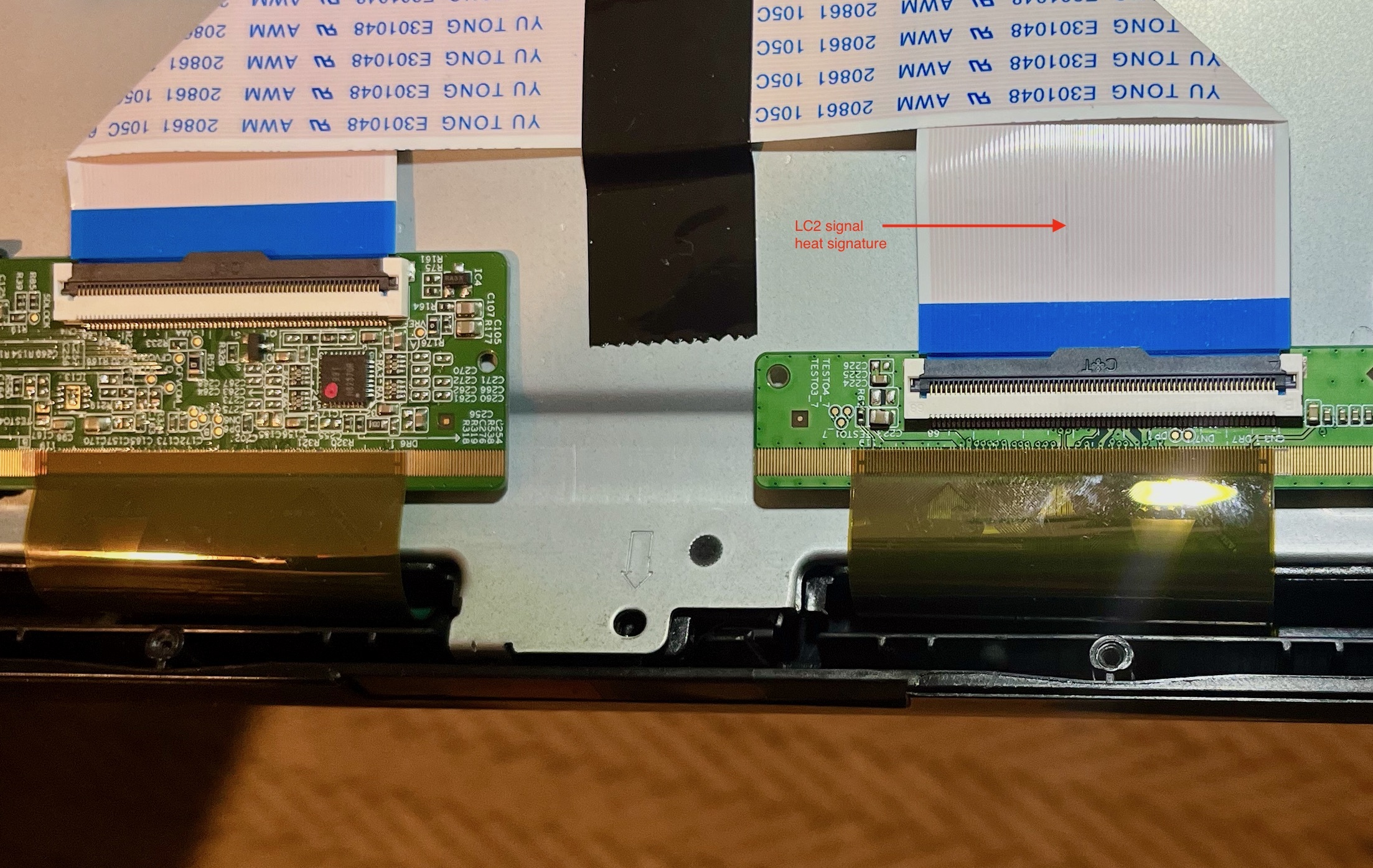

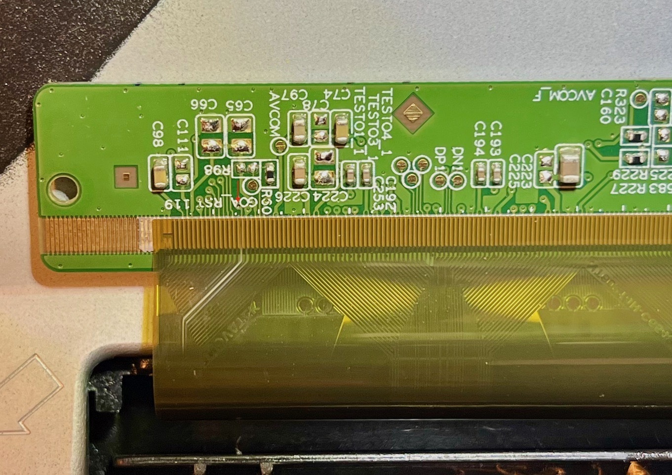

          Think I found the smoke gun on the failure.
          Outer most buffer board to panel flex cable on both left and right shows LC2 signl trace is discolored. Was able to trace continuity of LC2 probe point next to the timing chip to outer edges of both buffer board's discoloration traces on the outer most flex. Right buffer board also has label LC2 on this trace.

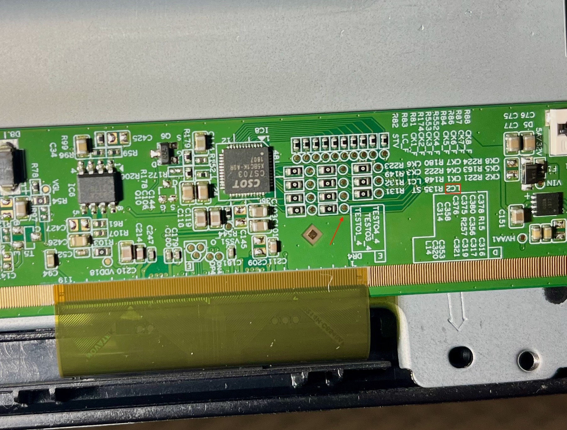

          Here is the CSOT timing chip (on left buffer board) with LC2 probe point (red arrow)

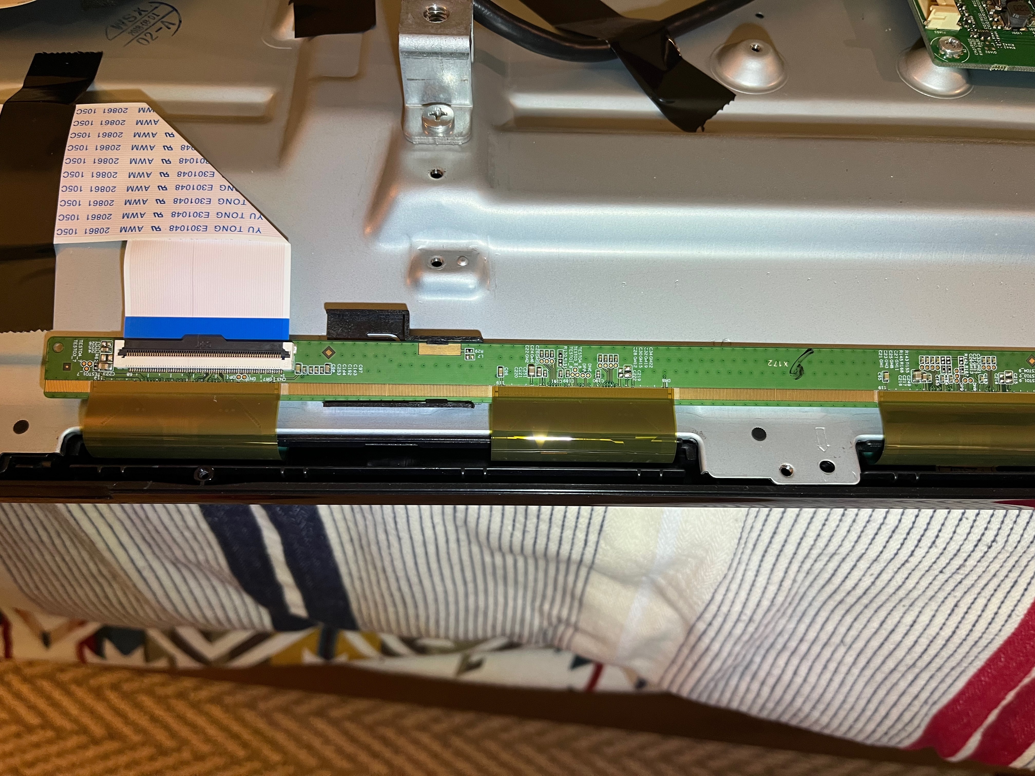

          Here is outer edge of right buffer board with LC2 probe point (red arrow) and flex trace discoloration
          Click image for larger version  Name:	IMG_4517.jpg Views:	0 Size:	868.5 KB ID:	3666206

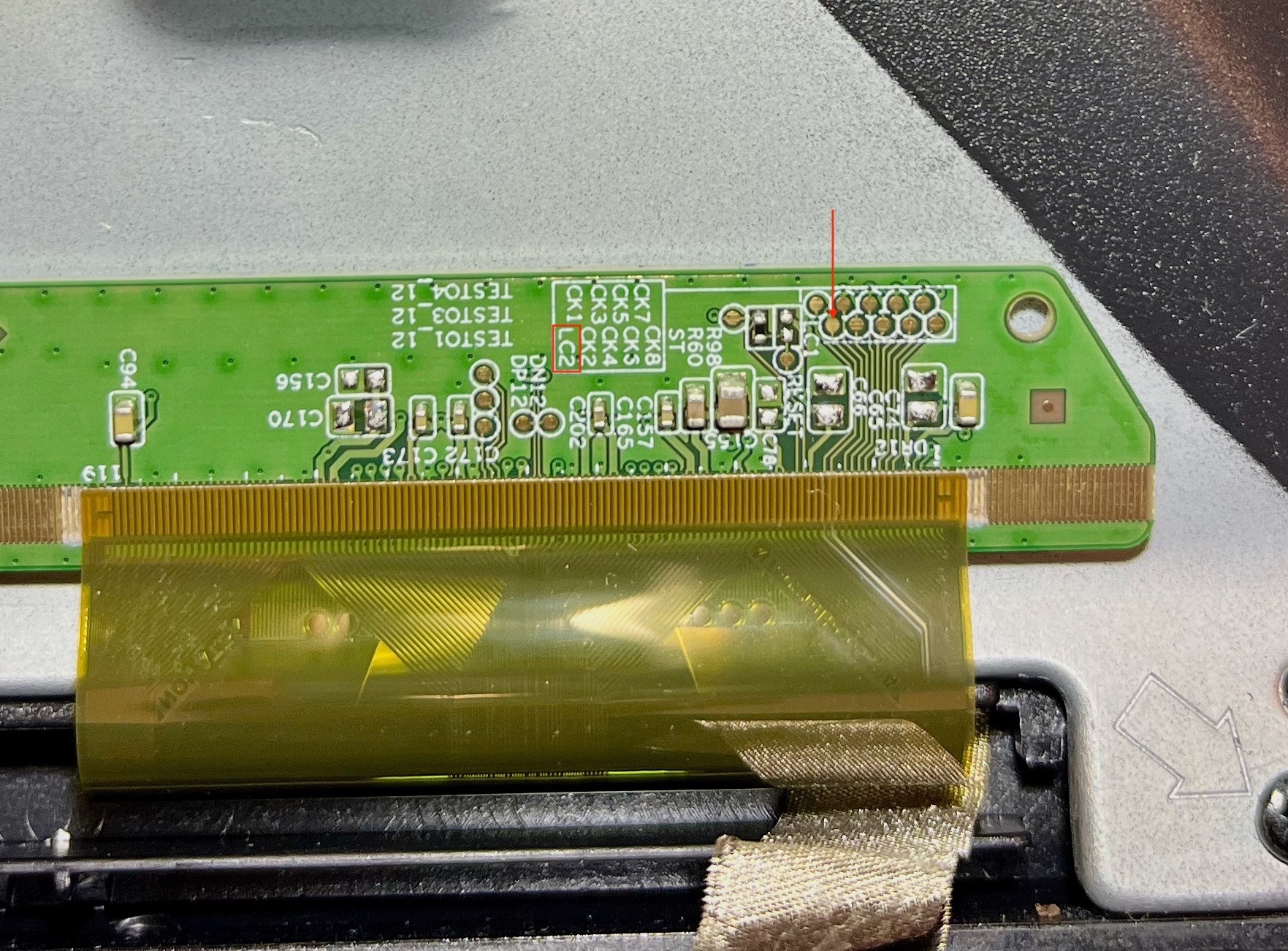

          Here is outer edge of left buffer board with probe point just above A of GOA (red arrow) and flex trace discoloration. Probe point is continuous to LC2
          Click image for larger version  Name:	IMG_4519.jpg Views:	0 Size:	409.5 KB ID:	3666204
          So unfortunately, damage seems to be in the panel/COF on both left and right side. Likely can't cut one side and depend on the other.
          However, since my panel exhibit the problem with right buffer board disconnected. I suppose cutting the left buffer board's LC2 and relying on the right side may potentially offer a solution. But since right side LC2 trace is also discolored, perhaps wishful thinking.
          I suppose if I have fancy flex bonding machine to bond to board and glass and a replacement flex with COF on there, its a potential repair but who has those equipment haha.

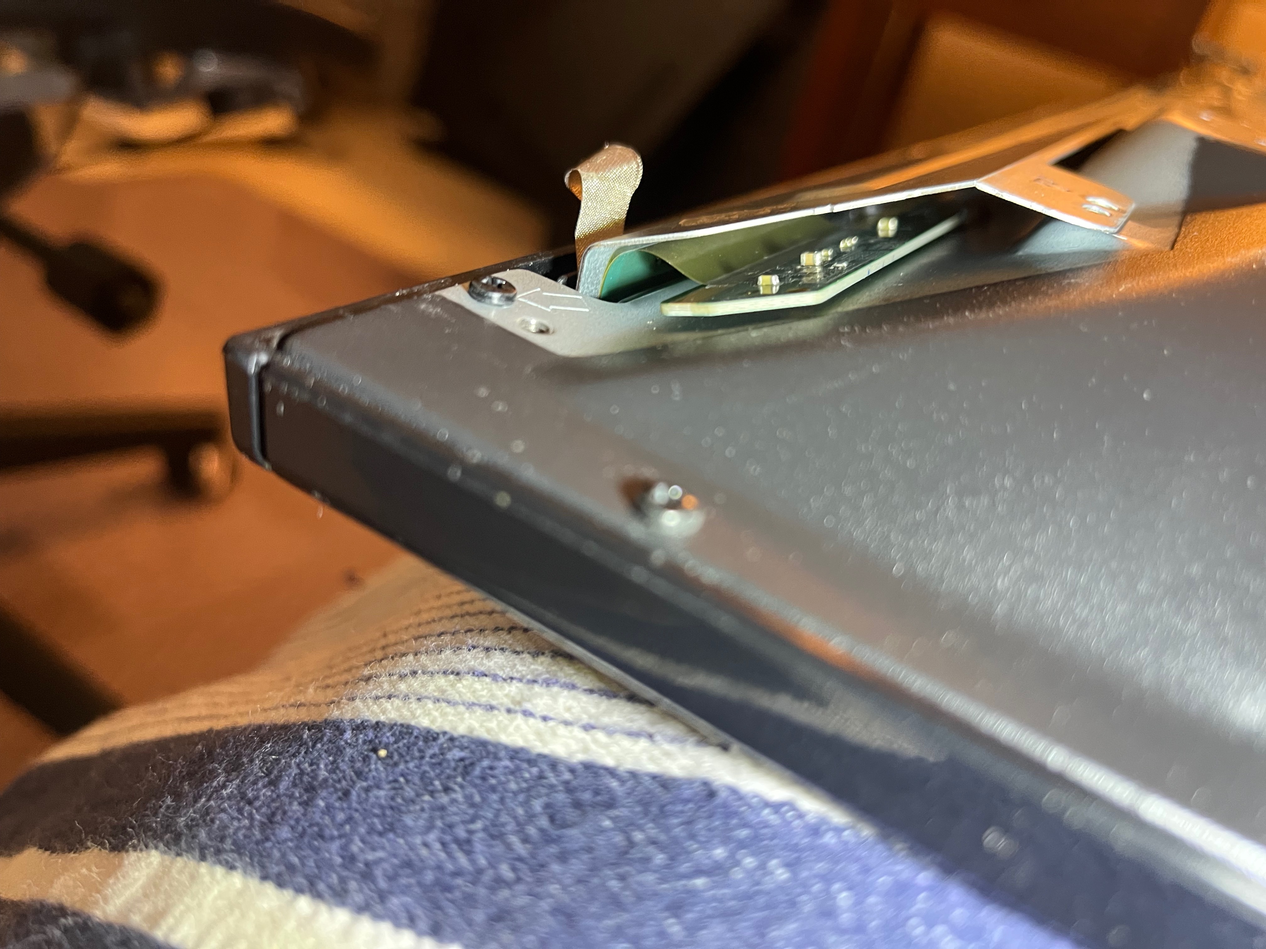

          As for why this failed, here is a possible theory. Maybe design weakpoint similar to an LG design failure I fixed (post #7)
          https://www.badcaps.net/forum/troubl...74#post1776374
          The metal guard for the buffer boards runs flush against the COF flex. COF will be just a tiny flex gap away from the metal guard which is a big ground rail. The outer most COF+flex carries the highest voltage for driving panel gates. On the LG, guard rail naturally scraps the flex during assembly.

          I wonder if thermal cycling over the years of use eventually cause weakpoints in the COF flex insulation?

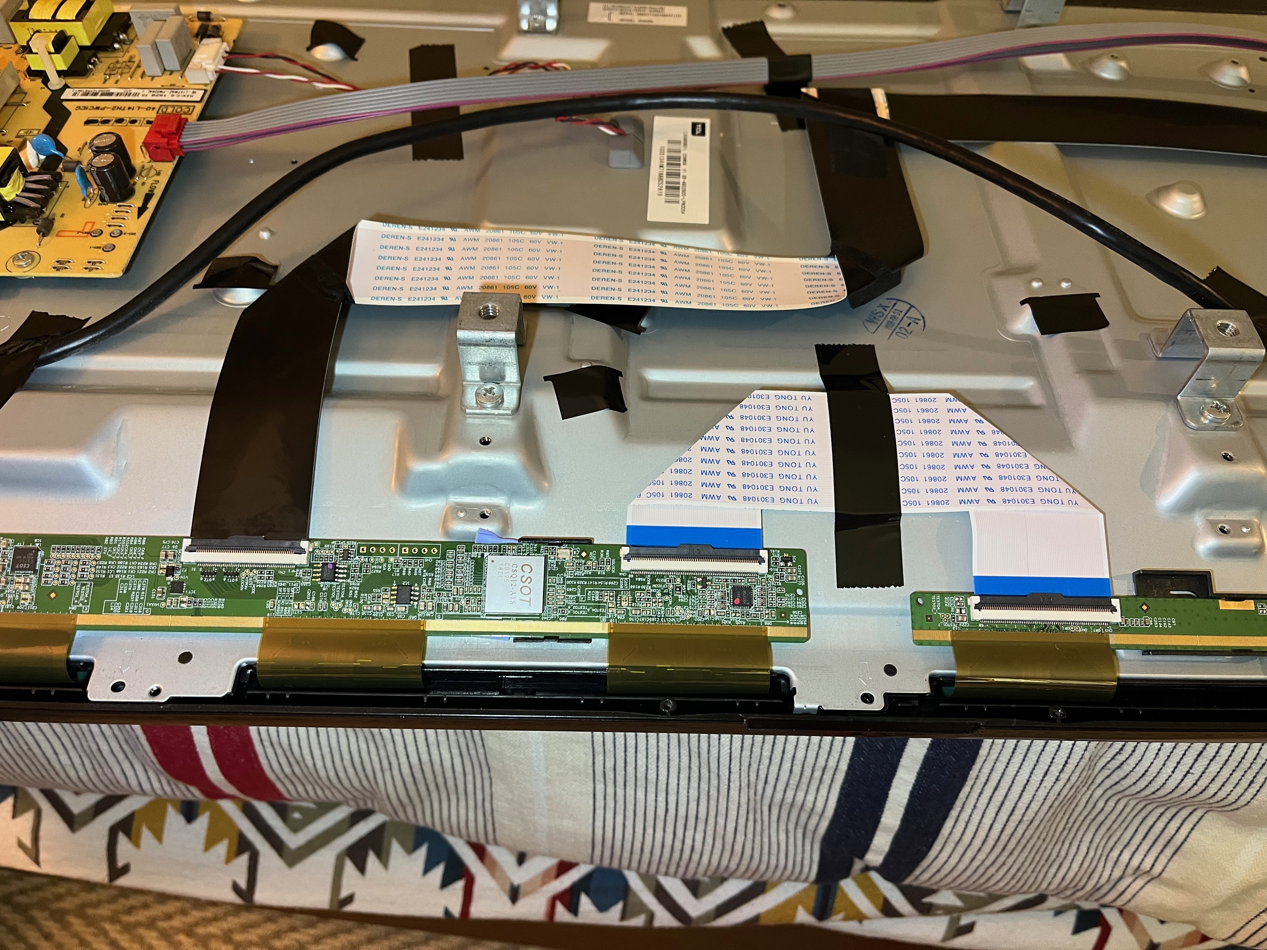

            Traditional T-Con to each buffer board disconnect test doesn't work

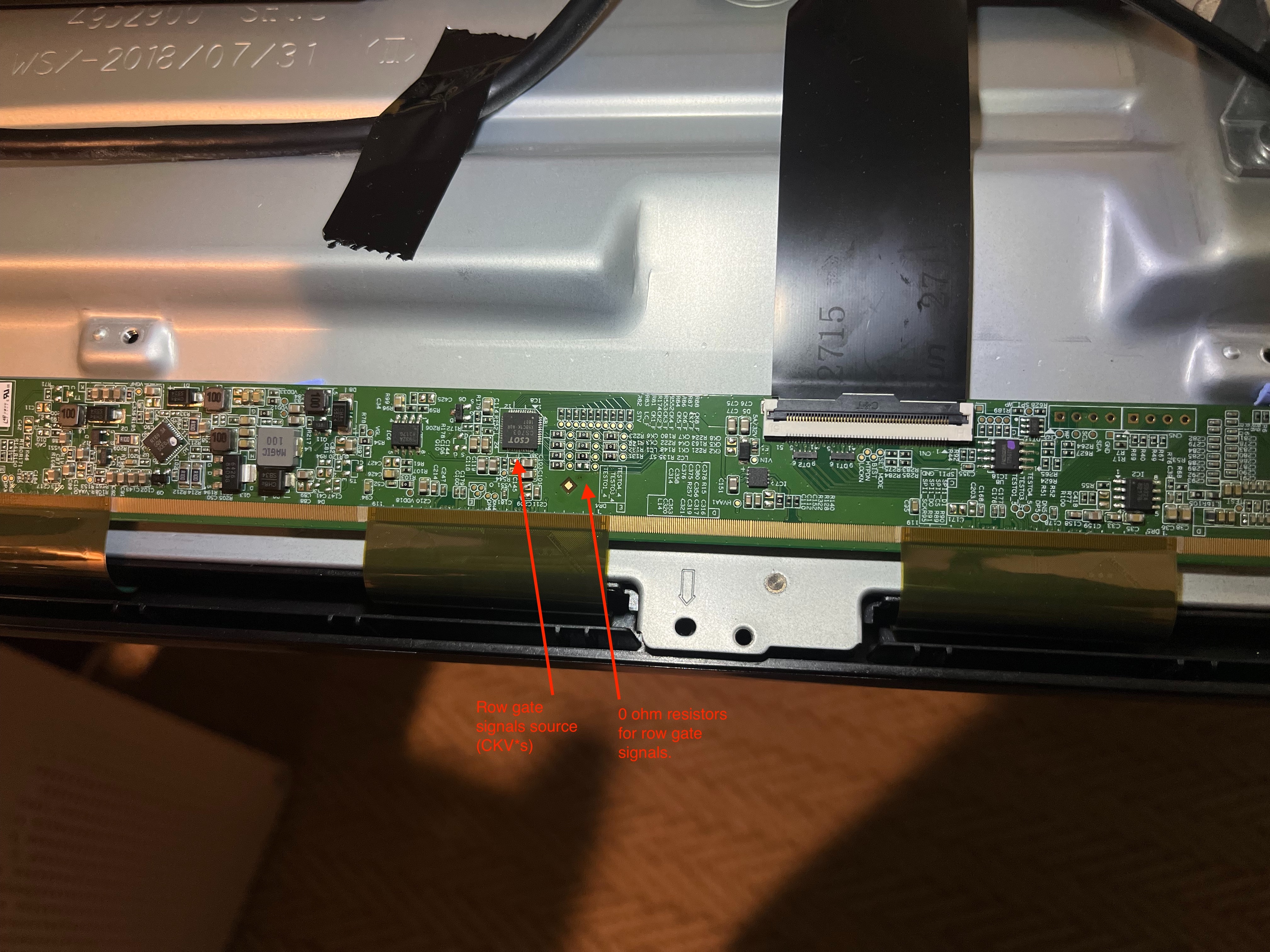

            The T-Con on this TV is actually on the left (looking from rear) buffer board. So the only hope to easily test which buffer board failed is if the right buffer board (without the T-Con) failed and find failed signal through masking the flex traces. Unfortunately likely not true in this case where the left buffer board containing T-Con failed.
            The row gate signals are generated by T-con on the left buffer board. Goes through a 0 ohm resistor then splits to
            • the left buffer board's edge most COF.
            • goes to flex to right buffer board to its edge most COF
            Click image for larger version  Name:	IMG_4983.jpg Views:	2 Size:	3.66 MB ID:	3714577
            Difficult cutting row gate signals on left buffer board
            No easy way. Have to cut the signal at the 0 ohm resistor and jump a long wire (> 1/2 meter) to right buffer board and mask the signal from routing back to the left buffer board.
            Or just cut the signals above the outer most flex but will be random (and may require repair) if don't know which set of signals are shorted.
            LC2 got hot
            Besides the edge most flex with COF showing heat marks on previous post. The flex connecting left and right buffer board also shows heat marks on the LC2 signal
            Click image for larger version  Name:	IMG_4982.jpg Views:	0 Size:	1,001.6 KB ID:	3714575

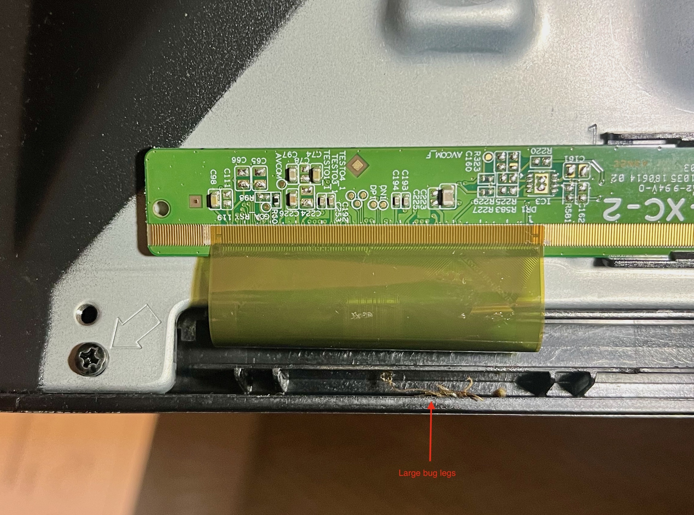

            And finally found a dead bug legs on the left buffer board's outside COF. Likely bug got zapped and created a short. TV came with remote that had food matter all under the buttons. Wasn't a clean household so likely lots of bugs and one got into the TV near the outside COF of left buffer board
            Click image for larger version  Name:	IMG_4981.jpg Views:	0 Size:	1.26 MB ID:	3714576
            Possible Repair Options
            Since LCD pictures from post #1 shows multiple rows of lines (row gate line driver short on left buffer panel COF), to cut all these requires removing all the necessary 0 ohm resistors from T-Con on left buffer board. Jumper a 2 feet wire to the right buffer board and mask the signals from coming back to the left buffer board.
            Alternatively can Xacto knife cut the failed traces on buffer board just above the flex. But have to run long jumpers just to confirm which lines traces are bad.
            Maybe just doing LC2 will fix it (don't know) Will report back after attempt.
