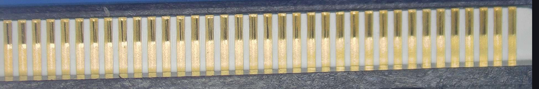

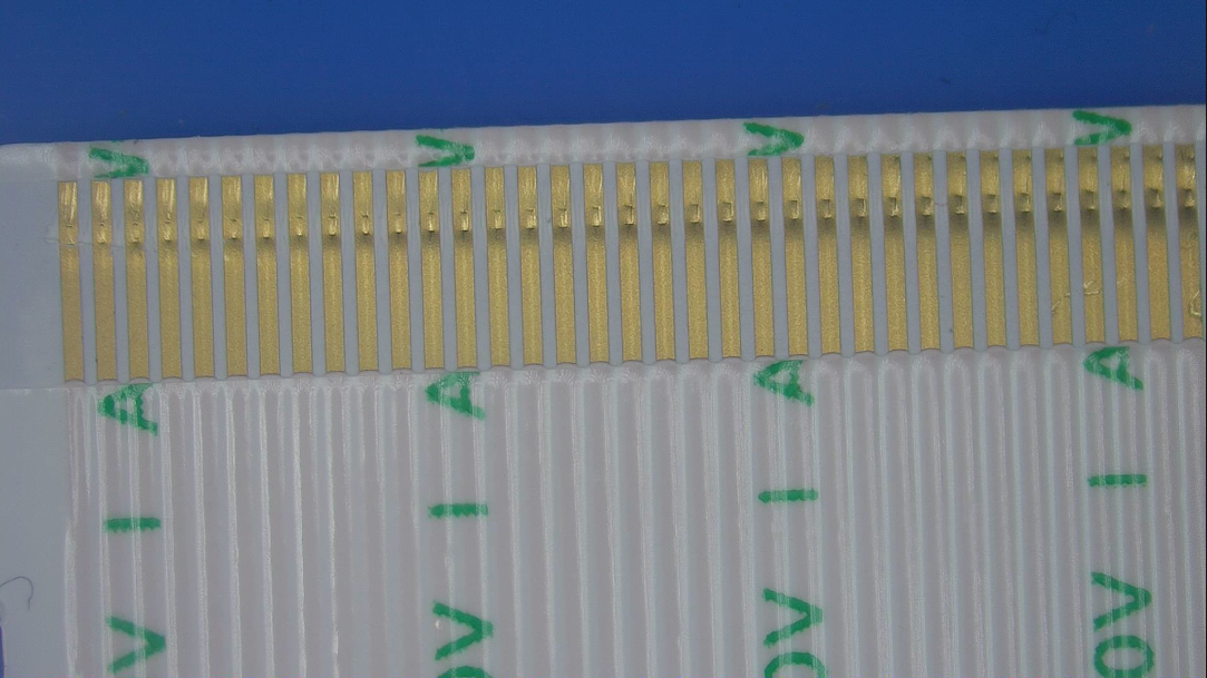

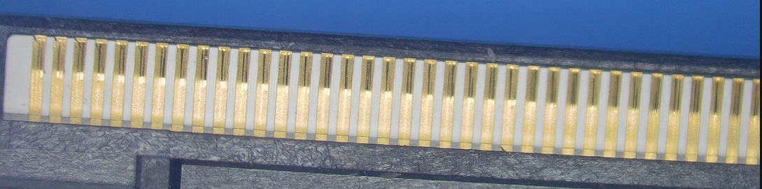

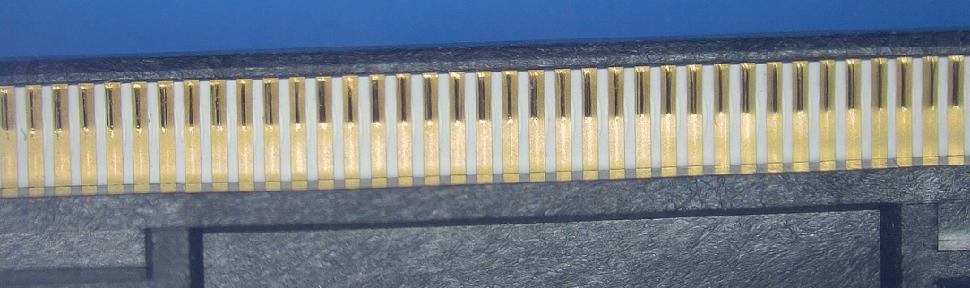

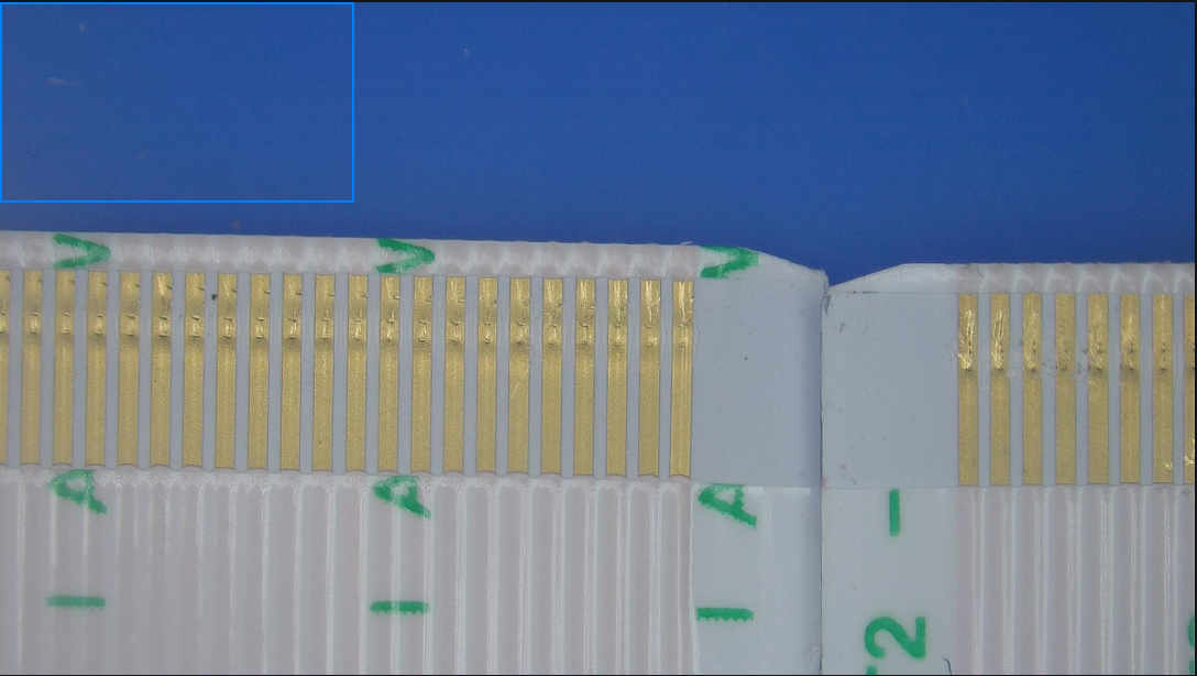

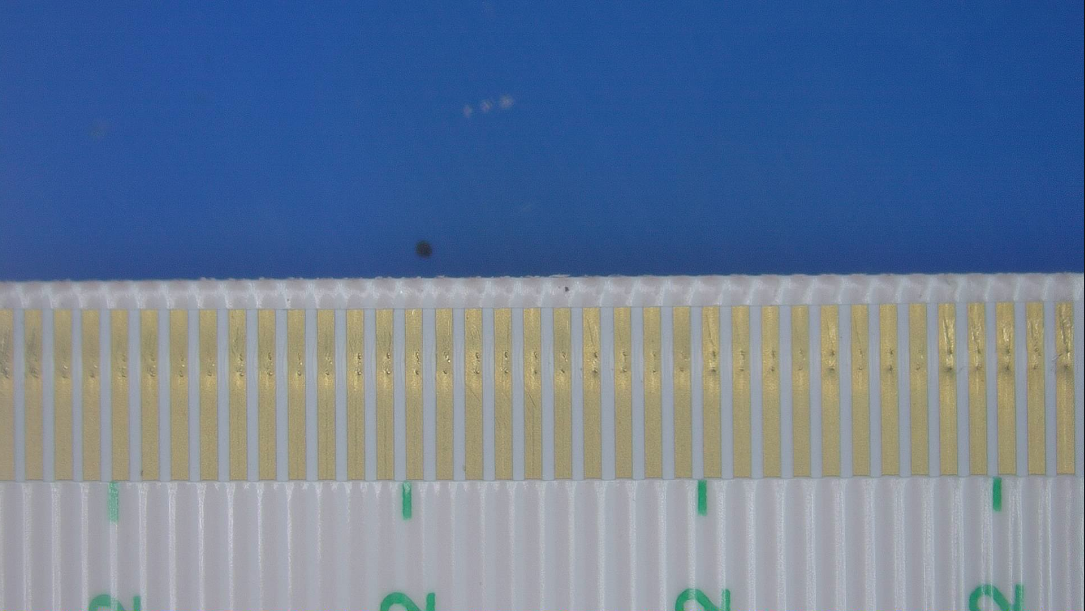

    Dont Touch the Mainboards... there are wrong info written from one user.. this set. are ONE SoC. there are no T-CON on MB... it had separted T-CON.. LVDS damage make the panel in test pattern.
    show me the 2 LVDS contact Pins from both side.. don't trust your glasses..
    if some one never had this set under his hand should keep silent
    Here are the cables under my scope.
    • Diah
      • Feb 2013
      • 6613
      clean them.. the black spots . but be careful as they are dry now... this set have many issue resulted with LVDS cable... but you need to repair the LED BL... and check the 4 ribbon cable too from both side to clean them..
      PFC from Main SoC stoped working because of error on LED BL.. so no signal go to T-CON. only VCC 12V will be on T-CON... this condition are the same when we testing the T-CON & Panel as standalone... EGB pattern will show.
      MB cant captured .. because this action only need JTK Module from LG.
      on MB you have eePROM and eMMC, the eePROM sending the start so you have Power ON ... and tthe rail of 13V will be provided to Panel T-CON via IC1100 ... so every things sound good..
      this why i wrote don't Touch the MB unless you repair the LED BL
        Okay so clean the copper pins, then replace the all of LED backlights correct?
        • Diah
          • Feb 2013
          • 6613
          YES
