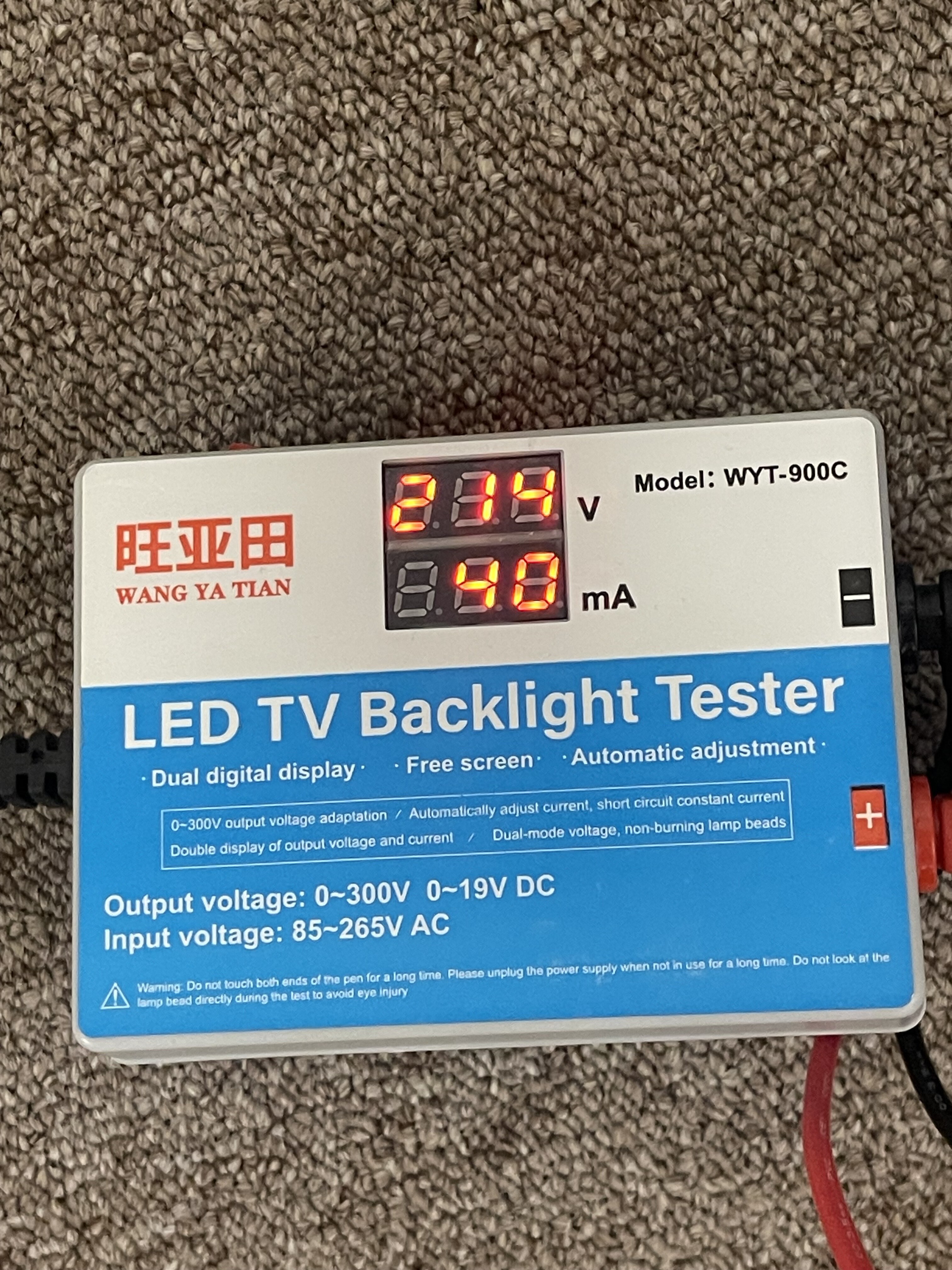

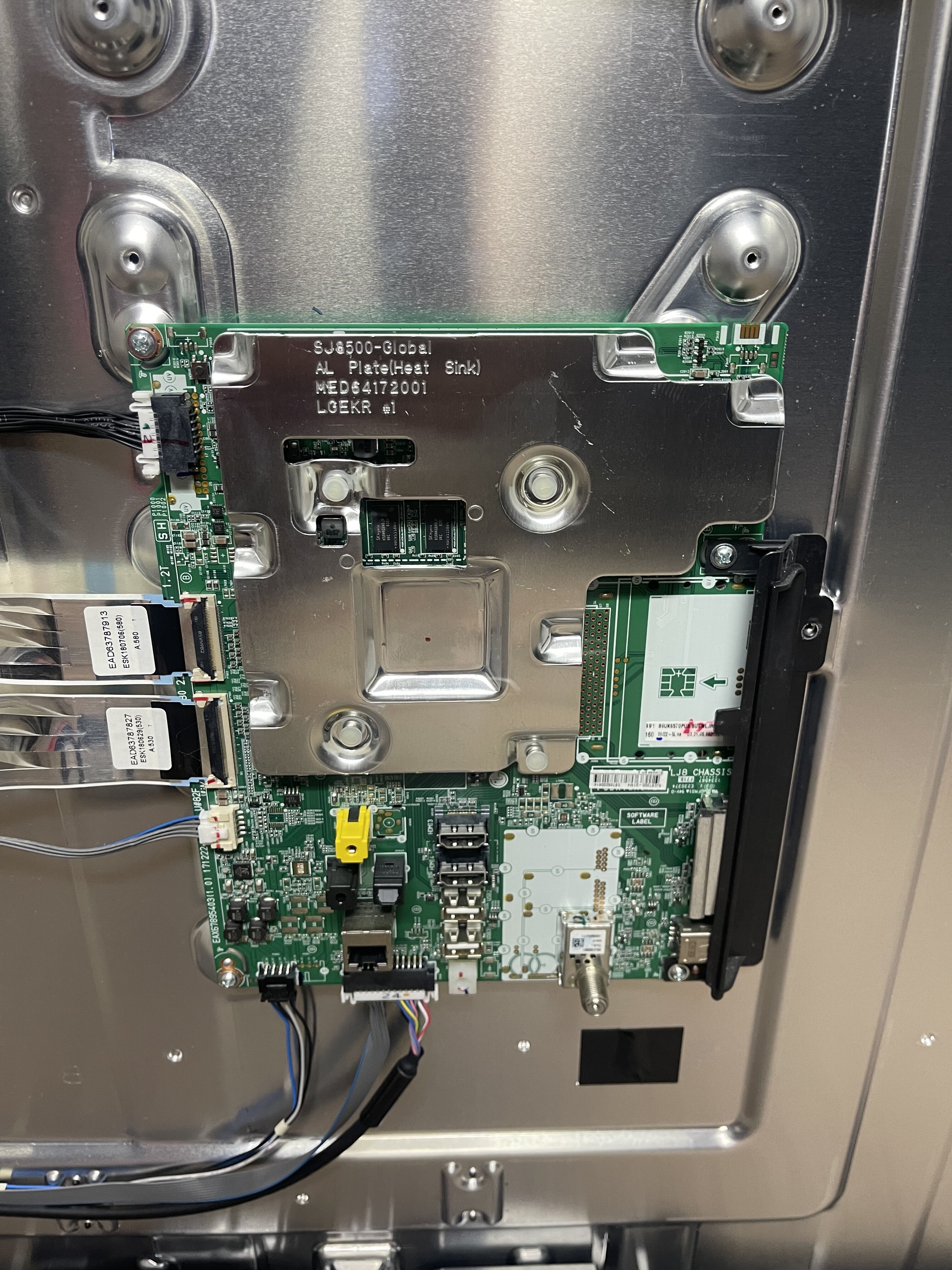

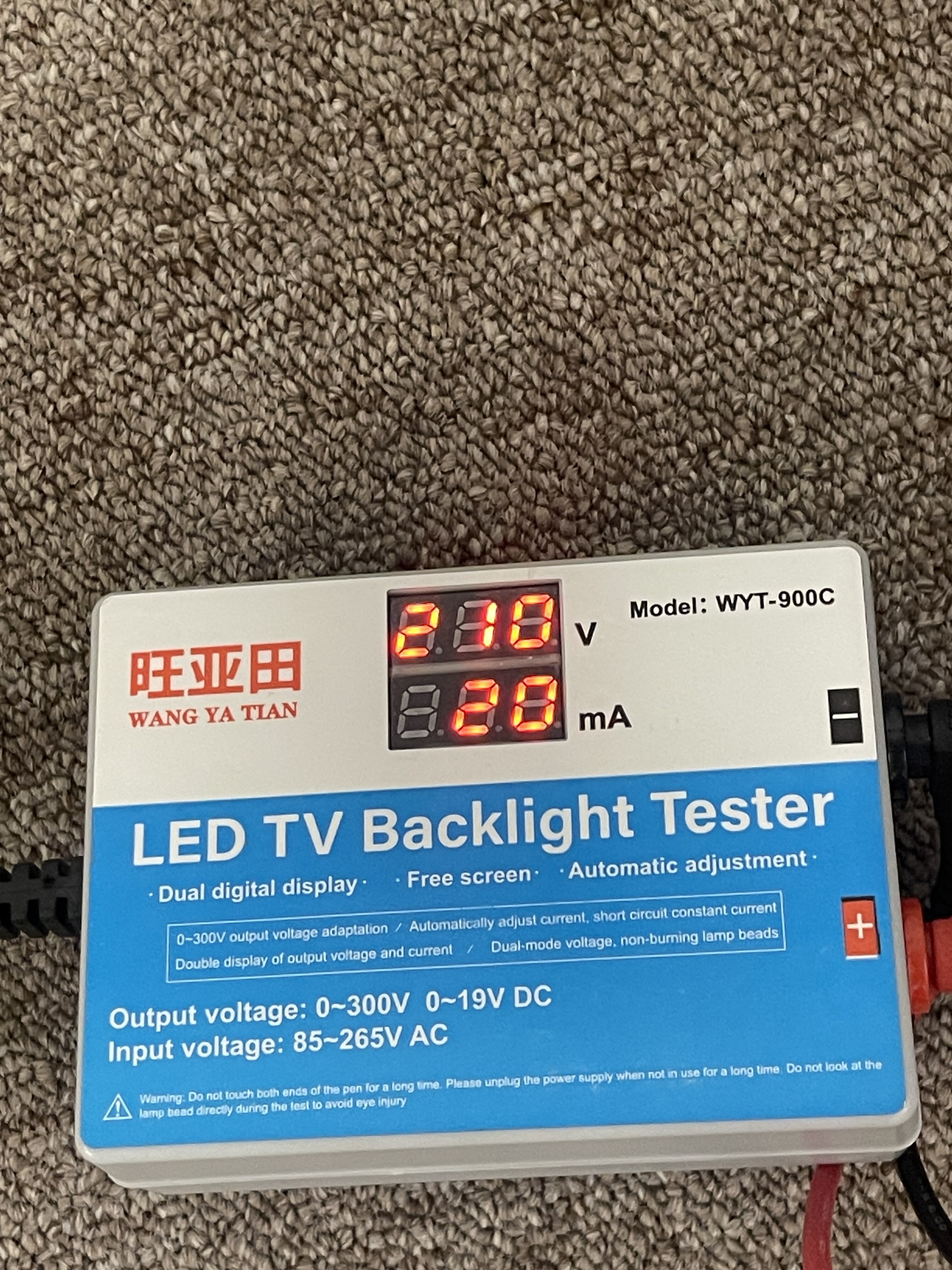

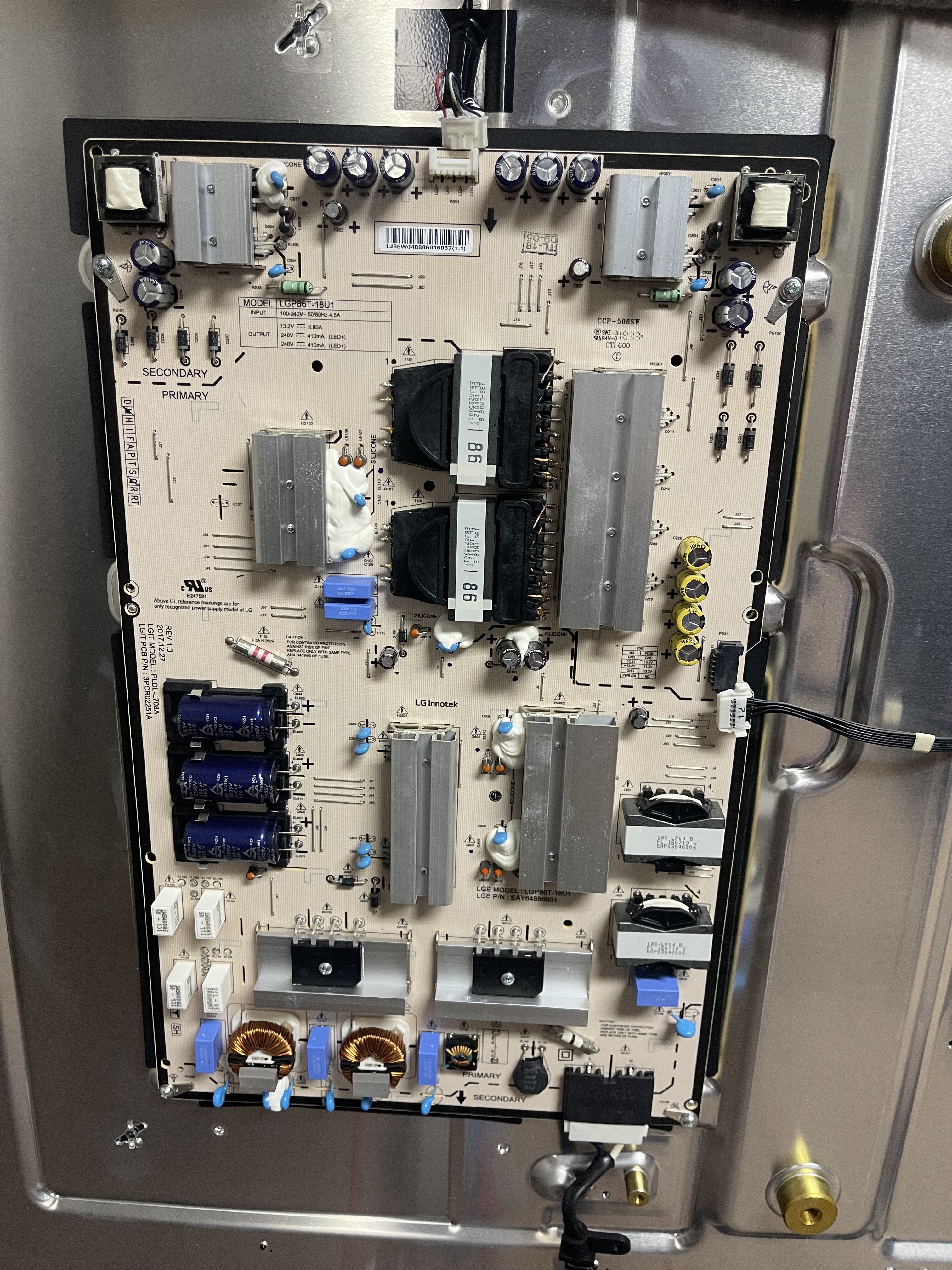

Hey Everyone, I have an LG 86UK6570PUB that wont turn on. Power light blinks 3 times. Tested voltage from power supply to main board and it is sending the correct voltage. When testing LEDs I have 1st strip at 210v 20mA, 2nd strip goes from 208v 20mA to 214 40mA. I'm assuming the LED strips is the issue. Anyone seen this before or can point me to something else to check?

Plug everything back up turn TV on and take a flashlight to the screen to see if there is picture. If yes then likely LEDs (where you are). Based on your test I would say yes the LEDs are bad. Led tester should bring it to a voltage and be steady around .4v on the tester. Since you are fluctuating on one, then likely yes that's the problem. I would change the LEDs. I test with the tester a few times since human error can occur and you may be messing it up when testing..
But make sure you try the flashlight test to make sure picture is totally fine just for assurance purposes.
Change the LEDs likely -

How can be the same symptom without the main board? How do you trick the PB? I think in this strange power connector MS is the new style of BL_ON, so you can take a zener diode around 3v and put it with cathode to MS and anode to gnd, then a 2k2 resistor from 13v to MS then a wire from MS to PWR-ON, check if the lights comes on.. ensure the zener almost and well solderedComment

No the main ic is a microprocessor, the main software is contained usually in an emmc, but good if you make the backlight trick before, even if i haven't ever read about LG with protection mode for faulty backlight.. bad software issue can easily be mismatched with bga issues, and LG is the king of bga issues, serial port debug can reveal some more..Comment
usually is very easy to locate serial port on a main board, 4 pin connector, usually not populated, one pin clearly on gnd plane, a side 5v output (not used if not needed), central TX,RX, use a random serial terminal sw, hyperteminal, etc..Comment
Dont Touch the Mainboards... there are wrong info written from one user.. this set. are ONE SoC. there are no T-CON on MB... it had separted T-CON.. LVDS damage make the panel in test pattern.
