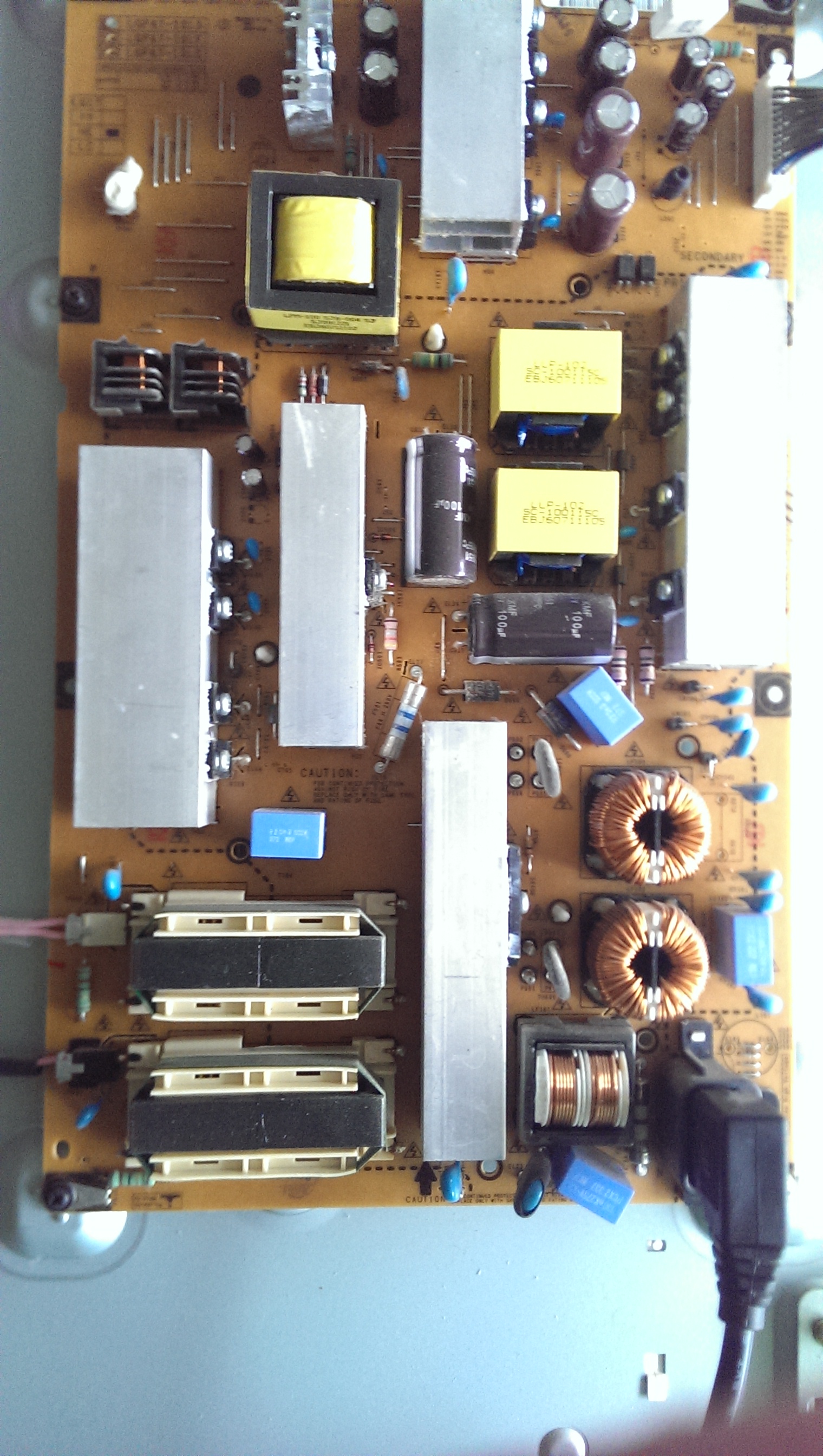

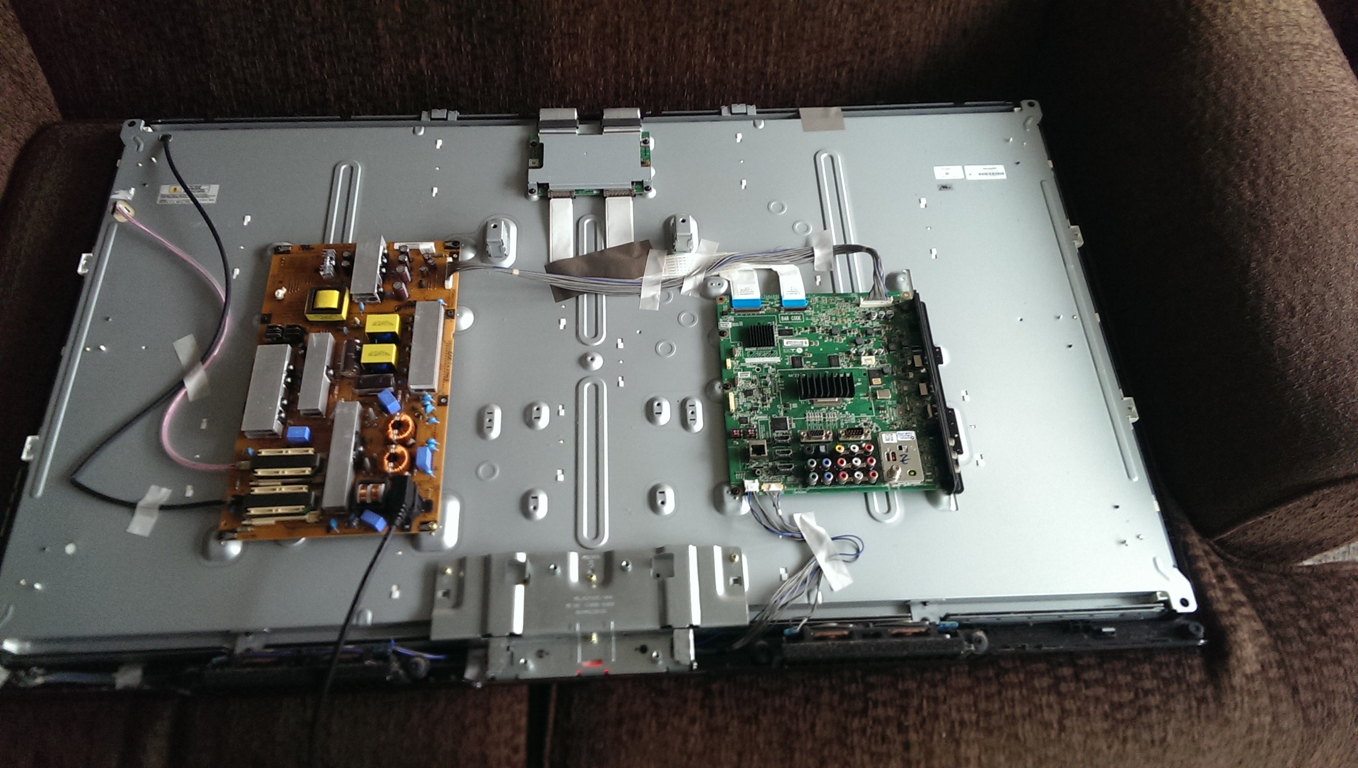

    so i have this TV and it turns on but all that happens is the LED turns on but not picture on the screen and i have no idea why this is happening, i have attached some pics if that will help anyone.

    i've done a bit of research but all i can find is check the caps, all the caps seem to be fine to me. is there anything else i should try to do? what would cause the led light to be on but not the picture or sound to come on

      I am not sure if this power supply inverter board combo has built-in pull up resistors on the PS_ON and bl_on PIN or not, so for quick test, unplug the TV from the outlet and then disconnect the cable between the power supply board and the main board, then plug the TV into the outlet to see if the backlights will come on.

          "i disconnnected the cable from the two boards and the red LED light would not come on after i plugged it in to the wall again." that is normal because we remove the power feeding the main board you removed the cable. So the backlights did not come on then?
          Next we will need to test the voltages.

            no backlights have come on at all that i can tell even with the two boards connected.

              yeah the only thing that has come on at all either way is the red LED light nothing else. no sound or picture or anything. and all the caps are fine

                http://www.shopjimmy.com/media/catal...9506-top_2.jpg
                On that white connector p201, you need to check the DC Voltage on the 'POWER' pin, use the metal chassis as the ground ref point for the meter, you should see the voltage on the 'POWER' pin toggle betweedn < 1V and > 2VDC when the power switch is toggle on and off.
