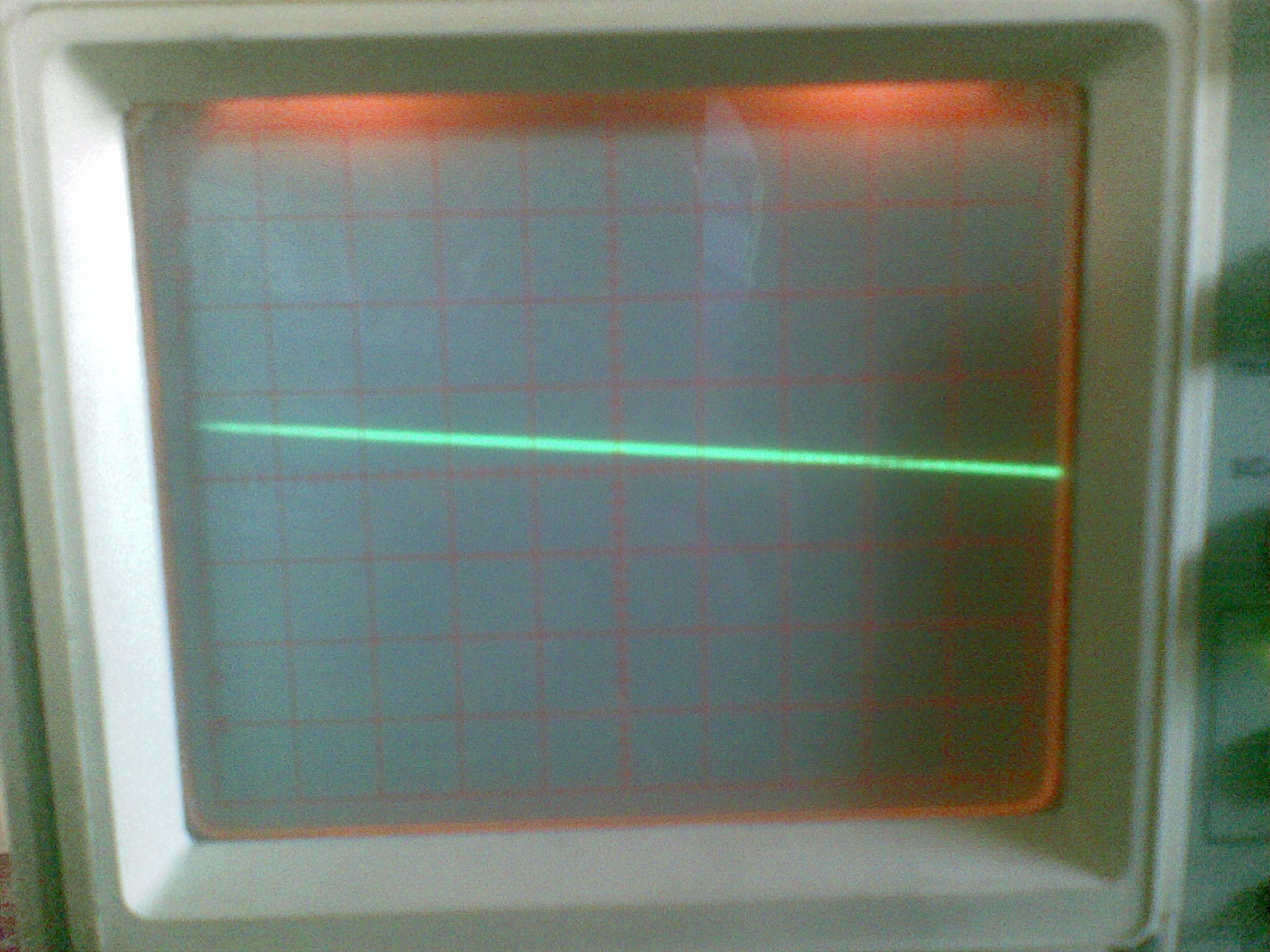

    Today , as usual i was planning to use my scope to check the output signal of a PWM ic ( ka7550 ) , so i turned the scope on , connected the ground clip to cold ground , and tried to measure the output with the probe , and by mistake i shorted some pins of the IC .
    Now i get a constant trace leaning downward ( see picture bellow ), and i cant show any measured signals on the screen .

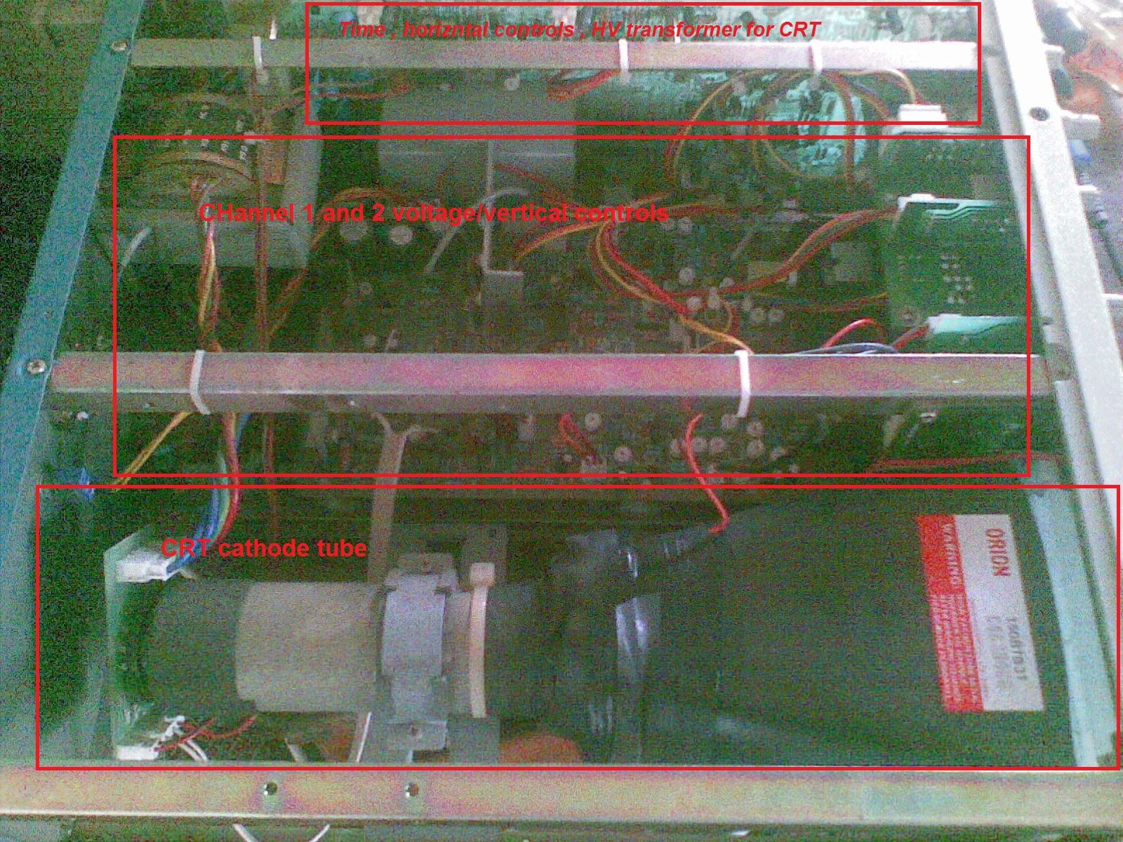

    Here is a list of the inside of the scope content :
    - CRT screen tube
    - Main card containing power supply and channel 1 and 2 voltage/ vertical position controls circuitry .
    - Side card containing HV CRT power transformer + time , sweep mode , horizontal position controls circuitry .

      Yes , i get the same display on both channels , but the short was caused by probe on channel 1 .

              I can rotate the trace , but i can't get any signal to show up on the screen unfortunately ,

                                      So right now after having disassembled the scope a part , i see two main cards :
                                      -one is related to the time control , horizontal control and contains a high voltage section, witch i guess is supposed to power the cathode ray tube .
                                      - the other one is certainly the vertical and voltage controls , also contains a power supply section coming straight from 220 V transformer's secondary .
