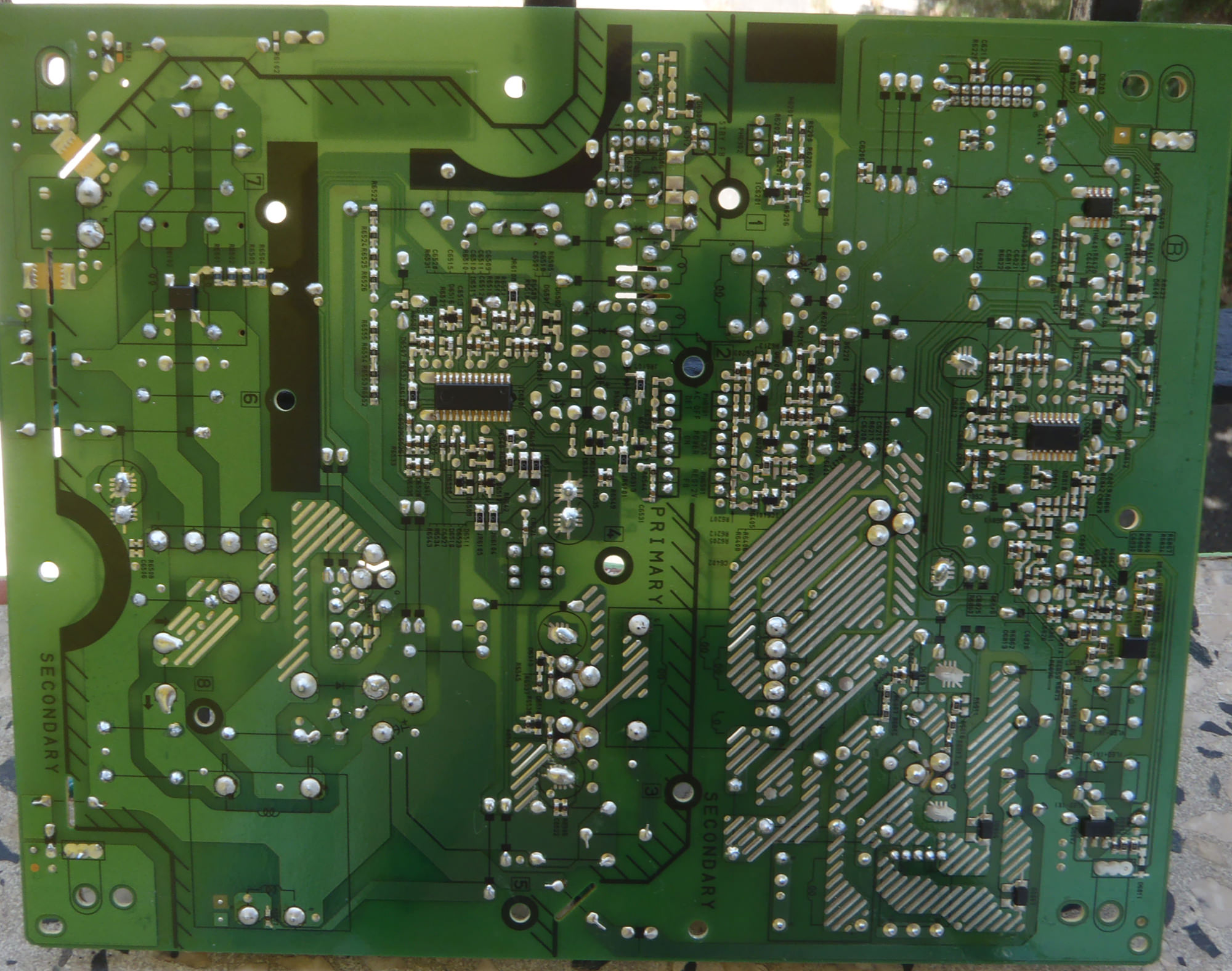

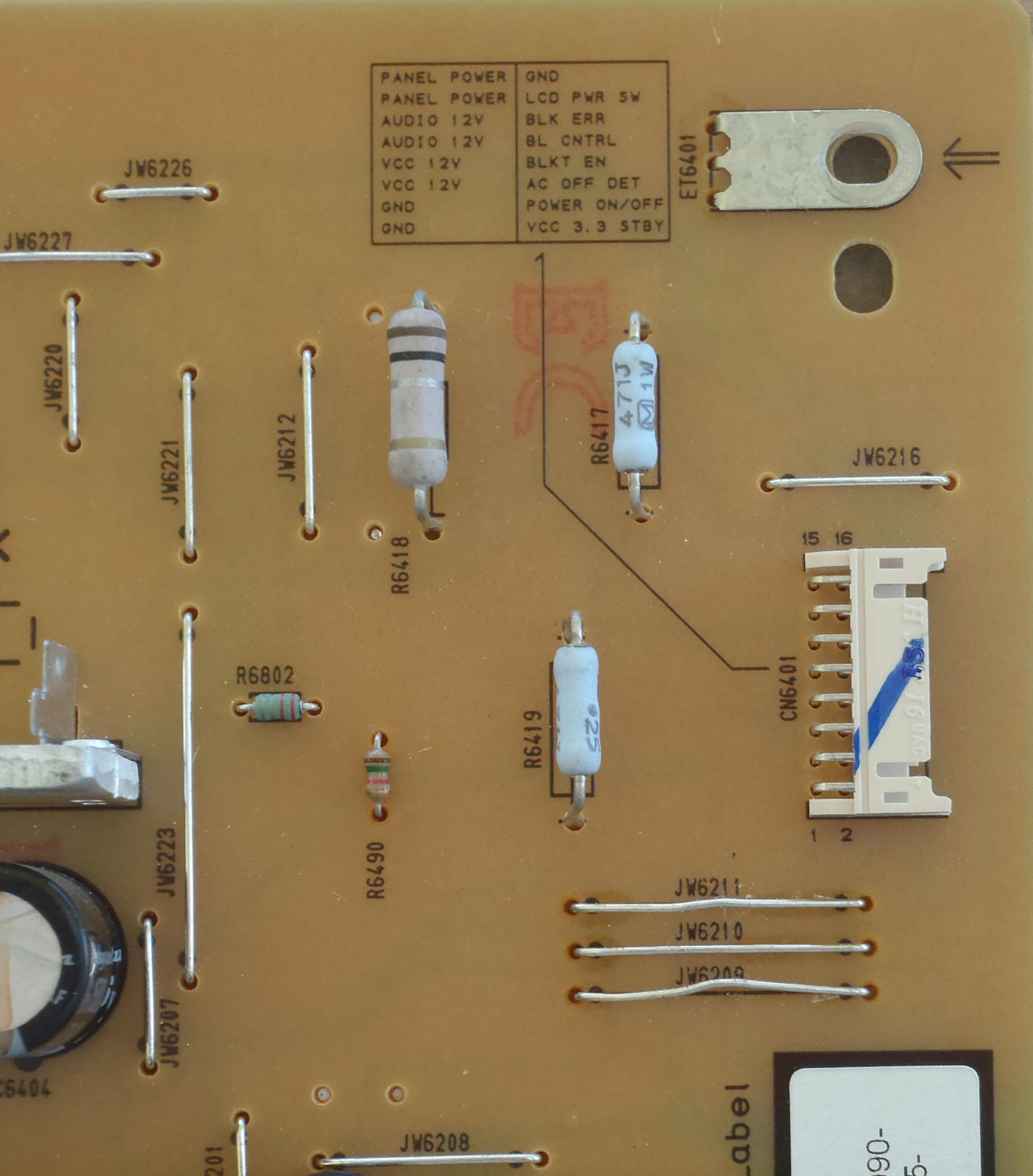

        Can we see the pictures of the boards and also the labels on the connectors to verify some voltages.

          Re: Sony KDL42EX440 no red light
          This is the best I can do right now. The panel voltage isn't indicated but the audio voltage should be 12 Volts and the VCC is also 12 volts and they all read 0 volts so I guess the power on/off voltage of 3.3 volts isn't firing those circuits.
          I will try to take some better photos tomorrow. Thanx budm.
            If there is a specific area u need a close-up of, just let me know.

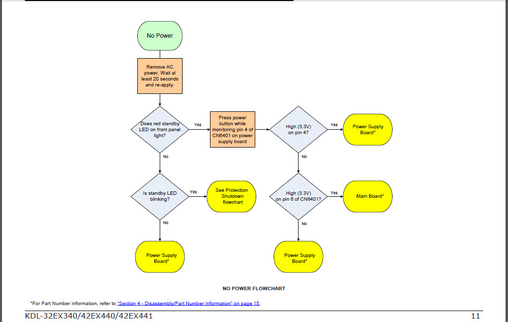

                According to this flo-chart the problem is in the power supply but the service manual does not give you the schematic so I guess I'll have to order a new power supply. Thanx for your help.
