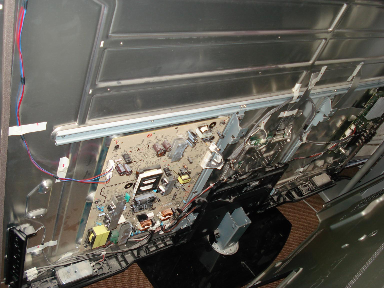

    KDL-52EX703 6 blinks
    I get 6 blinks / flashes on this tv. have managed to switch it on but the backlight is dim when BL_ERR is put on a resistor to ground. Any Ideas please?

    Re: KDL-52EX703 6 blinks
    only has 3 boards in view psu, av main and t-con

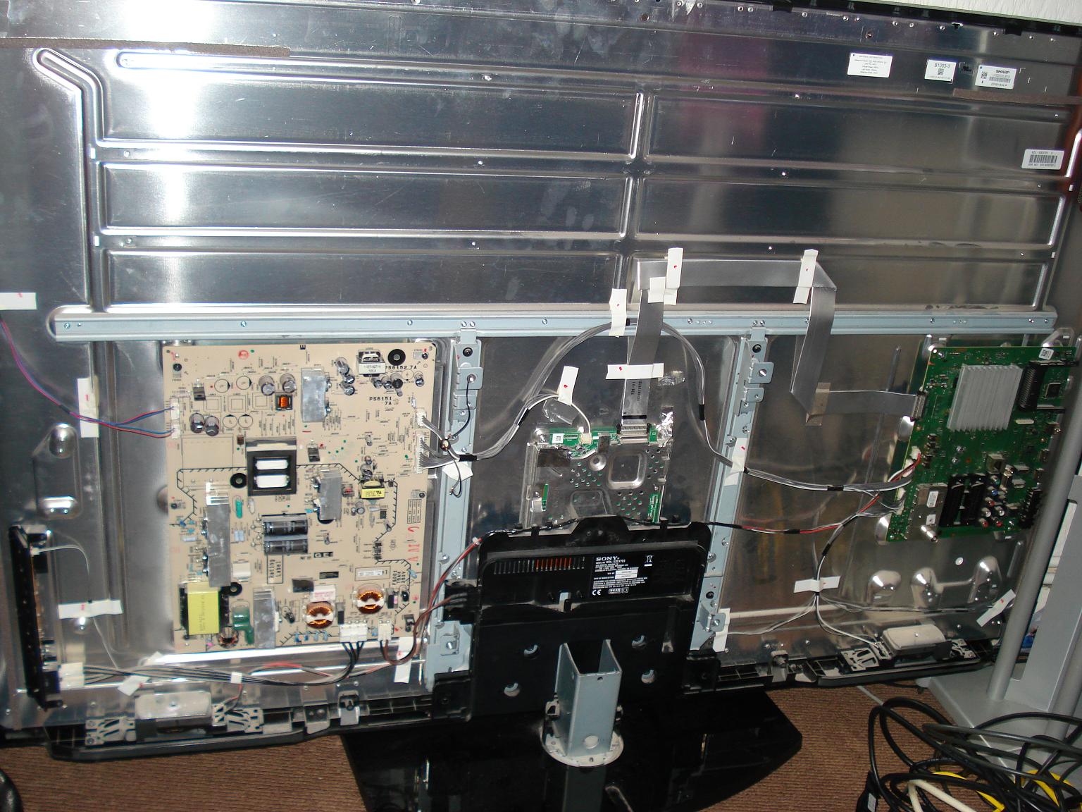

        This is LED backlights do it does not use balancer or high voltage inverter circuits.
        Can we see straight shot pictures of the backside of the TV?
          thats it it only has 3 boards! the psu measure 316v dc going into the backlight via thin red and blue wires

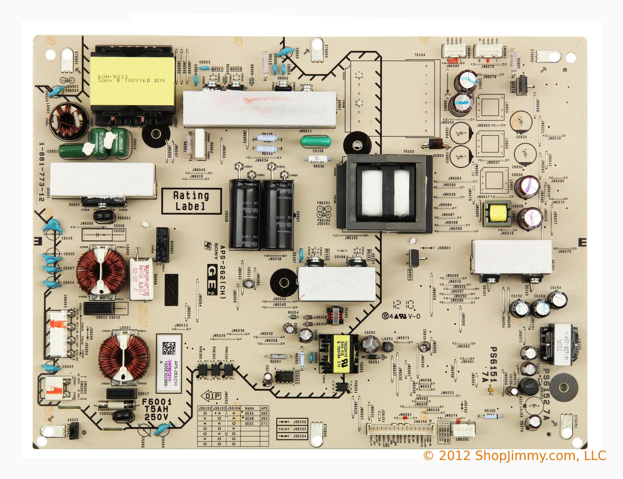

                              I found dimm and dimm dc on the power board going into av main. can this be bypassed?
                                        Hi just did some experiments and found:
                                        v on dc = 327v
                                        caps = 350v
                                        when ambient sensor is off and I increase backlight and everything to max the backlight fails to light up and voltage drops to 250/150 range. decrease backlight and it come back and voltage rises again.
