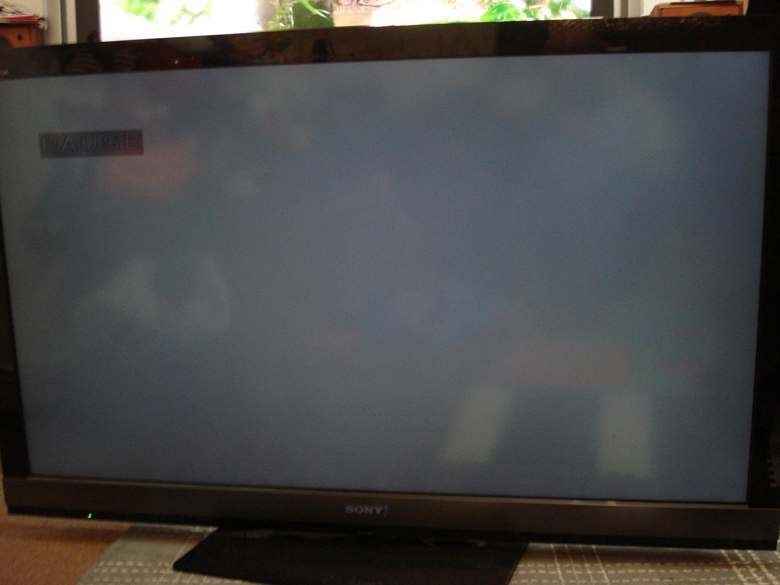

    the backlight is on 7. Im running test pattern dvd and the screen and backlight seems fine (I mean I do not spot any issues with the LEDs)

      ok i just disconnected the backlights and the voltage was around 340-350v.
      I disconnect the backlight cables and still I get 6 blinks and volatge rises to 340's then drops very quickly.
        Re: KDL-52EX703 6 blinks
        should explain I can only get it to boot via BL_ERR to ground otherwise 6 blinks
