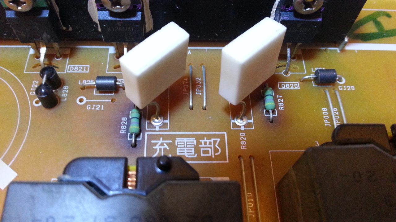

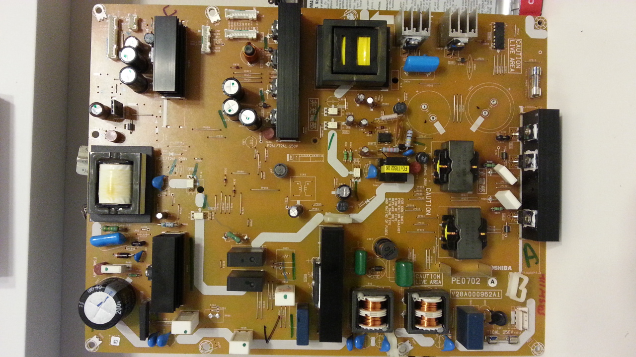

    I have a Toshiba REGZA 52XV645U LCD TV with a dead power supply
    (V28A000962A1) With the help of a link on this website I found the culprit. https://www.badcaps.net/forum/showthread.php?t=15787 The fusible resistor R850 is open. My question is I found 2 resistors R827 and R828 showing thermal heat damage. What can cause these resistors to get so hot?
    I'm replacing two 150uf 450v capacitors that looked a little rounded but measured ok.

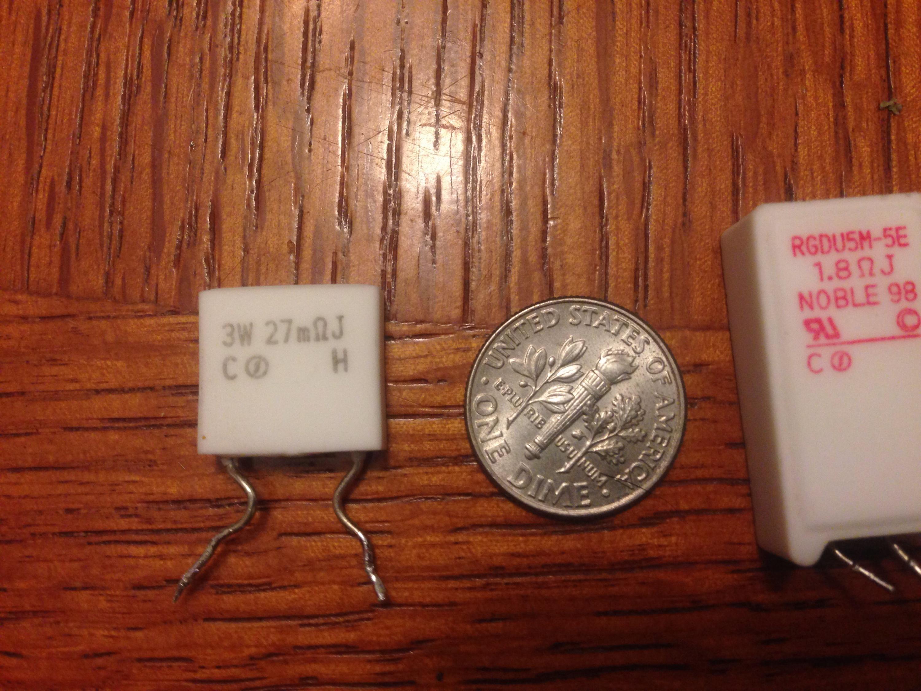

    I have a similar problem. A resistor reading open. I have yet to check those two. I just started "tv repairs" so I don't know very much however iv been reading a book on power supplies. But aside from the resistor I "found" (I was looking for a schematic and found a "repair kit" on eBay that pointed me in the right direction my meter reads 30vac from the chassis ground to neutral. Is this normal? Also I get ac readings past the bridge rectifier 50vac or so. Is that because of the way the meter works? I'm sorry please bare with my ignorance. And sorry for posting on your thread but I had to make my first post somewhere. Any help is appreciated.
    • Namenotfound
      • Jul 2014
      • 14
      • USA!
      Re: Toshiba 52XV645U LCD Dead Power Supply
      Rcflyer what should those read. I'm getting .2oms. is that correct?
      Sorry I found it. First time Iv seen milli ohms.
      Last edited by Namenotfound; 07-18-2014, 09:10 PM. Reason: Just started with component repairs
        27m Ohms = 0.027 ohms, it is OK you are basically reading your probes resistance. The one on the right is 1.8 Ohms. The section of your pictures with heated reistors are in the PFC Voltage booster section.
        BTW, those AC voltage reading are due to there is no safety Ground wire connected to the chassis, as long as you are getting 120VAC at the AC input connector, it is OK. You use chassis as the ground ref point when you measure the voltage in the secondary side, the primary side circuit ground ref point is the negative leg of the main filter caps (those 450VDC cap).
        The fusible resistor that blown open probably due to shorted out MOSFETs for the PFC circuit.
