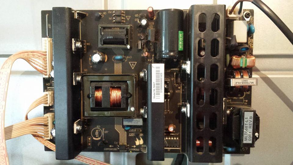

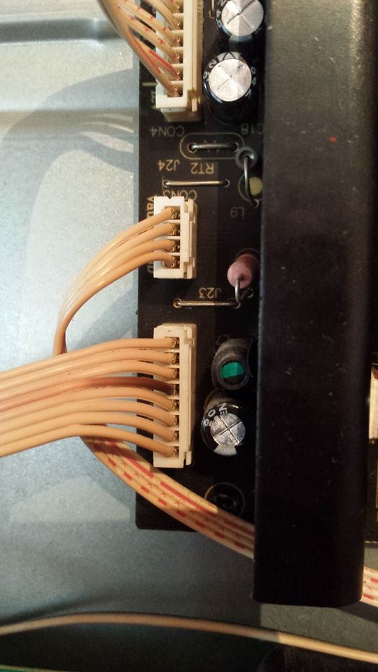

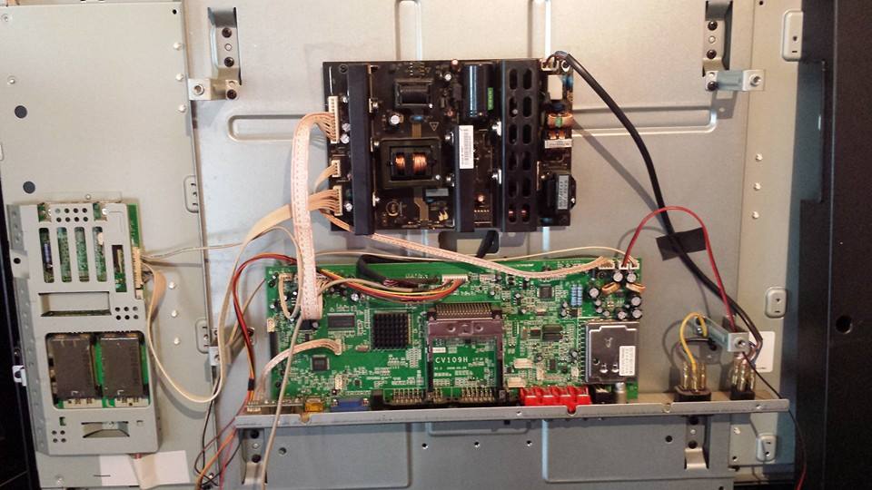

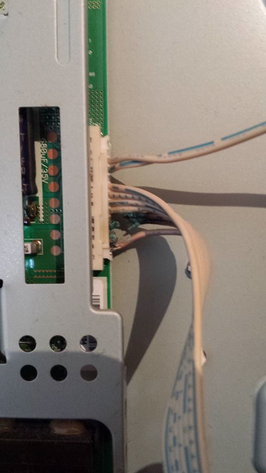

ok guys got this TV from a friend and when i plugged it in i got no backlight whatsoever, decided to pop back off tv and quick check of bulging caps etc however i noticed that the cable leading from PSU to Inverter was severely damaged, what could be causing this issue ?
Burinng out cables on Baird PR32BAIRD

This is a case of bad connectors overheating. If the traces are ok on the board then just pull the connectors and use wires with no connectors. Replace the caps when you are at it because replacing them after is a real bugger.Things I've fixed: anything from semis to crappy Chinese $2 radios, and now an IoT Dildo....

thanks for reply goontroon. will the caps need replaced though as there is none bulging etc ?Comment
Re: Burinng out cables on Baird PR32BAIRD
ahh ok thanks. i actually pulled the same cable from another TV, plugged it in and it works fine now. but is that is all that was wrong just a cheap shoddy cable and connector ?Comment
echoing what stj says, the new cable will burn in the year that it takes the caps to fail, but that time it might take the traces with it.....
it will be a lot simpler to change the caps now than in a year when you can't separate the boards, yes.Things I've fixed: anything from semis to crappy Chinese $2 radios, and now an IoT Dildo....
Follow the white rabbit.Comment
