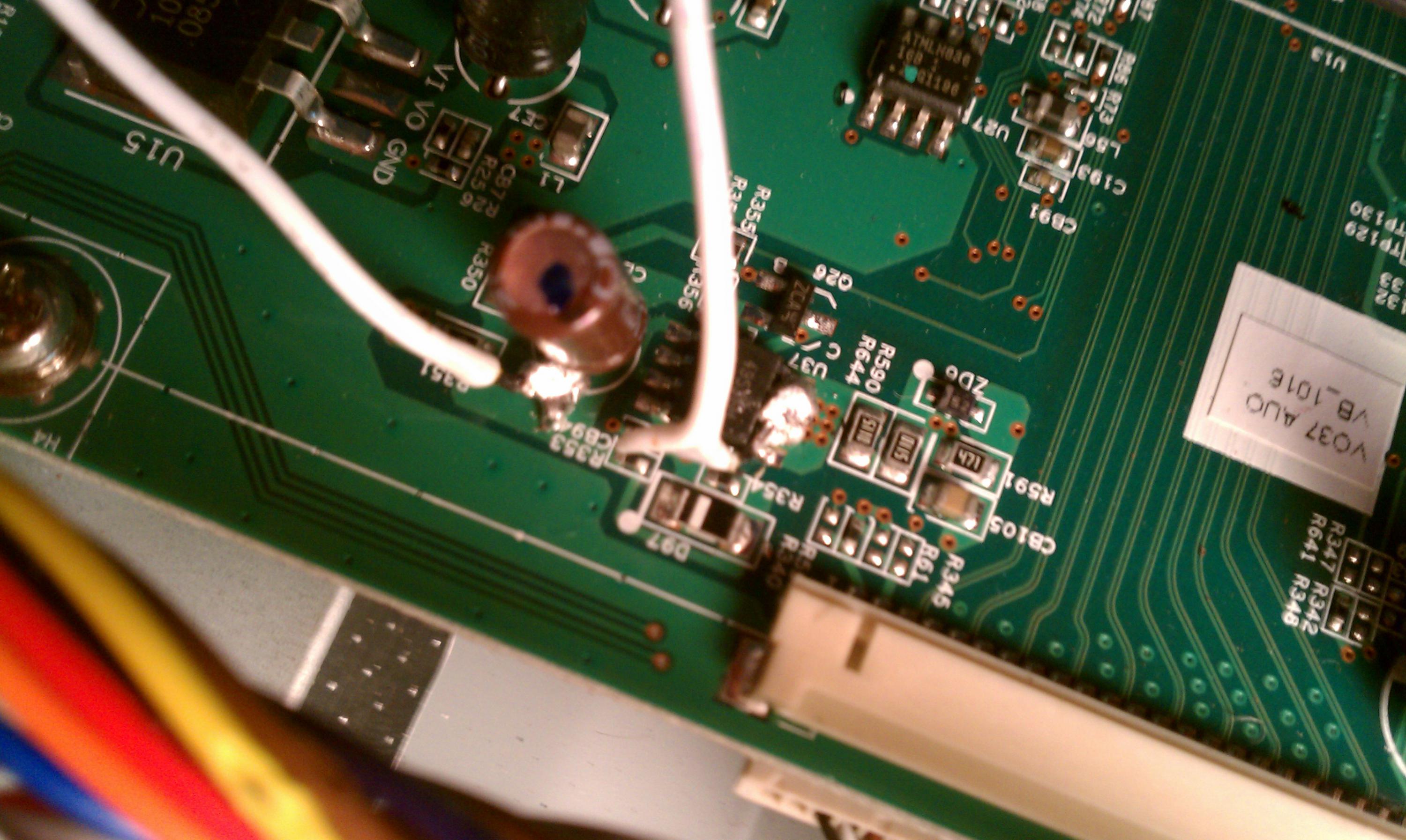

        Re: VIZIO V037L FHDTV20A powers up, backlight on, sound works, buttons work, no pict
        OK the MOSFET is not being turned on, the control pin 2 and pin 4 should have close to 0Vdc when TV is turned on, pin 1 and 3 are getting the 12V feeding them OK.
        What you can do to test is to put jumper wire between the 4 pins on the left and the positive leg of that cap CE64 to see if you will get the picture.
        Show me the picture of the jumper wire in place before you plug the TV in, I want to make sure you do it correctly.

          #124
          Ok wait...do I solder this in place? And to all 4 pins?
          Don't fear the repair...
            #125
            Those 4 left pins (pin 5~8) are connecting together to one large copper pad, so just solder 1 wire to that pad, then the other end of the wire will be connected to the positive leg of the cap CE64 which is next to that MOSFET.

                  #128
                  Will do. Thanks!

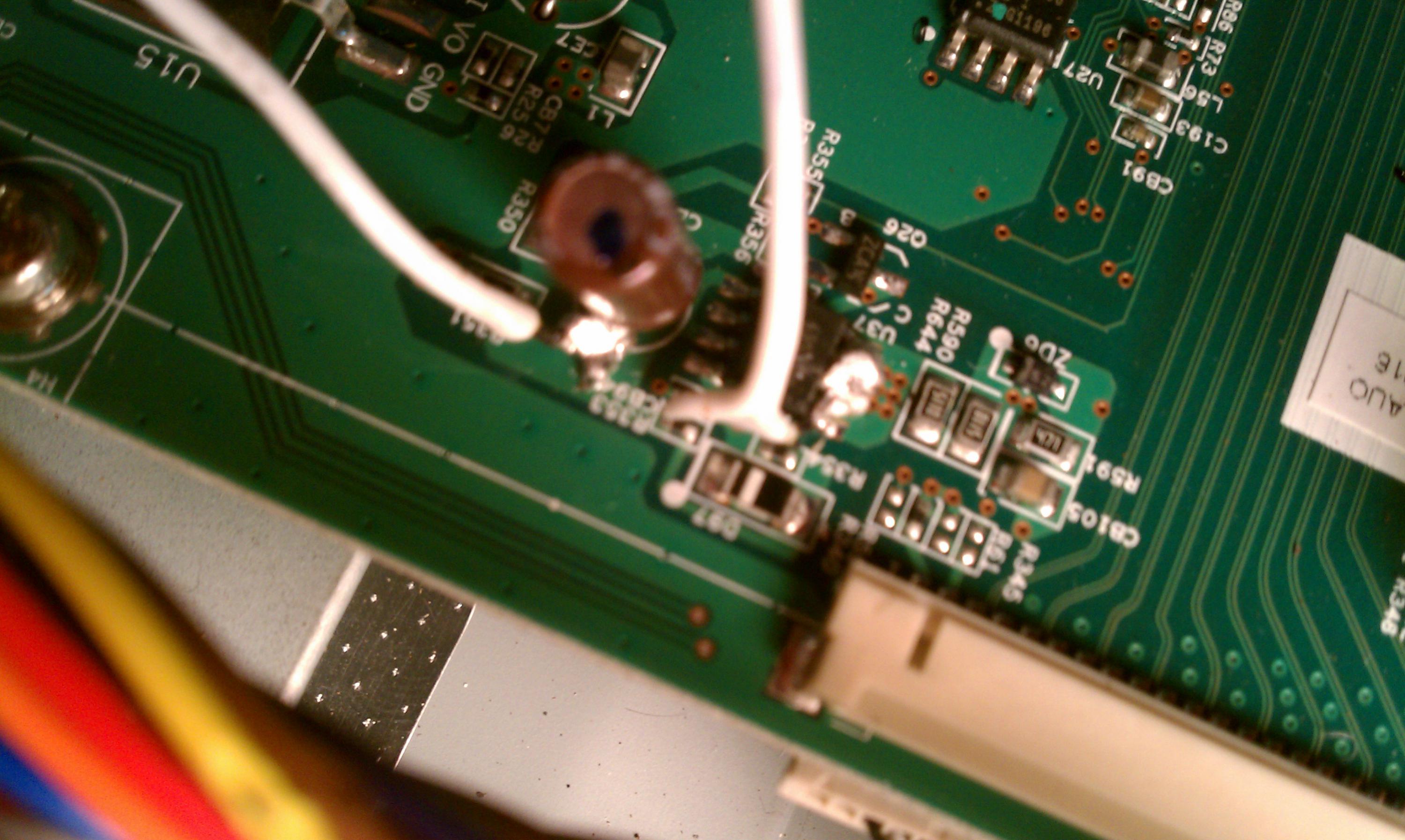

                    #129
                    ok soldering is done. i didnt see a single pad that all 4 of those pins went to like u said...but i guess i made my own with solder
                    u might not be able to see it so good in the pictures but i made sure no solder is touching anything but those 4 pins, and for the capacitor too just on that one positive pin

                      #130
                      hmm..when u said pad did u mean the lighter colored green pcb ?

                        #131
                        oh i see now and those 6 holes.. so those 4 pins might as well just be one pin then?

                            #133
                            OK! not great clean job, but that will do for now.

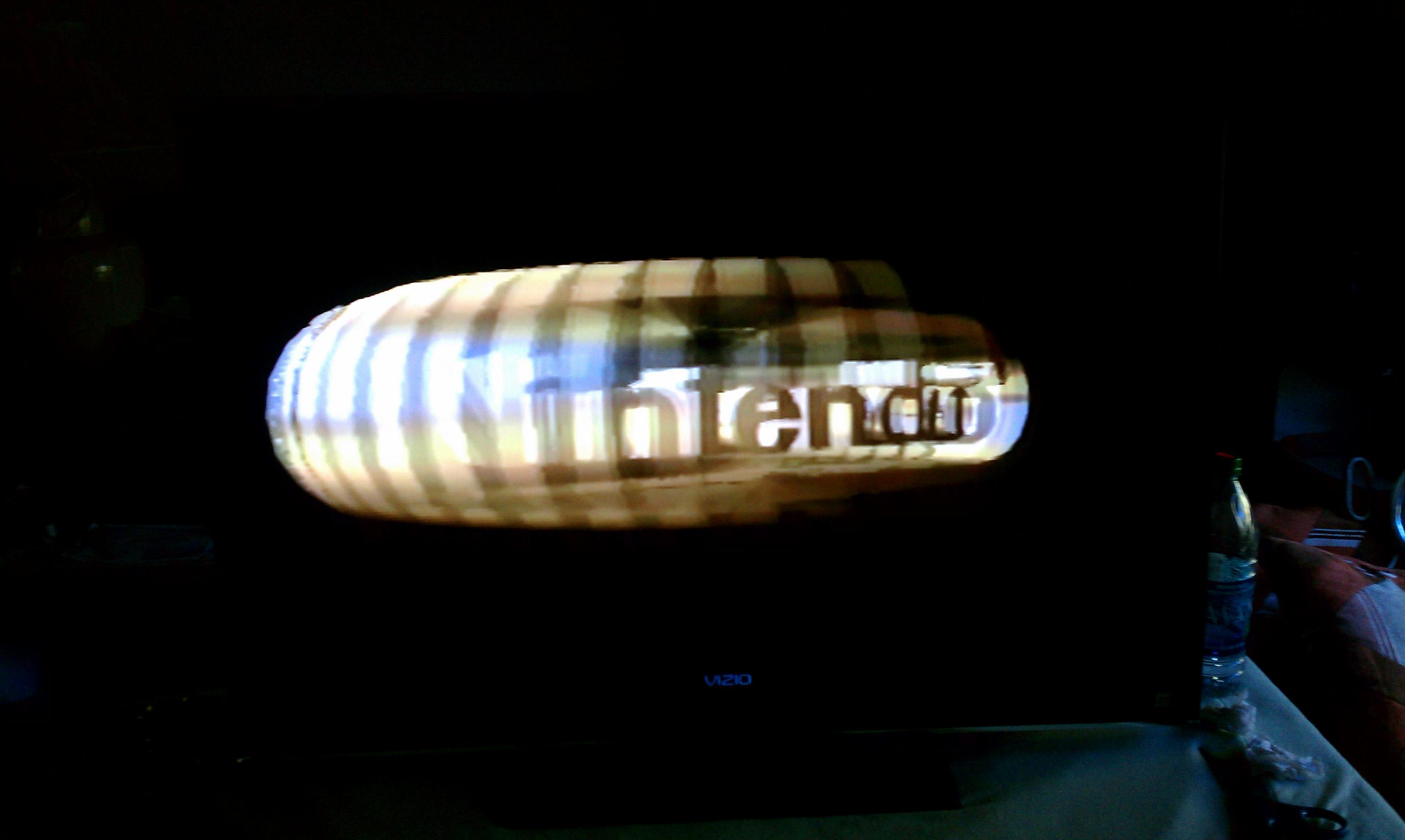

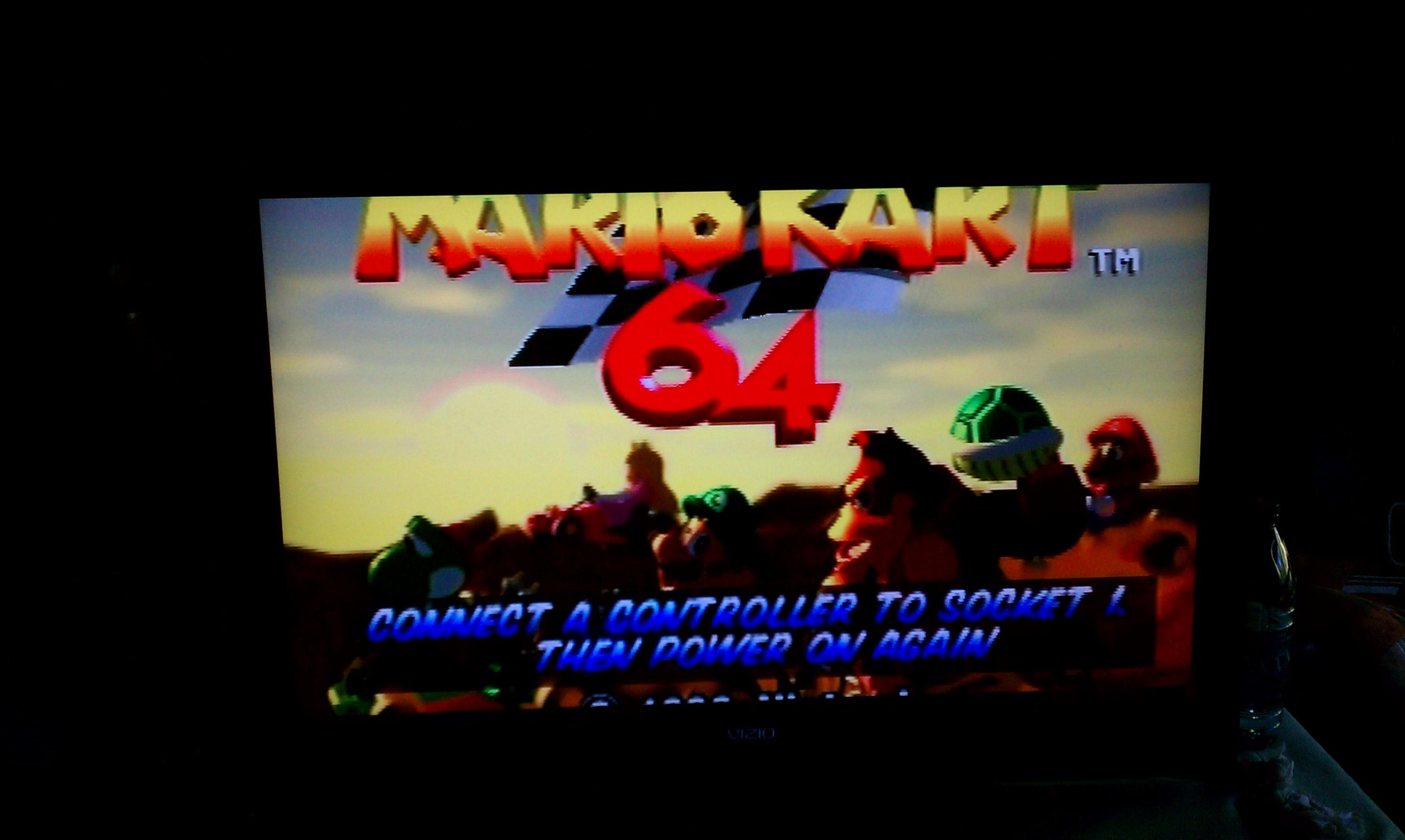

                              success!!! you are the man!
                              that totally was the problem!
                              i still would like to understand completely though... what exactly that chip does, and why it was not doing it, and how jumping this connection affects the operation of the tv?
                              is this a permanent fix or do i have to replace that chip for any reason? and if this works then why did i need that chip there in the first place??
                              so awesome to have fixed my first big tv with your help. without your help i would never have figured all this out, and now i know a lot more about electronics in general. i have some other TV's that im going to get right to work on as well and i hope you and the others here would like to help me with them as well!

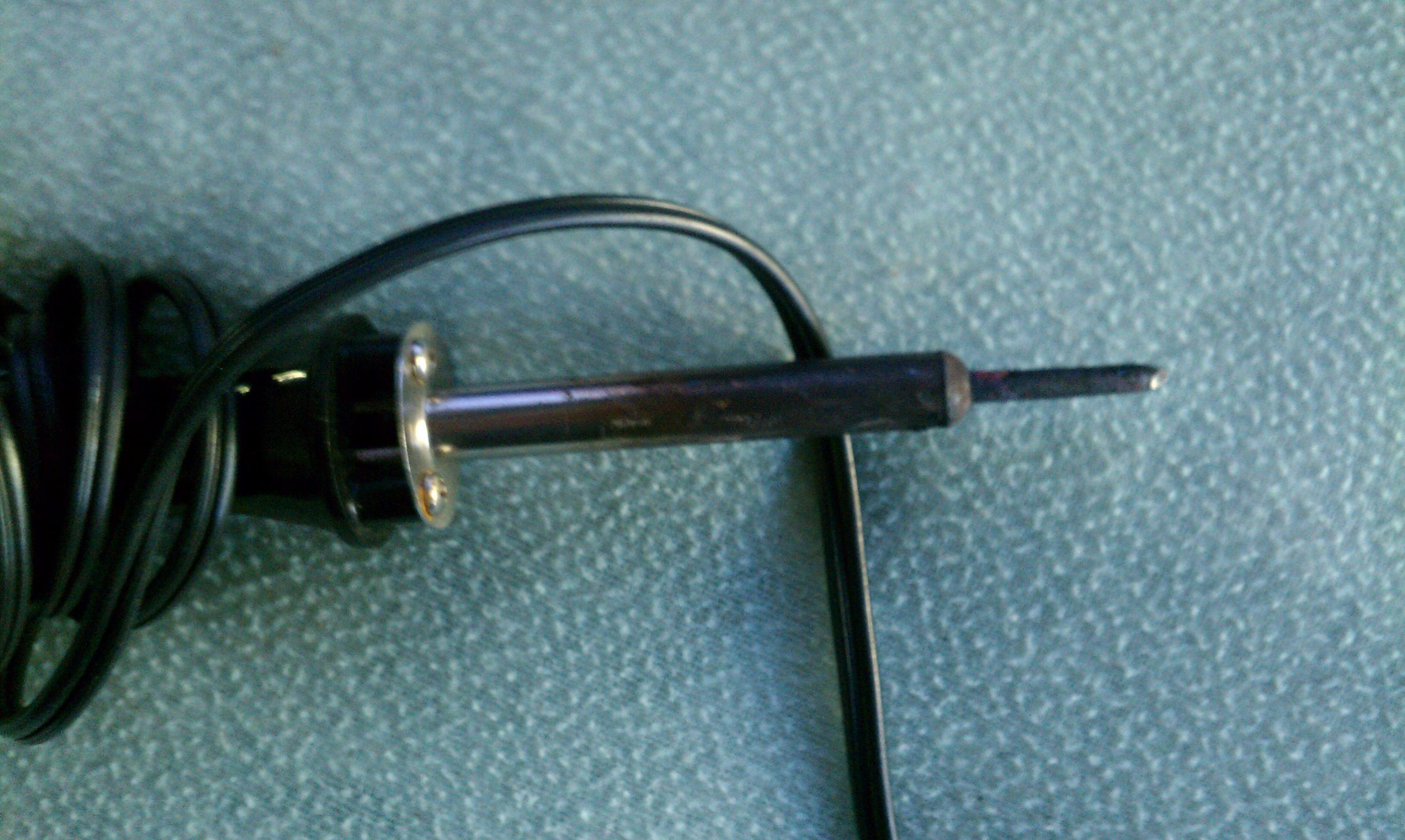

                                i included the pic of my soldering iron to let u all know why my solder joints were messy. this is a really cheap and abused soldering iron.

                                  #136
                                  "is this a permanent fix " No, this is to verify that the T-CON and other video processing functions are OK. The MOSFET is OK, but the Gate is not getting the turn on signal.
                                  What we did is bypassing the switch, the MOSFET is being used as a switch by the control signal feeding into pin 2 and 4, that signal is stuck high as we had measure the voltage around 12V on pin 2 & 4.
                                  You can use it as is but when TV is in standby, the 12V will still be applied to the T-CON all the time instead of being off, the only time 12V will not be present is when TV is switched off.
                                  The GATE pin 2 and 4 look like it is being drive by transistor Q26, there should be about 0.6V between B and E as you can see the label next to it, see if it does have 0.6V
