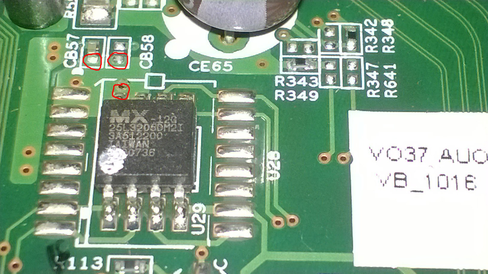

    hmm so a resistance tells us there is another component between that pin and the capacitor? and you are assuming it would be a MOSFET?

          so im going to keep one probe on the top left pin of the mx-12G MOSFET
          and touch any other mosfet's around that area? and look for one that has less than 1ohm resistance?

            You will keep one probe on pin 30 of J8 or the positive leg of the cap CE65, then use the probe on other semiconductor devices that may have 3 pins or 8 pins, one of device will show <1 Ohm. Using pin 30 will be the easiest.

              ok i tested the resistance between the points circled in the picture and i got .03 or .04 so the top left pin of the mosfet is going directly to those 2 points?

                Is it .03 Ohms, or .03K Ohms on the meter? it should show the same resistance when you touch the two probes of the meter together.

                  i have my meter on the lowest setting "200ohms" so when it says .03 i beleive it to be .03 ohms

                    when i touch the 2 probes together i get 0.02 resistance

                      If that is the case, then that pin should show the same voltage reading as shown on pin 30 of J8 then, please verify.
                      If is does show the same reading, then next thing we need to find out which one of the pin of that IC has 12Vdc on it.
                        #91
                        Re: VIZIO V037L FHDTV20A powers up, backlight on, sound works, buttons work, no pict
                        I am still not believe that is MX-12 because there is white pad the right of it with printing that looks like the indication for FIRMWARE version for VO37 AUO for that MX IC.
                        I would try probing some more resistance between pin 30 and some other devices to see if it also shows <1 Ohm.

                          what do u mean? it says mx-12G right on it...hang on checking voltages

                            OK, I verify that MX-12G, it is not the MOSFET we are looking for,
                            MX-12G 25L3205DM2i is the serial flash chip.

                              ok if we say the top left pin is pin1 voltages on the mx12g are
                              1. 3.29
                              2. 3.29
                              3. 0
                              4. 0
                              5. 3.29
                              6. 0
                              7. 3.29
                              8. 0
                              voltage to cb57 and cb58 on the sides circled is also 3.29v
                              but the voltages on the other side is 0
                              im getting a bit confused here. there is no 12v coming out of the mx12g at all

                                  See post 93 I just updated, it is serial flash, not the MOSFET we are looking for.
                                  When I saw that white pad with those info, then I know it is not the one we are looking for.

                                    jeez i dont even see how that tag is related to that chip...
                                    what are we looking for again?

                                      we're trying to figure out why j30 is zero. it should be 12v, right?

                                        Yes, there is a MOSFET some where that is bad or it is not turned on, 12V will go into one pin of the MOSFET and comes out on another pin when the Gate is driven by the processor on the main board. We are woking blind right now without the diagram, that is why using Ohm meter is the only way to find out where that pin 30 is connected to. You are doing the resistance testing with TV unplugged, right?
