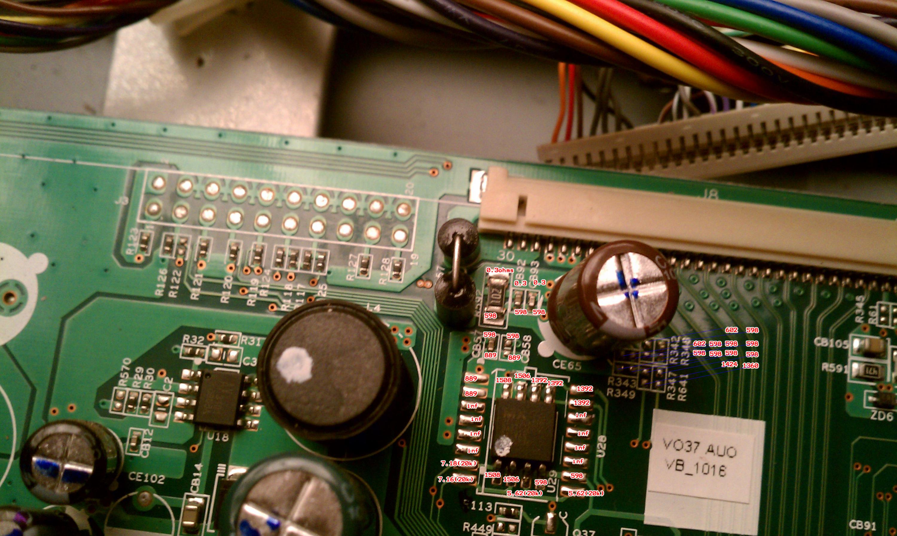

          ok which resistances should i check now? can i forget about the mx12g?
          should i put one probe on j30 and just go crazy probing everything in sight and then write down all the values and label them on the picture?

                    ok well it took a lot of time but i made pretty much all the measurements i could stand. writing them down on the picture now. gimme a minute.

                      #110
                      Re: VIZIO V037L FHDTV20A powers up, backlight on, sound works, buttons work, no pict
                      i measured some resistances lower down on the board than whats shown in this picture. ill have to take another picture to show it.
                      but heres what i got so far.

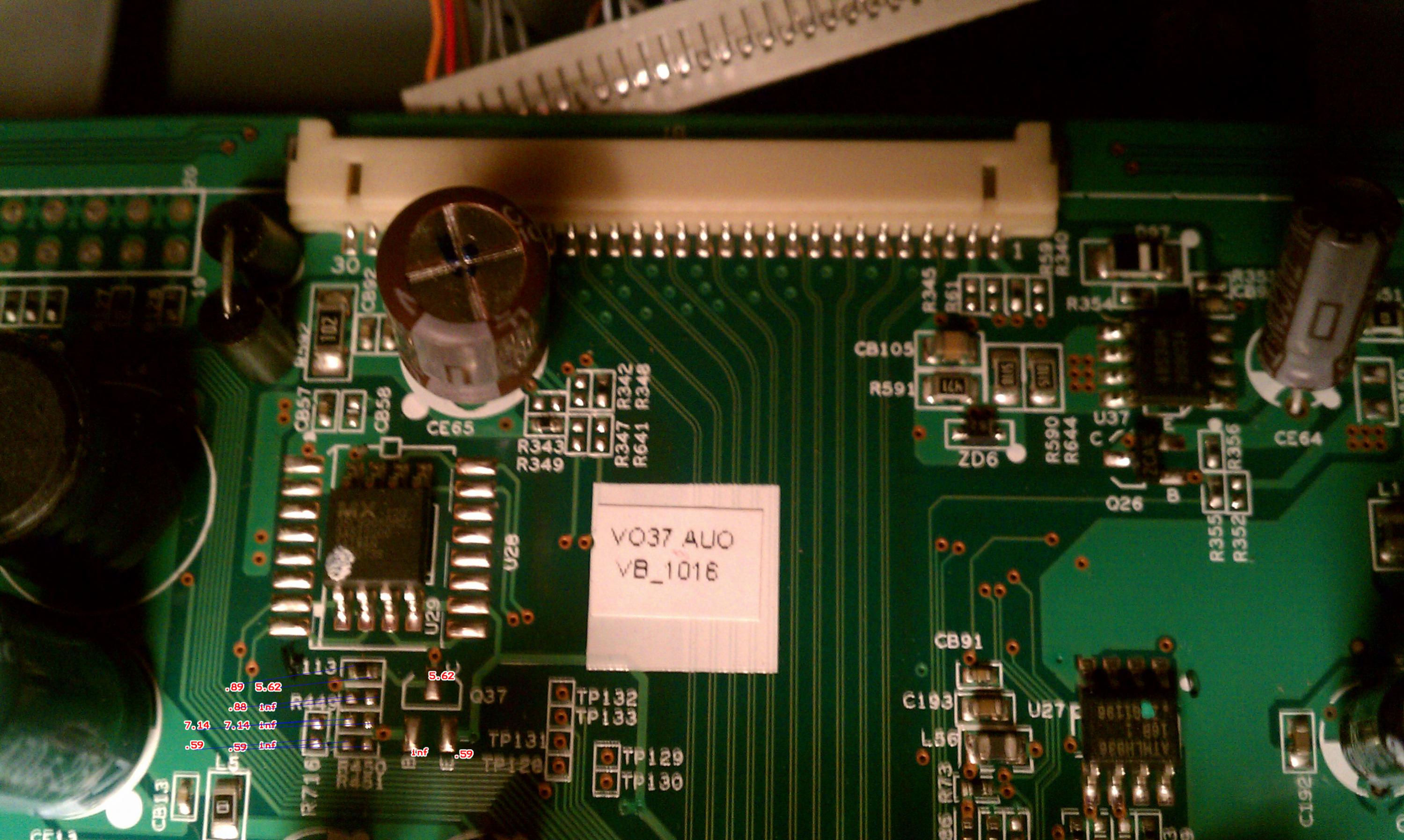

                        #111
                        heres the other part
                        Don't fear the repair...
                          OK, on post 86 you said you read 0.03 Ohms on two pads of MX-12g, now you showing the reading of 1506 ans also show 889 for the pad of c858 wwich is connected directly to those two pad of MX-12G, that cnnot be right.
                          But no matter what, that IC is NOT the MOSFET we are looking for, do not waste any more time testing that IC. You need to probe other components.
                          Your Ohm readings are not consistence as you can see you are reading the same connection but comes up with different readings.

                            #113
                            ok in post 86 i think there was some miscommunication. now that im re-reading it. you wanted me to put one probe on j30 and test those points. but i was testing between pin1 of the mx-12g and the other 2 points circled. thats when i got the .03 resistances.
                            later when i tested everything from the j30 i went over and over double checking to make sure. so those are assuredly the resistances from j30.
                            sorry for the confusion.
                            did i still not probe enough stuff? what else should i try? what am i looking for? to find something going from j30 that has .03 resistance?

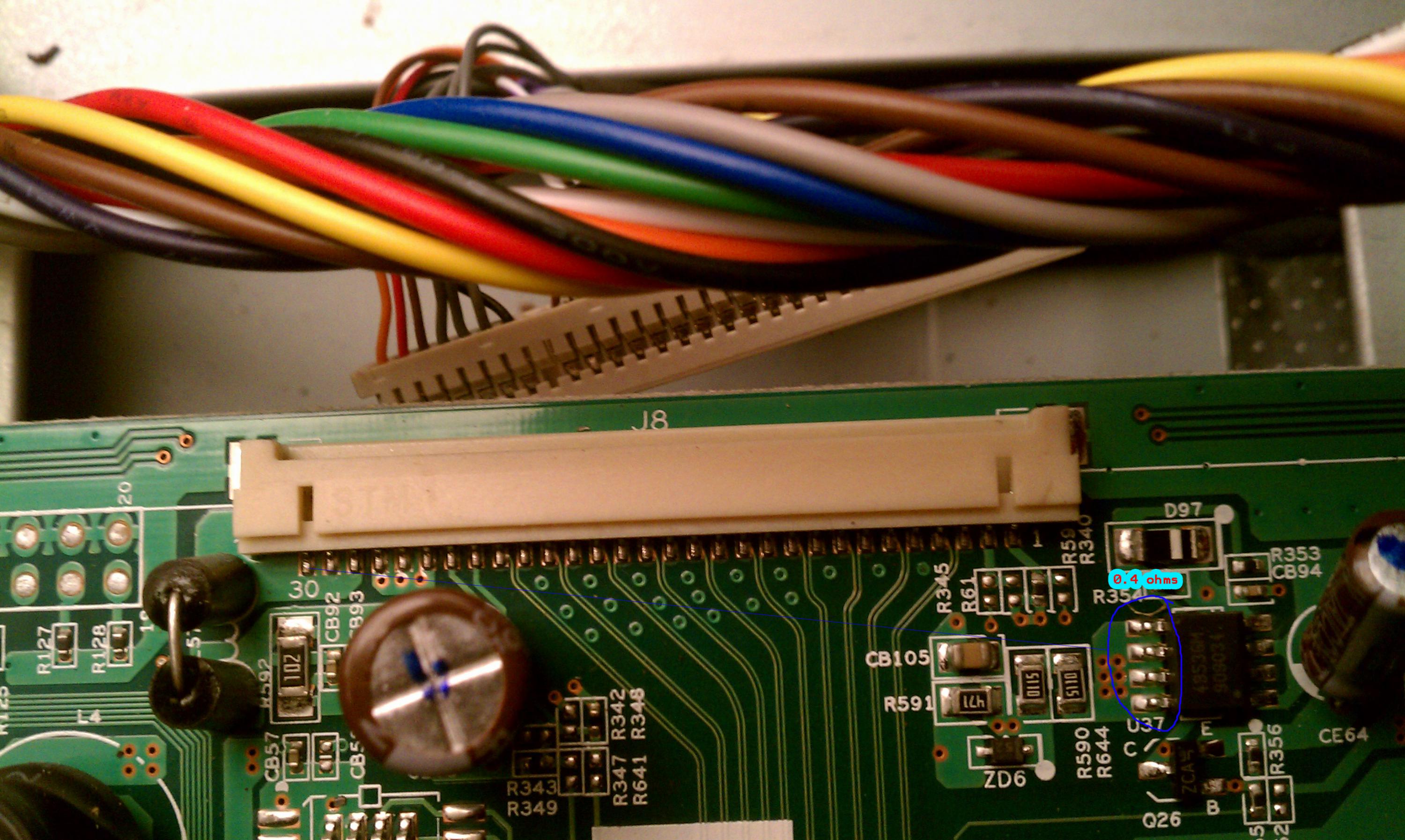

                                #115
                                ok so with the black probe on j30 i ran the red probe all over the place...i dont think i tested every mosfet on the board but every one in that area for sure. and i only found this one that has .4 ohms resistance on 4 legs
                                i circled it in the picture.
                                4853GM
                                908034
                                or is it
                                4B53GM
                                908031
                                so is this the MOSFET we're looking for, obi?

                                    #117
                                    OK that may be it! Take the DCV reading on the 4 pin on the right, the two pin (pin 1 and pin 3, you can see that they are connected to positive pin of cap CE64 ) should have 12VDC.
                                    Give me the reading of all 4 pins on the right (pin 1 ~4).
                                    "oh yeah im also wondering (and should have asked earlier) how you know that j30 is supposed to be 12v when we dont have a schematic? is that just how most vizios are?" Just from experience, other TV may not used other pins, when you work on many units as I have, you will kind of know which pin will be for the b+.
                                    P/N is AP4853GM

                                        #119
                                        its for the pins on the right from top to bottom 11.95 , 12.05, 11.95, 12.05 ...
