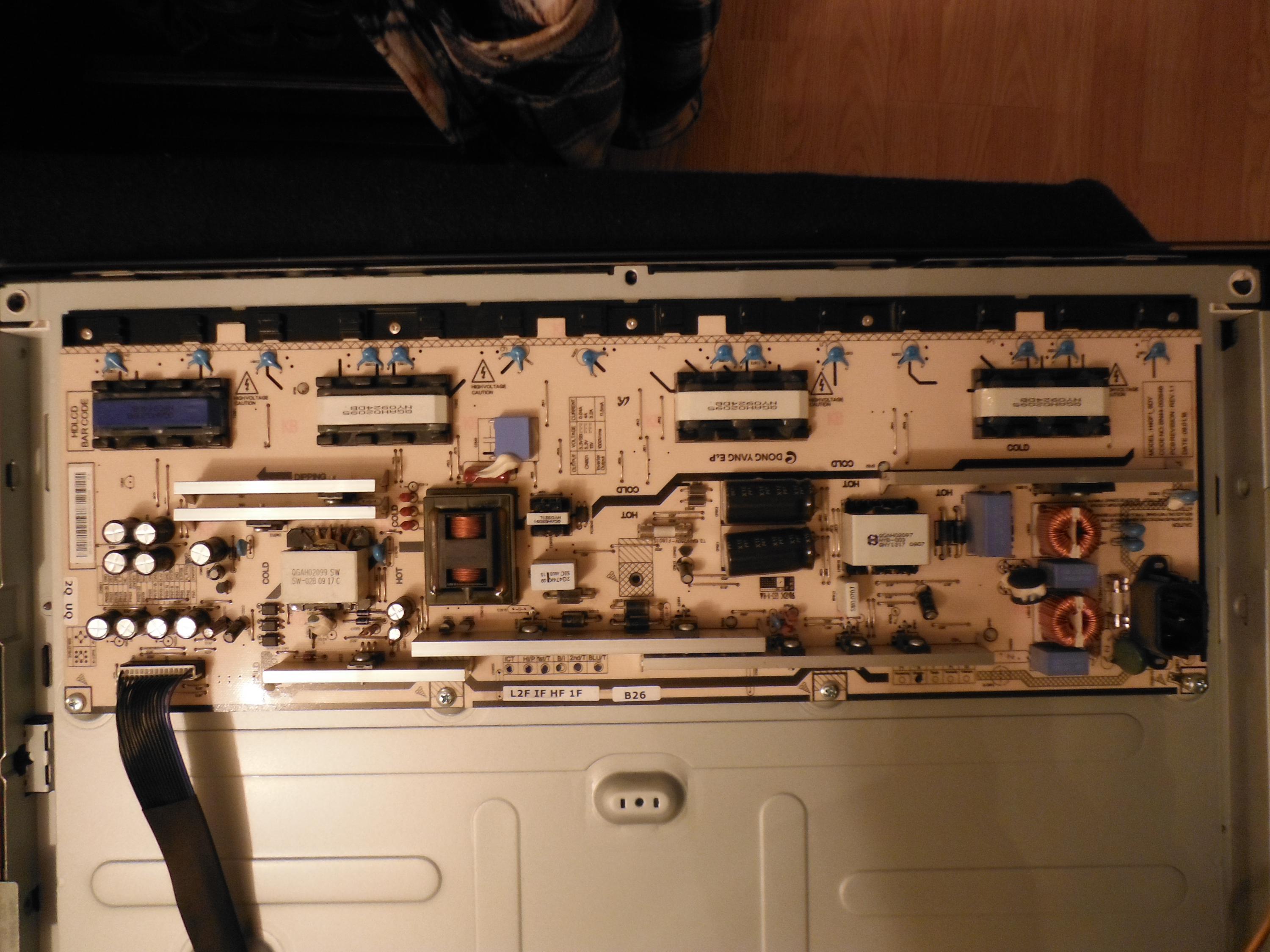

    It sounds like a problem with either the inverter or it could be a failed ccfl lamp, Check the boards for bulged capacitors, post pictures of the power supply and inverter boards. all lamps must light, of one does not for whatever reason it will shut the inverer down.

        I open it up and there seems to be no visible problems that i can see.
        no bad caps or scorch/burn marks.
        Are the ccfl s easily accessible, i would think not. Can you test a ccfl?
        As for pictures, I'll try again but the page times out.
          Re: Samsung ln40b550k1f no picture but has sound
          Here's the power supply/inverter board. this one uploaded.
          It's not too clear.

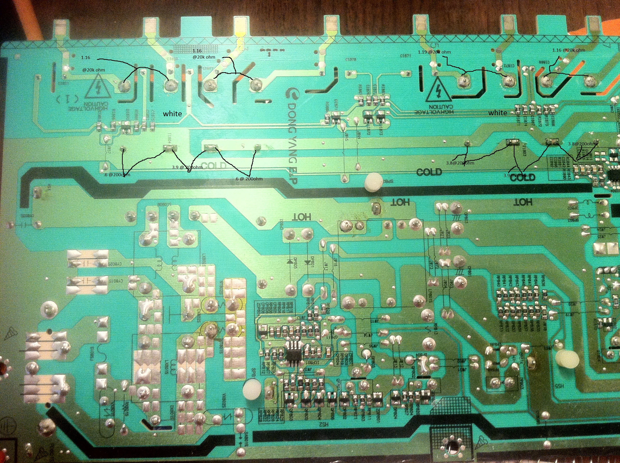

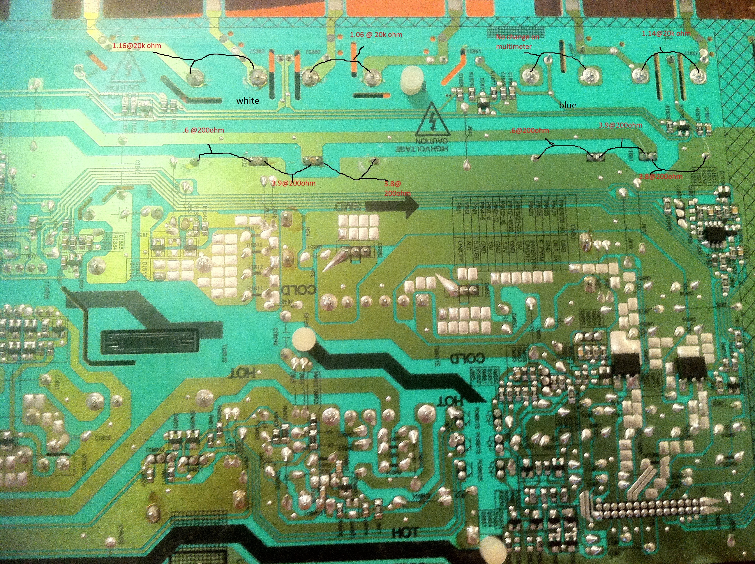

                  hi again, sorry for the delay. Been busy but got around to testing inverters and finally was able to upload some pics.
                  After reading several tutorials i decided to test the transformer on-board as a first step.
                  not sure if i did the test right. I tried to follow the diagrams on a few sights for primary and secondary coils but got a little confused along the way.
                  I have edited the photos and put in the results i got with the multimeter. I used two settings, 1: @ 200ohm and 2: @20k ohm.
                  Again, not sure if i did this right. Do these results make sense to any of you.

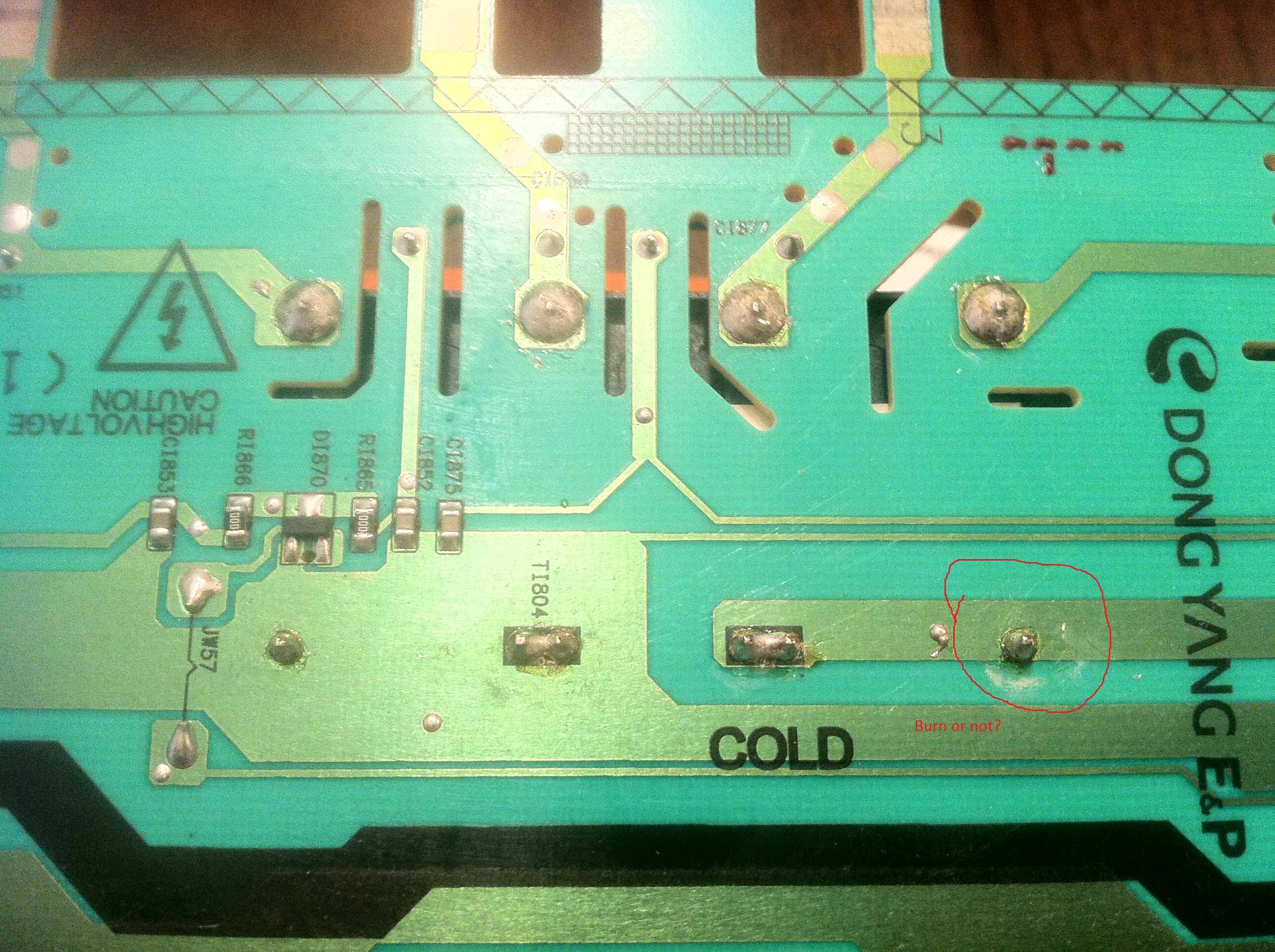

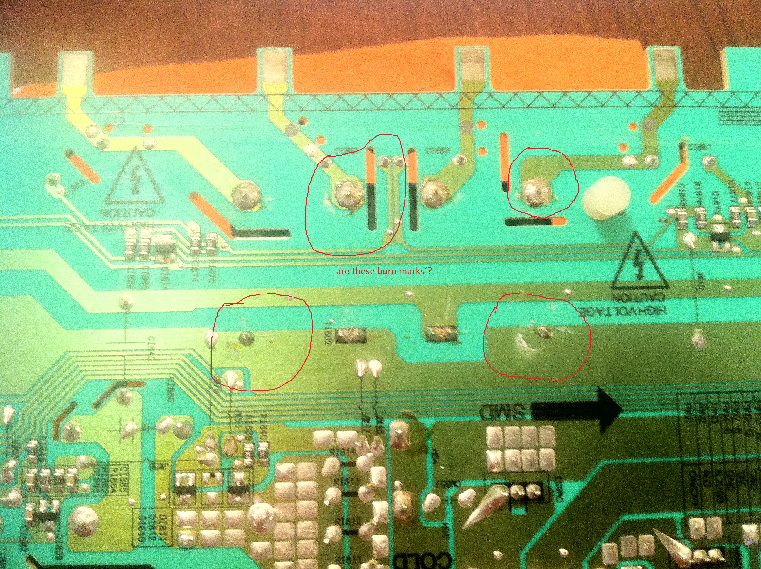

                  I also added two other pictures that appear to have some discoloration near some solder points of transformers. Not sure if they are burn marks or residual flux from soldering?
                    Hi again. I take it from the lack of responses I have done wrong. :-(
                    Sorry.
                    I have taken the time to remove all three white transformers from the board and have tested them.
                    Multimeter set to 2k ohm
                    Transformer #1
                    Primary .013 secondary #1 1.171 secondary #2 1.174
                    transformer #2
                    primary .013 secondary #1 +#2 zero
                    Transformer #3
                    primary .013 secondary #1 1.071 secondary #2 zero
                    Transformer 3 broke while I was removing it. I forced it. My bad.
                    But transformer 2 came out easily and I get no readings from either secondary.
                    Are the readings for transformer 1 ok?
                    Should I just replace all three since they are out?
                    Why would transformer 2 not function, is it something else that shorted it out?
                    Any help would be appreciated. I'm still taking baby steps here.
