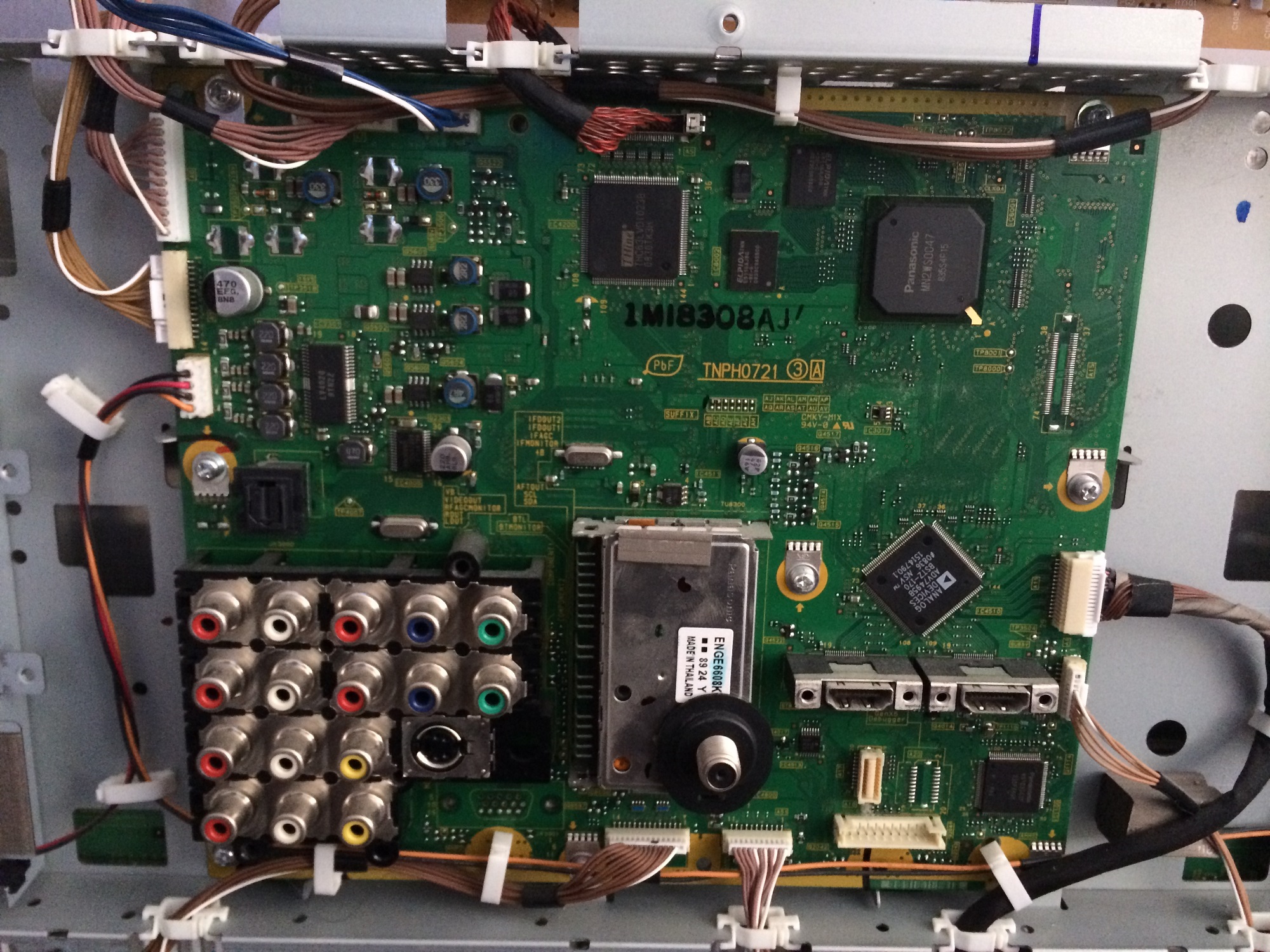

    I have a Panasonic with the typical 10 blink code. I thought it would of been the easy IC and cap swap on the PSU board, however this one has a completely different PSU than what I expected. It doesn't seem to have the little MC301/201 board.

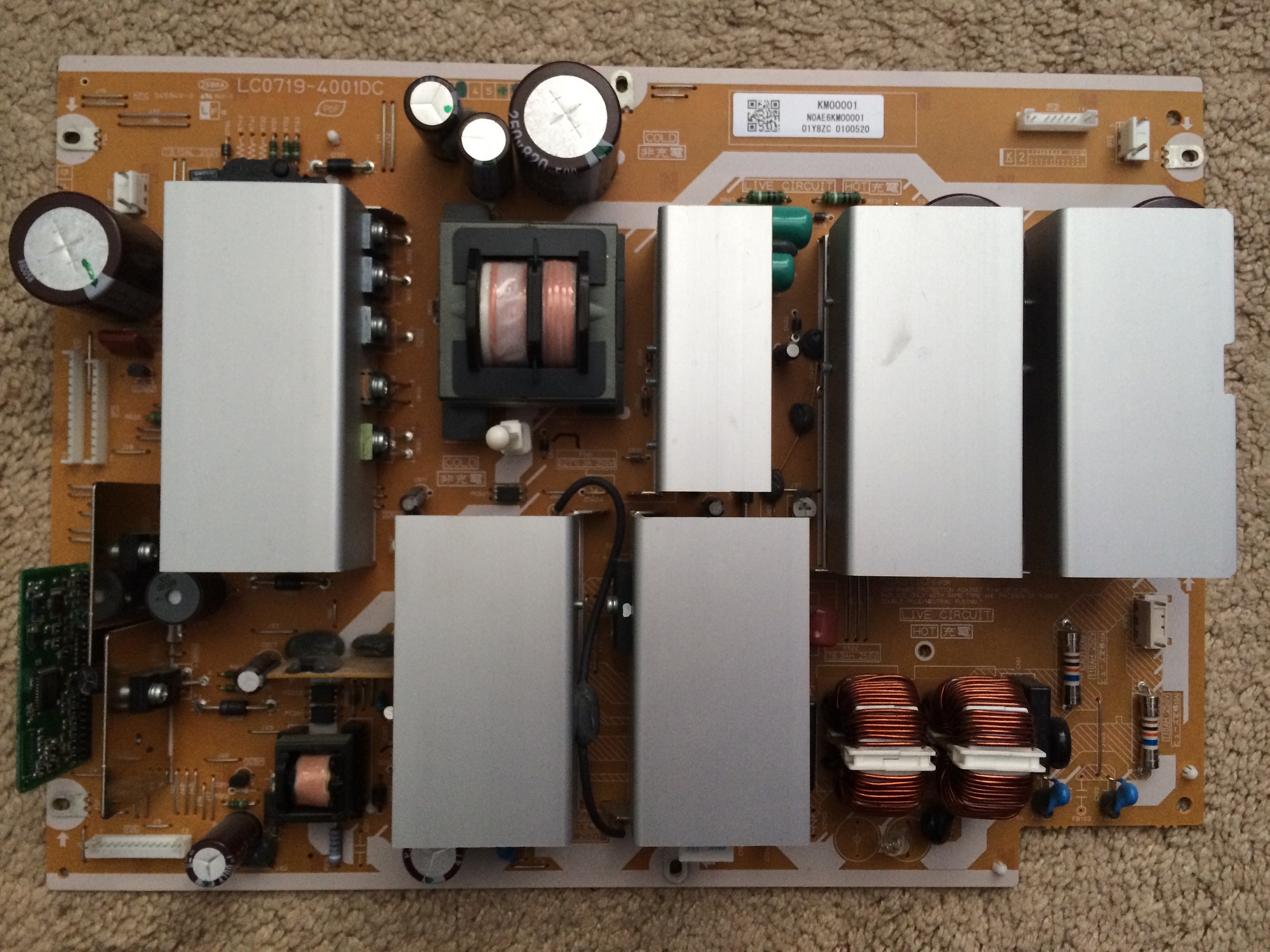

    Uh... umm... that's odd. That's a completely different PSU. ShopJimmy does show it as a possible part though.

        It appears the PSU is used in TH-C42FD18 too perhaps a late model change? End of year refresh?

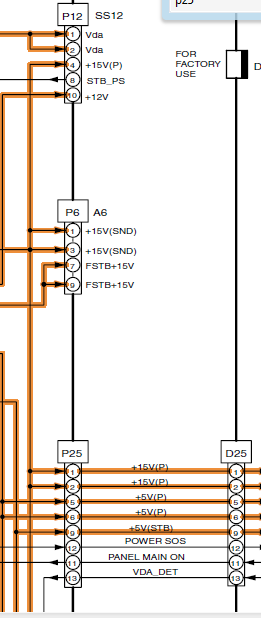

        Connection diagram is on page 30.

            Try checking the F15V pins (use the P board schematic, a different P board but identical pin out) to find an F15V_STBY pin, check the voltage as the TV cycles on and off.

              Ok I think I see it in the diagram. Is it FSTB+15V? Its in connecter P6, pins 7 or 9.
              So placing my probe on those pins, as soon as I plug in the set, it goes up to 15V for a second and then drops down to near 0 immediately.

                If the 15V goes down quickly next step is checking Vsus, should hit about 190~200V (exact rating printed on panel.) If it is low then isolate SC/SS - if it jumps to 6/7/8 blink you have a VSUS short. I believe SC & SS boards are cheap for these models so I would exchange any that are bad.

                        Sounds like the PSU is shorted. That PSU is unfamiliar but maybe check over it for shorted FETs, check for shorted outputs at the PSU.

                            I just confirmed that this is a PSU issue. I was able to get the more common PSU for this model (ETXMM655MEH) from a related panasonic panel. It won't screw in right (board was just hanging, and some cables were too short), but all the connections are the same. I connected everything to test it out and the tv powered up normally.
                            I placed the defective PSU in the other Panasonic and it gets the same 10 blinks now.
                            I'm sure the problem is something with the missing 15v on the PSU that is similar to the common PSU 10/2 blink fix.

                              You may want to check the MOSFETs for the vsus I have one in the shop right now with this problem. Alternates between 10 blinks and 2 blinks. I swapped out two MOSFETs and put in a new fuse and it is working again.

                                No shorts on the mosfets, that was the first thing I checked on the psu and all fuses are good also. I'm about to buy some freeze spray and start spraying some parts to see if I can get the set to come on.

                                    Well... something must drive these Mosfets!? If the driver is bad, there is not going to be any output either.
